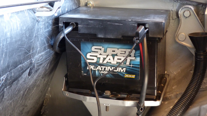

I just ditched the Optima Red Top in my car because I didn't like the fit and replaced it with this Super Start Platinum Battery Group Size 47 H5 (there are other brands that are pretty much the same battery). This one fits perfectly in the battery tray without having to trim as the Optima requires, accepts the factory hold down unlike the Odyssey. EDIT: the factory recall battery cover fits perfect unlike the Optima but just bare DOES NOT clear the rain tray when the engine lid is closed. I'm also in the camp that thinks using AGM batteries is a great idea unless you like cutting and patching rust in the hell hole.
(IMG:http://www.914world.com/bbs2/uploads/post-20845-1601772708.jpg) |

@Fejsa, sorry to join your thread! I’m also in the process of buying a battery. Anyone has an idea using Interstate AGM battery and what group number? thank you! This may help with choosing group size https://www.batteryequivalents.com/bci-batt...size-chart.html I thin Group 42 was the stock size but those aren't very common anymore. I can say that Group 47 fits fine and Group 34 also works but I had to trim the length a little and the height is pushing the limits. Group 47 is just 3mm longer than a 42 but fits the tray fine, and 17mm taller than a 42 but 10mm shorter than a 34. From my limited experience, I'd say Group 47 is the sweet spot between availability and fit. |

I just discovered that the rain tray dips down just enough at the rear to interfere with the corner of the factory recall battery cover and pop it off when fitted to a Group 47 battery. It took a little sleuthing to figure out why the cover snapped on the battery so nicely and the engine lid shut perfectly, but whenever I opened the lid, the cover was popped off. Bummer. I guess you really need to stick with a Group 42 battery to use the recall cover. I edited my earlier post to correct it.

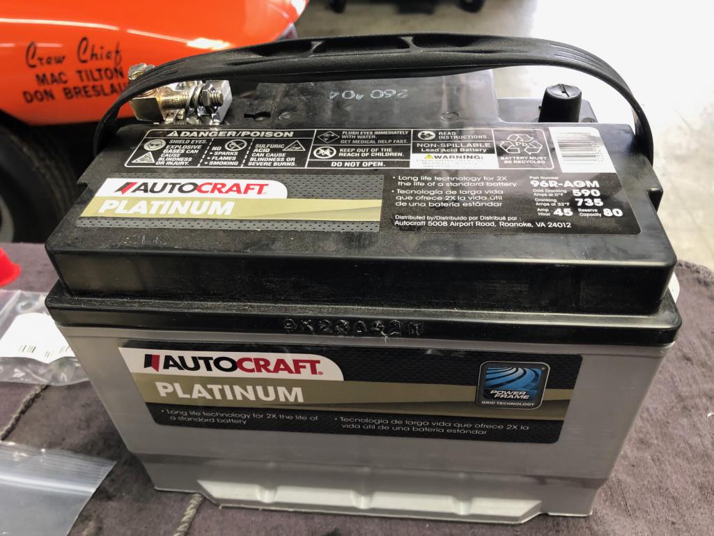

trick-e |
