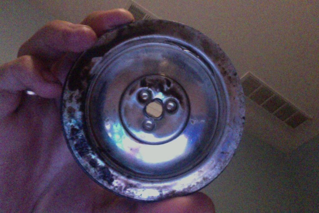

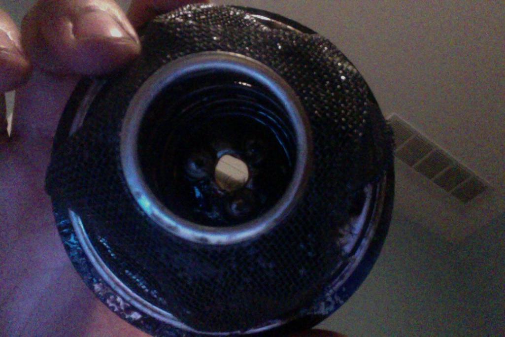

I pulled the oil metal mesh basket today and I was a little panicked to see that it looked like this. The metal center where the the bolt goes thru looks deformed to me, is that normal? The mesh itself I had to crush a bit removing from the metal plate and I used a new one. I'm praying that the previous owner did *not* over torque that bolt, how can I tell if this is the case? Also, how do you guys remove rounded bolts? The oil drain plug is near impossible to get off with the state it's in right now. Attached Image Attached Image

I've seen worse strainers. Count it as a blessing as long as you're not finding metal trash on the strainer.

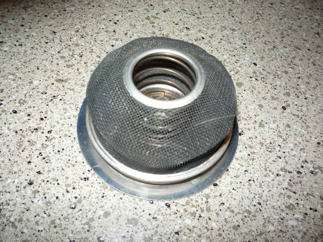

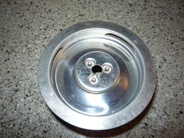

Screen looks normal. I think I may have a few NOS filter nuts and screens, have to look. Added pictures of NOS one

Be careful that the screen center is not deformed upward. When building my engine, it would not build oil pressure, the center had blocked the oil pick- up tube, fixed that then OK.
