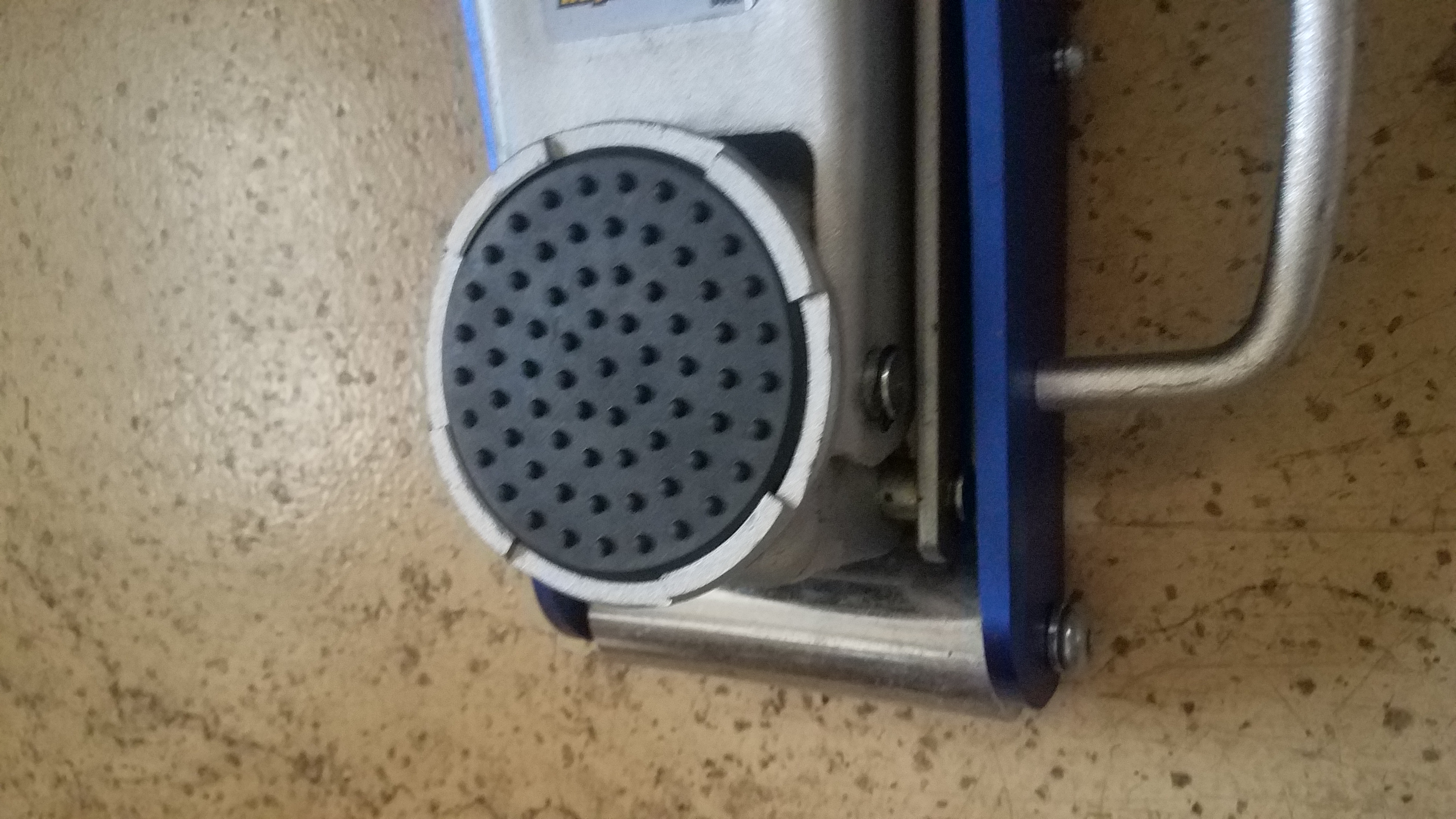

I agree on the Tangerine Engine Plate. (TEP)
I modified TEP to make it work better with my floor jack. I also modified the stock floor jack plate. The floor jack plate was originally mounted to the jack in a way that wasn't meant to be removed. I modified it to be removable so I can swap the TEP.
The hole where the original plate mounted was not big enough for the solid cylinder stick down from the bottom of the TEP. I enlarged it to fit the TEP cylinder and then dirlled, cut and shaped the TEP cylinder to fit over the hoirizontal bar in the floor jack.
The pictures should tell the story better than words. I wish I had pictures before the modifications.
Original jack plate with black rubber insert.

QUOTE(TX914 @ Nov 19 2020, 07:04 PM) *
Put everything you take off in containers so you don’t lose anything and label if any doubt. After several days with the engine out you will forget things! Also, Plan to spend 90% of your time cleaning stuff.
FIFY

QUOTE(AZBanks @ Nov 19 2020, 09:58 PM) *
TEP on floor jack. ROCK Solid!
That’s nice work @AZBanks . My craftsman jack had a similar horizontal pin that would not allow the TEF to sit down in the hole. I removed the pin and got a couple of carefully measured bolts to us in its place. That was a tip from Chris at Tangerine.
