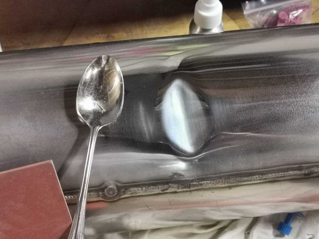

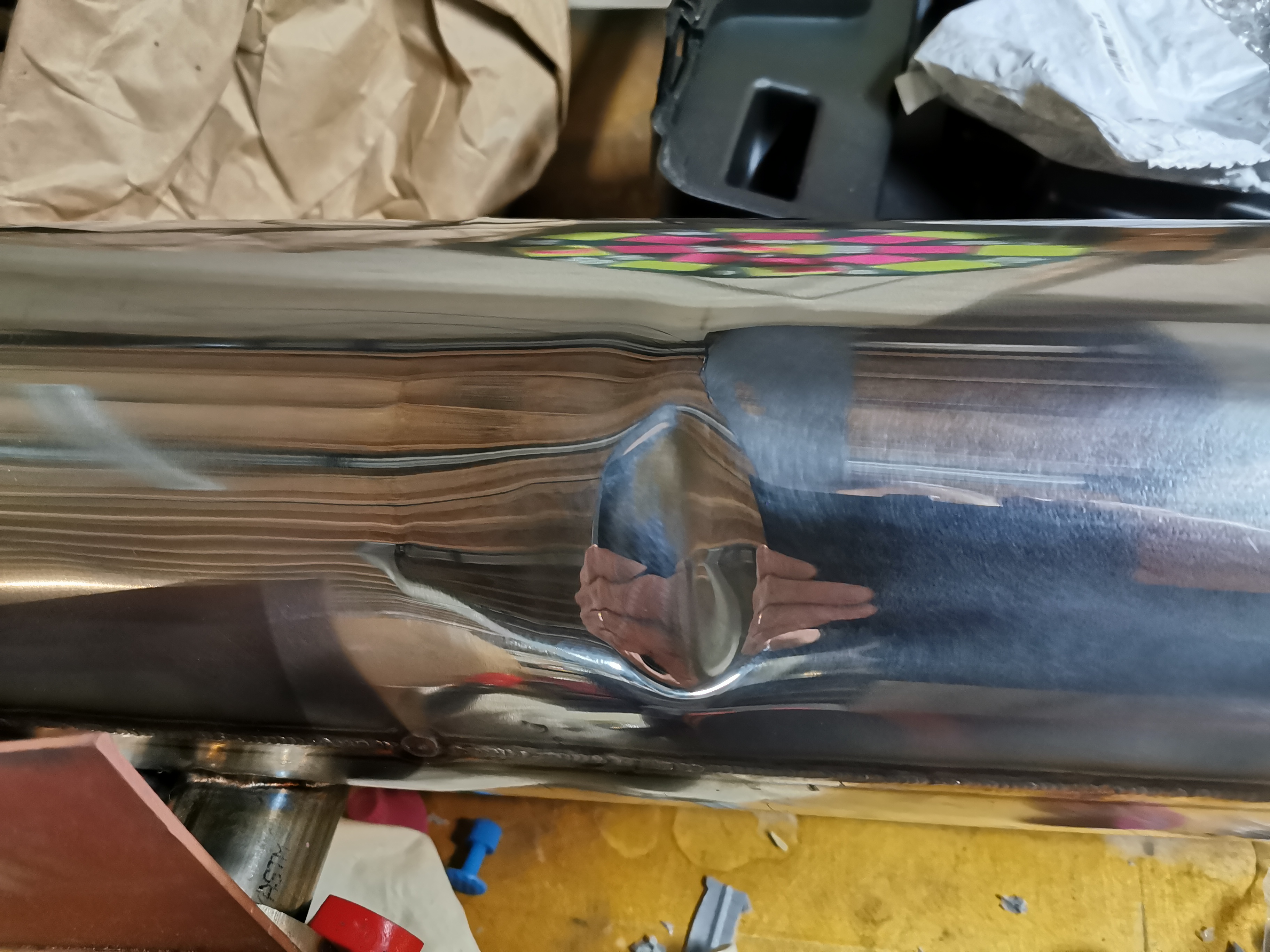

Ben sent me PDR kit which arrived yesterday. I also picked up a similar kit at Eastwood along with some stronger TabWeld Glu sticks and slide puller to augment robo puller.
After spending several hours and dozens of pulls, including some pretty strong ones, I think it is about as good as it's going to get without going to a next level which could do more harm than good (stud welder, glowing red heat, etc). I also was able to apply about 25 psi of pressure to the inside.
I would say it is some improvement at this point. Reduced the length of the dent to about 2.25" x 1.25", it now looks much like a teaspoon (although I guess it looked similar with a sharper crease before).
Perhaps one of the metal masters here has ideas to further reduce it. Getting to it from behind is not an option.
On a plus side, I do doubt it will effect sound or performance. Likewise, it *might" not be visible once installed (I have not yet removed old muffler to try fitting). On the other hand, it's still a noticable blemish :-(
Ideas welcomed.
