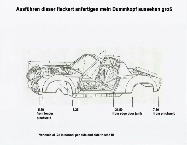

Have them follow this if possible, also have the flared rocker for correct placement. Best, MarkAttached Image

Awesome information! thank you!
