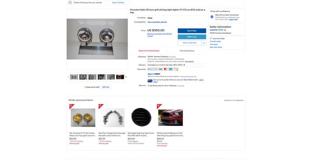

914Sixer
post Nov 28 2020, 07:56 AM
Posts: 9,616
Joined: 17-January 05
From: San Angelo Texas
Member No.: 3,457
Here is seller on Ebay. He has them in fog, driving and yellow fog. Reproductions made to factory specifications. He is using the H3 bulb. Should be LED replacement for H3

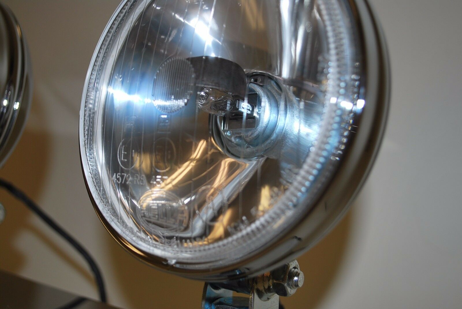

914andy
post Nov 28 2020, 01:47 PM
Posts: 63
Joined: 23-December 11
From: Nashville tn
Member No.: 13,929
Yes... those are the style of lights I am installing. I always thought the stock fog lights were pretty much useless.
If this gentleman is having them made, I wonder if he would consider making just the reflector for 914 fogs? I think I will inquire about that.'

914andy
post Nov 28 2020, 10:31 PM
Posts: 63
From: Nashville tn
Member No.: 13,929
The actual lens & bezel are different.The back of the light will interchange with a stock 914 fog.The size of the reflector is a bit different size wise as well as the fact that it takes an H3 lamp. It still fits within the stock fog opening. Focus is going to be a bit more critical since a whole lot more light is being thrown farther down the road.
I just need to tweek on my focus.... I had forgotten how low these cars are....gettin to old for this.
