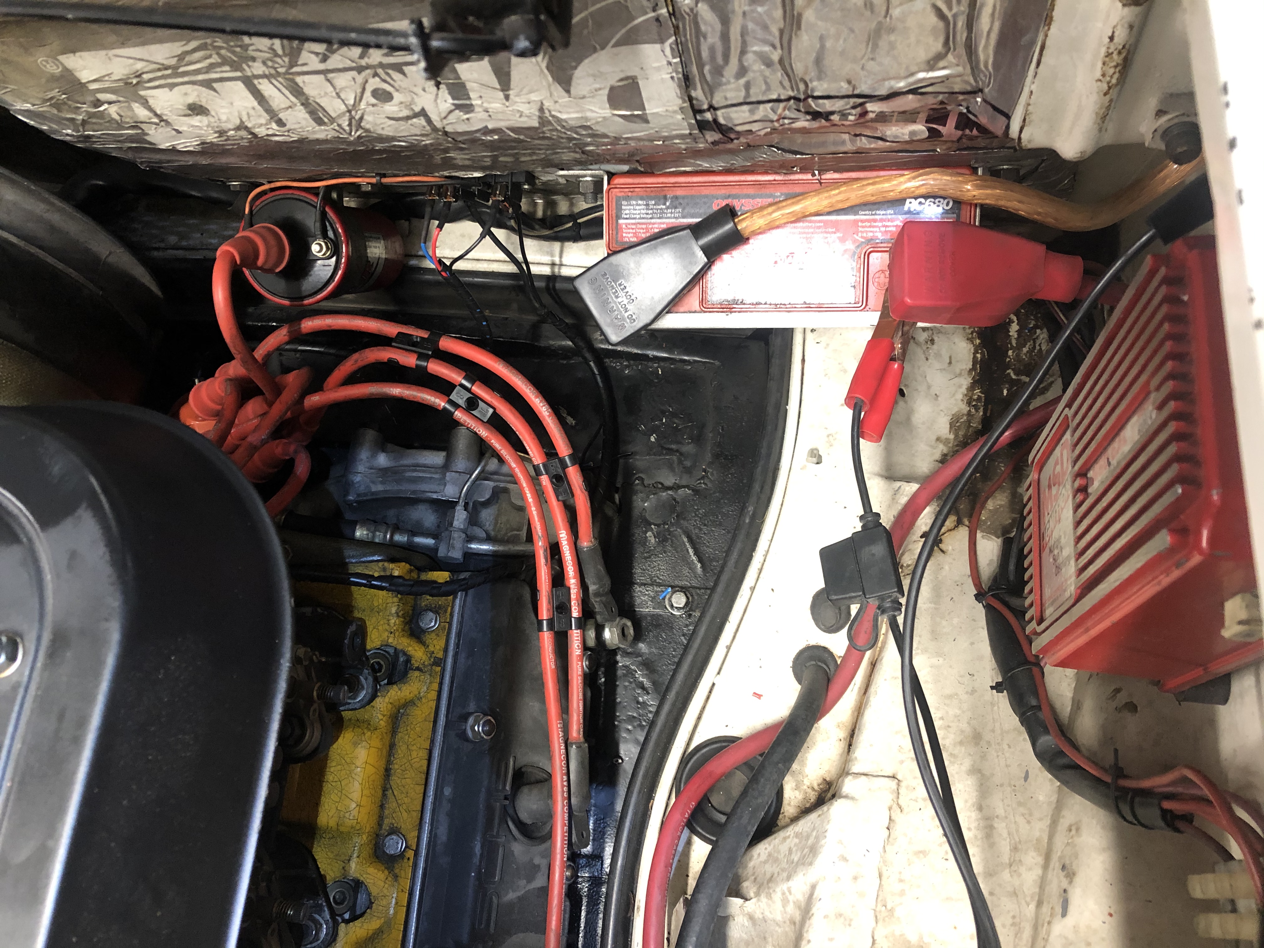

So I’m wired up
Blue ground
Red ignition hot
Black to white MSD
I’ve got the green LED at Z1 on the flywheel 1 TDC
I re-installed plug leads with #1 aligned with where the rotor points with the green LED on.
I can see 12VDC on the 123 dashboard while cranking.
Just spent 2 hours double checking verifying etc.
no change.
I know lots of people are running this with MSD, Ben being one of them.
What have I missed?
Attached is a pic of my wiring. Yes I know my coil wire is a tad short.

Mark Henry   C&P from the bird post #8 of this thread by me...   Nov 27 2020, 09:34 PM
blabla914   Thanks Mark I read that thread on the bird board b...   Nov 27 2020, 09:41 PM
Mark Henry   Trigger your MSD box by jumping the purple mag tri...   Nov 27 2020, 09:47 PM

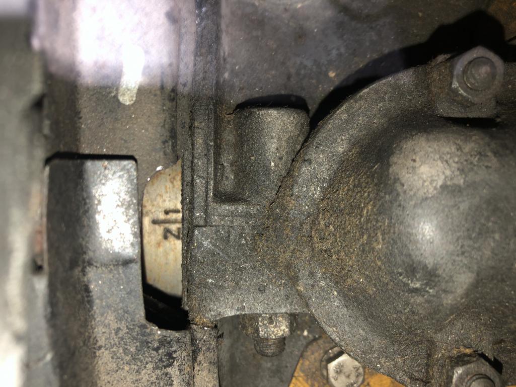

mb911   Are you sure your on z1? My guess is your just a t...   Nov 28 2020, 07:51 AM
blabla914   Thanks for posting those Mark. The car just ran on...   Nov 28 2020, 09:07 AM
mb911   Thanks for posting those Mark. The car just ran o...   Nov 28 2020, 09:37 AM
blabla914   Swapped the blue coil with 3 ohm primary resistanc...   Nov 28 2020, 09:46 AM
mb911   Swapped the blue coil with 3 ohm primary resistan...   Nov 28 2020, 09:51 AM
sixnotfour   prob. on #4 not #1 Z1   Nov 28 2020, 10:01 AM
mb911   prob. on #4 not #1 Z1 That could be if he didn...   Nov 28 2020, 10:04 AM
blabla914   prob. on #4 not #1 Z1 When I read this I though...   Nov 28 2020, 10:27 AM
mlindner   And best to have it marked on the flywheel for the...   Nov 28 2020, 10:04 AM
mb911   And best to have it marked on the flywheel for th...   Nov 28 2020, 10:05 AM
blabla914   IDK man.....looks like I’m right on Z1. Has a...   Nov 28 2020, 10:08 AM
mb911   Still betting on a tooth off   Nov 28 2020, 10:11 AM
sixnotfour   If that is a 2.4 engine , that is not Z1   Nov 28 2020, 10:17 AM
mb911   If that is a 2.4 engine , that is not Z1 Oh go...   Nov 28 2020, 10:18 AM
blabla914   If that is a 2.4 engine , that is not Z1 Oh g...   Nov 28 2020, 10:28 AM
sixnotfour   [quote name='mb911' post='2870186' date='Nov 28 2...   Nov 28 2020, 10:39 AM
blabla914   [quote name='mb911' post='2870186' date='Nov 28 ...   Nov 28 2020, 08:12 PM
blabla914   Ben called it. Off a tooth. I didn’t appreciate ...   Nov 28 2020, 08:02 PM
