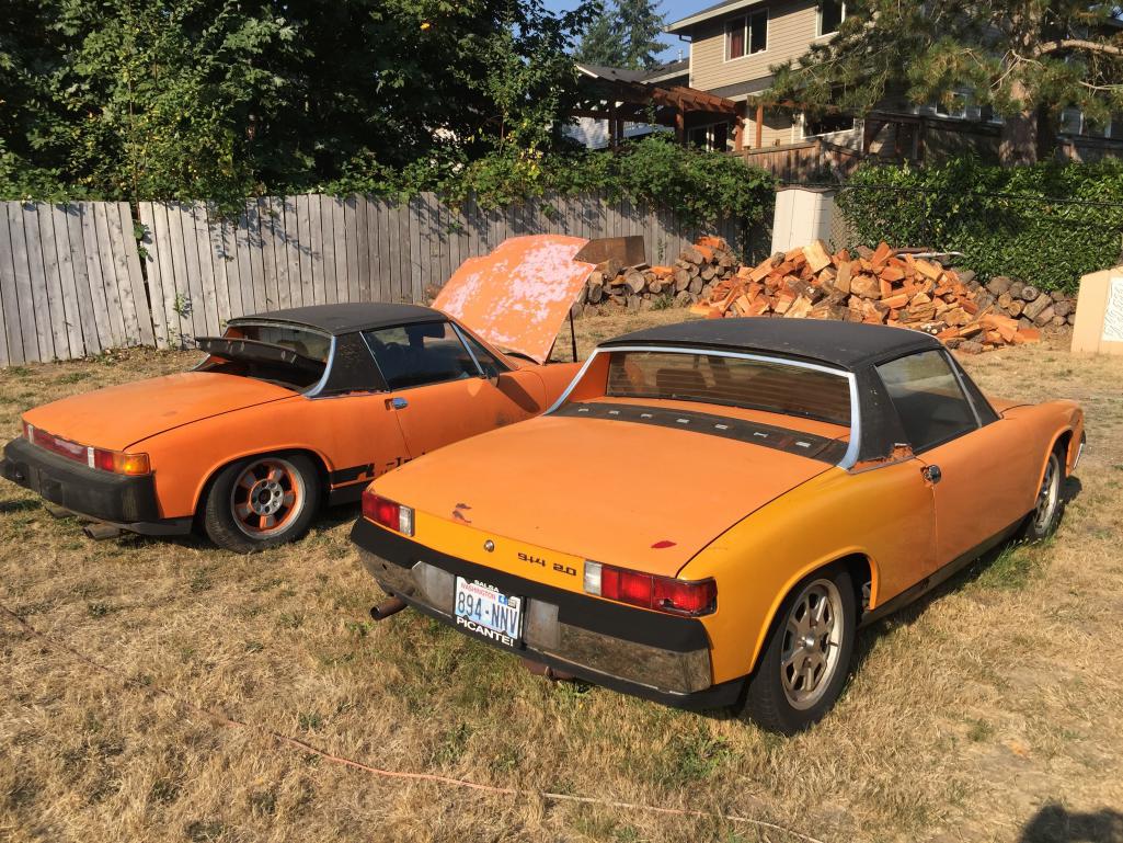

I think that is high given the location. Right front fender has damage; maybe the bumper and hood as well. There looks to be a funky patch in the right wheel well. The back edge f the rear trunk lid shows signs of rust and it's probably worse than it appears. The back bumper looks good. The passenger outside handle looks funky; maybe broken? Glass looks good. The Fuch wheel's are worth $400 if straight. The right valence is bent under towards the rear. May have run over something and bottomed out. Pull the carpet behind the seats and check the floorboards. Look beneath also. Check rear of trunk floor for rust and as always the hell Hole also. (IMG:style_emoticons/default/beerchug.gif)

I think that is high given the location. Right front fender has damage; maybe the bumper and hood as well. There looks to be a funky patch in the right wheel well. The back edge f the rear trunk lid shows signs of rust and it's probably worse than it appears. The back bumper looks good. The passenger outside handle looks funky; maybe broken? Glass looks good. The Fuch wheel's are worth $400 if straight. The right valence is bent under towards the rear. May have run over something and bottomed out. Pull the carpet behind the seats and check the floorboards. Look beneath also. Check rear of trunk floor for rust and as always the hell Hole also. (IMG:style_emoticons/default/beerchug.gif) Thanks for the tips.....I'll let you know if I make a buy. |

Take an ice pick.

It's all about condition.
Right rear corner repair with poor paint match. etc. etc. Defrost rear window. Good color. 2.0, Best year. |

If you’d like another set of eyes to check it out let me know.
