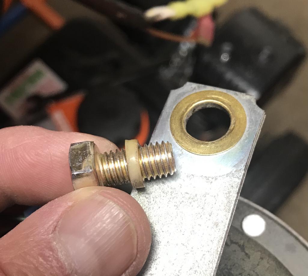

What is the purpose of this plastic ring on the horn other than centering the 13mm bolt on the horn bracket? I only have one and have gone nuts trying to find them.
ThanksAttached Image

To dampen vibration to the body. Some horn brackets are triple layered. Use a rubber washer too.

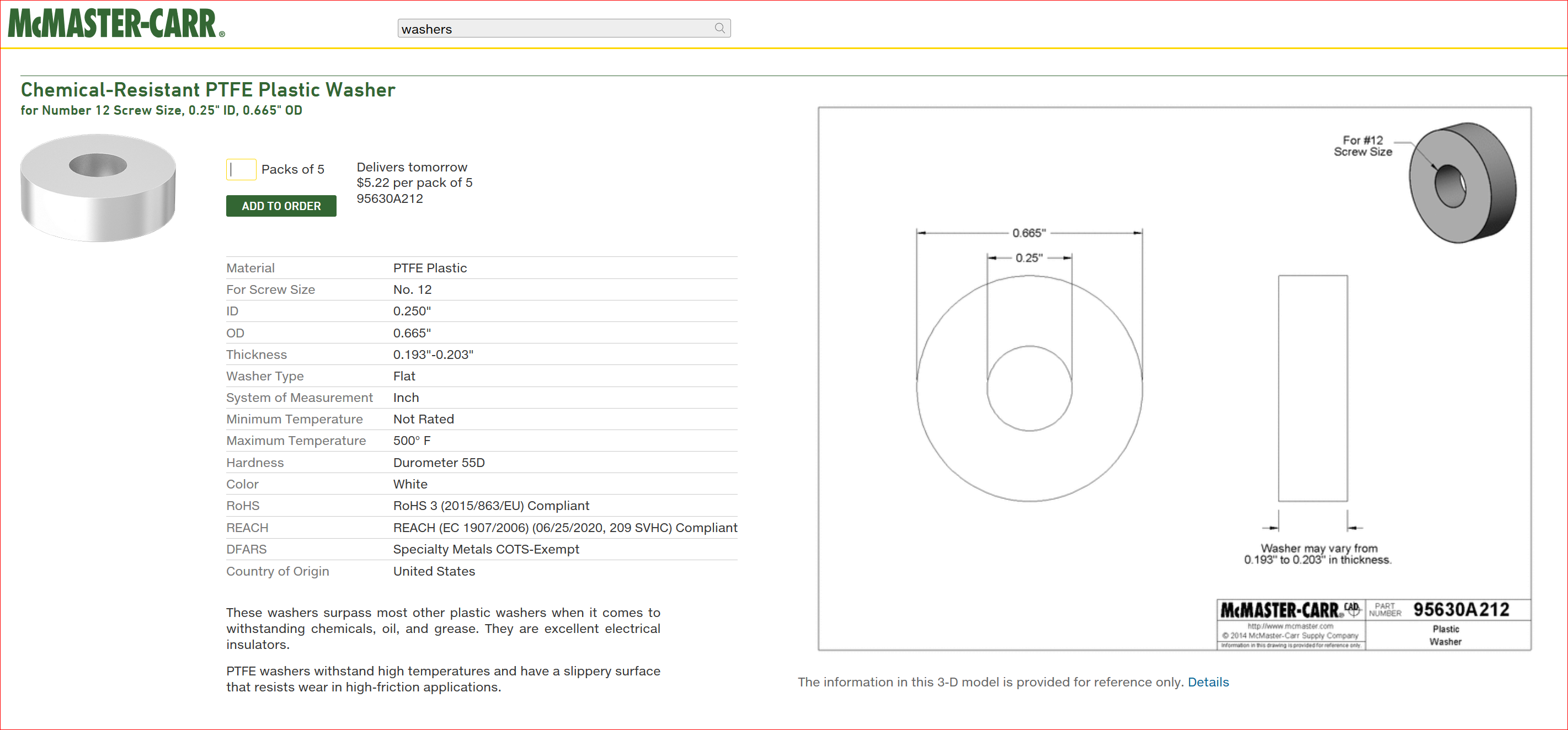

How about this one ? I guessed at the thickness.

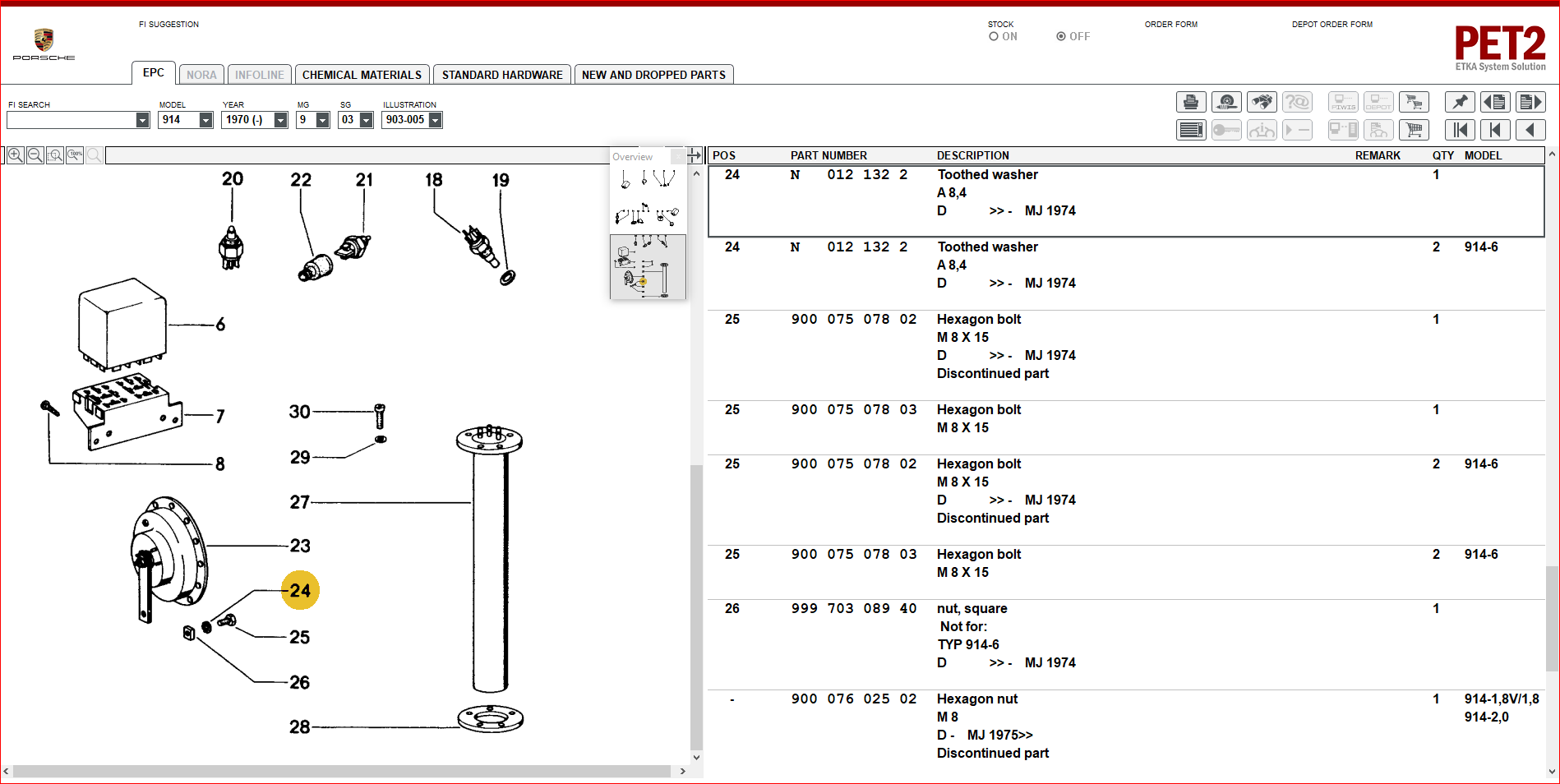

Does it go between the horn and the bracket, or the bracket and body? PET only shows s lock washer on the bolt to the body. I have never seen one of those plastic washers on a horn but PET is not always right.

I'll ask for a sample from McMaster and see. update to come later.

@Nacho
-Nacho
[/quote
Does the washer fit inside of the hole?]

I think it does.

Yes the washer fits inside the hole and does not extend past the thickness of the bracket
