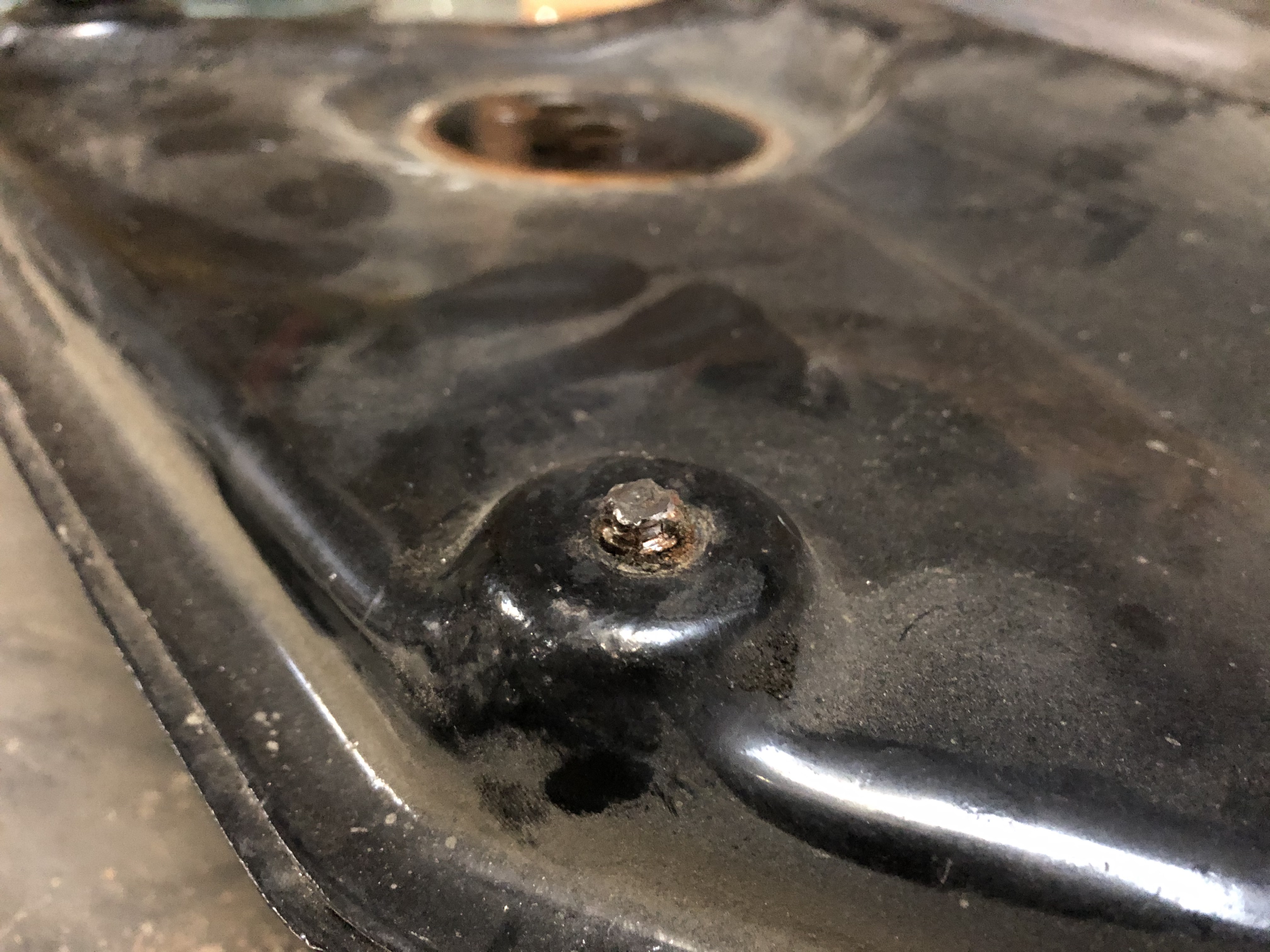

i had to pull the oil tank out of my 914 to address a leak, and one of the mounting studs on the tank broke when i went to remove the nut. it broke about a 1/4" off of the tank.
quick google search last night didn't yield any good intel, what am i looking at to replace that stud?...

yes, the stud on the right hand side of that diagram is the one that broke. there is only 1/4" or so left on the tank.
i can feel the back of the other stud and it feels almost like it's pressed in from the back side...

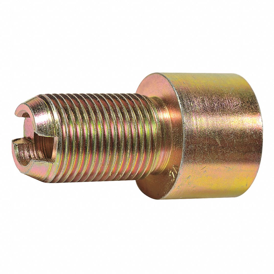

If there's enough thread, you might be able to use a stud extender. Might have to put an extra washer or two on the engine bay side. But it would be an easy fix if it's possible.

yeah, there isn't enough of the stud left, and the threads are jacked anyhow.

You could try to cut the old one flush at the base and then drill and tap the hole for a new stud. Being carful not to drill thru into the tank.

Maybe take a bolt with the same tread, grind the head to about .080" thick. Grind the broken stud flat to the tank. Mig the modified bolt/stud to the tank.
That is what I would try. The extra material provided by the ground head would make it easier, less risky to weld. You could push the puddle formed by the hot head metal to flow into the tank wall material for good penetration without burning through the tank wall. The threads would be clean all the way down the stud to the weld, where as when welding a stud to the broken stud you would have to chase the threads down onto the old stud to get a full threaded stud. Possible but a bit risky and a lot of work.
be sure that if you try this to grind off the copper plating that is on the tank. Welding through the copper would ruin the weld.

I've fixed this problem before on 911 tanks. You'll need to carefully grind the broken stud flush to the the tank and clean the area to bare metal.
The only proper way to re-attached a stud to metal this thin is to carefully braze a new stud on and it will be as strong as the original
The tank is too thin for electric welding in my opinion even TIG is a challenge due to the vast differences in material thickness.
Also getting rid of all the oil or rust contamination for a proper electric weld is near impossible, brazing is much more tolerant in that regard.

Thats a tricky spot for sure.. that stud is brazed with a flange from the inside..That will be a tricky repair. A couple ways to go about it.. I think the best way would be to drill and tap then insert a stud and weld or brake in place. That will ensure proper centering.
