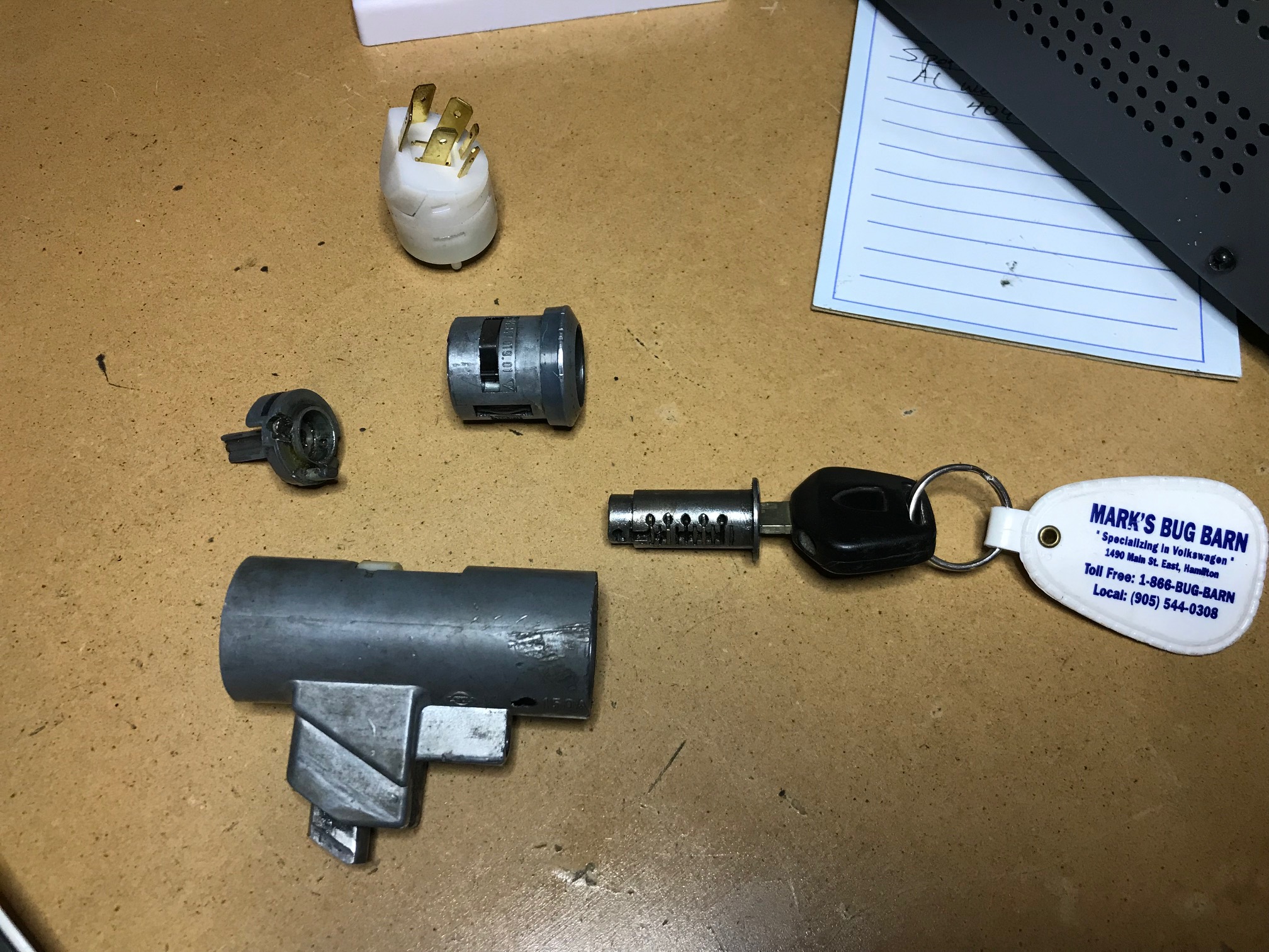

As I read it:
Steering column is turning completly free (wheels move right and left) but the lock cylinder and key itself won't turn.
What I've seen is the housing for the ignition key cylinder gets worn and then the wafers start hanging up in the notches or indentations that have been created over time. This prevents the ignition key from turning.
Wiggling up down and side to side may help get it rotating temporaily.
I had one in similar situation and the end solution was to get a new key cylinder housing assembly that wasn't as worn as what I had. In my case sometimes it had to sort of be "forced". However, do this at your own risk. In my case I was getting very concerned about breaking a key off in the ignition cylinder before I replaced the housing.
The housing I'm talking about is the middle row - it is the part the lock cylinder and wafers rotate within.
