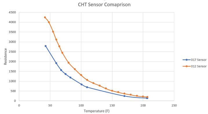

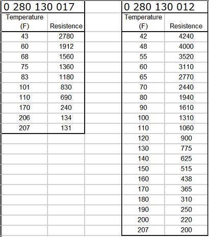

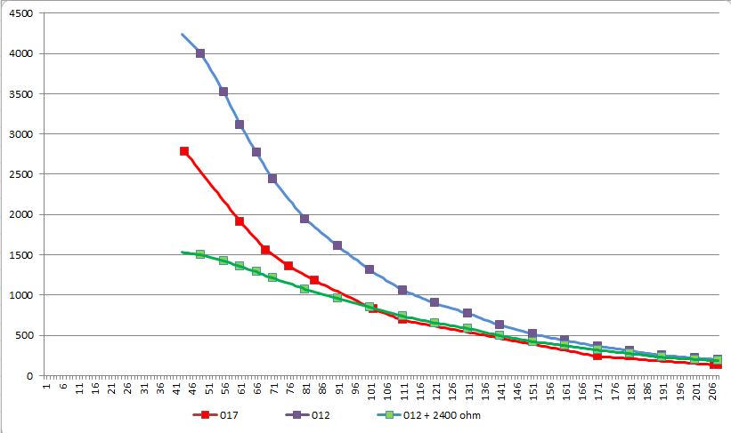

I recently acquired a NOS temperature sensor for the one year only '73 Djet system 0 280 130 017. This sensor has been NLA for a very long time and finding a used one is very difficult. Given the rarity there isn't a lot of information on the proper resistance values of this sensor. Pbanders (https://members.rennlist.com/pbanders/DJetParts.htm) lists three data points for the resistance of this sensor but I thought I would post my findings. I also listed the values of the aftermarket sensor 0 280 130 012 available from 914Rubber.
@Superhawk996 This answers some of your concerns.
