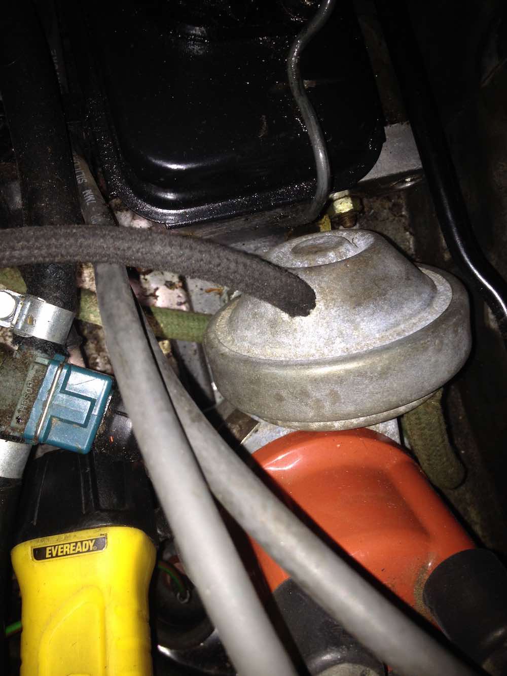

Green vacuum line from Distributor.
Seems to be the same as the D-Jet cars.
There is a green vacuum (retard) line out of the distributor body to the throttle body.
I think i am right saying its the retard side (sometimes gets dyslexic on that).
The green line in this photo is an original vacuum line. Along with the crankcase vent hose these are the only two lines i did not replace on my car. The crankcase line is moulded to an S - shape and we decided to stay with the original. its still sealing ok.
Same with the distributor line. We checked and still pliable and it was sealing so it stayed. We cleaned it up a little. I also left the intake manifold seals on as we did not go that far in - requires disassembly of the intake manifold. They are still in good sealing condition though looking a little aged.
There is a black vacuum (advance) line out of the distributor to the throttle body.
The green line from the distributor was the only colored line still apparent on my car.

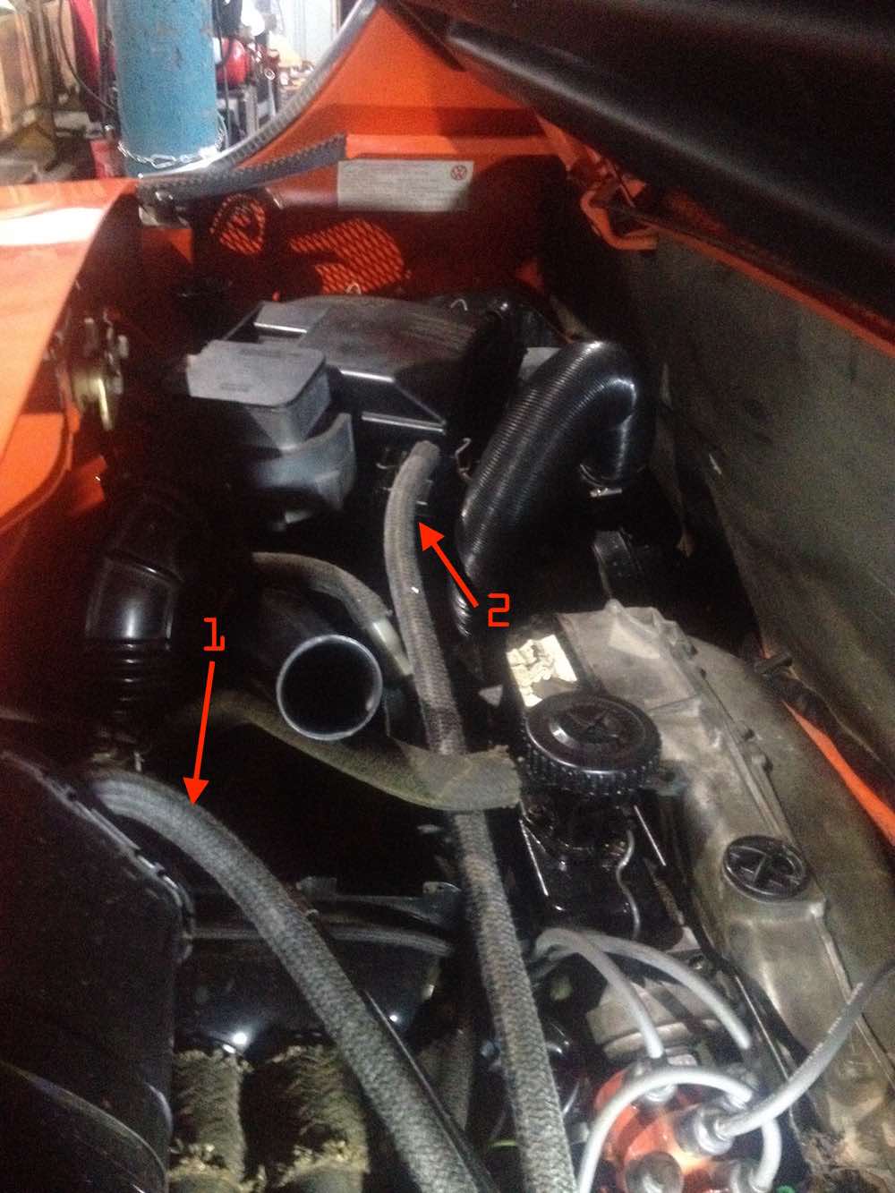

second bit of information is that hose layout for charcoal cannister evap vapor system is incorrect on some diagrams floating around.
i've come across this before.
i believe the arrangement and design of the charcoal cannister changes at some point -
possibly when the cannister is moved into the engine bay in the 1.8 cars.
earlier cars had a charcoal cannister up front near the fuel tank.
the earlier design has the fan blower hose connected to the end of cannister along with the small diam tank expansion/fume hose. the hose to the air cleaner connected at the opposite end of the cannister.
diagram from factory manual showing early layout.
the schematic shows the fan blower hose arrangement.
the schematics for the 1974 (and later) 1.8 (and 2.0 L as well?) are from the emission warranty i have. These show that the arrangement of the cannister hoses changes.
The fan blower hose now connects at the opposite end of the cannister to the expansion/fume hose from the fuel tank and the air cleaner hose. this conforms to the hose arrangement in my car which i have never altered and i believe remains original.
i have replaced the hoses last year and simply copied what was there.
I have a view on this. I believe the original design did not work and the cannisters failed to purge during open road cruise driving. the blower hose was too long to push fumes back into the air cleaner for burning off. there is no valve in this very simple system. the charcoal is the valve. once it becomes saturated the hydrocarbon fumes escape to the atmosphere (via the fan hose or via the air cleaner after passing through the filter - in fact i can smell it in mine at the moment because i am sure the charcoal filter is saturated and the car needs a good run to purge it).
the charcoal filter cannister is located on the rear engine bay firewall in my car. which is a jan 74 build. i think it was shifted one more time in 74 to just beside the battery and stayed there until the end of production. i think they did this progressively to shorten the fan hose to make this system work. the hose plumbing is the same in both positions in the engine bay. i've looked at a few engine bay images to confirm that.
The hoses were dark grey/black standard hose colors on my car.
They had faded and have been replaced with new dark grey/black hoses.
starbear has already amended the diagram shown below for the charcoal cannister hoses in the other thread.

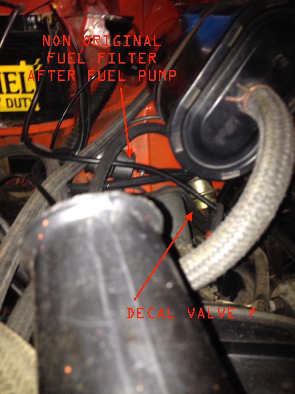

the above error in the factory manual gets me to something that has been puzzling me since we re-newed most of the vacuum lines and hoses last year.
this "decal" valve was just floating around in the rhs of the engine bay of my car, not attached to anything. both i and my mechanic were a bit troubled by this as we could not believe either porsche or vw would do this. i've been looking at it ever since. its always been there like that since i bought the car 31 years ago and i had no real cause to think about it until the hose renewal work last year.
as part of the work we did on the car we also had to change the fuel pump as the original was kaput. i am attempting a rebuild of that original fuel pump but for now we have plumbed an in line 2 port pump replacement. we incorporated a high pressure fuel filter into the fuel system after the pump as that is good practice (porsche themselves began to do it on later cars like the 924). we mounted that fuel filter off a handy bracket just behind the battery mount tray which had a handy hole already in it.
i now realise that bracket and hole is where the desal valve should mount. and the desal valve itself has an inbuilt bracket. except the one i am looking at in my engine bay doesn't have a bracket and the more i look at it, the more it looks like a fuel pressure regulator that has been plumbed in there. i am going to try and get to the bottom of it today with my mechanic.
if it is a fuel pressure regulator it does not seem to affect the engine running or coming off revs. mystery for the moment.
i have noticed searching around on the web that in this image, showing at 2.0L motor there is a very similar looking valve installed as the one floating in my engine bay.
wonkipop
post Jan 23 2021, 06:51 PM
Posts: 5,770
Joined: 6-May 20
From: north antarctica
Member No.: 24,231
got to the bottom of the decal valve mystery.
pulled out the floating valve and found the part # still on it.
Bosch 0 280 160 200.
its a fuel pressure regulator valve subbed in for the decal valve.
not done by me so predates 1989 and by original owner or dealer/mechanic.
we thought about it.
we reckon its a clever emissions cheat from back in the day.
most people here, first thing they did with their 911s back then, was to block the small vacuum line of the decal valve with a ball bearing. or they just pulled it out and plugged it. owners hated the decal valve and the slow idle drop, not what you wanted cornering a 911 off and on throttle?
think it was done a lot in the USA too.
subbing in a fuel pressure reg valve does the same thing. plugs the small vac line.
but passes visual inspection on an emissions inspection if not looked at closely?
i think i will leave it in, its part of the history.
now i know what it is. we might have a bit more of a think about whether its doing anything - we don't think it does anything wrong?
car drives great, always has. comes off throttle nicely.
never had any serious backfire issues, just occasional pops and burbles out of the back.
will just mount it properly.
which i would have to do anyway even with reinstalled decal valve given new fuel filter.
