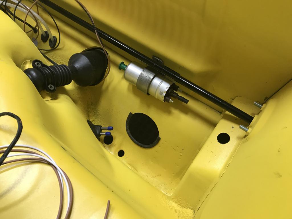

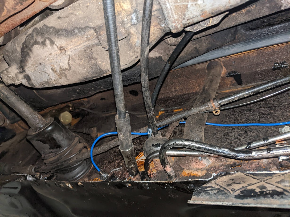

This thread is what comes up for pump relocation but I haven't found many examples of with the steering rack. So here is:
Got through this in a day. Only need one wire if you make a good ground. The filter is pretty big and is a little pressed in with the panel.
I put holes for the wire just big enough to also put in some old washer tubing as a type of grommet/protection going through the sheet metal.
