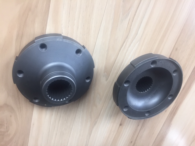

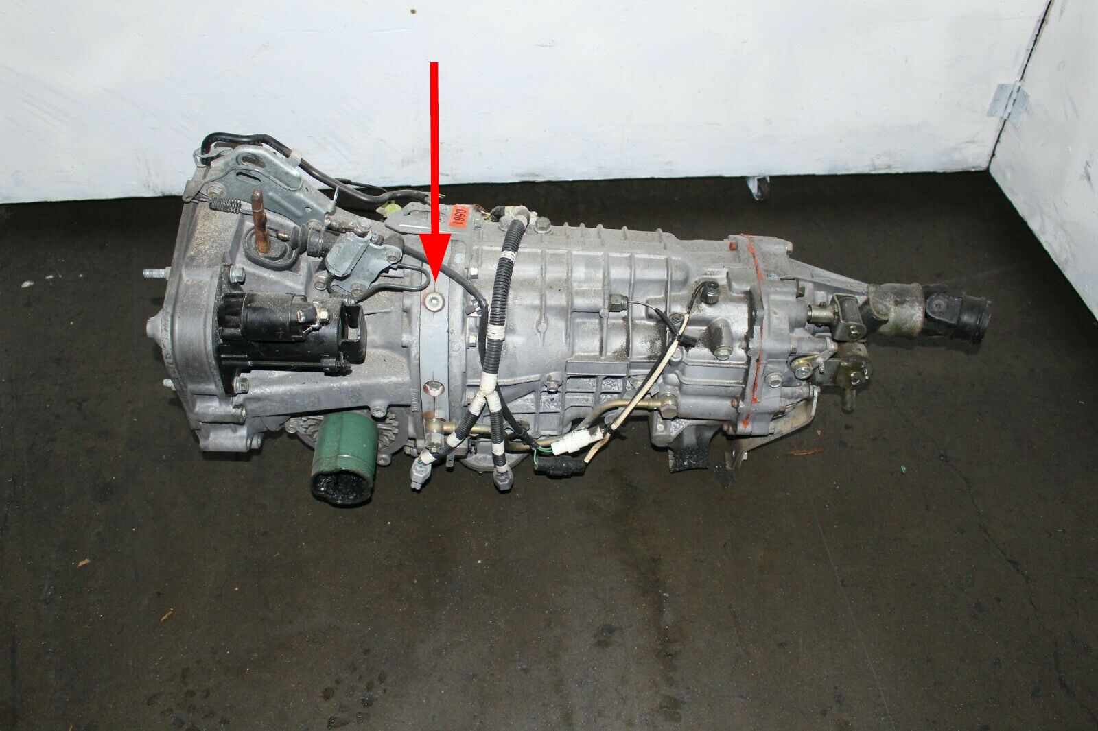

The Subaru WRX STI about 2004-? and have a one piece case. These are the biggest, strongest and longest transmission. Linkage shift. Arguably more than you need for most 914's because the extra weight and added rotating mass is not needed. Last I looked nobody makes the coupler to disable the AWD and needs to be welded as been shown on 914World.

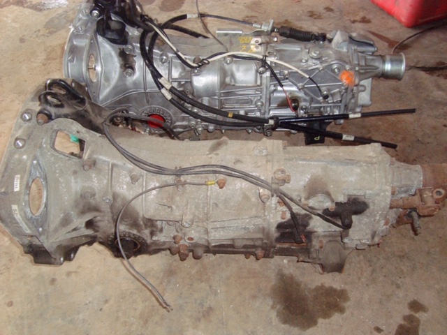

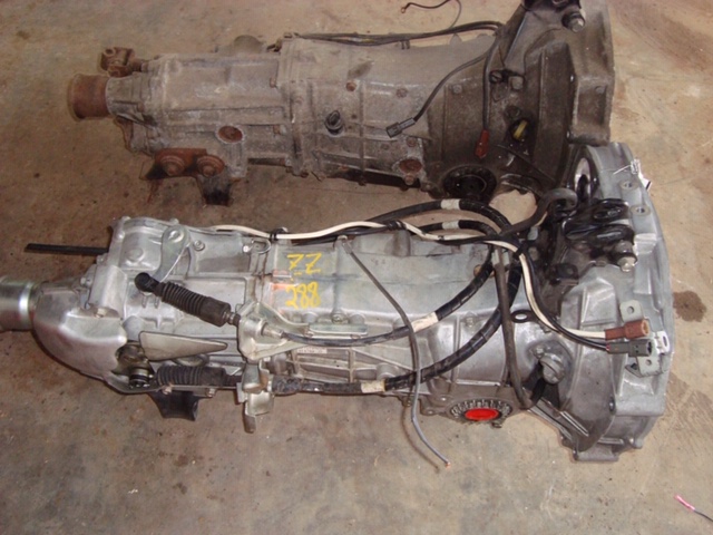

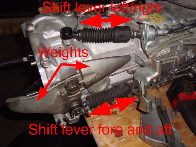

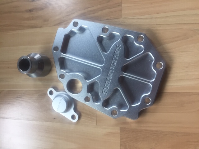

The latest is 6-speed split case cable shift that is the same length as the 5-speed. In the US it comes in the the 2015-? WRX. (not WRX STI) also 2014-17 Forester and probably a couple others. There are different ratios between models but externally and fit appear to be the same. Outside the US they came in diesels also. Subarugears.com sells the coupler and rear cover. The only negative I noticed so far is it doesn't have a speed sensor.

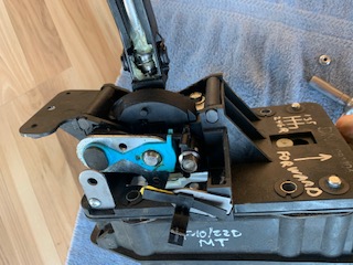

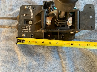

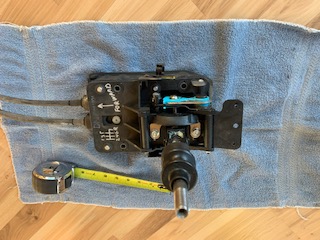

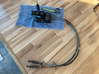

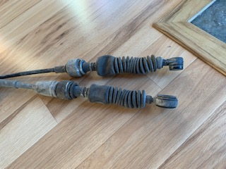

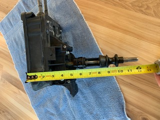

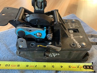

I just purchased one out of a 2016 Forester with 43K miles. I will be using the shifter out of the Forester with custom length cables.
The Forester transmissions are selling for less than half the price of the WRX.

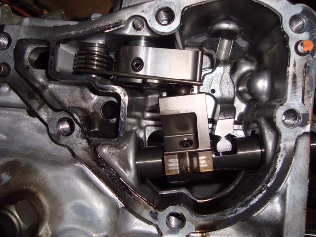

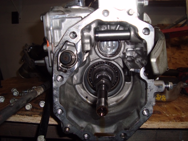

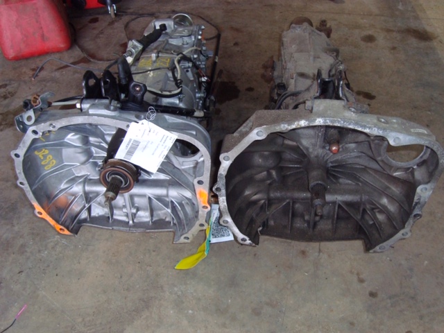

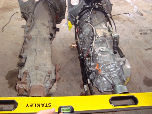

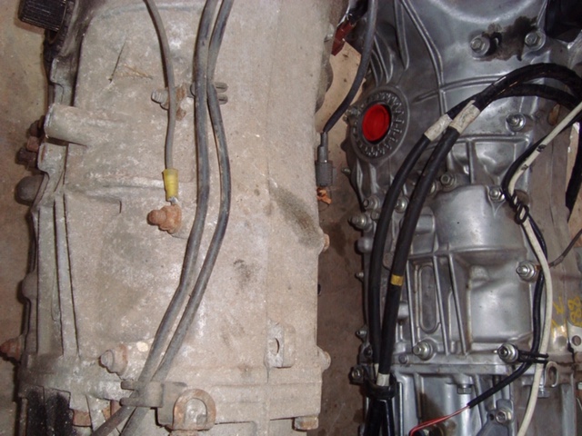

Here are some pictures comparing the 6-speed to an old 5-speed. I think this would be a good option to consider for future swaps.
To quickly identify the STI 6-speed I usually look for this divider plate the red arrow points to.

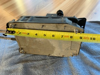

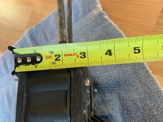

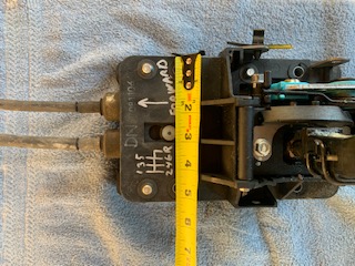

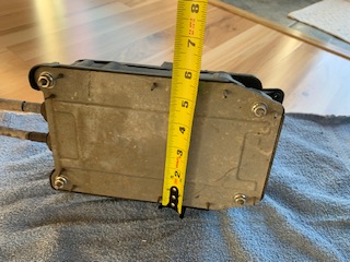

914Subaru   I purchased this shifter cable assembly to see how...   Dec 15 2021, 02:10 PM
rhodyguy   After a brief look elsewhere, why the 6 speed? Wou...   Dec 15 2021, 04:03 PM
cali914   Great info I have the 5 speed set up in the garage...   Dec 15 2021, 07:42 PM

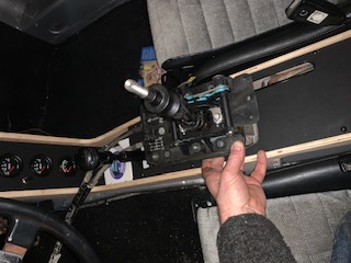

Zaffer   I realize this post is older, but thought I’d as...   Jul 16 2026, 06:02 PM
76-914   I realize this post is older, but thought I’d a...   Jul 17 2026, 08:06 AM
East coaster   Hmmm……..I didn’t have to cut my clutch lever...   Jul 17 2026, 04:50 PM
76-914   Hmmm……..I didn’t have to cut my clutch leve...   Jul 18 2026, 02:54 PM
East coaster   Hmmm……..I didn’t have to cut my clutch lev...   Jul 18 2026, 07:27 PM
76-914   [quote name='76-914' post='3265545' date='Ju...   Jul 19 2026, 06:56 AM
