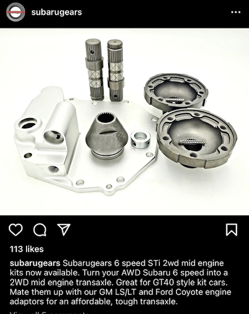

post Jan 17 2023, 12:15 PM
Post #34
Posts: 59
Joined: 19-October 08
From: Duluth, MN
Member No.: 9,667
Now there is a kit to use the STI transmission.
The STI transmission is the ultimate when it comes to Subaru boxes. There has been someone in this group that has made their own kit that requires some welding and advanced talent for sure. Now being easier I would consider this kit if I was to do another. Although a new engine transmission cradle would need designed.
