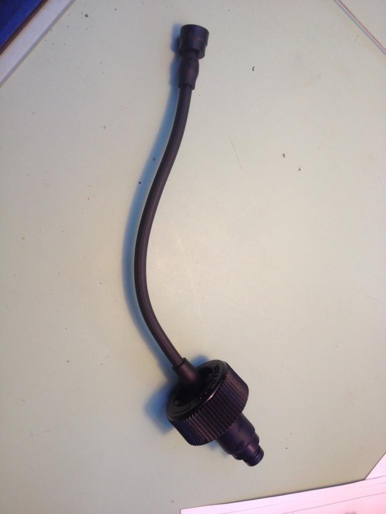

cracked the problem with mine.
the hose connection to the tyre had dirt in it which stopped it from sealing once it was screwed into tyre valve. the tyre valve once you screw it down combined with tyre pressure self seals it, unless you have grains of dirt in there that stop it all being pushed back and self sealing under pressure.
pulled both screw in connectors to schrader valves (in line valve and tyre valve) and soaked in hot water. dissolved dirt out of the tyre connector fitting. basically grains of sand in there were washed out.
whole system is working again. pathetic as it is.
the mikey tip on how to fit the hoses is 100%.
just soak in hot water.
and fit.
hot water is your friend in fitting and also cleaning parts of the system.
it all accumulates either sand grains in critical spots or calcium deposits.

managed to even restore the section i had zipt-ied 6 months ago.
had retained a piece of orig hose from under the dash that was still pliable/not perished. cut a length. found some rubber hose right diameter in the workshop to use as orig style seal sleeve and followed the Mikey tip. boiling water or just under boiling water temp - hose can be made to go over the tits on the fittings fairly easily. same for massaging sleeves over that. boiling water - super hot. the rubber hose won't move with just hot water. keep a kettle/saucepan on the boil for a constant source and keep soaking it. works well, no air leaks. now all back to stock form and does not seem to be leaking.
+ thanks to bbrock i now air up the tyre from the connection near the gas tank filler.
can't believe i never realised that for 30 years.
