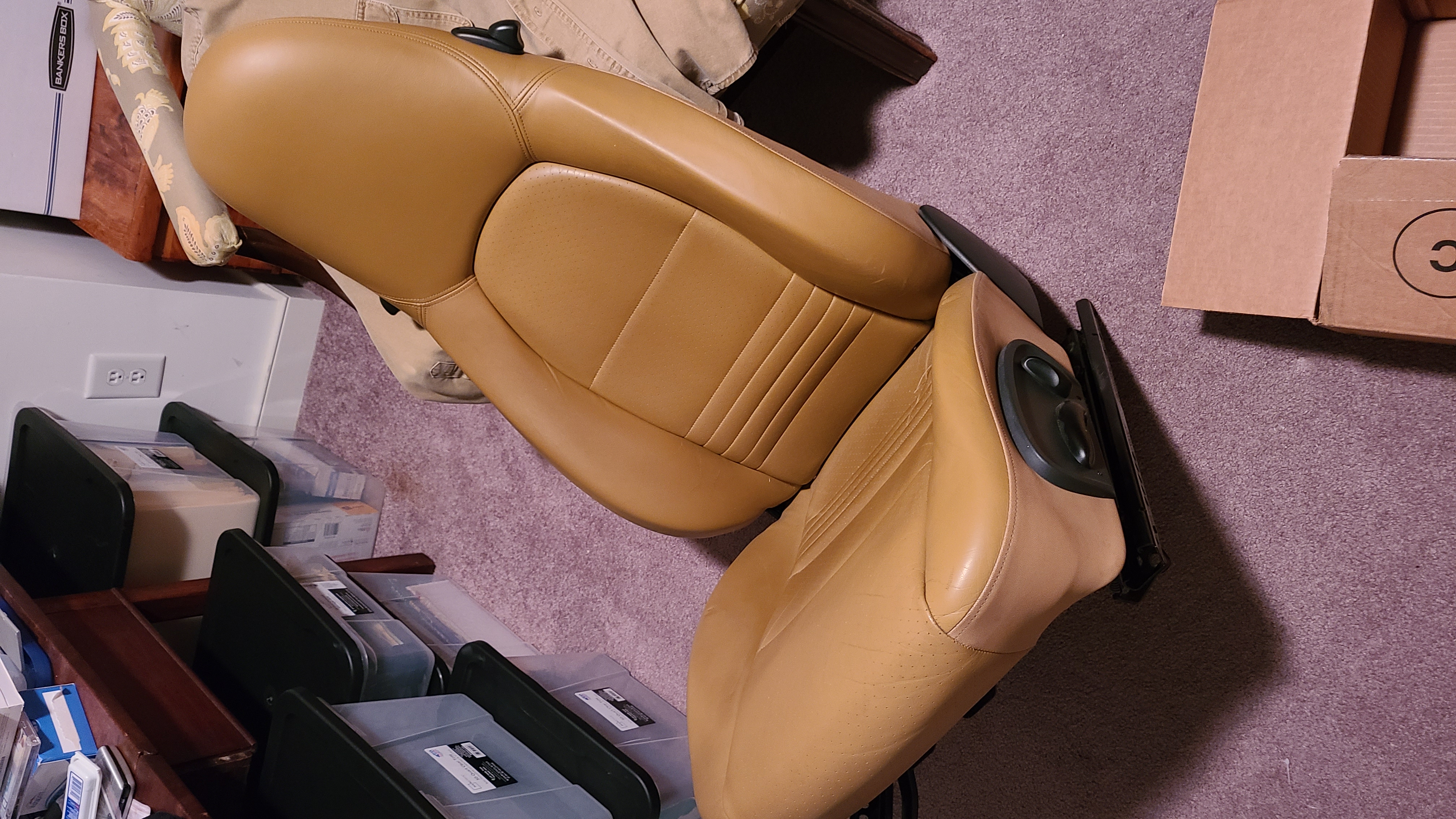

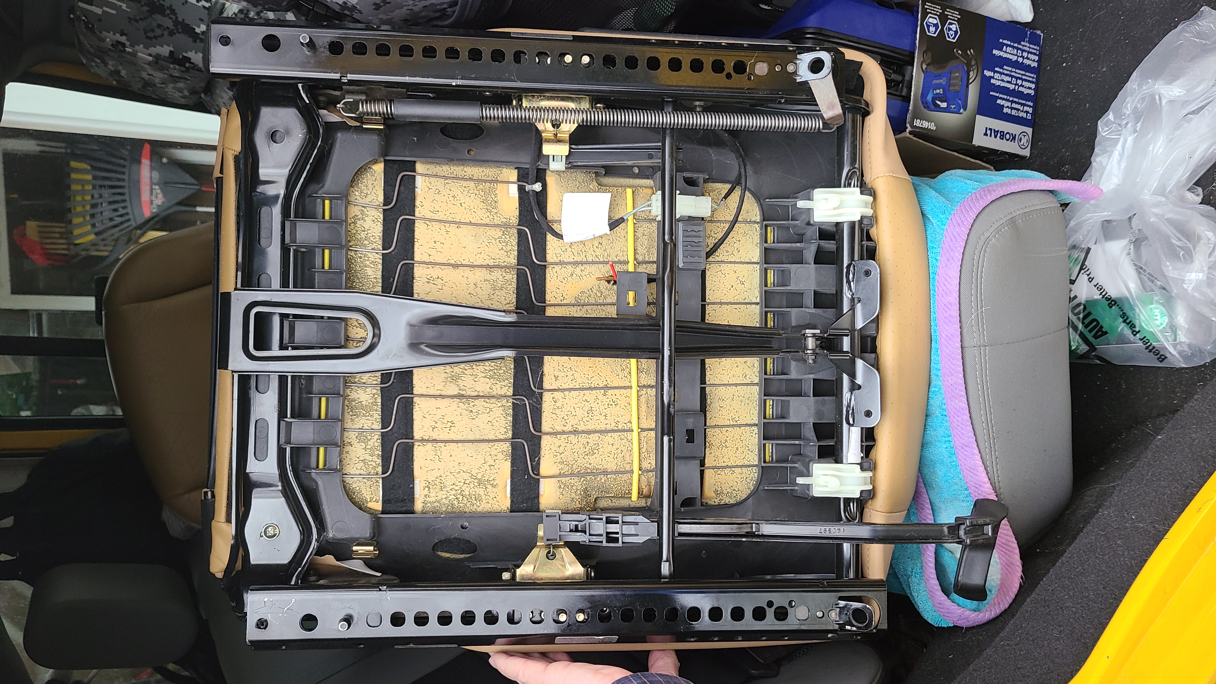

Hey there everyone,
I am currently rebuilding my motor (and upgrading a little) and working on improving the interior a bit. I got a great deal on some 1st gen Boxster seats that I'd love to use, but don't know how to tackle this. My current seats are pretty torn up and I would think upgrading to a newer, Porsche seat could be really cool. 1.) Has anyone swapped out for seats like this before? 2.) Is it worth the time/effort? I know these seats are heavier than the stockers... They are, however, much more comfortable and I plan to drive this a bunch. If/when I decide to do more autocross/track days, I will likely look to change to something lighter and safer. Thoughts? Help? |

mepstein Most production seats sit too high in a 914.
Measu... Feb 10 2021, 07:28 PM
bkrantz Might work if you are not too tall. Feb 10 2021, 08:35 PM
Krieger They are very heavy.... Feb 10 2021, 08:54 PM
horizontally-opposed As others have noted, probably going to sit you to... Feb 10 2021, 11:39 PM
Mikey914 Remember that it may interfere with the back pad t... Feb 10 2021, 11:44 PM
UkonCornelious Thanks for the input and considerations, guys... Feb 11 2021, 08:45 AM
mepstein Not cheap but very nice.
https://www.classiccars... Feb 11 2021, 08:51 AM
KSCarrera The biggest hassle I've found, along with the ... Feb 11 2021, 08:59 AM
