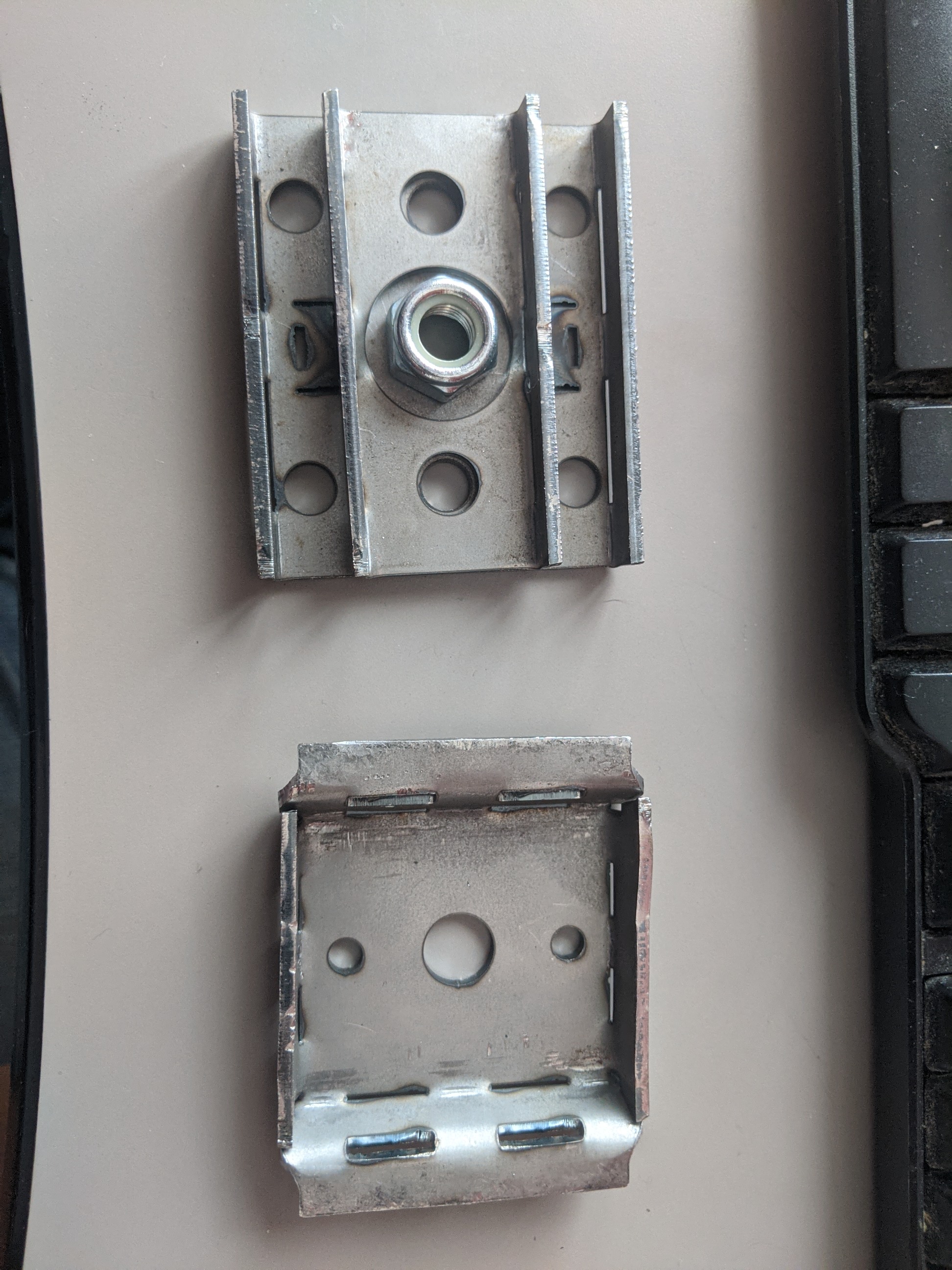

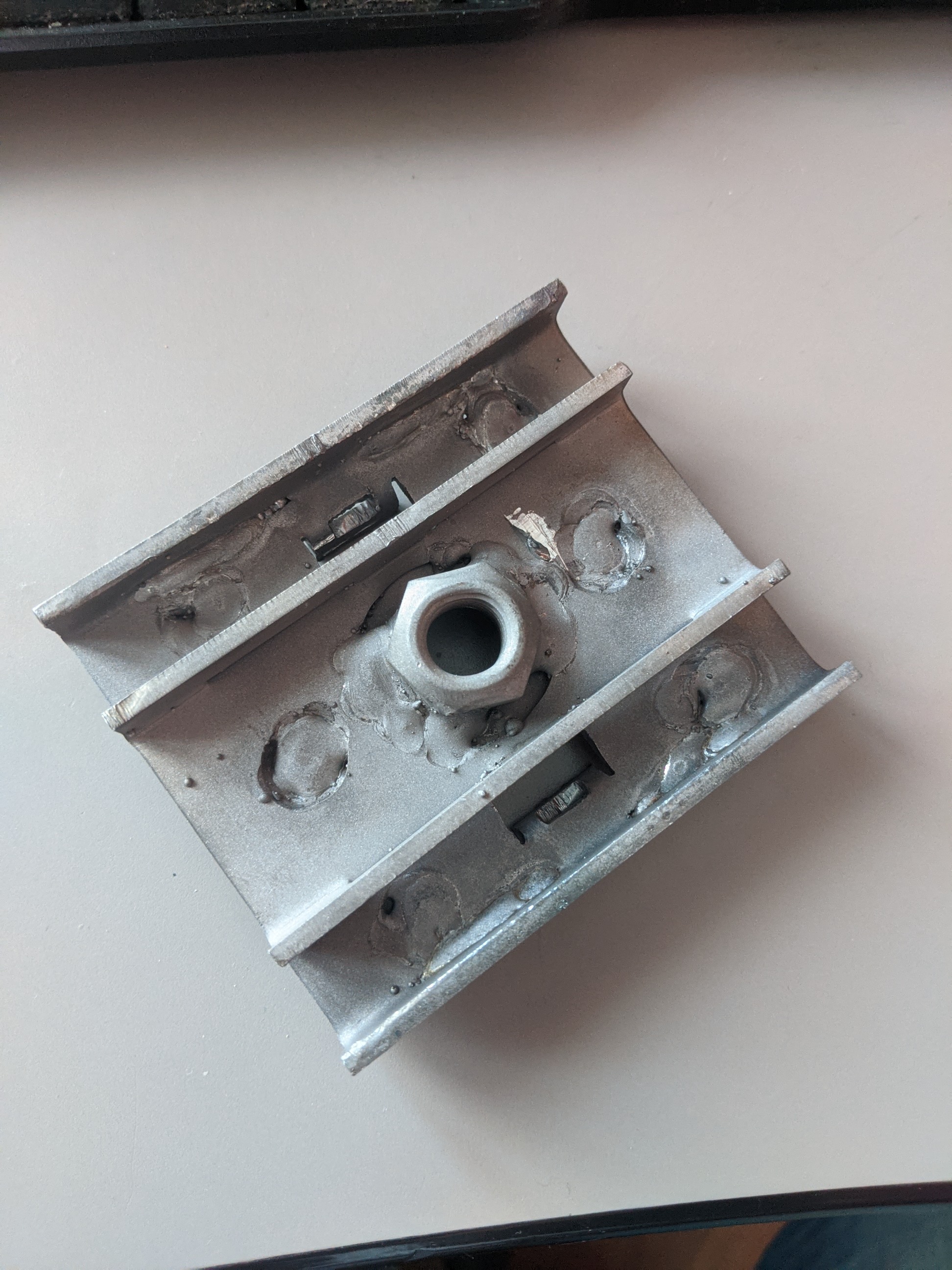

maddog
post Feb 19 2021, 04:05 PM
Post #45
Posts: 201
Joined: 19-May 03
From: Grand Rapids Michigan
Member No.: 710
got the blanks the other day, formed them up, just have to weld them now.

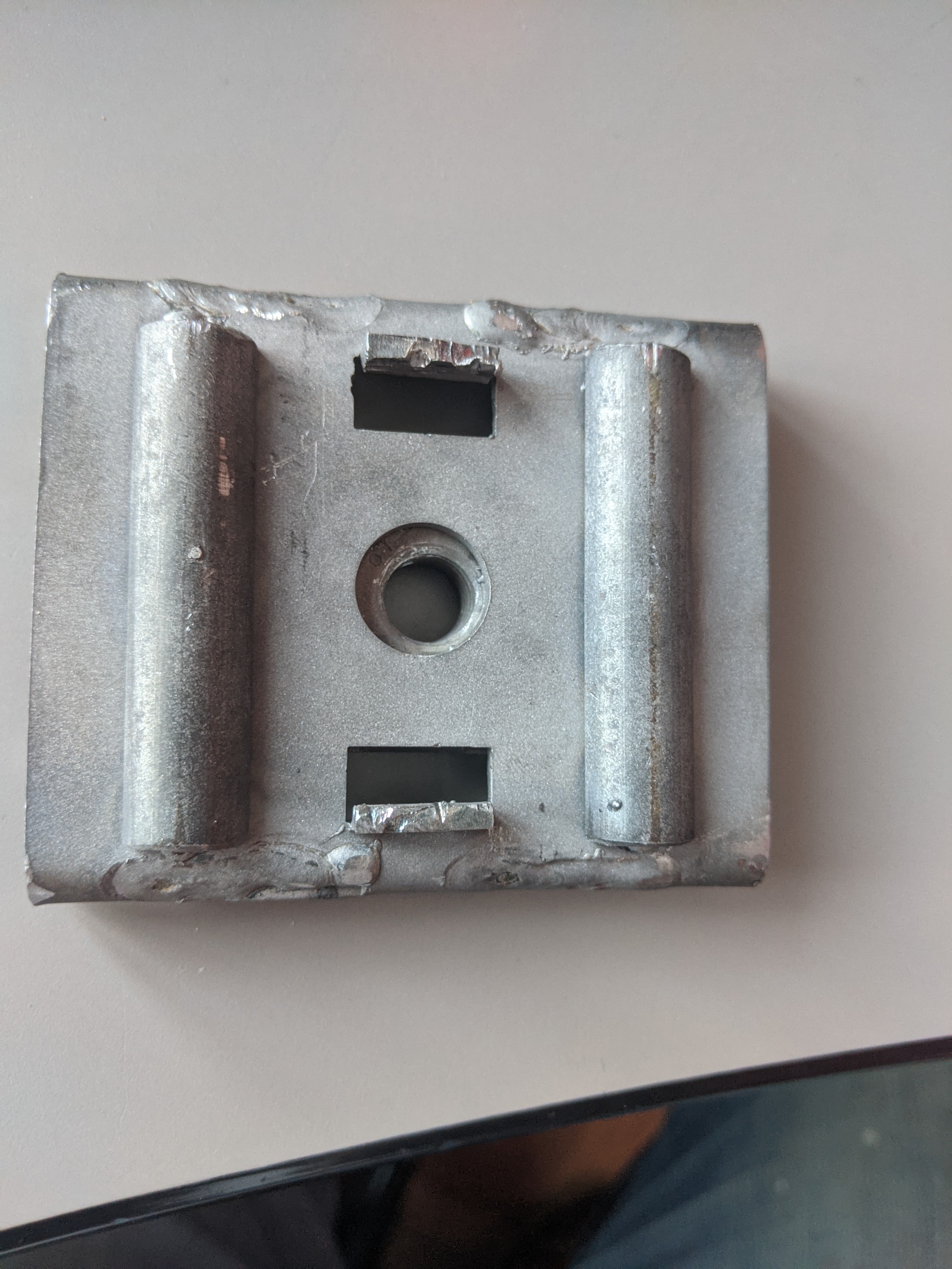

so not happy with how the first prototype turned out, I did a couple of changes and just ordered a new set of blanks

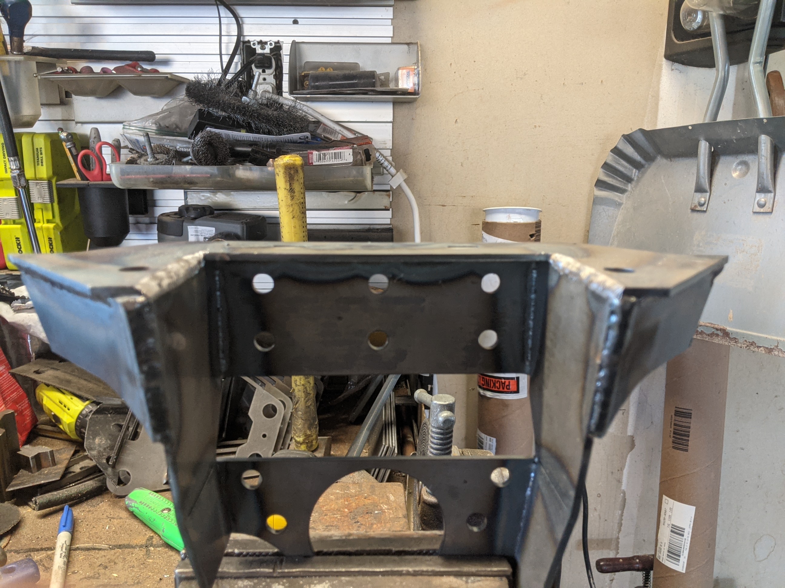

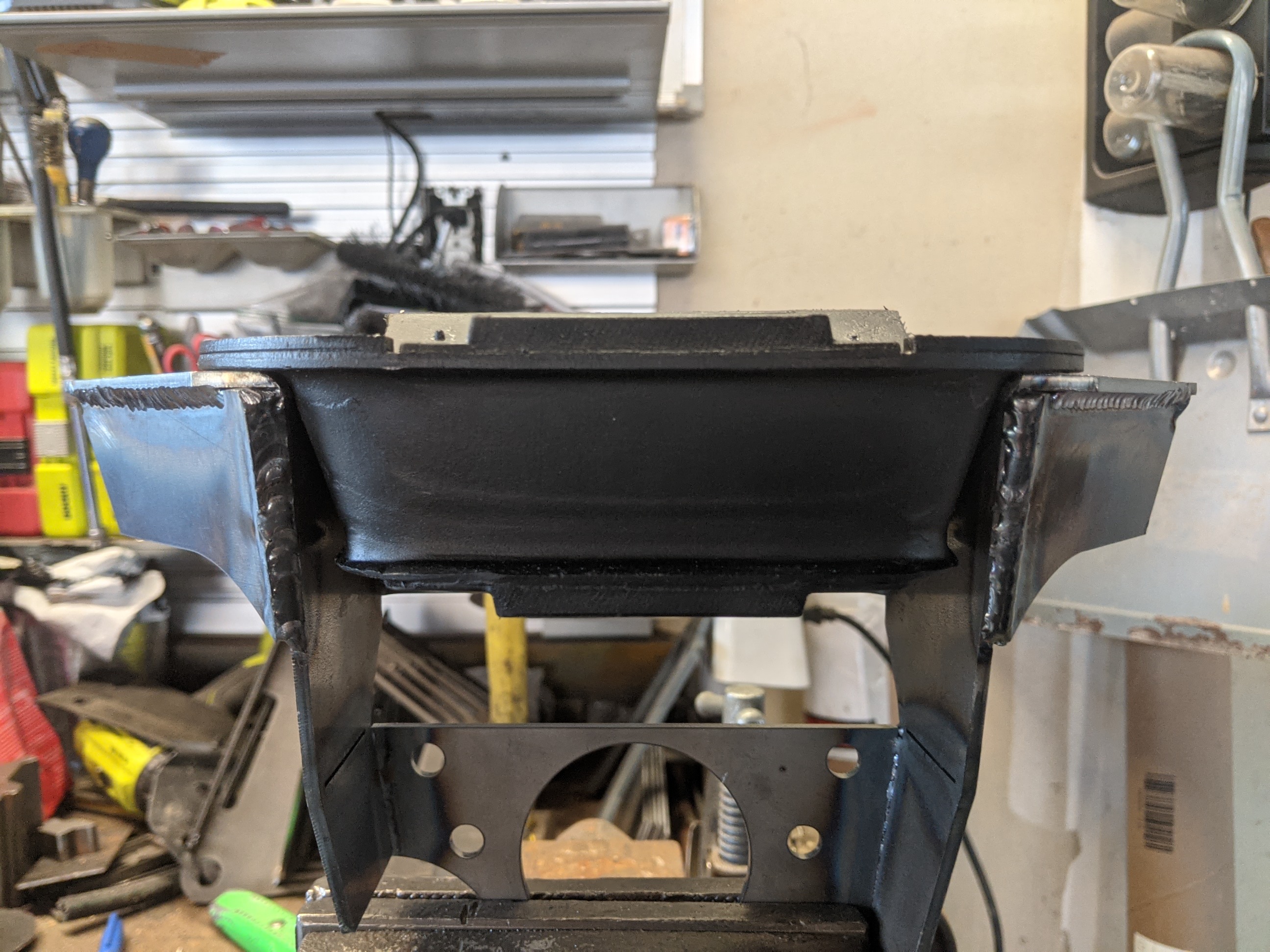

Update on OEM mount
Got the engine side back from powder coat. Looks great!
Yesterday I received the URO mount p/n 914 375 049 00 Appears to be nicely made.
Did a quick trial fit to put URO mount into the body side bracket . . . almost! (IMG:style_emoticons/default/idea.gif)
Not a big deal really, but the body side bracket will need a little clearnace work to properly fit the the radius of the URO isolator can.
I want to be really clear - I don't see this as reflecting poorly on the Mad Dog mount or the URO isolator.
When you're doing these sorts of conversions with hand made parts, a little finessing is part of the game. Knowing many will likely use the Wevo mount, it wouldn't even be an issue. The isolator holes line up perfectly though! Great job making allowance for use of the OEM style isolator!
Likewise, there could be minor difference in the URO isolator can vs. the 914/6 mount isolator that Mad Dog built his orignal prototype to. Again, I'm just very glad URO is reproducing the 914/6 mount that was NLA for quite a while.
Mock ups and trial fitting are all part of the game. Just wanted to post my situation and prep others for need to do a little fitting to make it all work.

@Hawk , we are in a similar boat, but I have welded the mount to the chassis "assuming" everything would fit! The URO mount arrived the other day and I am seeing the same interference. The answer: Wevo mount, shim the URO mount, grind a portion of the mount, ... I am hoping for a straightforward solution.
Such is the conversion

Superhawk996
post Feb 27 2021, 03:12 PM
Post #56
Posts: 8,134
Joined: 25-August 18
From: Woods of N. Idaho
Member No.: 22,428
@930cabman
Oh man, that was beyond simple.
All I had to do was radius the corners a bit, took a smidge off the back side, and leveled a weld bead. 36 grit on a 2" disk and it was done in like 15 minutes.
No modification done to the URO isolator.
Fits perfectly now. (IMG:style_emoticons/default/piratenanner.gif)

Hi guys, Hawk is right about the URO mount interference. I had Luke check his OEM mount fitup and it was the same. Hawk has the best solution for anyone that already has the mount, just get a grinder and put a nice 4-5mm radius on the two edges and the URO mount will drop right in. Dont worry about removing that little bit of material to get the radius because there is a nice fillet weld behind the wall. I did one in my bench vise and it only took minutes like Hawk said.
