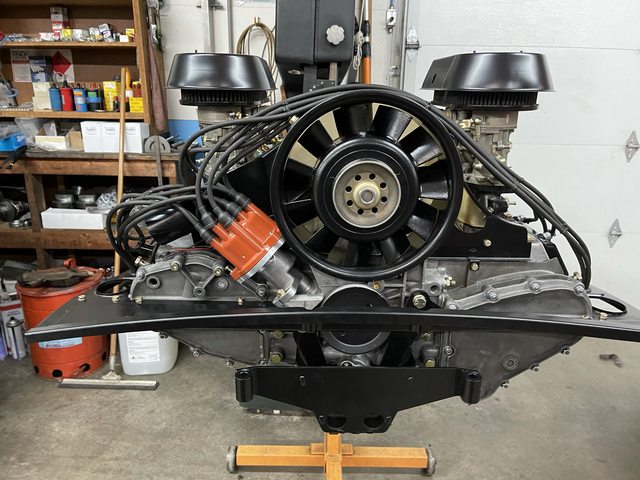

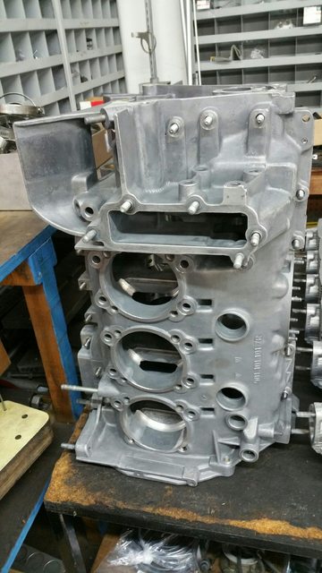

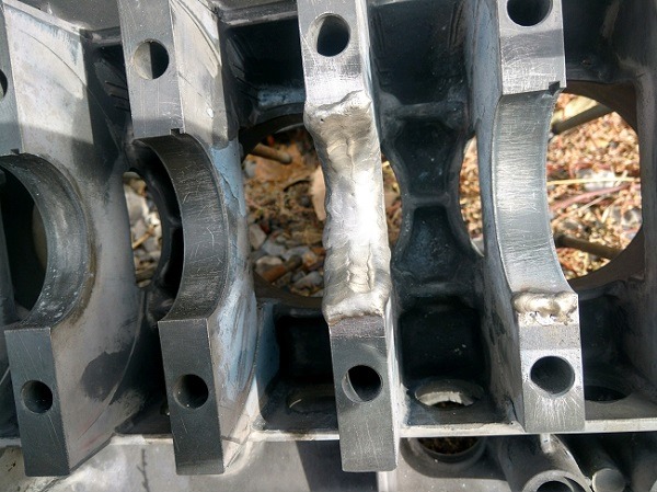

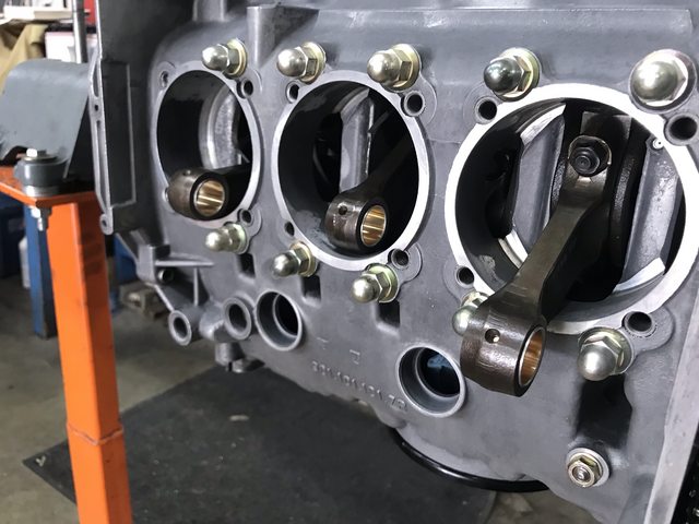

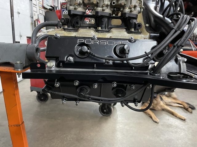

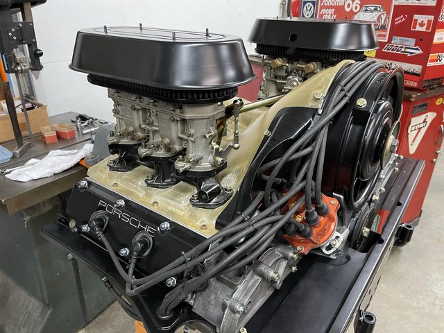

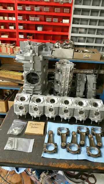

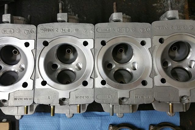

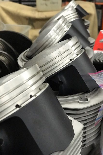

My Ollie’s bill was closer to $4k for my 2.7, and it got all the works including oil bypass, decking, inserts, and a twin plug conversion. Running it with a Solex cam and Webers. The 2.7s are wonderful engines when built, as the make more HP than my stock 3.2 with a Steve Wong chip. I think their bad rap is due to the emissions crap which retained excessive heat and caused the warping. Shops would just torque down the heads and covers making things worse.
My 3.2 is sure fun with all the torque but the sound and performance of a 2.7 - can’t wait. Plus it looks way sexier than my 3.2.
