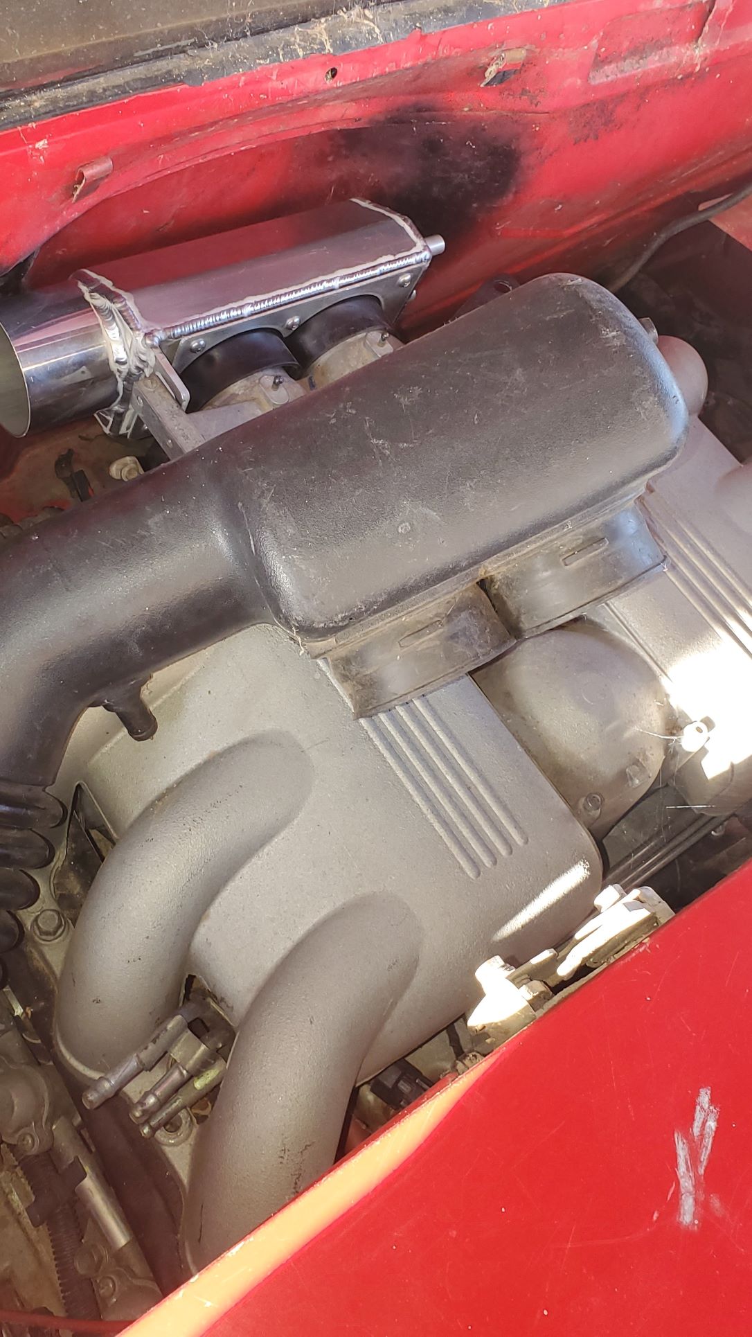

this is the new intake, smaller than stk but not by much,..will it perform the same ?? Thanks Attached Image
flmont
post Oct 9 2021, 09:17 PM
Post #30
Posts: 881
Joined: 21-October 08
From: Tucson,Az
Member No.: 9,676
This solves a lot of issues if it works as intended

That’ll work great Frank. Is that from Rocky Mountain Westy or did you make that?
flmont
post Oct 10 2021, 05:20 PM
Post #32
Posts: 881
From: Tucson,Az
Member No.: 9,676
Yes,.. it is from Rocky Mtn westy,.I check that site every so often and even when I spoke with them a year back they said they were NOT making anymore,I for some reason went back to that site and they had it listed and I was very surprised,so I bought it to make sure I covered all my options,they have 3 left as of last Tuesday !!
Thanks,I'am very glad to hear you say it will work..! I was a bit nervous on buying it because I have to cut off a tab on one end and I didnt want to cut anything until I Hopefully heard from you..Thanks so much for checking in !! ..Frank
