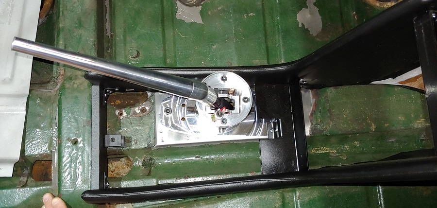

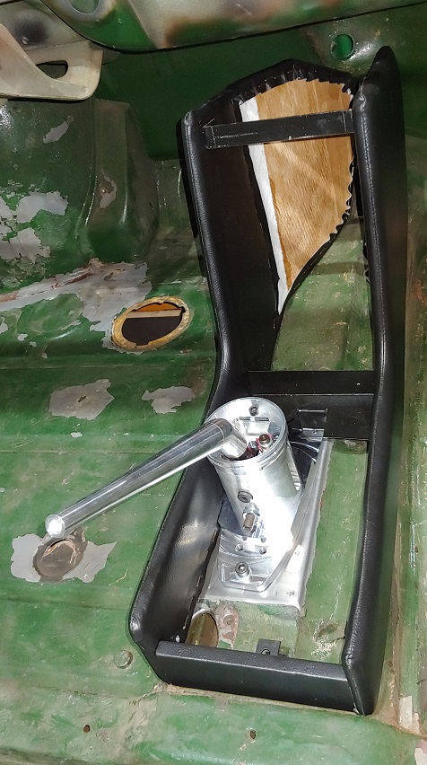

So while I wait on some sheet metal to come in I've been working on some interior stuff.

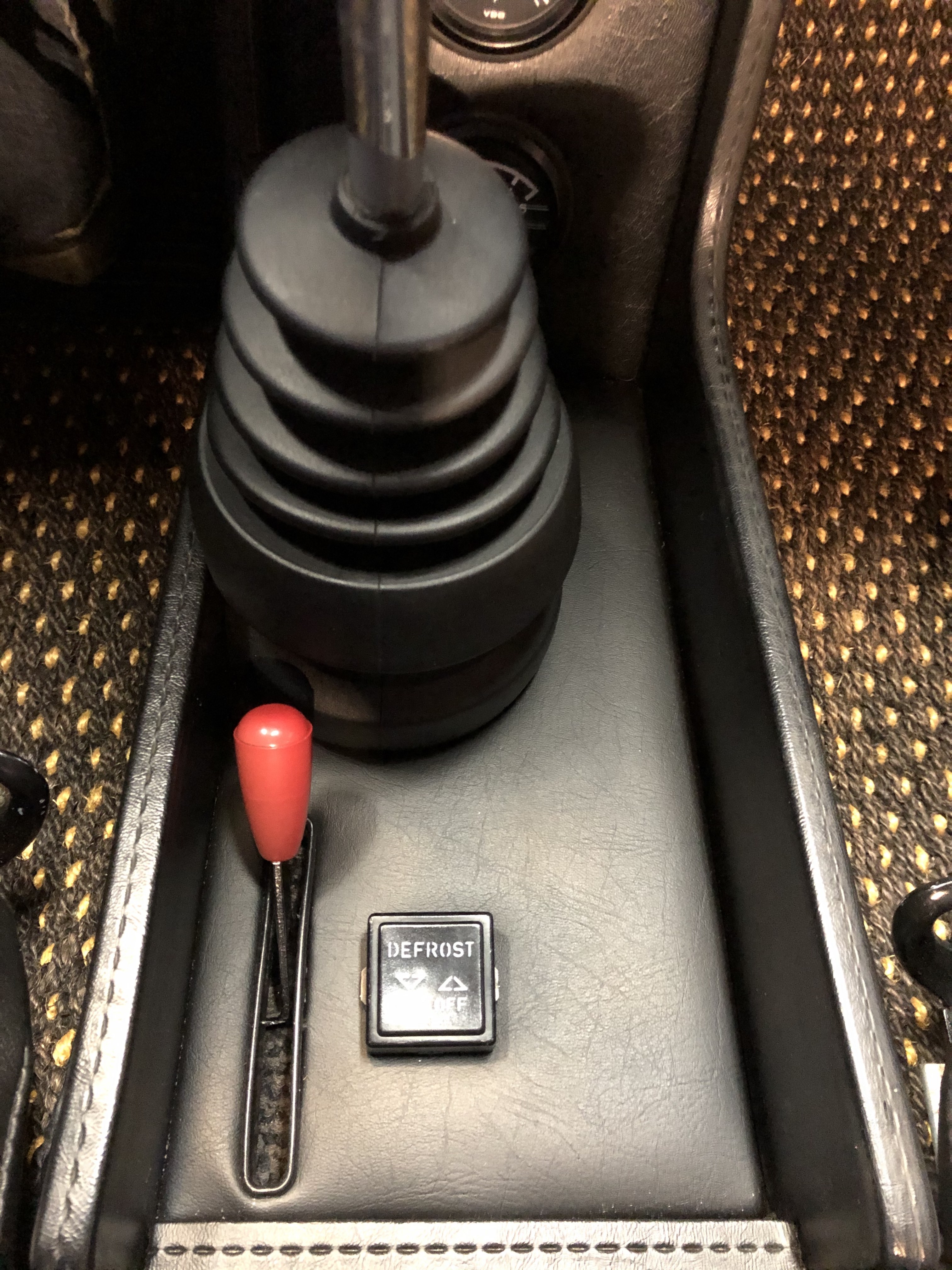

I'm going to run a RennShifter with a center console. I do not like the shifter boot supplied. It looks like a cv joint boot to me. I'm thinking of a leather boot for it. Anyone running the above setup that can post a few pics and where you may have gotten the boot from?

It is a CV boot (IMG:style_emoticons/default/laugh.gif)

QUOTE(Mark Henry @ Feb 23 2021, 12:15 PM) *
Just take an old leather boot and the rennshifter to an upholstery shop, tell them to make you something as close as possible.
You want leather, I think the AP shift boot is the only interior 914 item that's real leather.
I was thinking if there was one from another vehicle that someone retro fitted.
I could always take it to an upholstery shop but wanted to see what else was available first.

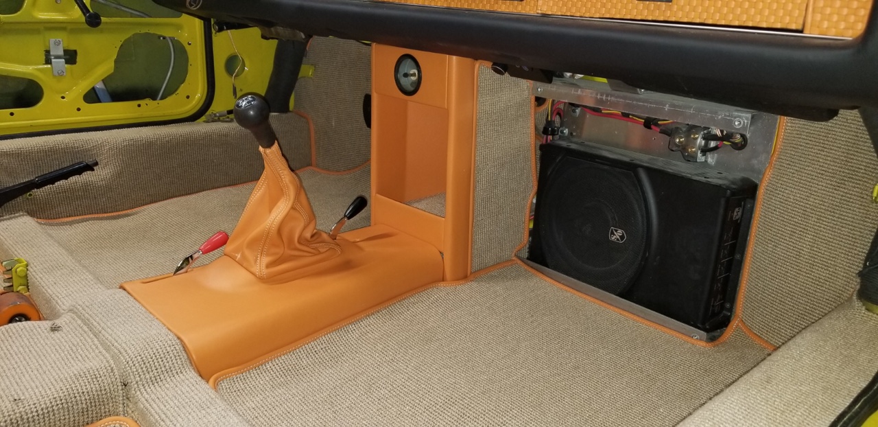

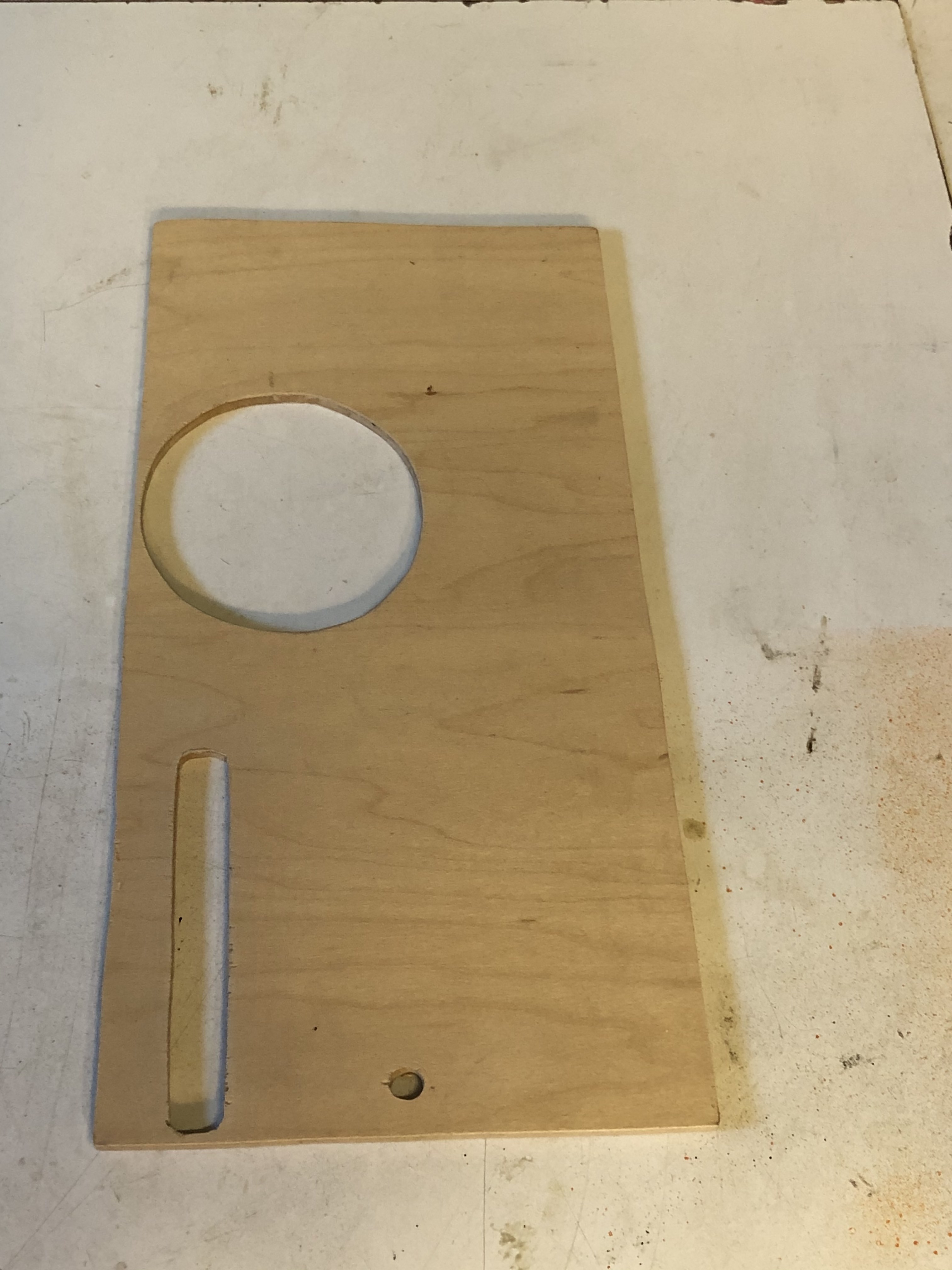

i also have a center console with a Rennshift, and although it was fairly tricky, i was able to solve this problem last fall. you will have to build a customized bottom panel. here's how i did it.
first, i used a 911 SC-style boot — much better appearance, and they can be affixed to the underside of the panel as a final step, similar to how the factory 914 center console shift boot is attached.
to build the panel, i made several iterations using foam core panels at first. then i used the most accurate of these templates to trace and cut a version out of 1/4" plywood, and iterated a couple times on that. if you intend to cover it with thin foam + vinyl as i did, remember to account for the extra thickness. i found the install to be pretty tricky due to how close the larger diameter shifter body is to the inside of the left console panel. it's TIGHT in there. i will get some pictures for you.

QUOTE(Luke M @ Feb 23 2021, 10:35 AM) *
TIA,
sorry for the delay. here's a shot of the template, and the finished installed panel. it was extremely tricky to get right, and i'm about 95% happy with it. getting the panel in and out requires some careful prying of the console left panel, plus plenty of cajoling and the use of not a few colorful metaphors.
I ran into the same issue getting the template on/off.
I'm gonna go with a leather shift boot now that I see yours installed with the center console. Thanks for adding the pics.
