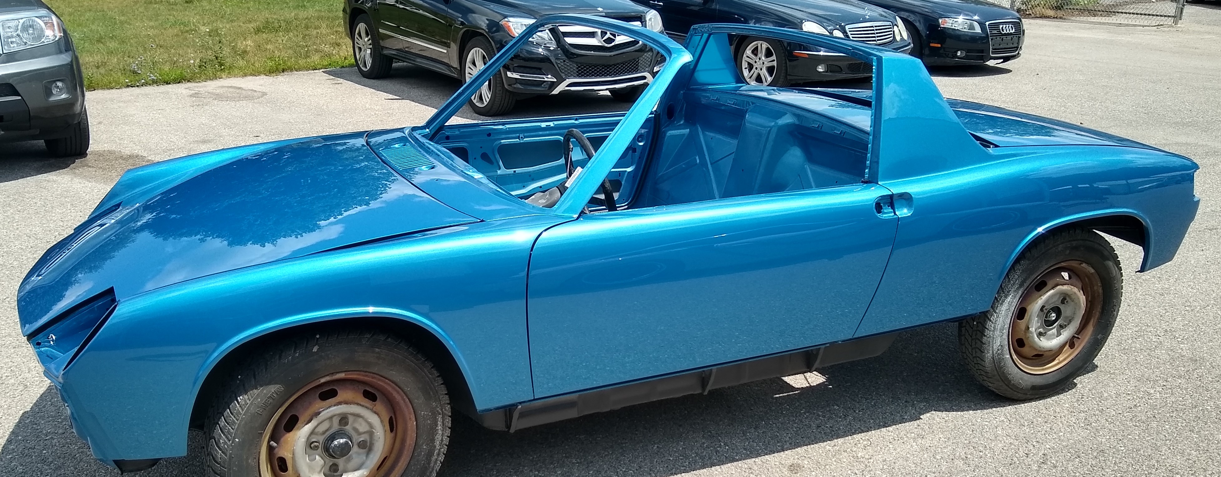

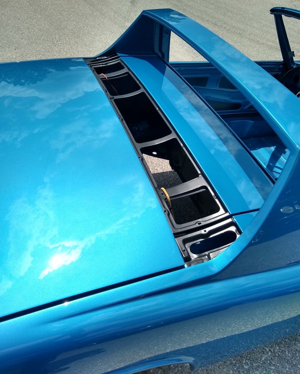

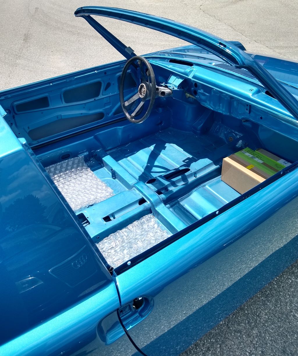

GeorgeKopf
post Jul 21 2024, 08:46 PM
Post #38
Posts: 270
Joined: 9-February 21
From: Princeton, NJ
Member No.: 25,186
Brought home the finished chassis this past weekend. I couldn't be happier with the results.
