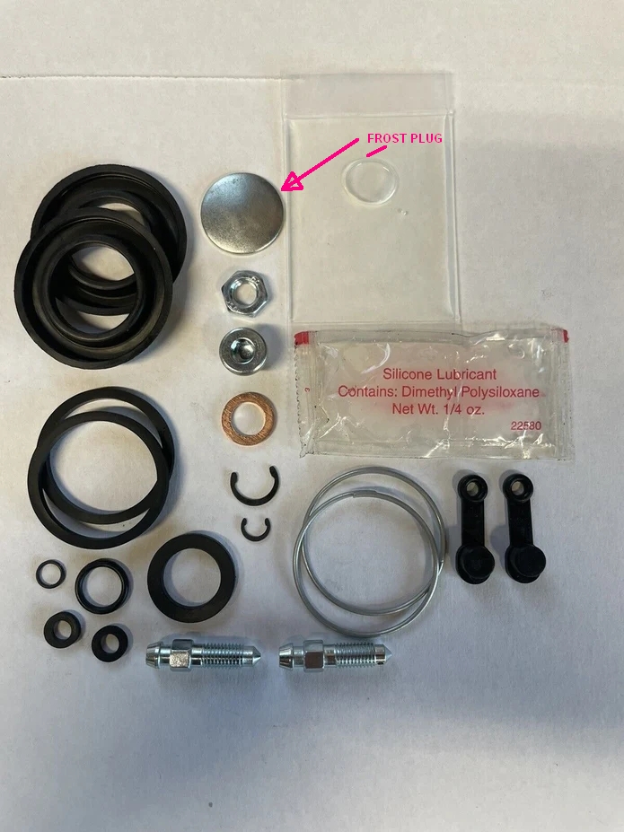

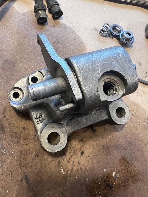

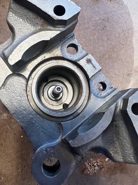

Okay, I could use a bit of help, please...
I've spent the last couple of days with Covid in the garage disassembling and cleaning brakes. Can anyone enlighten me as to how I remove the parking brake lever assembly? I thought that the spring, hat, and circlip within the caliper body might somehow be retaining it, but I've removed those. The lever, while turning freely, still won't slide out of its bore....

If you have removed the clip in the groove at the bottom of the bore, then the threaded adjuster shaft can be pulled out; It is packed with grease, so it takes a bit of force.
To remove the parking brake lever, first acquire the correct rebuild kit with the frost plug. You have to cut the frost plug, and twist it out with significant force. Then remove the clip holding the shaft in place. Some sources supply an O-ring to replace the original seal. That helps, but I also use a garden hose flat ring just under the lever arm; some fit better than others, and some are up to the heat while others may not be.

Never mind, thanks. I just found the tech article on the Pelican site...

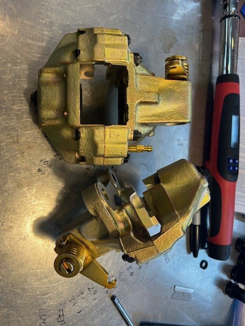

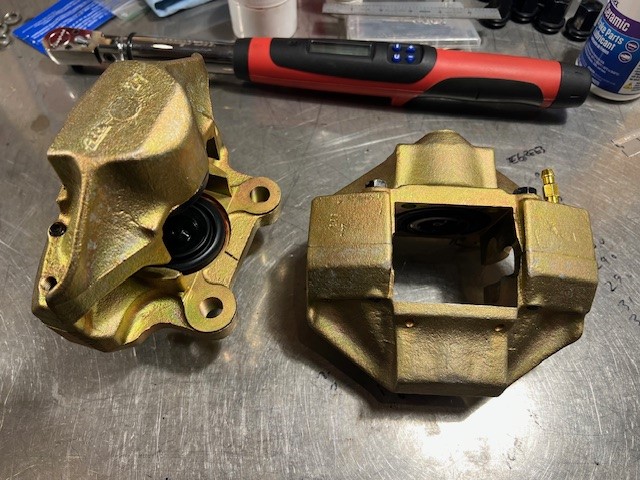

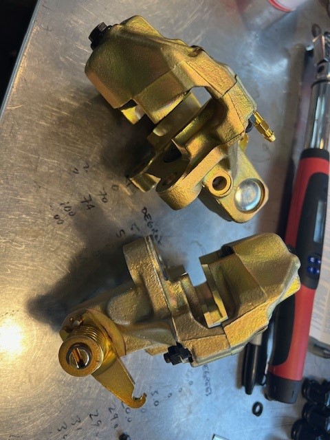

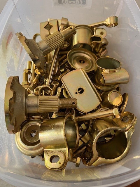

I did get the rears, fronts, and balance valve all disassembled. My hope was to get everything rebuilt over Christmas holiday, but I had some challenges getting everything plated. In the end, the fourth plater I tried got the job done, but I didn't get the parts back until last week. They do, however, look great, and I'm happy to have found a reliable source to plate castings.
The fronts and balance valve are all rebuilt. Rears are next.

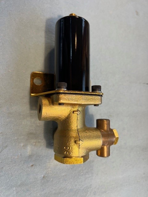

Did you rebuild the rear proportioning valve yourself?
If so, how did you set the adjustment?
Nice plating there!
Beautiful!
Jewelry for car folk...
worn

@techniclaninja, I have not yet set the proportioning valve. I'm going to have to cross that bridge at a later date. I've got 911S calipers for the front of this thing. The decision on tackling a 911 rear brake set-up has yet to be made. In any case, I figured I'd have to play with the proportioning valve, otherwise I might have left well enough alone.
technicalninja
post Feb 12 2025, 11:37 AM
Post #36
Posts: 2,531
Joined: 31-January 23
From: Granbury Texas
Member No.: 27,135
QUOTE(Detroit @ Feb 12 2025, 06:04 AM) *
Thanks for the compliments, fellas.
The easy button for correctly sized rears is the 914-6 repops that PMB offers.
$1000 for a pair, no core charge!
Correct ratio to your S fronts.
Keeps the original E-brake stuff...
Available with spacers for vented rotors!
That valve is not exactly a proportioning valve and cannot be "tuned" like a normal valve.
That pup reaches a specific pressure and then actuates a pressure regulator cutting pressure to the rear. Even Eric @ PMB calls it a "regulator" and not a proportioning valve.
IMO you need a hydraulic test bed to set activation pressure. It looks "touchy" enough that I've decided to let PMB rebuild my valve instead of doing it myself.

I found some time this weekend, after a week in Florida, to get the rear calipers back together. Another box checked.

Works of art. (IMG:style_emoticons/default/beerchug.gif)
