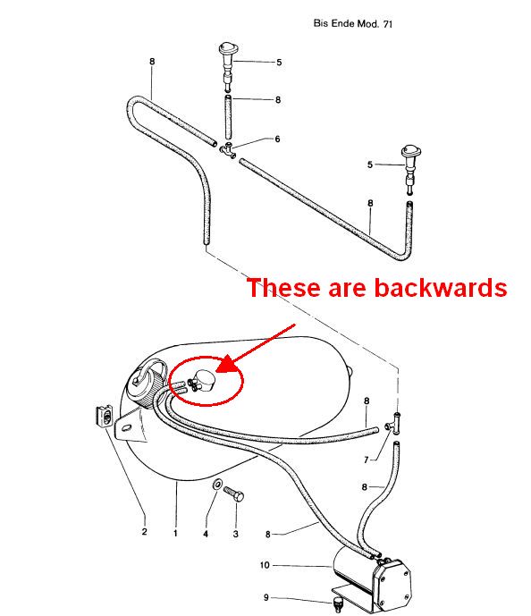

Needed to put in new hoses and such. I copied this diagram from the PET.
I found there was one problem. For the connector on the top, only one
outlet has the hose going down into the fluid, and it is not the one that is
connected to the suction port of the pump.
