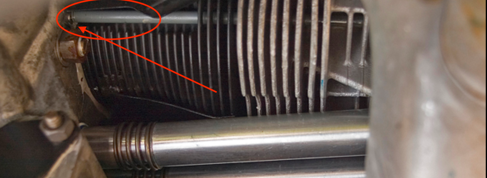

Engine rebuild has not gone as smooth as I had hoped.
I am dropping the engine again to figure out the source of my leaks.
I have drips coming from a couple of the tube on the passenger side under the oil cooler.
Tough to tell if it's the cooler or the tubes.
Cylinder 3 is giving me the most concern.
It almost looks like one of the four cylinder studs is leaking oil.
I can't tell exactly as it could be the actual mating surface of the cylinder and the block.
Anyway I am dropping the motor to track these down.
Has anyone else come across oil leaking out of a stud or is this just the cylinder and engine mating surface leaking?
If it is how have any of you remedied this?
Is there a bullet proof sealant that others have used to stop this?
Attached is an image I borrowed online that shows the location of where I see oil coming from.
Thanks for sharing as always.

Mark Henry   Where's the underside cooling tin? What did y...   Apr 28 2021, 02:27 PM

Wew   Hi Mark, I removed the tin to see the leaks. I u...   Apr 28 2021, 03:08 PM

Mark Henry   So you took the pushrod tubes out to remove the ti...   Apr 28 2021, 04:42 PM
Wew   ahh... That is a photo I borrowed from another us...   Apr 28 2021, 04:46 PM
Mark Henry   Okay as long as you have those tins, your engine a...   Apr 28 2021, 06:32 PM
