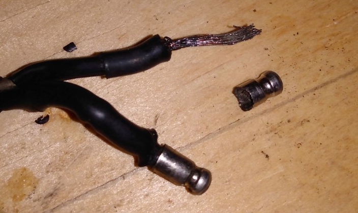

Anyone have a source for these connectors for the back up light switch on the transmission, or an alternative? Thanks.Attached Image

Part number 99965210210
Stoddard
Auto Atlanta
Pelican
Maltese Falcon

Try and get a donor cable (transmission end), and put back together into your frayed end. But you could actually save yours with a little TLC and use a solder-gun, a bit of shrink tube...as you already have the specific male ends. These ends readily push into the Rev-light switch (use a tiny screwdriver), and sit in the switch snug. Get crafty with a small rubber dust boot (Grainger or McMaster) and done.
@Garoldshaffer or @Bdstone914 might have the cable end. (IMG:style_emoticons/default/smile.gif)

Thanks for the replies. Found them on Pelican Parts

Belmetric carries better German made ones with a double crimp. On crimp around the insulation and one around the bare wire.
