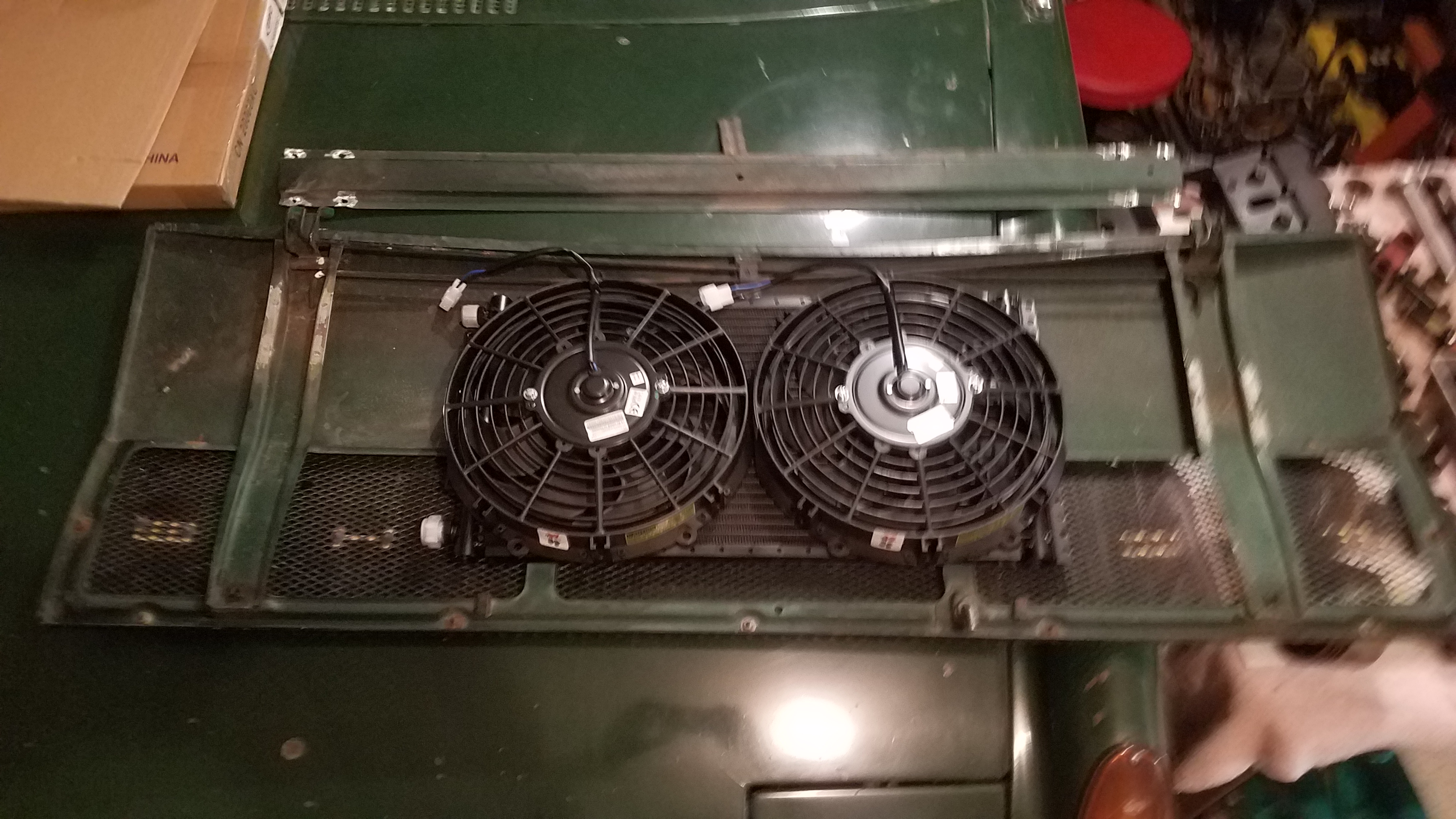

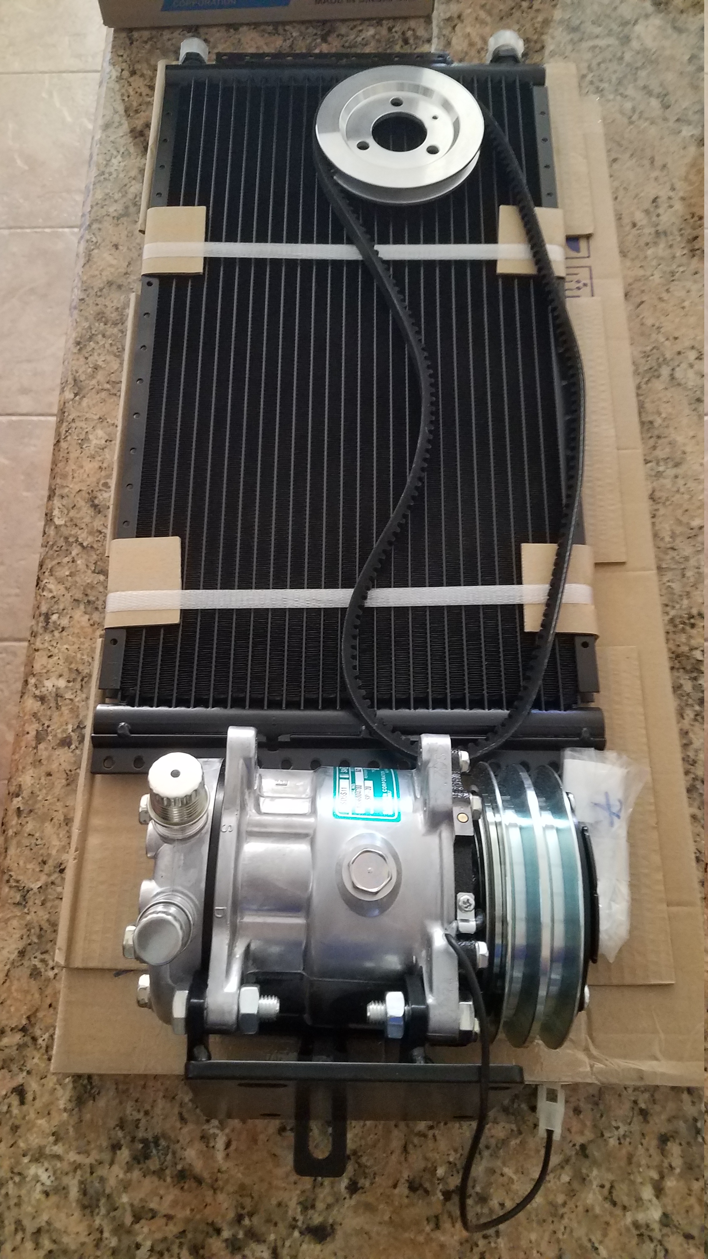

With the advances in modern compressors, condensers, and fans I decided to try an installation with the condenser mounted to the underside of a GT style engine lid.
In addition to the original style under dash evaporator, I am using a Sanden sd5h11 6333 compressor. It is the modern equivalent of the SD507 and is designed to use R-134a. I will be mounting it to the passenger side of the engine with amount plate I got from Gilmore Enterprises out of Las Vegas. Their website (gilmore-enterprises.net) doesn't list parts for the 914 or any individual parts but Ed, the owner is super easy to deal with. I called him up, told him what I was looking for, and it was on the truck heading out to me later that day.
I picked a universal fit parallel flow 11" X 21" condenser and 2 high flow, low profile 10" fans and a drier with a trinary switch.

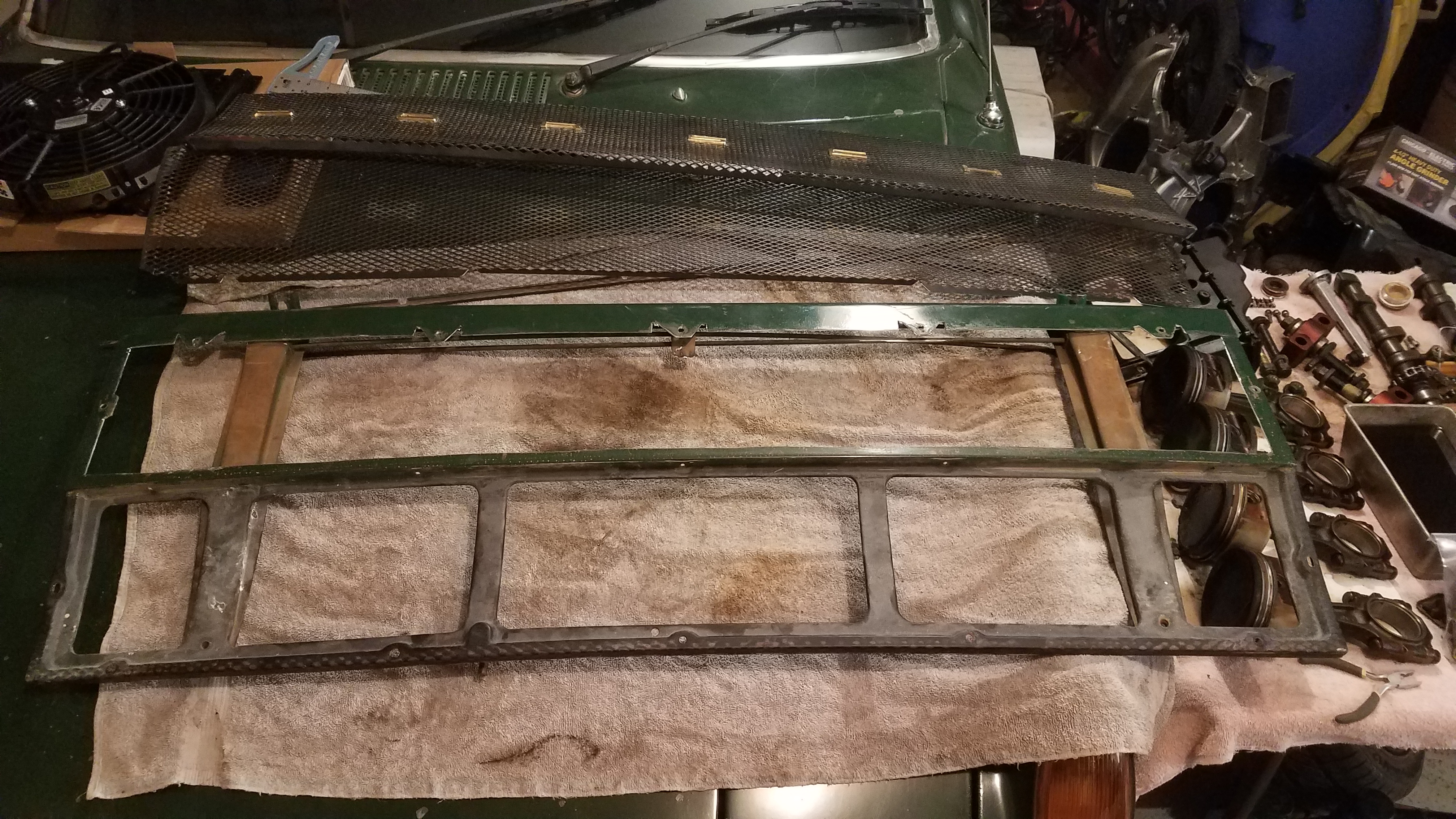

Working on the lid.

The only other part that I am hacking up is the engine lid and I'm trying to get that right as well. I started on it tonight and I still have a bunch of shaping and fitting to do before it's done. I like the GT lids anyway so it's possible I might have done this with or without the AC system.

I will have a couple small holes in the body to run the lines into the cabin for the evaporator. I'll be using the newer reduced diameter hose to keep the holes as small as possible.
The lid still has a long way to go.

From experience, and from working with my father (he designed automotive AC systems), you need a bigger condenser. That one is too small, especially if you are running 134A.

I wonder if the warm air of the condenser will affect engine temps. Good call on the rotary compressor. Much more efficient, smoother and draws less HP from the engine. (IMG:style_emoticons/default/agree.gif) with Clay. The condenser determines how cold it blows. If you find it isn't enough look at Keith's - aka @914toy - additional condensers that he added to the rear wheel wells.

The condenser size is one of my guess-timates. (IMG:style_emoticons/default/confused24.gif)
11 X 21 is bigger than the condenser in my 944 Cab and it has no trouble keeping up with the Phoenix heat using 134A.
If it does not keep up, I have enough space to fit a much bigger condenser under the engine lid and universal fit condensers are surprisingly affordable. Although, a bigger condenser will require bigger fans and then it all starts to add up.

Airflow over the condenser is one of the biggest questions I have running through my head.
The first part of that question is what direction does the air go through the engine lid? Is cool air flowing down through the lid into the engine compartment or is hot air flowing up out of the engine compartment?
I don't want my fans to be fighting against the normal flow of air.
If the normal flow is down, I wonder the same thing you asked, will the heat from the condenser effect engine temps?
If the normal flow is up, will the hot air from the engine effect the efficiency of the condenser?
Does the flow change depending if the car is moving or sitting still and how much effect does vehicle speed have on air flow?
If my car was running, I'd attach some string to the engine lid grill, point a go-pro at it and take a drive. That is hard to do when it is up on jackstands with the engine and transmission out of the car.
Does anyone with a GT style lid have a go-pro, some string, and some time??? (IMG:style_emoticons/default/idea.gif)

Use bulkhead fittings into the cab & thru sheetmetal.
The rest of the design is fine.

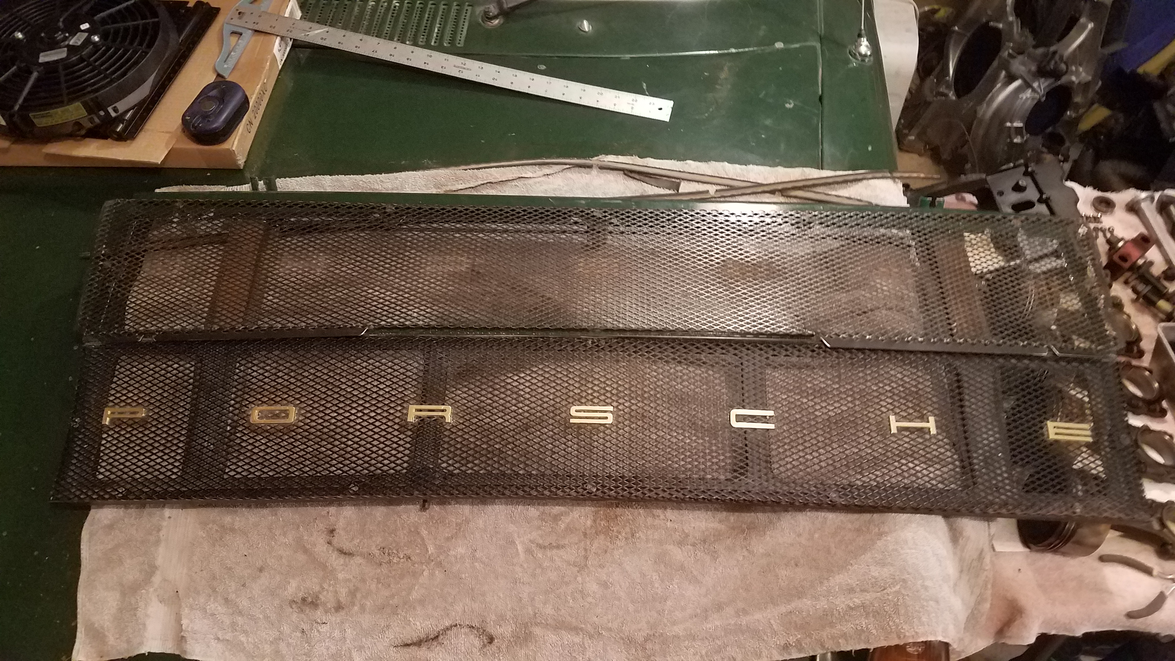

The grill is way bigger than the slit provided with the rain tray installed.

With R-134a I had to add an additional condenser from a 911 SC under the engine lid on Betty's 914. It was run in series with the existing dealer installed DPD condenser in the front trunk. I put two fans on the engine mounted condenser, and a larger fan on the condenser in the front trunk. That made it get really cold inside on a Texas summer day.
The Condenser to Evaporator size ratio and the compressor efficiency is what you have to calculate to get the AC cold. In doing the one on my red car, I am using a modern 16 x 12 condenser in the front trunk. with the added efficiency, it should be able to keep up with the heat load. I am probably going to add a second 16 x4 condenser in series mounted in the exhaust side of the front trunk opening. Air will flow through the big condenser, and then exit out through the little one. If I pass the refrigerant through the little one first, the condenser will be hotter than the air passing through it, and it will drop the refrigerant temp before it gets to the big condenser. That will make it more efficient.
I will put bulkhead fittings on my list of things to buy. Thanks for the tip.
What is this "rain" tray thing? What is "rain"??? We don't get that here. (IMG:style_emoticons/default/stirthepot.gif)

Are you using old tube and fin condensers or newer parallel flow condensers on Betty's car?
"Size ratio"?????, wait, there is math involved, I am so screwed!! (IMG:style_emoticons/default/headbang.gif)
Your series condenser plan 16X4 > 16X11 gives you 25 sq/inches more area than my single condenser
I admit, I was just winging this based on a few threads and other documentation I picked up along the way.
Some of those docs talked about the greater efficiency of the newer parallel flow condensers and newer compressors. I was thinking that would be enough to get me to my goal of cold AC. Now I've got to research size ratios.
My current plan is to use the under dash evaporator from an original dealer installed AC system. I have that stored in my parts stash. I guess I need to find out the size of the evaporator. What is the size ratio I should be shooting for?

With Betty's car, we were using the original dealer installed tube and fin condenser and evaporator. So we had to add a second condenser to make up for the losses of the 134a. With my car, I will be using new parallel flow condensers, and a parallel flow evaporator core.
I would have to look up the maths needed to figure this out. My dad knew them from memory. But he used them all the time when he was working. We worked out the required evaporator and condenser sizes for my car before he passsed. I am adding the second small condenser as a "fudge factor" to insure it is cold.
Also, the parallel flow condensers are thinner than the same size tube and fin units. So the box in the front trunk will be shorter. (IMG:style_emoticons/default/piratenanner.gif)
