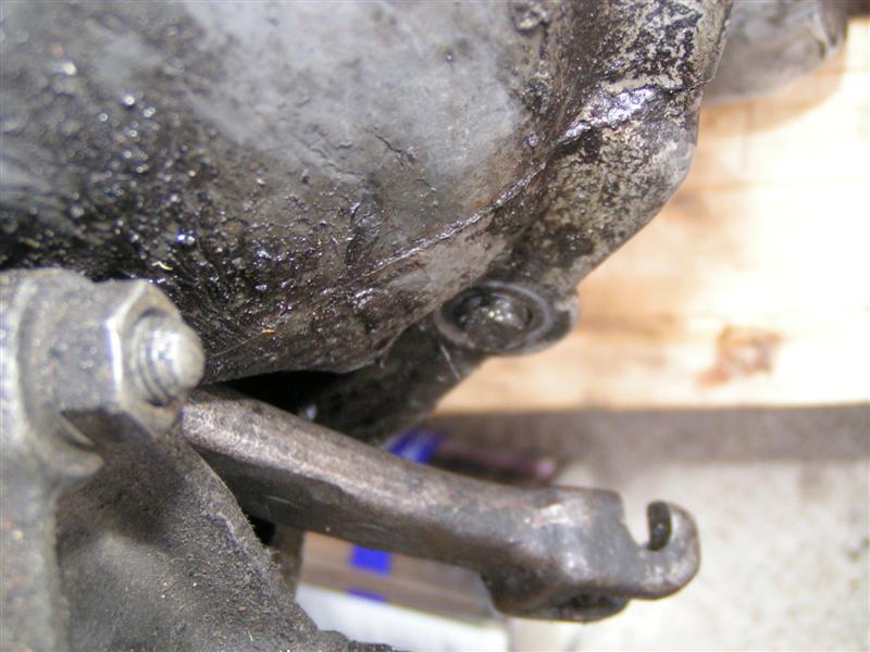

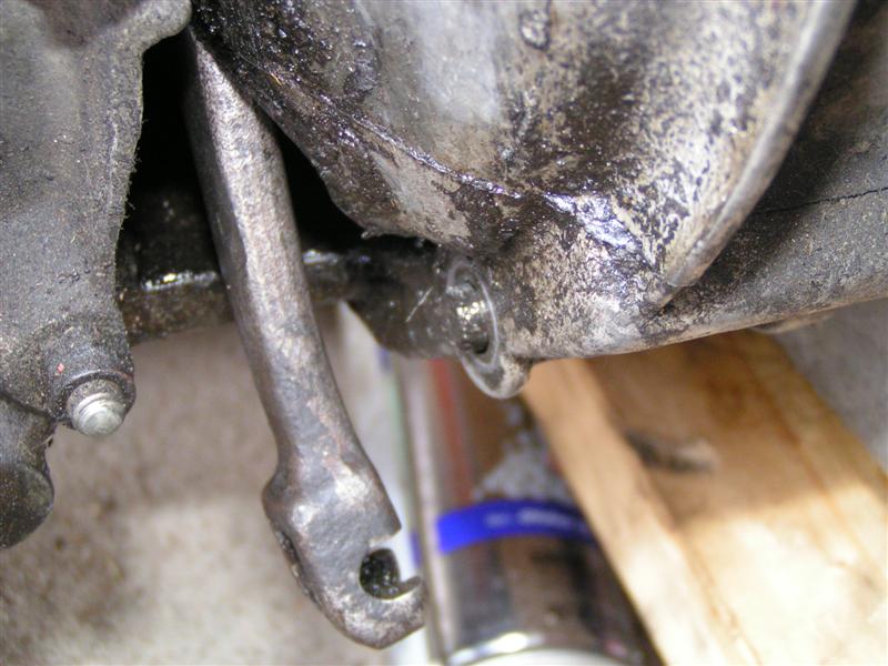

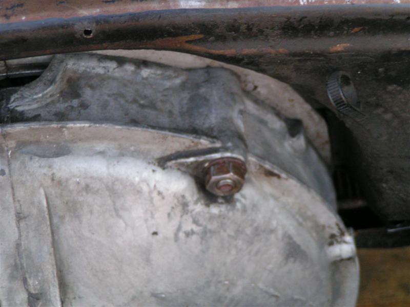

I mated the tranny and the engine back tonight... mind you I only seperated them like 3 weeks ago, when they were seperated, everything fit fine...
now, 1 out of the 2 studs on the bottom seems too short (IMG:http://www.914world.com/bbs2/html/emoticons/blink.gif) WTF?!
the tranny seems flush with the engine, but the stud is only BARELY poking through the hole, not out far enough to even get a bolt on(even with no washer)! a washer BARELY fits...
here's a pic... what the hell?!

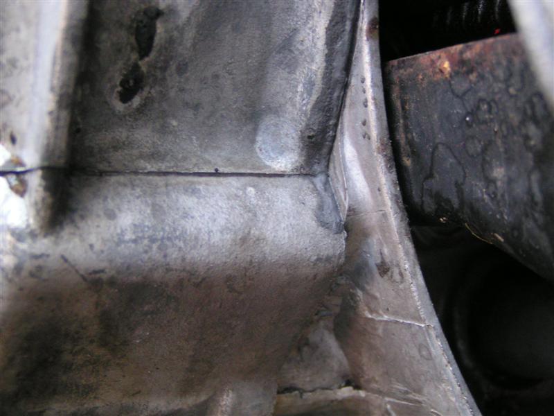

(IMG:http://www.914world.com/bbs2/html/emoticons/wacko.gif) one more:

Show a pic where the tranny and engine meet.

QUOTE (Headrage @ Jul 22 2005, 07:13 PM)
(IMG:http://www.914world.com/bbs2/html/emoticons/agree.gif) tranny hasn't seated right ...
(IMG:http://www.914world.com/bbs2/html/emoticons/smash.gif) Andy
PS: get some brake cleaner and clean all the crud off the tranny and engine!!!

Did you take off the clutch?
If so did you align it when putting it back together?

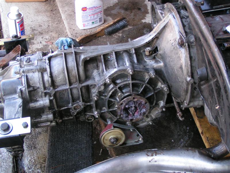

yes, the tranny is a dirty mother fucker... I've tried engine brite, simple green, abd B-12 and it's just not coming off well... I'll attack again today with some brake cleaner, power purple, and ??? it sat behind a tired 1.7 with a bad seal before I got it. the engine is clean, but the tranny is so dirty, it's guilty by association.
I did take the clutch off but I did use the alignment tool
I'll take more pics but the thing that throws me off is this... the other 3 bolts are RIGHT... they had plenty of thread, even the other stud at the bottom...

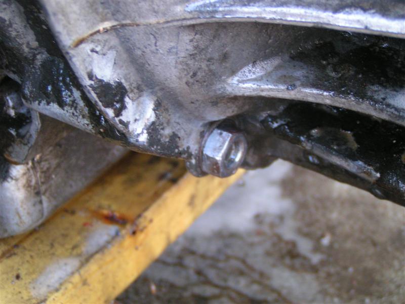

I got it MUCH cleaner...
the trick is in the combo... I sprayed foamy engine brite, let that set a sec, followed by power purple, folloed by brake cleaner... it is 100 times better, still not perfect though... good enough for me though....
that one stud is STILL being a PITA... the other stud will allow the bolt on about 1/2 way... the top ones are fine.
pics follow

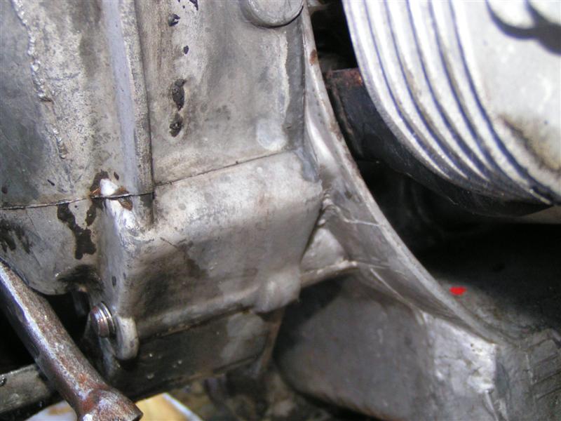

looks FLUSH!
