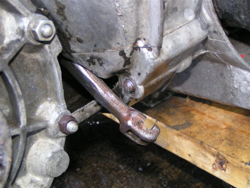

Something VERY strange going on here. (IMG:http://www.914world.com/bbs2/html/emoticons/huh.gif) I went out and check the same area on my '73, and I have a bolt there in lieu of a stud. I'm guessing that a stud there might interfere with the movement of the clutch release arm.

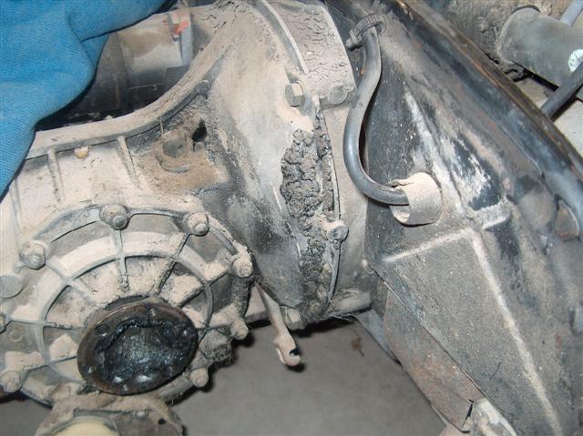

I took a picture of mine for reference, I hope this helps. I have a stud on mine, with a bolt on the next one up.

JESUS Lou, you should delete that pic before 10 people tell you to clean it (IMG:http://www.914world.com/bbs2/html/emoticons/wink.gif)

If everything is installed correctly, i.e., flywheel, pressure plate, clutch and throw-out bearing and the tranny mates up to the motor okay if it was me I would just find a longer stud and give it a shot.

Have you fully tighten the other three? Is there enough thread exposed to get the nut started? If so, maybe it will snug the rest of the way on. IIRC, that stud is only barely supposed to extend through, otherwise it will interfere with the TO bearing fork.
Otherwise, I would take it back apart and inspect the stud further. Despite how it looks, something is keeping the tranny from mounting completely on the engine.

i guess I'll extend the stud and see what happens... maybe when I loosened the tranny it screwed into the case more?! (IMG:http://www.914world.com/bbs2/html/emoticons/confused24.gif)
the only bolt I didn't put on was the one that holds the starter too... I didn't want to put the starter on, with something obviously wrong...
I thought the other 2 bolts would tighten up and leave enough to get this stud stared... but I tore the thread out of 1 bolt trying to get it started...
if the stud won't extend enough, I'll pull the stud and put a longer stud or bolt there...

If you're going to extract the stud a bit for nut installation, I think I'd take it all of the way out, and throw a little green lock-tite on the threads going into the block, as well as the nut side. Wouldn't be fun laying on a hot Texas road trying to re-tighten those bolts/nuts. (IMG:http://www.914world.com/bbs2/html/emoticons/wink.gif)

That's weird, those studs are 914 studs. I had the shorter ones on my 2270 and ran into that problem, so I got another set.

That stud is supposed to just barely stick through the nut. If it's too long, the clutch arm will hit it. Loosen the existing stud up until it will just barely stick through the nut when everything is tite.
Make sure that you put some locktite on the stud before you button everything up.

yea tom, this IS weird! like I said I didn't change anything with these studs, and now this one seems short... actually both bottom ones seem a little short, but the opposite side will work...

Figure out how long the stud needs to be. Then remove the stud and put just a dab of red on the threads and put it back in the engine case.
