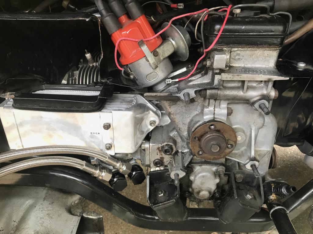

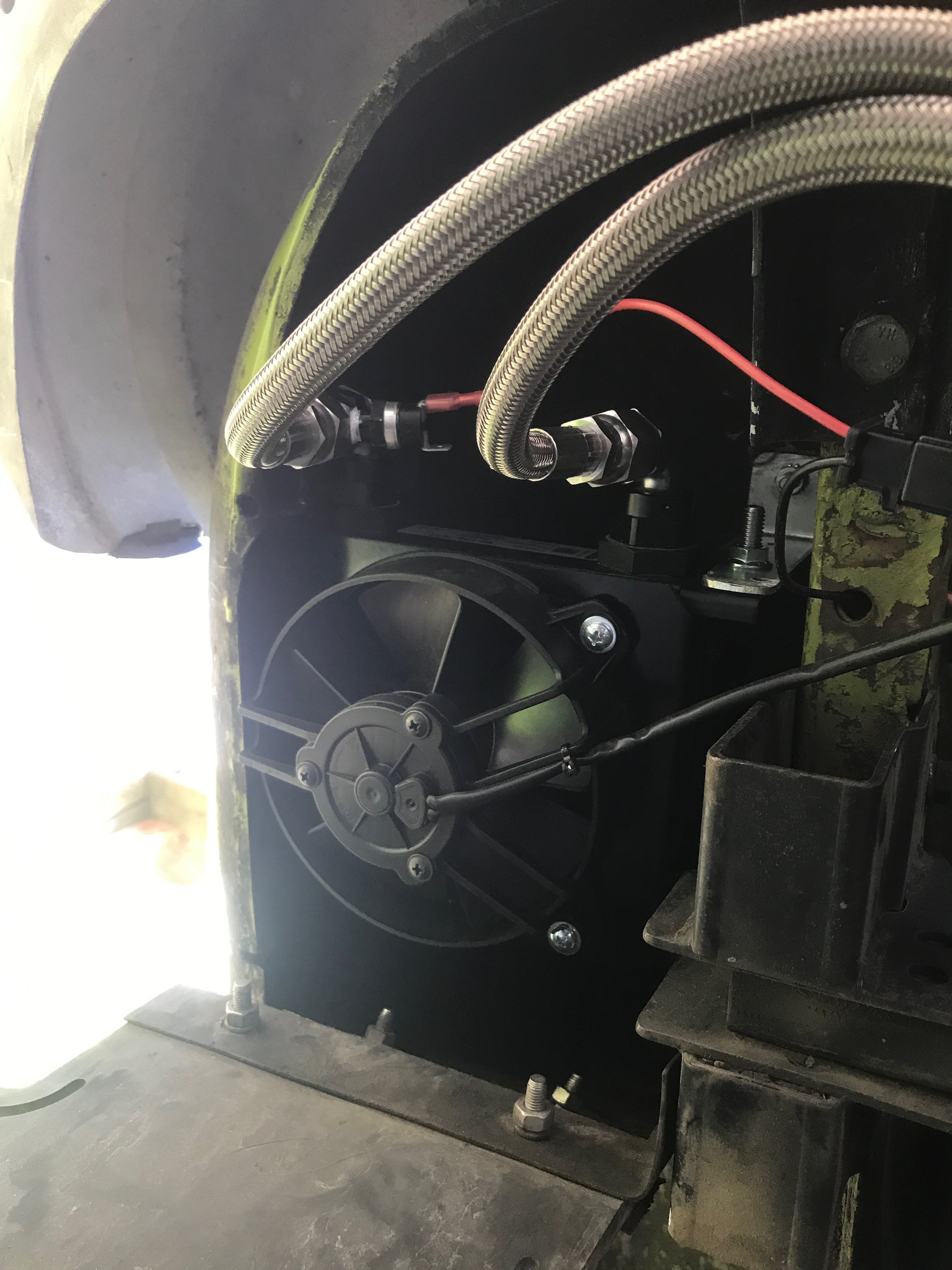

Pics of the remote oil cooler setup

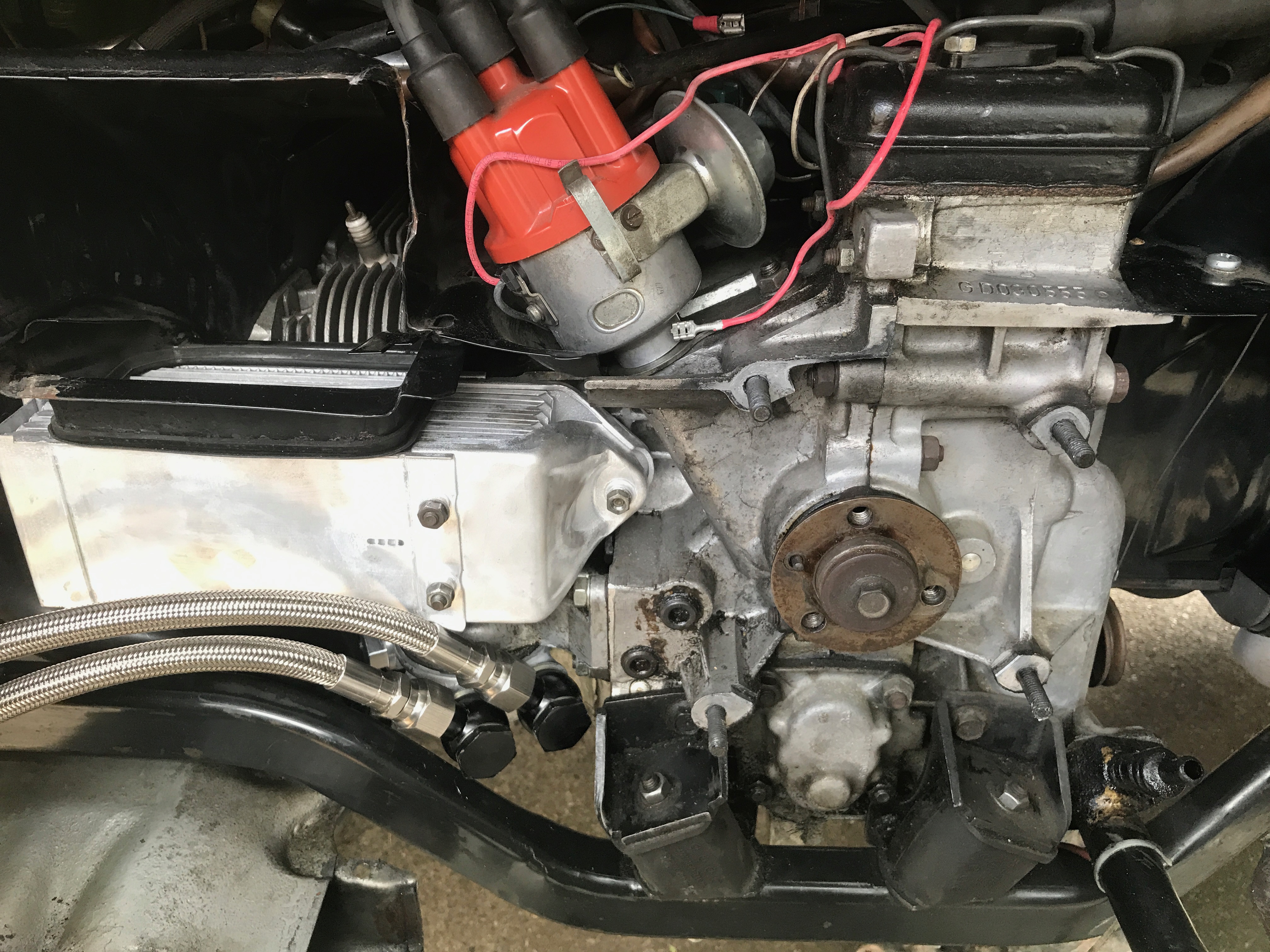

How I ran the lines behind the fan housing with the sandwich adapter

QUOTE(Bleyseng @ Jul 20 2021, 07:50 AM) *
Those are really nice oil line! What size and where did you get them?! (IMG:style_emoticons/default/drooley.gif)

I place in Seattle that used to be called “Fittings NW” but they got bought and changed their name. They are 13mm inside diameter high heat lines with SS ends. $50 each to have made,ouch!

looks like some sort of AN banjo fitting. I like it. I have the same sandwich adapter on my engine now using AN fittings and lines I made. Would not be too much to change to some sort of AN banjo assuming I could find them. That looks very doable.
