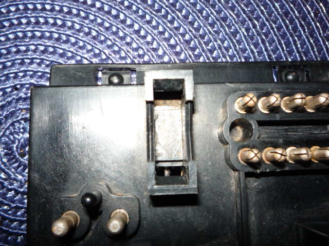

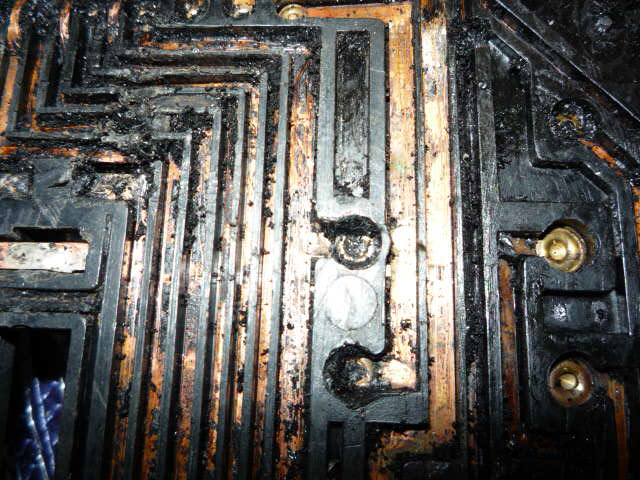

I was cleaning up another batch of relay boards for testing and reseal. Been a while since I caught a bad one. The open was under the tar so it would not have been seen. Some type of corrosive must have eaten a hole through the copper. Second picture is of a good board. Hole was directly below harness clip holder.
