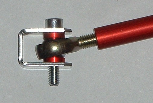

Was it the upper or lower rod ends? I’m guessing that it’s the lowers. Not sure if I agree with rotating the mounting tabs. Check to see if they got bent. Rotating them will probably cause binding when the car is jacket up and the front suspension drops. They may also bind when the suspension is compressed. Please PM me with pictures and your address, and I’ll send you new parts. Then we can figure out where the binding is coming from. I’ll also need to know which thread you need (right or left), and if you need new drop links too.

hey ira, i'll take pictures tomorrow and post them here. the reason why i moved the u-tabs 90 deg. was because with the swaybar on full soft (where i was running it) the heim-joint would hit the top of the u-tab under normal operation.
might had to do with the drop-links as they were too long for my setup. both heims are screwed in completely to make the droplink as short as possible, still, on full soft or full tight they would hit.
with the u-tabs turned 90 deg, the only time they would hit was on full decompression (car on the lift) ...
it'll make more sense with pictures ...
(IMG:http://www.914world.com/bbs2/html/emoticons/boldblue.gif) Andy

Your explanation makes full sense, and I’ve heard of 914’s not being able to be set full soft before. I’ve also heard of them being set full soft without any problems, so I’m not sure what the problem is. It may just be on the edge of working, or not working in this case. Anyone else seeing this, please let me know? It looks ok on my 911, but the 914 swaybar may be in a slightly different location to clear the gas tank.
Here is the drop link at full tilt. The rod end is hitting on the spacer before it can touch the bracket. This is on of my brackets, but the factory one is similar. If your bracket is higher and hitting, maybe it can be shortened. If the spacer is causing the problem, maybe I can change it to allow for more clearance.
What do you think about a compromise of rotating the bracket 45 deg.? Either way, we need to get it back together and figure out what the problem is. Let me know what you need and where to send the parts. No charge, I just want to solve this. I’ll be out of town next week, so let me know soon if you need parts before then.
