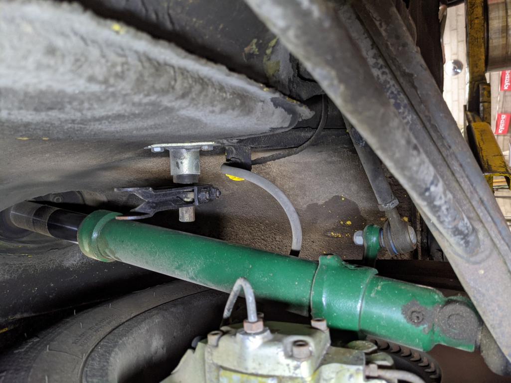

Yeah, don’t know exactly what exactly what happen with this either. Would you just weld on the tabs to the existing alarm or a swap out the a arm for one that already has the tabs?
I suppose if the bushings are questionable that are used for swapping out the arms as a whole...

I think 914 Limited makes tabs.

I would weld on a tab. Easy to do.

https://www.elephantracing.com/911/swaybars...bars/u-tab-kit/
Tabs

Tabs it is then!
Thanks gentlemen.
