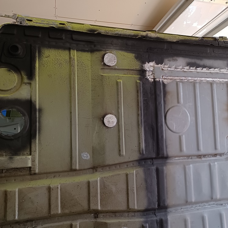

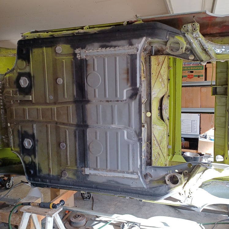

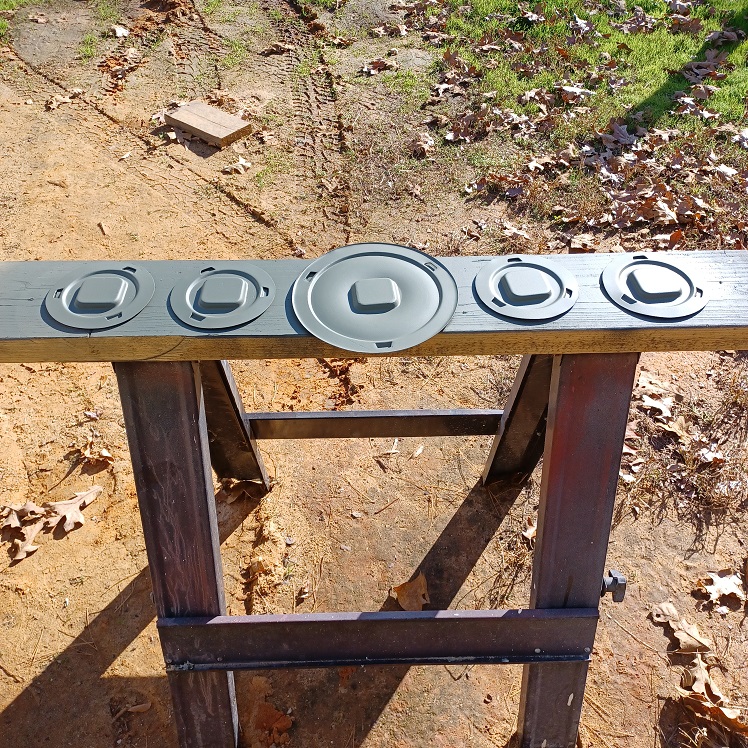

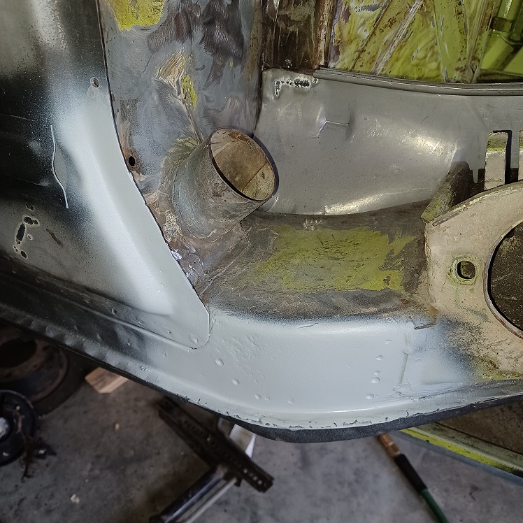

Then I turned my attention to the floor plugs. The four larger ones up front and the giant on from the trunk had to have all of the undercoating removed befor blasting them clean to bare metal. So for hours I scraped until I got the majority of it off, I swear Porsche paid the guy who applied the seam sealer by the gallon that he applied in a day. But finally got them all blasted and cleaned.
Puebloswatcop
post Dec 2 2021, 02:50 PM
Post #183
Posts: 1,690
Joined: 27-December 14
From: Mineola, Texas
Member No.: 18,258
Painted them with self etching primer...

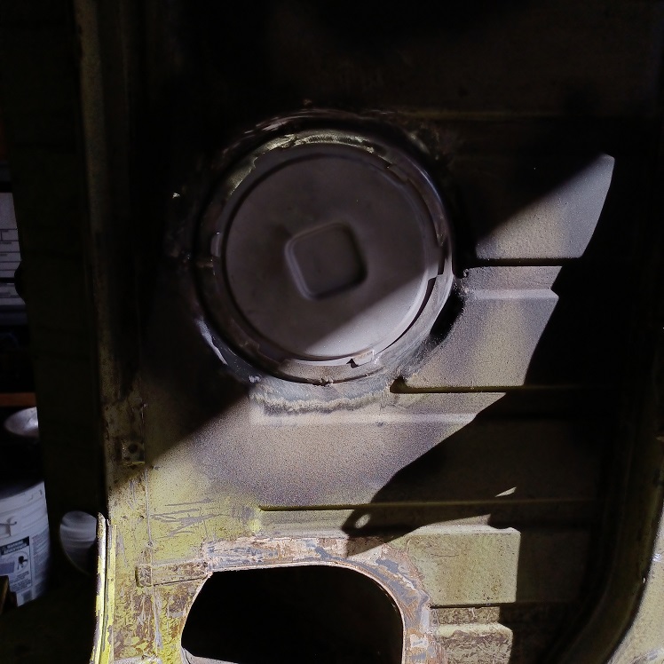

Not wanting to watch paint dry I turned my attention to the 4 small holes that were in the floor, not sure exactly what these were for, but I decided to weld them closed. First I had to remove the metal cover from the inside, remove the seam sealer and hammer the flaps flush, then welded each one and ground the welds flush.
Puebloswatcop
post Dec 2 2021, 03:07 PM
Post #185
Posts: 1,690
Member No.: 18,258

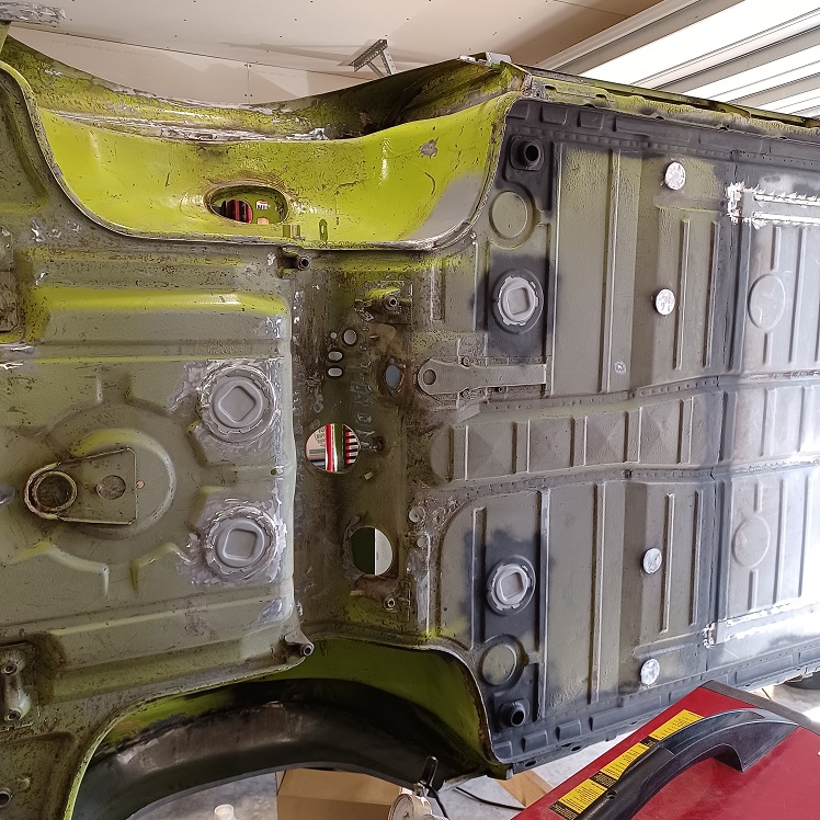

After removing all of the seam sealer from the other plug holes, I re-installed the plugs with new seam slealer applied to the mating surfaces. Will go back after I blast the entire floor and apply the final coats of seam sealer.

Nice thing is, by the end of the day I got to cross two tasks off the white board. I am hoping that I can cross the rest off by the end of the week.....and now its time for (IMG:style_emoticons/default/beer3.gif)

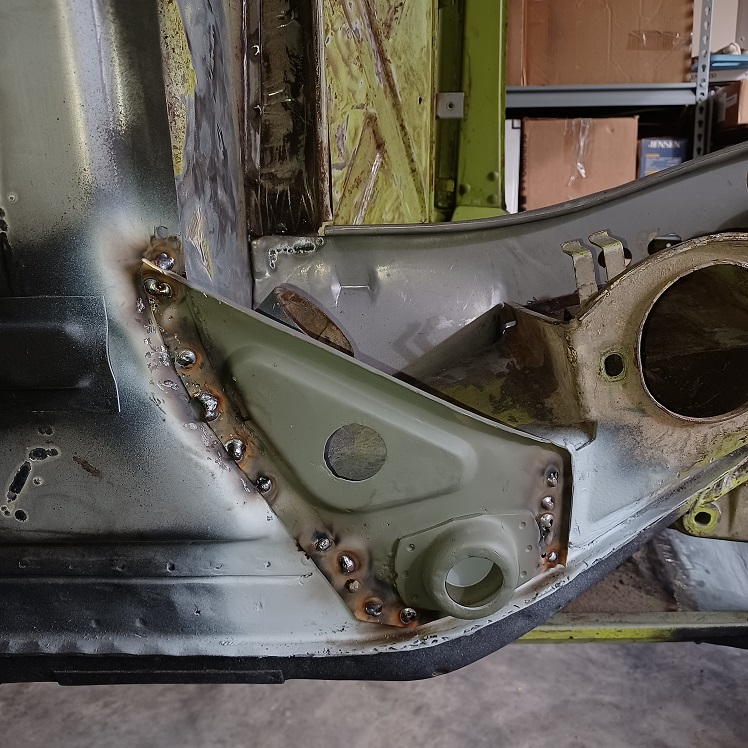

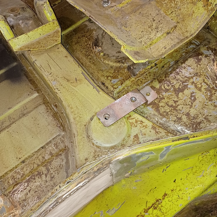

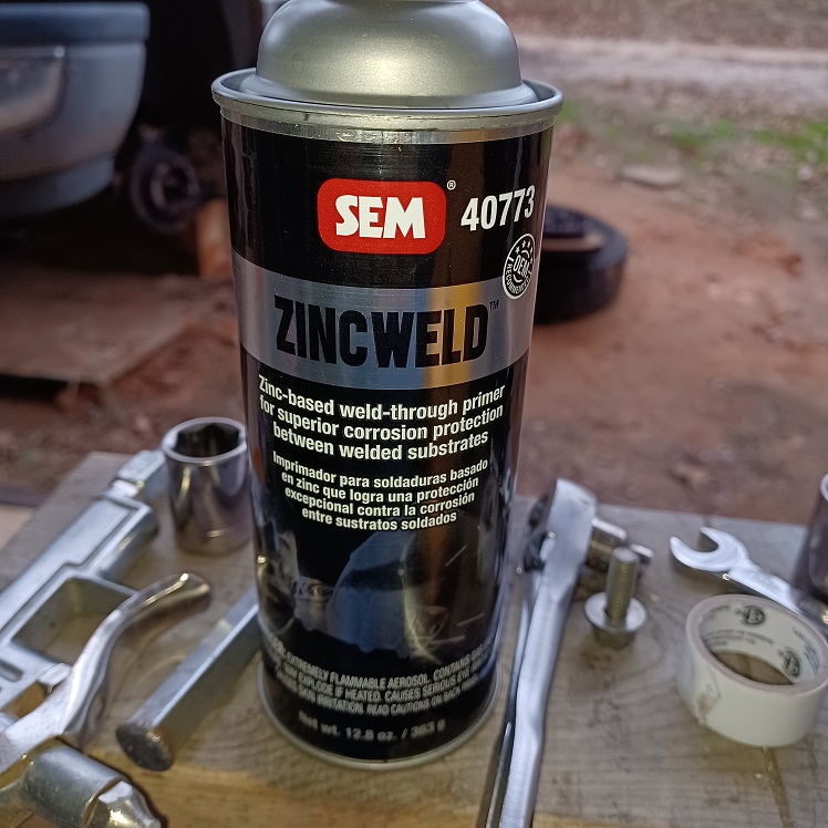

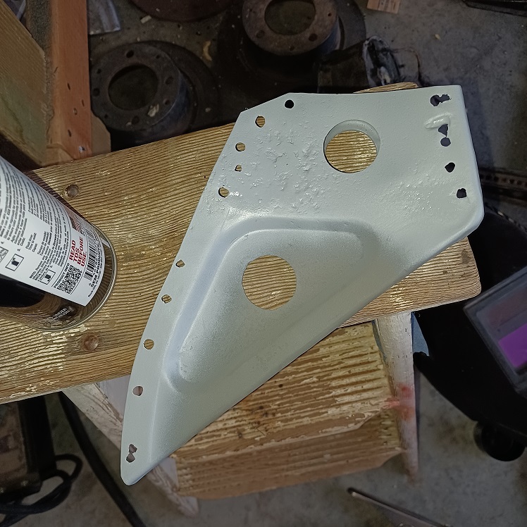

So I finally found someplace in east Texas that sels weld through primer, which I desperately needed before welding the rear jack points back in. The drivers side triangle was already cleaned and primed, but for some reason I couldn't remember what I did with the other one. Found it in my parts boxes this morning, so that was my goal for the day. Took about 2 hours to get it all cleaned up, blasted and primed. Then it was on to the task.
First I had to strip the primer I had sprayed as a rust preventative.
Puebloswatcop
post Dec 3 2021, 05:34 PM
Post #190
Posts: 1,690
Member No.: 18,258
The good thing about re-installing the same supports is that the alignment is exactly the same as they were installed at the factory....How do I know, because the holes drilled through the triangles line up with the dimples in the long, where I drilled them out....
So I painted both the mating side of the triangles with the weld through primer as well as the portion of the long and the floor where they are welded together.
Puebloswatcop
post Dec 3 2021, 05:37 PM
Post #191
Posts: 1,690
Member No.: 18,258
The weld through primer I used is a zinc based primer, hopefully it will provide some level of protection between the the mating surfaces.
Puebloswatcop
post Dec 3 2021, 05:42 PM
Post #192
Posts: 1,690
Member No.: 18,258

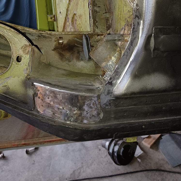

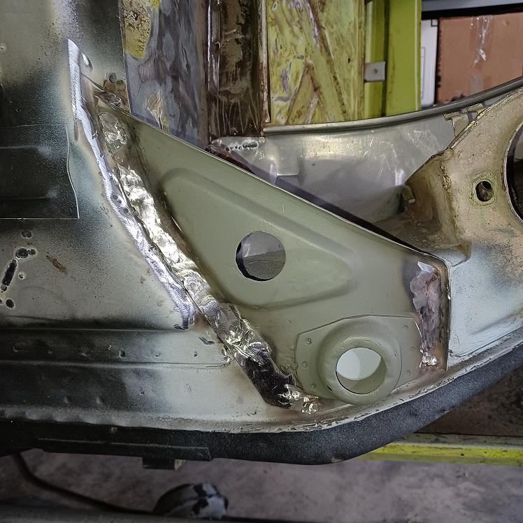

Got the passenger side all welded in. The welds were a bit of a challenge welding with the primer in place, got allot of spattering. So after a bit of reading I discovered that it works buch better if you remove the paint where you are actually welding. Live and learn.
Puebloswatcop
post Dec 3 2021, 05:48 PM
Post #193
Posts: 1,690
Member No.: 18,258

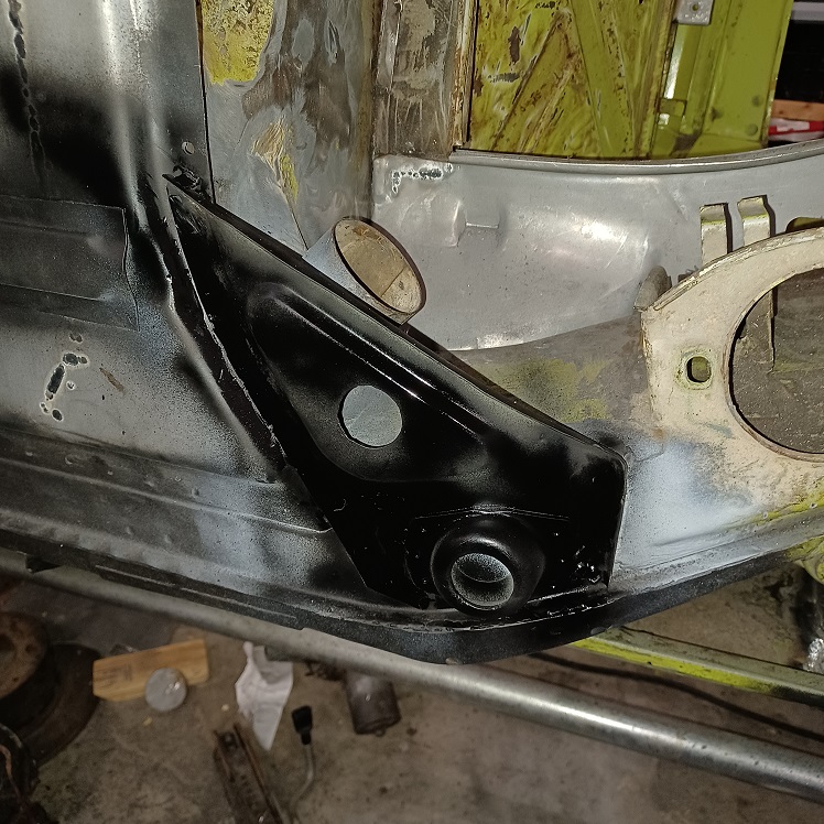

then I ground the welds flush and primered it with the black primer to keep the rust at bay.
Puebloswatcop
post Dec 3 2021, 05:50 PM
Post #194
Posts: 1,690
Member No.: 18,258

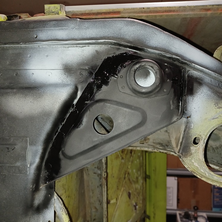

Then it was wash, rinse and repeat on the driver's side. Here is a pic of both of them in place. Its starting to look like a complete car again.

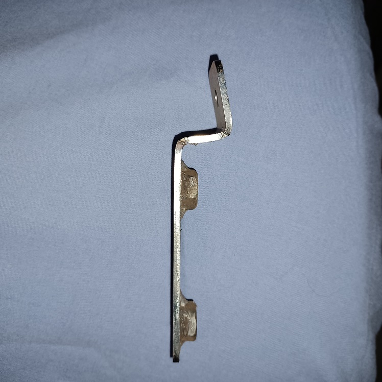

Today I decided to weld in the rear traction bar mounts.

After checking the placement and fit, it turned out the short tail of the bracket needed a little tweeking to get it to sit flush to the surface...
