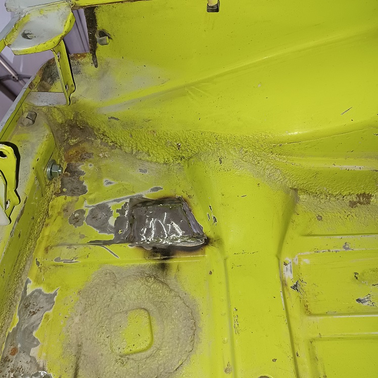

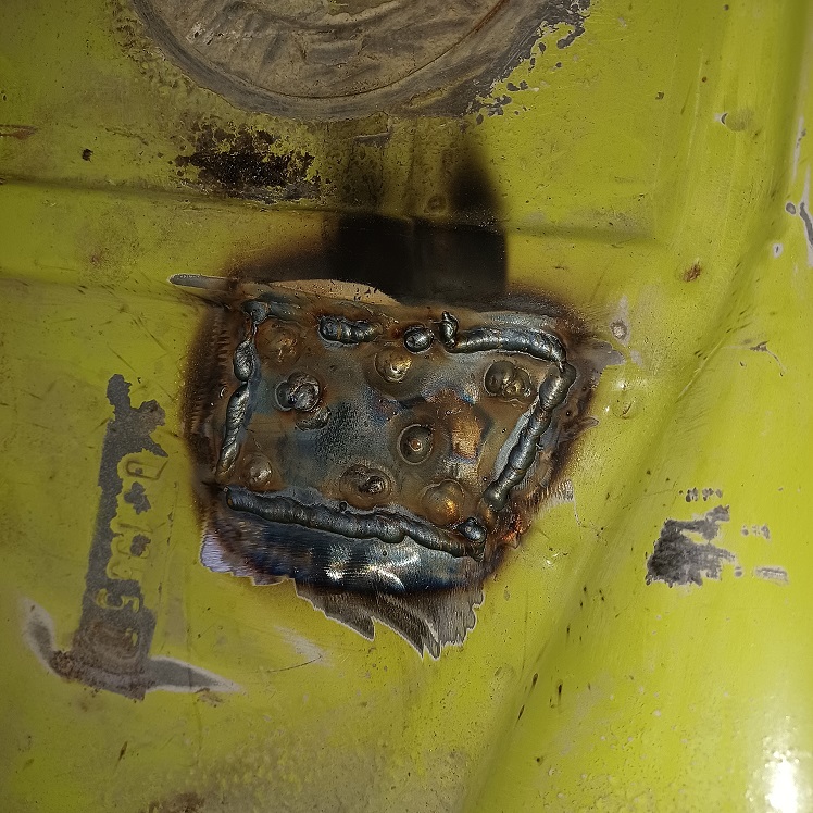

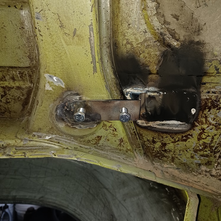

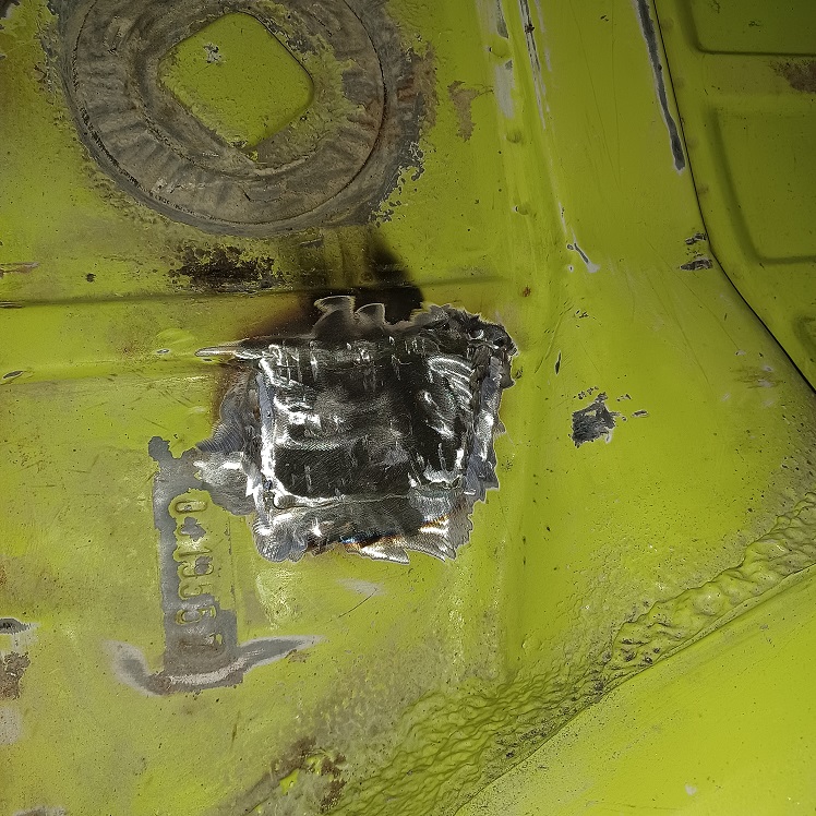

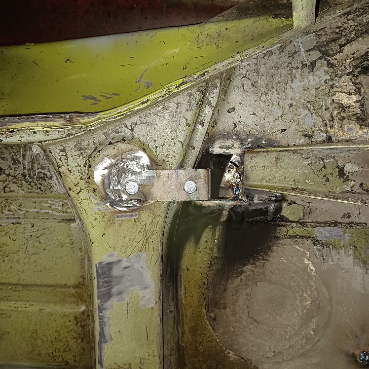

The nice part of the removable mufler heat shield is I didn't have to contend with it while welding in the mounting brackets...But on the passenger side I did have to contend with the tow hook bracket. After the welds were in place I ground them flush for a better finished appearance

On the drivers side there was nothing that interfered with the install, except seam sealer that was nearby.....just a small fire....

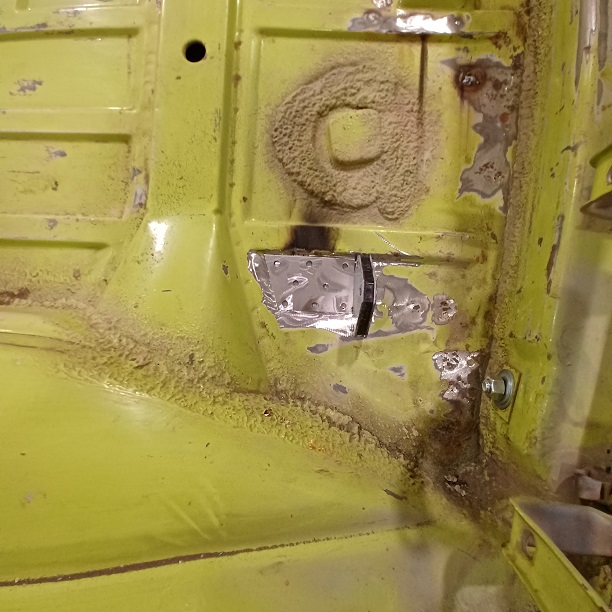

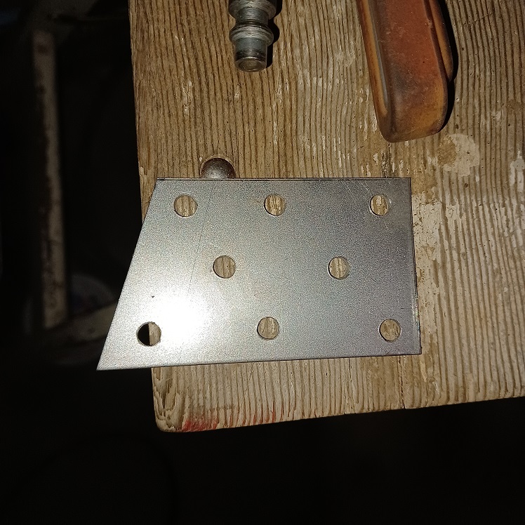

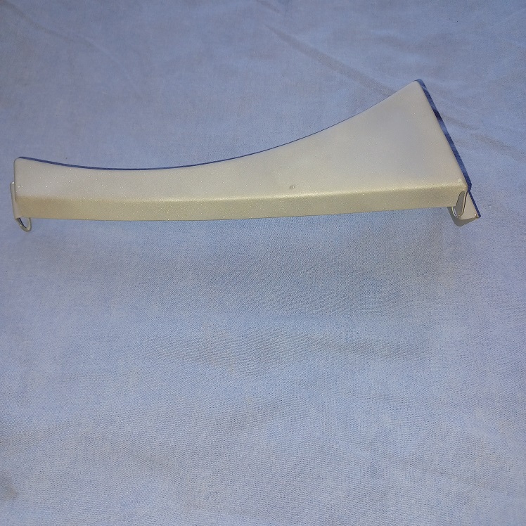

Once the mounts were in it was time for the supports to go in. These came with no holes drilled so I drilled 8 holes in each one to insure the center portion of the metal was well attached.

After confirming the orientation of the supports (thanks Montreal 914 & Luke M), the areas were sanded clean as well as sanding the coating off the support pieces.

Ive seen these just spot welded, but I decided to weld the entire perimeter of them as well. Then grind the welds to blend them to the floor, They definately aren't going to pop any spot welds....

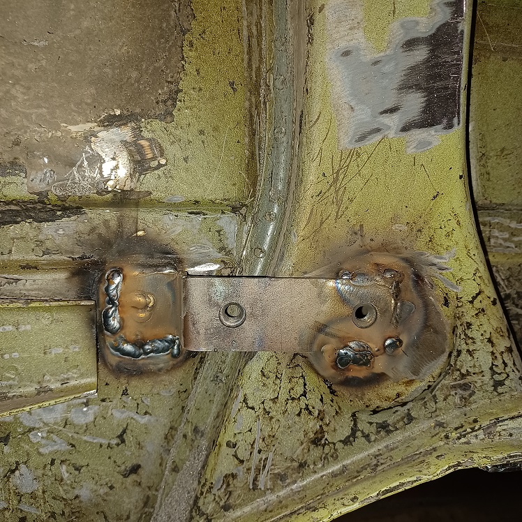

On the passenger side I just repeated the process, being careful not to weld over the number in the trunk metal. The nice thing is you can actually see the heat signature of the bracket underneath. My welds aren't to straight, trying to get used to welding with bifocals sucks.

Then ground all the welds flat and blended them into the floor, again being careful not to get near the number.

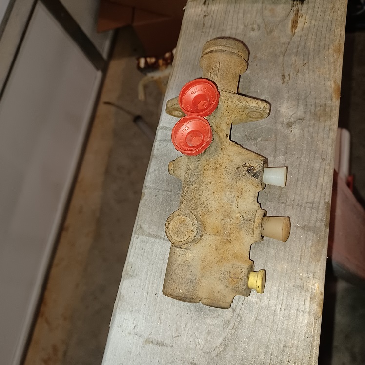

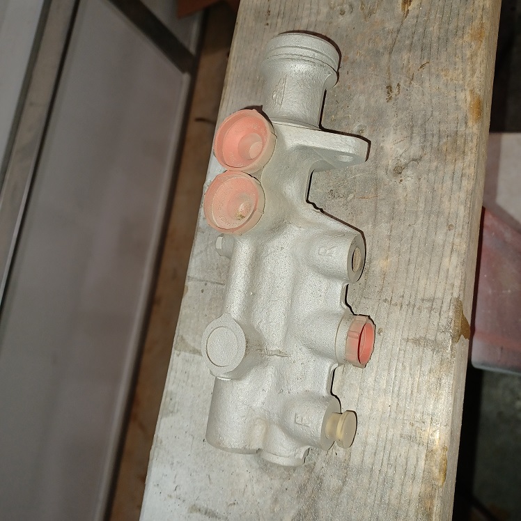

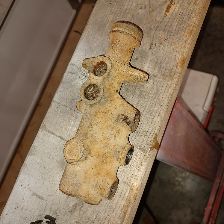

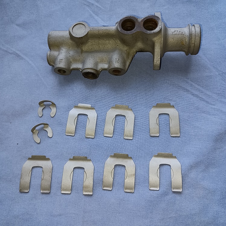

Started out emptying some of the boxes that just came from Colorado. Found one of my old 17 mm brake master cylinders. It is amazing how nasty these things get, out of sight, out of mind.
Puebloswatcop
post Dec 11 2021, 05:02 PM
Post #214
Posts: 1,649
Joined: 27-December 14
From: Mineola, Texas
Member No.: 18,258
After removing the gromets and other attachments, I plugged the holes. My wife makes fun of me because I save every cap and plug that comes on new parts...Ha Ha, Now you know why.
Puebloswatcop
post Dec 11 2021, 05:05 PM
Post #215
Posts: 1,649
Member No.: 18,258
Then I spent about 30 minutes blasting all the rust and dirt away. Now the only problem is it needs rebuilding. Does anyone know where or even if I can find a rebuild kit for it?

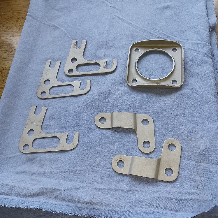

Then blasted a hole bunch of retaining hardware for the brake lines.

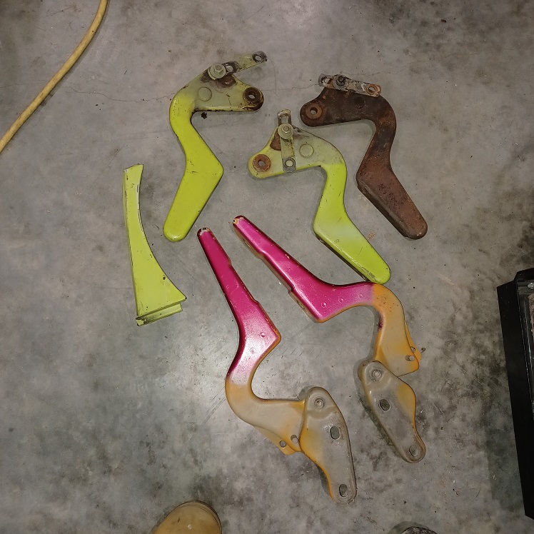

Then found a box with Misc. hinges in it. Some came off the car I am actually working on (green) Others came from the parts car I was dismantling in Colorado. The P O of that car painted what was originally Orange and turned it into a psychodelic disco car......The custom blackened torch look also came from the disco car
Puebloswatcop
post Dec 11 2021, 05:17 PM
Post #218
Posts: 1,649
Member No.: 18,258
Blasted all of them clean and ready for primer

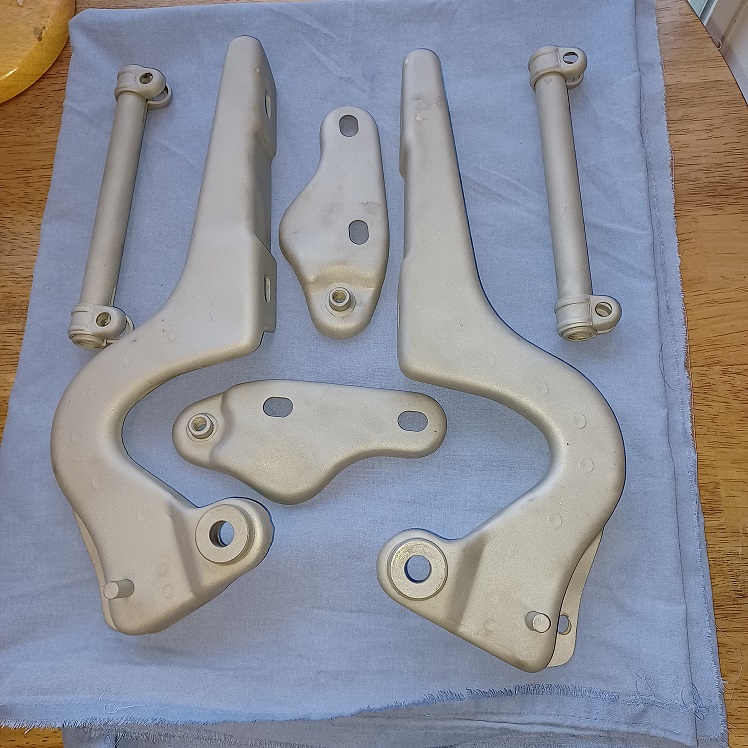

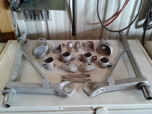

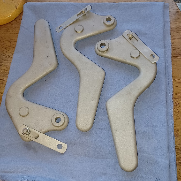

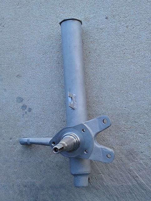

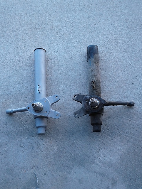

Then came the boxes of suspension parts....
Puebloswatcop
post Dec 11 2021, 05:26 PM
Post #220
Posts: 1,649
Member No.: 18,258
I love clean parts. The only thing better than clean parts....is painted parts.
