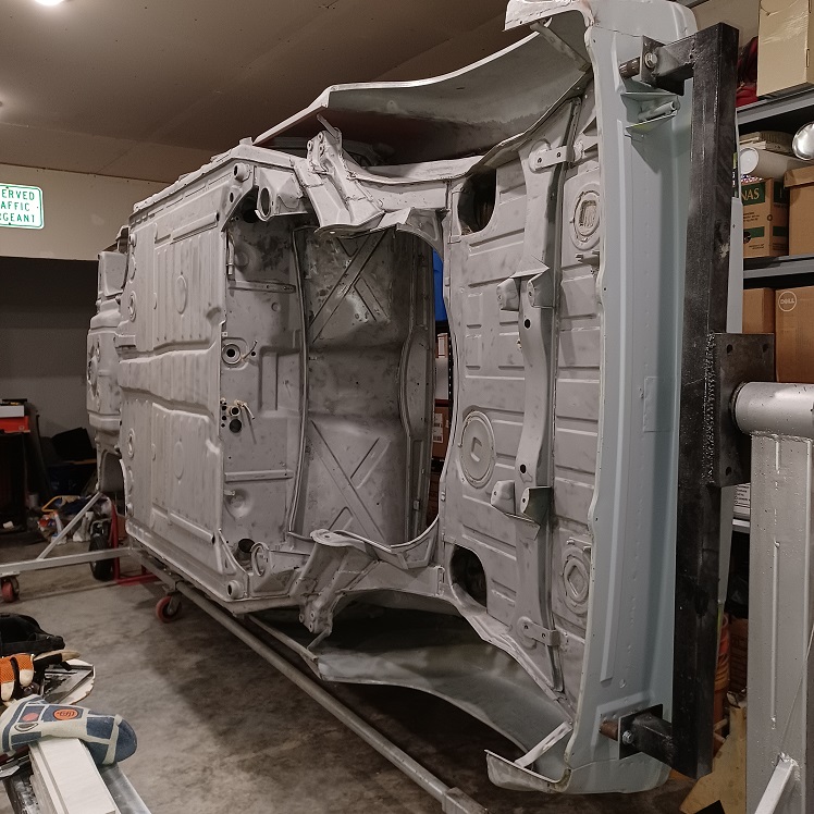

So, overall I have about 5 or 6 hours of blasting done and am about half way through the underside and engine compartment.
To answer some questions...Is this doable....yes. Is it pleasant...Absolutely not, it is very messy. Would I do it again, nope. I would save up the money to have a dustless blaster come out and do it. I figure by the time I am done, I will have about 12-15 hours invested, Cost about $200.00. I will gladly pay the $900-$1000 to have someone else do this job.

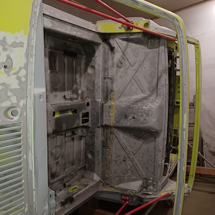

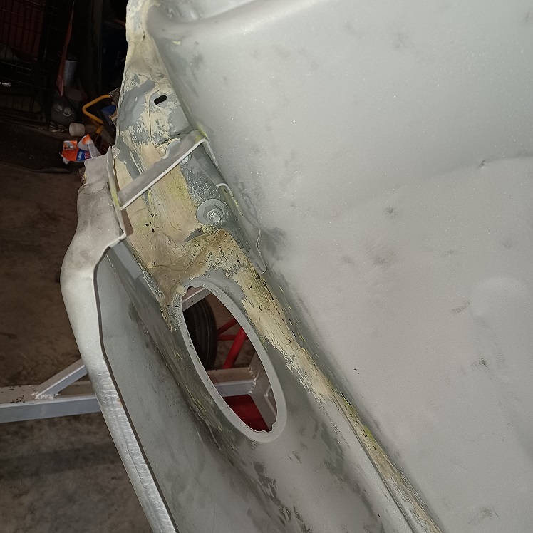

Another few hours of blasting today...between heat and humidity and all the dust, it makes for a miserable project. Cant wait to be done...But, got most of the front trunk blasted

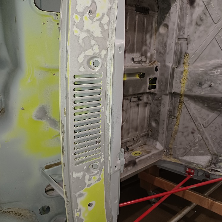

And the air intake grill...figured this is allot better than trying to sand the openings by hand

The passenger compartment is done
Puebloswatcop
post Apr 16 2022, 03:59 PM
Post #467
Posts: 1,609
Joined: 27-December 14
From: Mineola, Texas
Member No.: 18,258

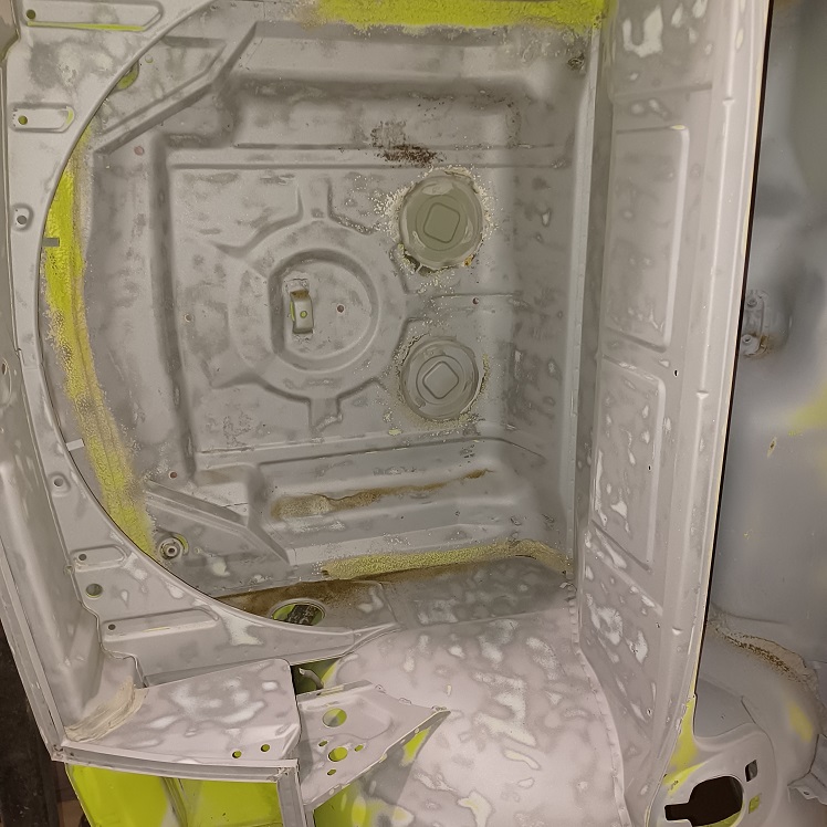

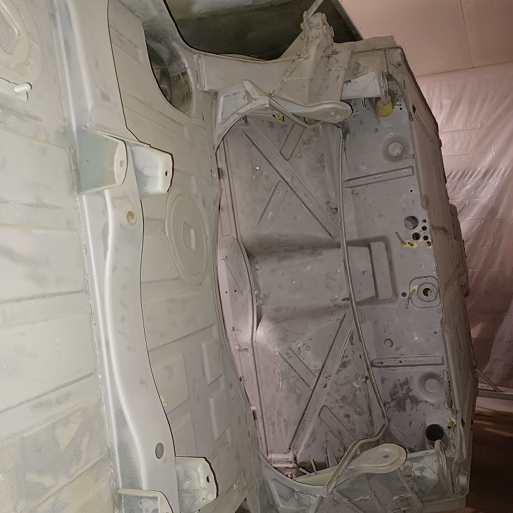

Engine compartment .....Done
Puebloswatcop
post Apr 16 2022, 04:01 PM
Post #468
Posts: 1,609
Member No.: 18,258

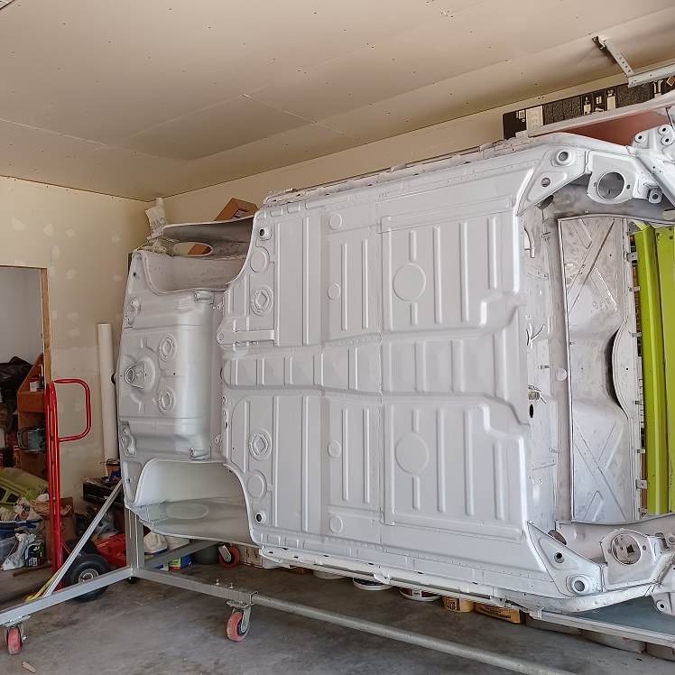

Bottom of the body...Done
So Monday I will finish the rear trunk and touch up a few other areas and blasting will be done.
Thank Goodness. Happy Easter everyone.

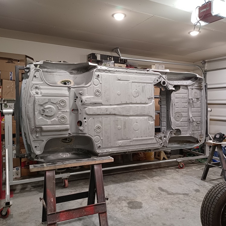

Well, Finally got done with the media blasting. What a mess. Next few days will be spent just cleaning the garage.
So, if you ever feel tempted to media blast your car, spend the money and have a dustless blaster come do it for you. It takes an average of 9 hours, so at anywhere from 75-100 per hour its worth it. Just my humble opinion.

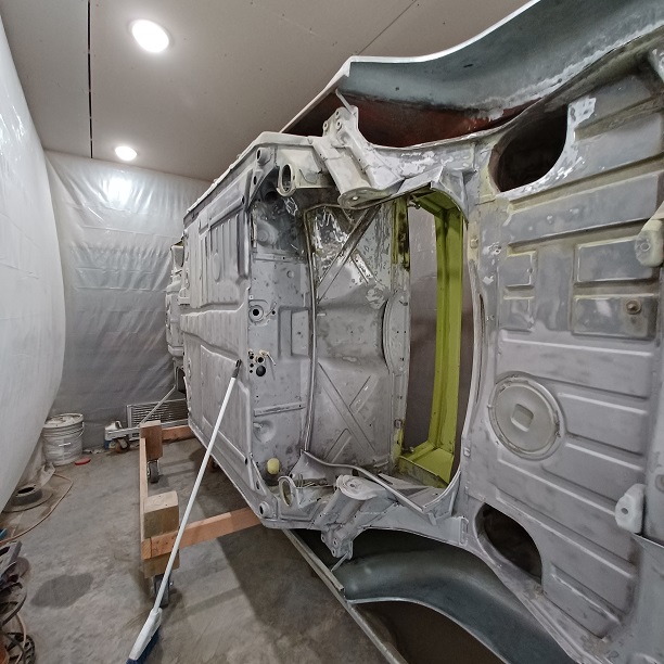

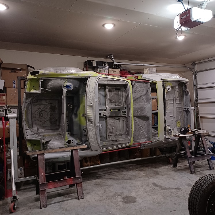

Forgot to post the Pics of the finished Blasting job. I decided not to blast most of the outside body panels and will prep them by DR sander and hands on sanding. If you look carefully at the ceiling, yuo can see where the tent was, it totally discolored the sheet rock....Damn. (IMG:style_emoticons/default/headbang.gif)

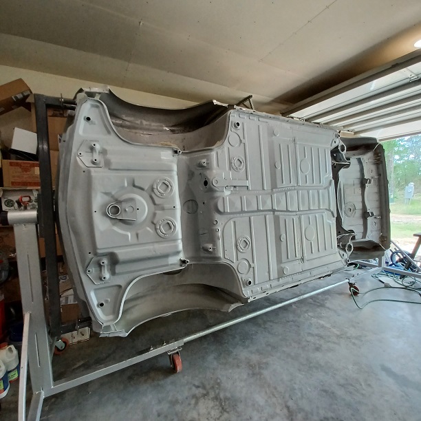

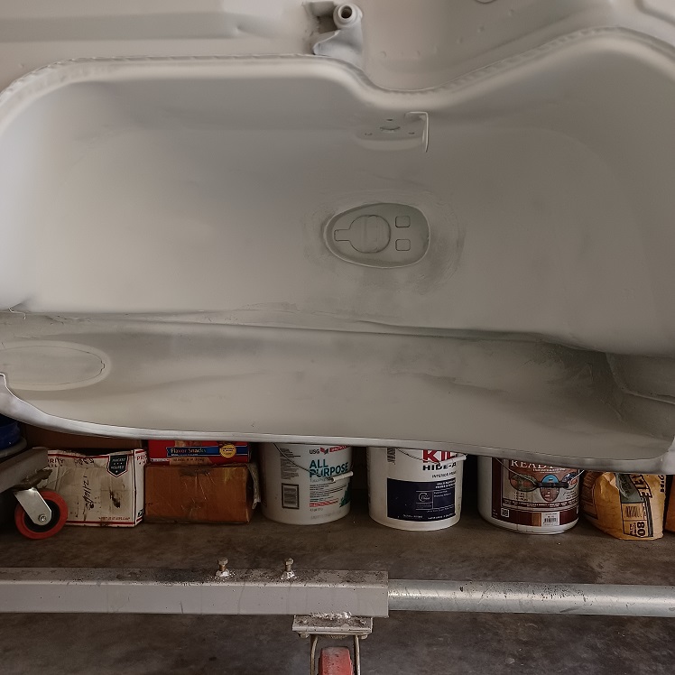

The underside of the car and the engine compartment came out really nice though.

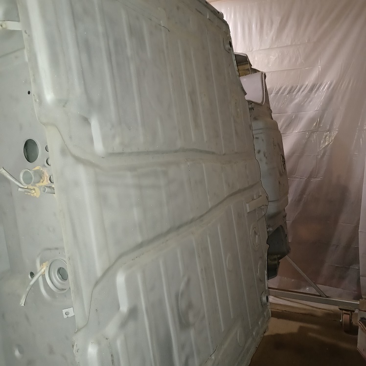

And after two full days of garage cleaning and spinning the car about 100 times, I think I have gotten the majority of the media out of the car and out of the garage. Now I guess I will just have to finish the sheetrock and paint over the whole ceiling so I can cover up the grey square I created....

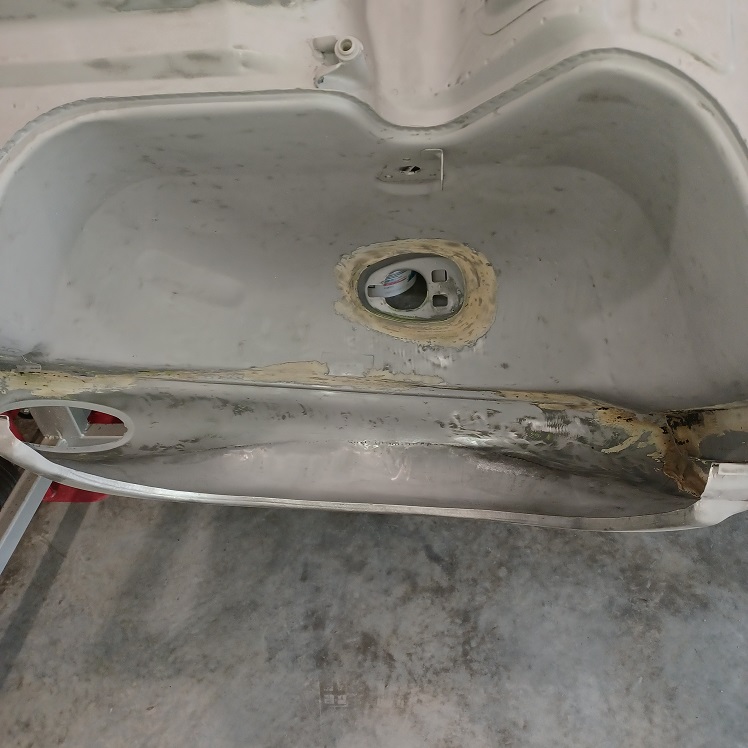

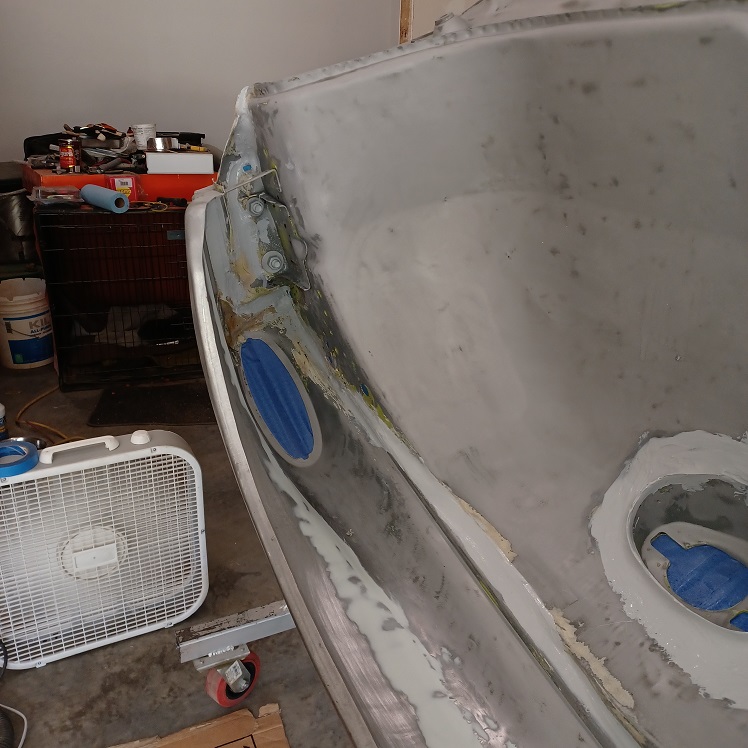

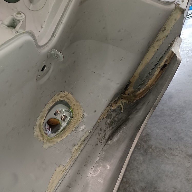

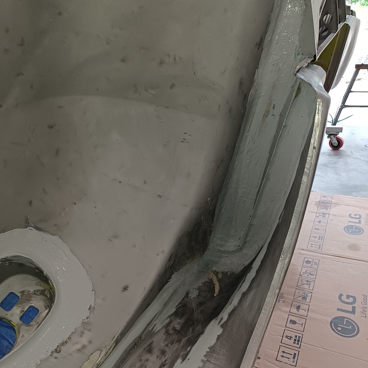

Today started the next chapter in this build. Started covering up the metal that was blasted over the past week. I started in the passenger front wheel well. This is what it looked like after blasting...
Puebloswatcop

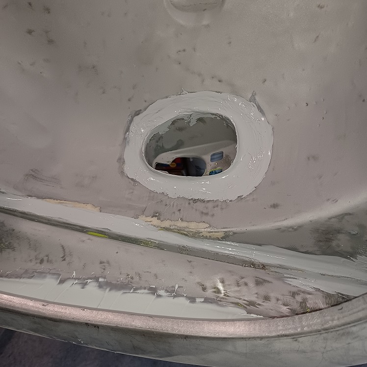

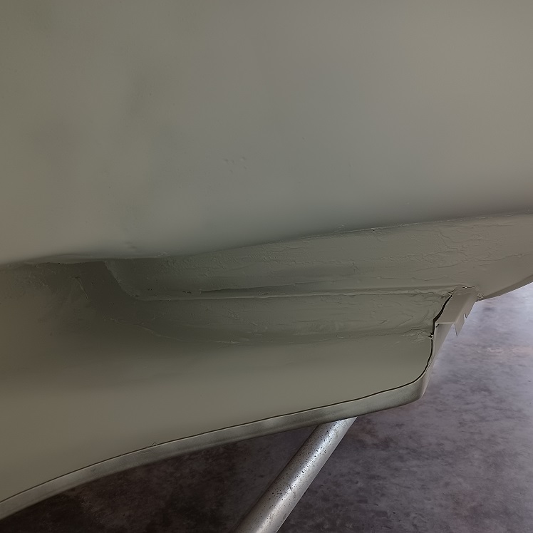

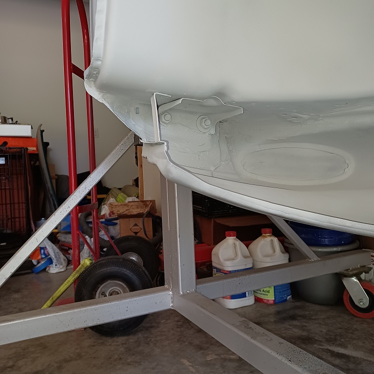

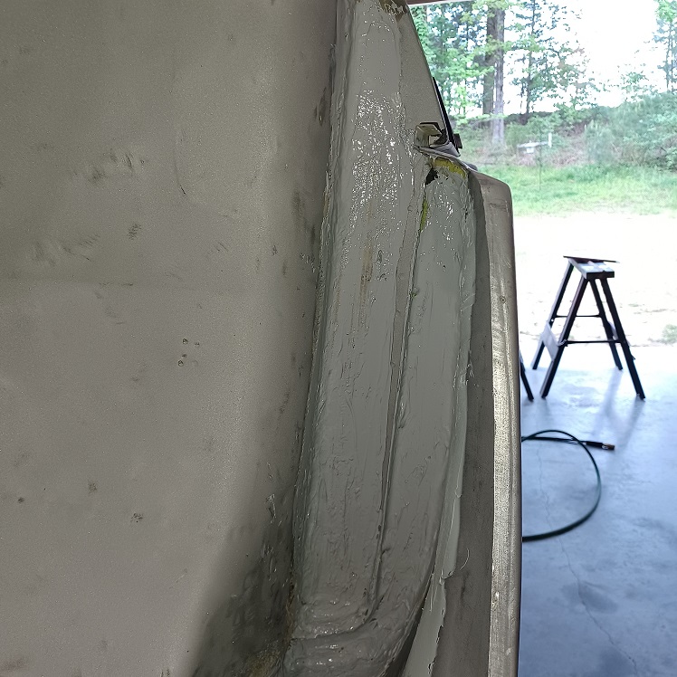

I filled in along the new seam where the flares were attached with body filler , just to pretty up the seam. Then covered all of the other seems with new seam sealer.
Puebloswatcop
post Apr 22 2022, 04:43 PM
Post #478
Posts: 1,609
Member No.: 18,258

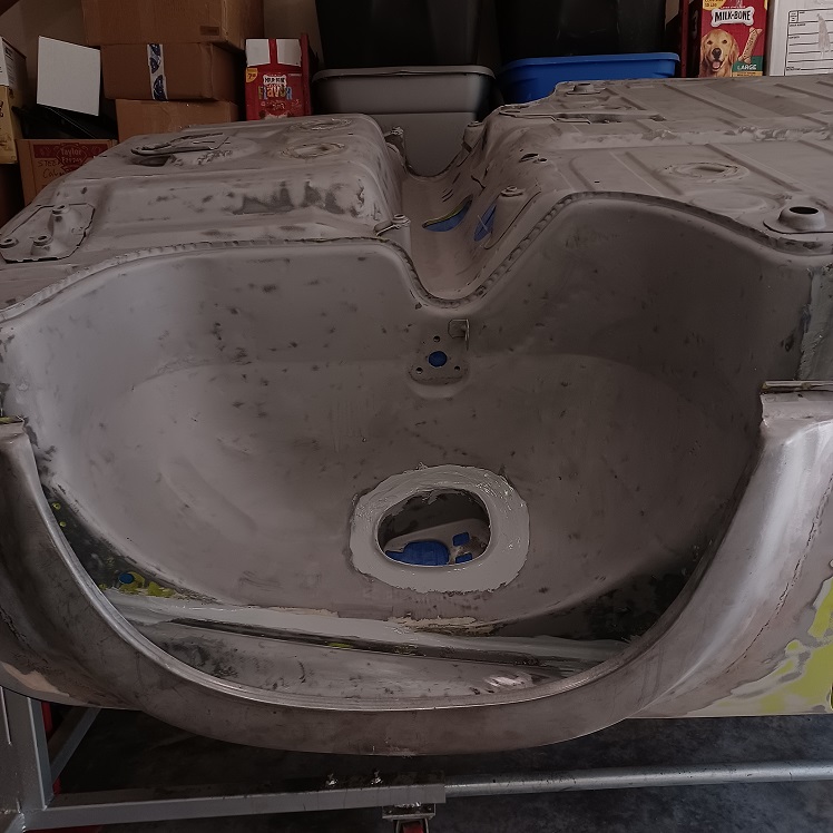

After sanding the seam smooth where the flare mated up and letting the seam sealer cure, I painted the wheel well and most of the bottom of the car with 2K Epoxy. Man that is some nasty stuff, don't spray that without a respirator....
