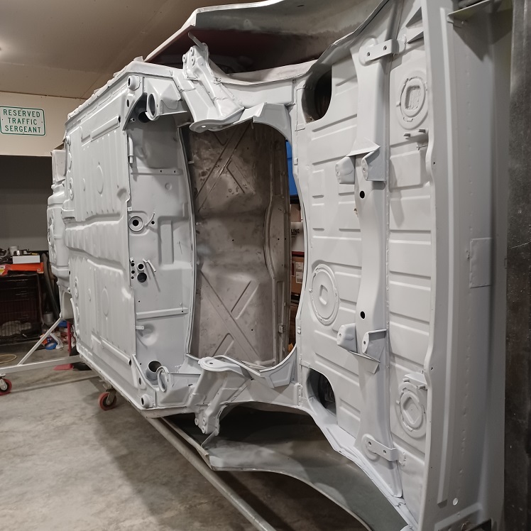

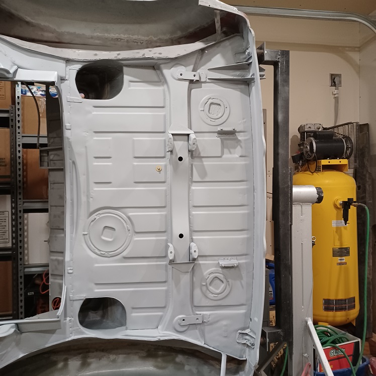

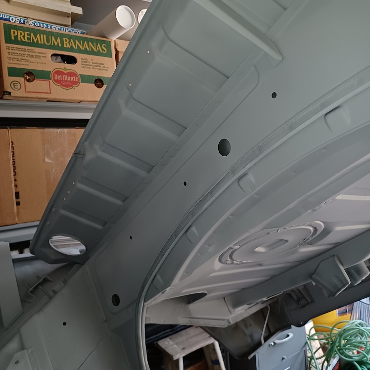

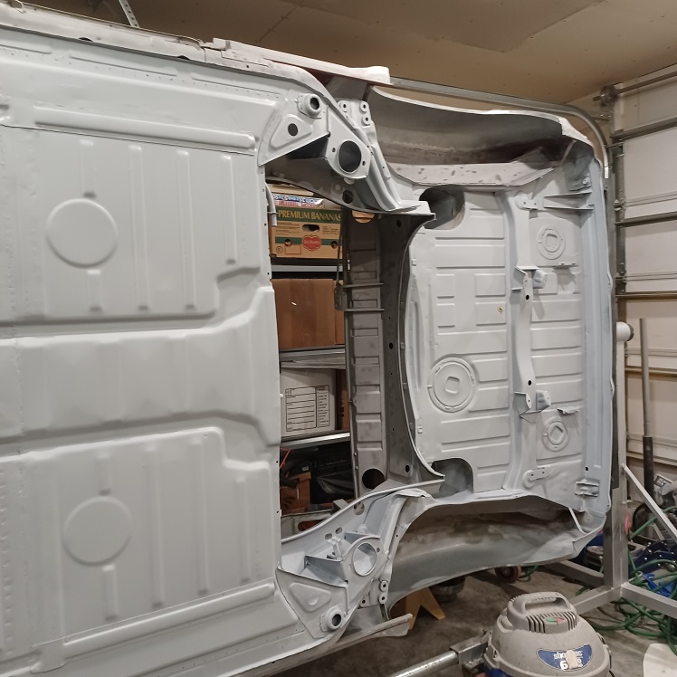

Got a bit more painting done today to include the underside of the rear trunk and the rear jacking points
Puebloswatcop
post Apr 25 2022, 03:57 PM
Post #483
Posts: 1,609
Joined: 27-December 14
From: Mineola, Texas
Member No.: 18,258
Both of the rear suspension points... what a pain getting all those angles....

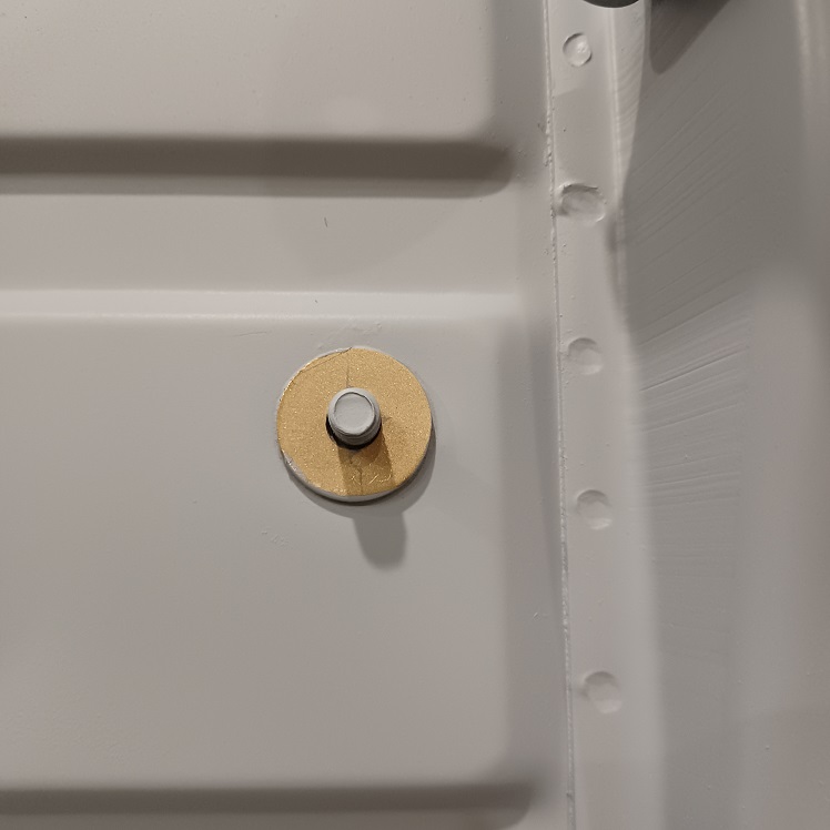

One thing I liked about blasting the car was getting the grounding points absolutely clean. So I made sure to mask this off before painting. These should get great ground connection....

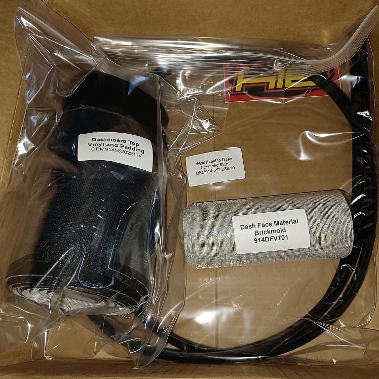

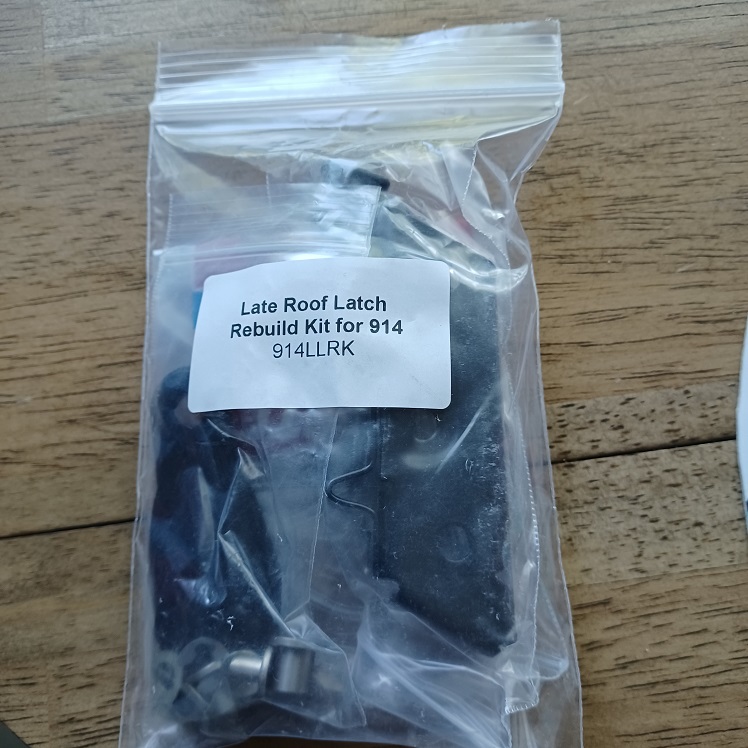

Didn't get anything too exciting done on the car today. A bit of hand sanding....But i did get some cool stuff from 914 Rubber... (IMG:style_emoticons/default/aktion035.gif)

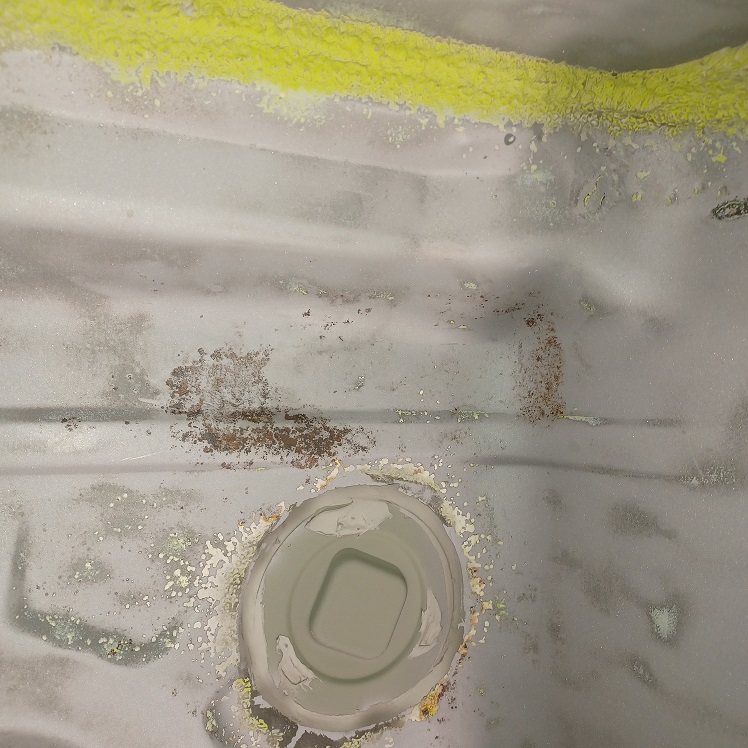

Today I decided to start addressing body issues that will be mostly out of sight out of mind. In the front trunk there is an area of rust that did not come completely clean during blasting. This got treated with Ospho rust converter.

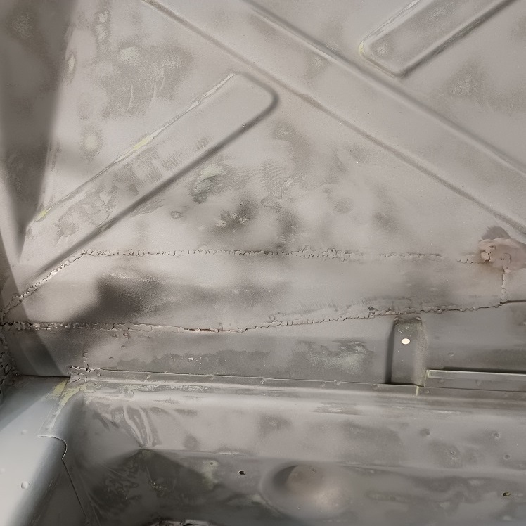

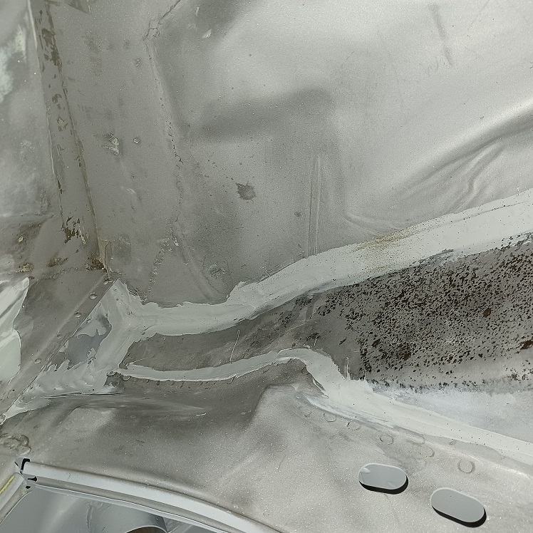

Then I decided to address the patch that had been put in by the PO on the passenger firewall. The seams are solid, but not pretty. So I decided to cover the top seam with body filler. The lower seam gets seam sealer.
Puebloswatcop
post Apr 27 2022, 05:27 PM
Post #492
Posts: 1,609
Member No.: 18,258
Got the first layer of filler on the top seam. Still plenty of shaping and sanding to do.

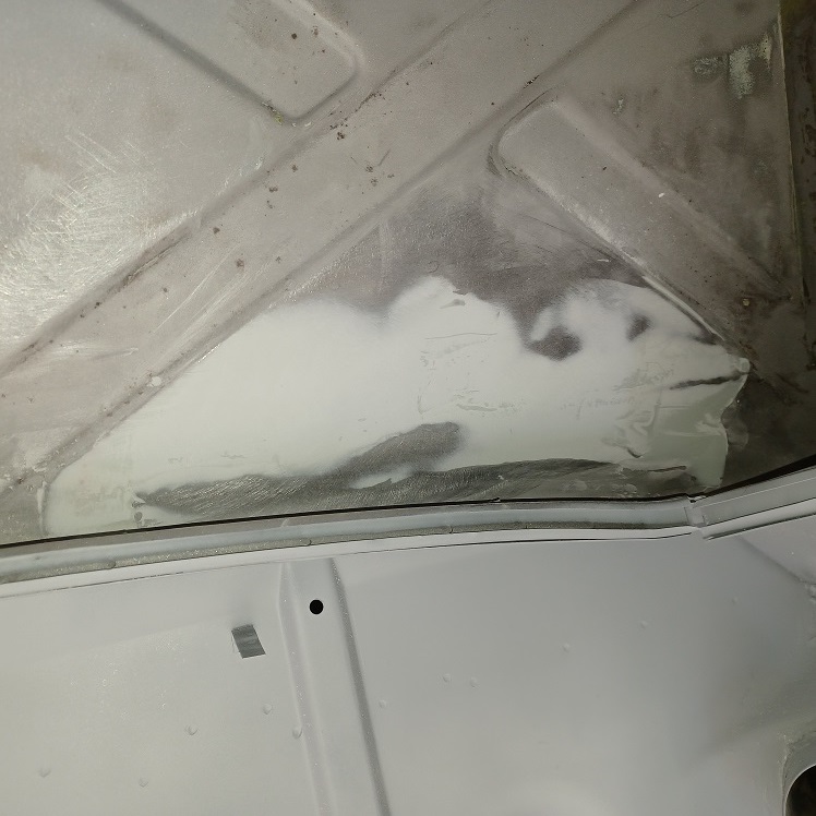

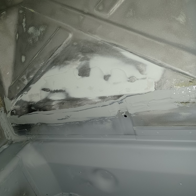

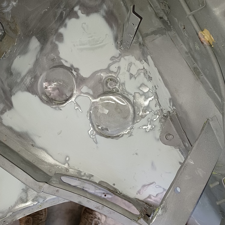

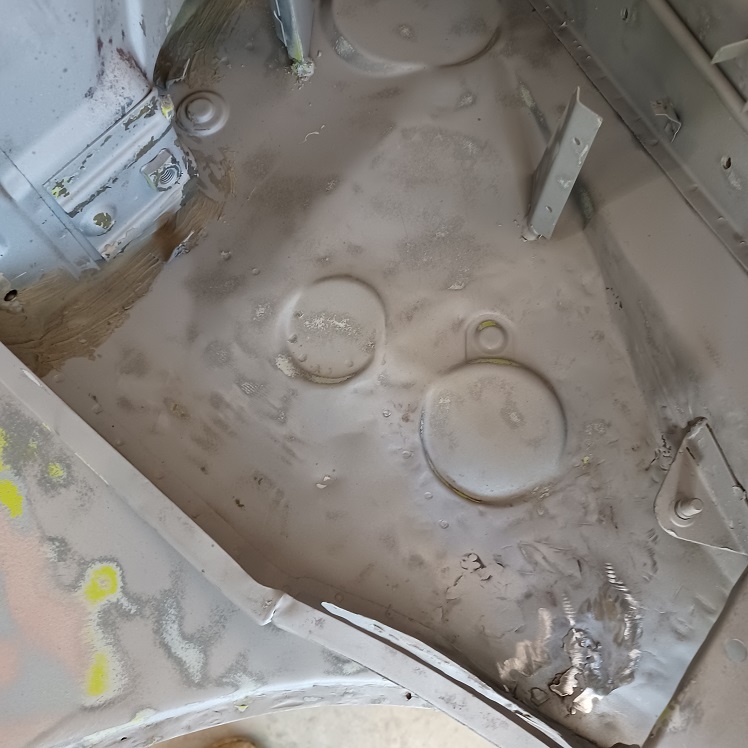

Another area of damage from a prior collision was the rear inner engine wall. The repair to the quarter panel was actually done quite well. But they didn't replace the inner wall. They just hammered out most of the krinkles and it was filled with layer upon layer of high build primer. So I wanted to fill the real deep stuff with filler.
Puebloswatcop
post Apr 27 2022, 05:34 PM
Post #495
Posts: 1,609
Member No.: 18,258
First coating filled most of the deep creases...I think a skim coat then using high build primer will help the appearance in the end.

Didn't want to do the second coats of filler today, so took a little time to fill some seams.
The lower seam on the firewall. I tried to stipple it so it would look somewhat original, but that turned into a total mess, so I just finished it smooth, will see if I can come up with an idea to change the appearance to resemble spray on sealer....

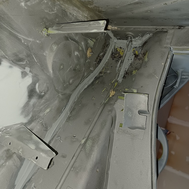

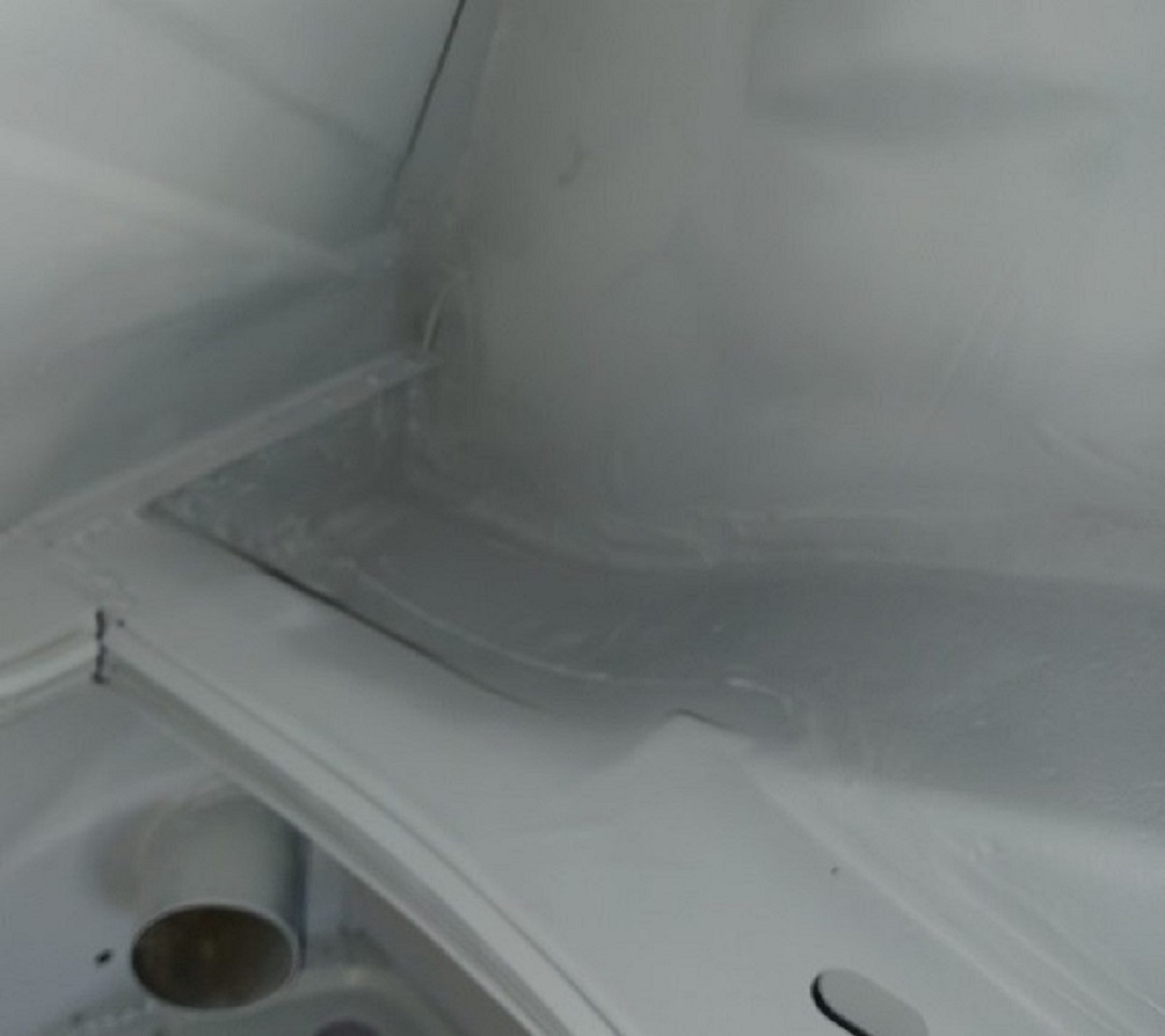

Then with what was left in the tube of sealer, I started in the hell hole areas. Notice that in the right hell hole, Bkrantz's prediction of blast media sneaking out of somewhere has come true....

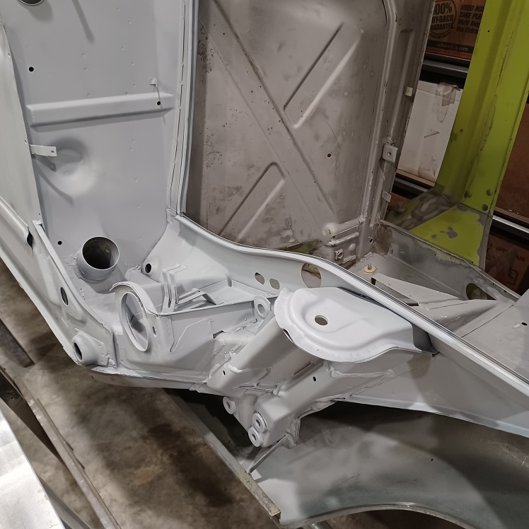

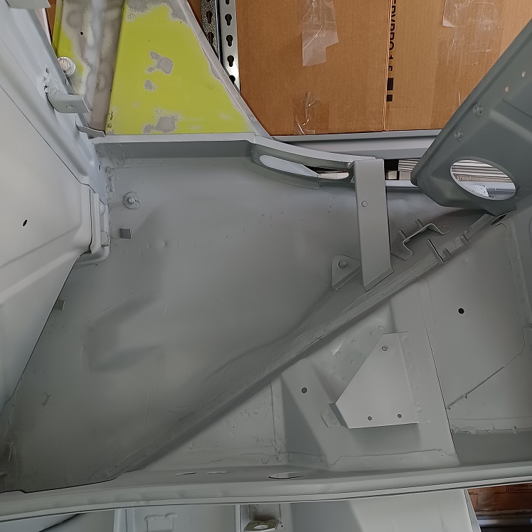

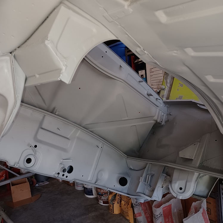

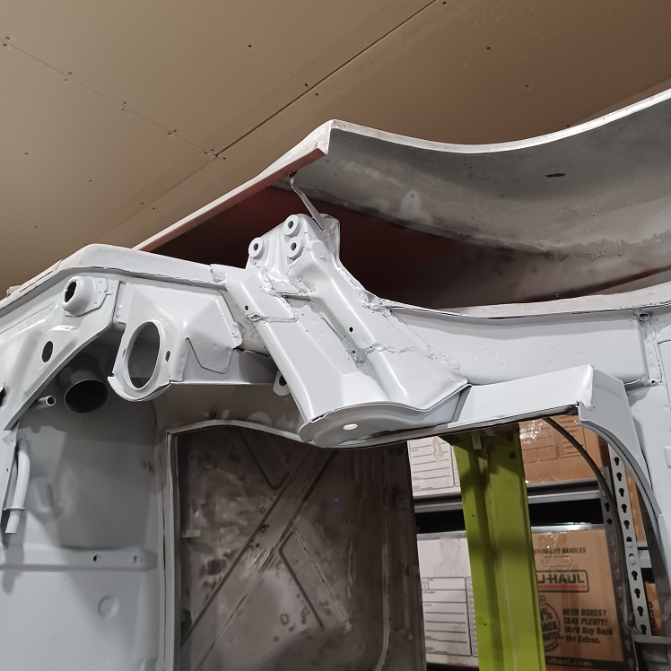

Well this week has been a bit slow for car fun, been preparing for a family visit. But I did get most of the engine compartment done. Still a bit to do on the driver's side hell hole.
Puebloswatcop
post May 4 2022, 03:41 PM
Post #499
Posts: 1,609
Member No.: 18,258
Passenger side hell hole and inner wall.
bkrantz
post May 4 2022, 07:37 PM
Post #500
Posts: 8,461
Joined: 3-August 19
From: SW Colorado
Member No.: 23,343
That looks nice.
