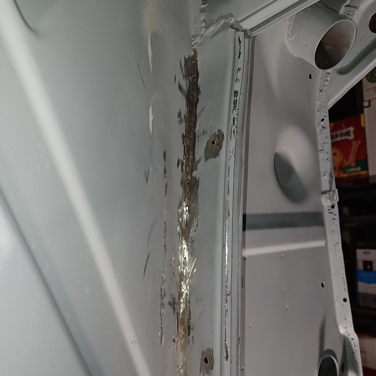

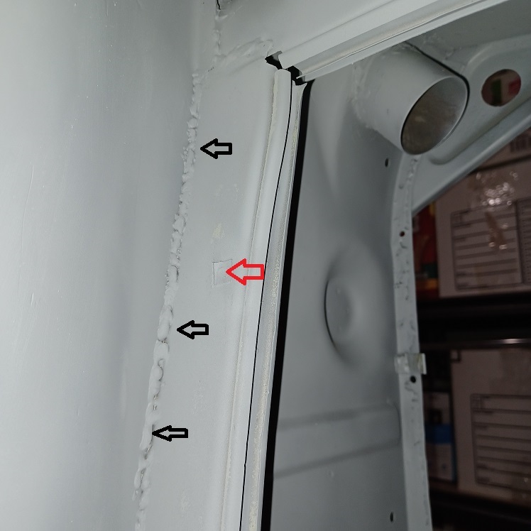

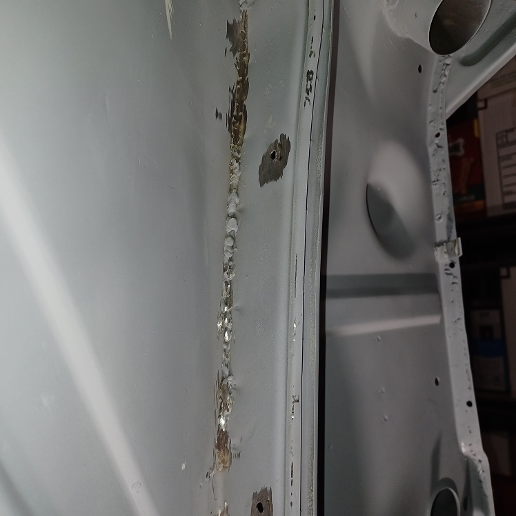

You can see in the pic how rough the weld seem was from the firewall repair. Also the red arrow shows where one of the two metal tabs that hold the wire harness in place have broken off

Started smothing off the weld line, however the only cutoff wheel that I had was a 3", and I needed something larger. You can also see where I ground off the broken tabs and drilled holes to weld in the new ones.

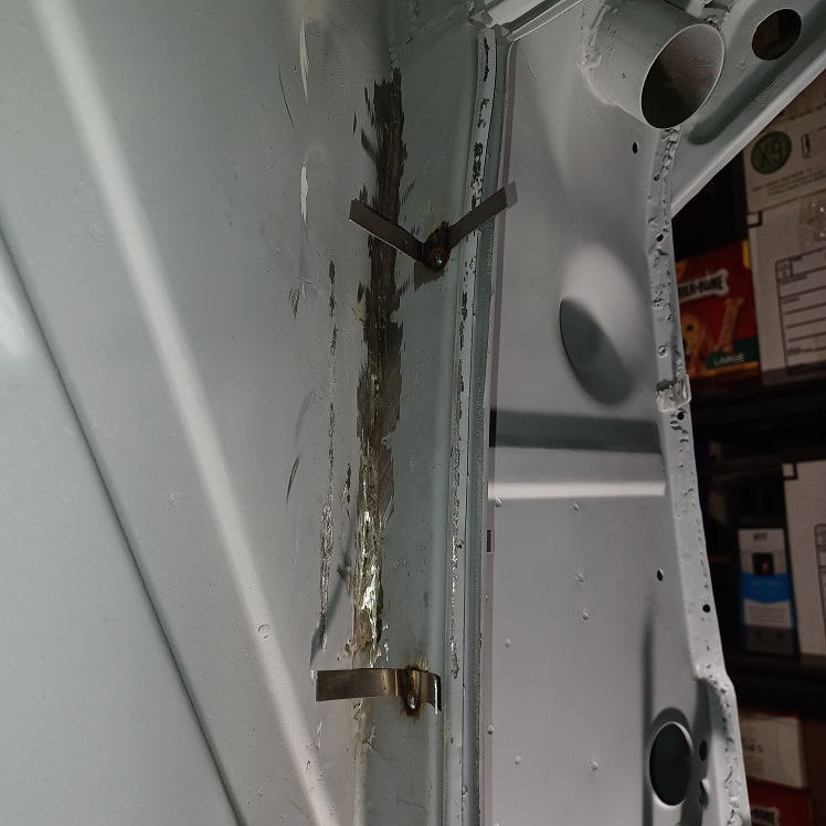

The grinder I had wont allow me into that tight corner either, so I went and bought a 4" Disk and that did the trick.

I then cut 2 metal tabs out of 22 Ga. metal and welded them in place.

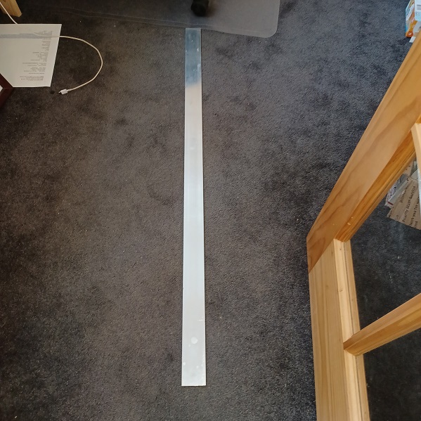

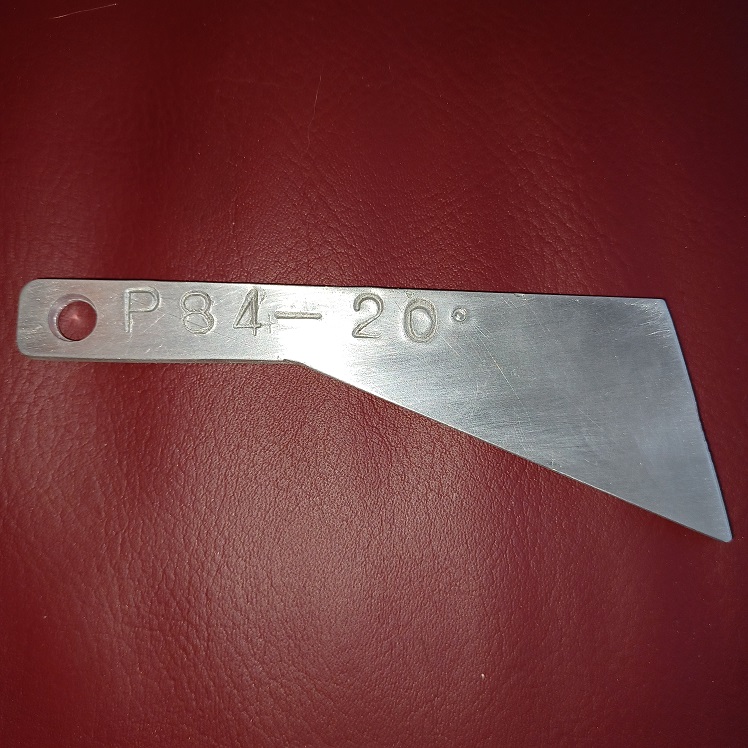

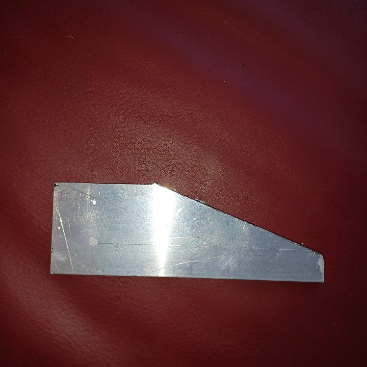

Since the list was done and I have been working on the brakes I decided to go back to work on those. I have been trying to locate a piston alignment tool and the only one I could find was in England and it was $19.00 plus shipping. I contacted ATE and they said the tool does not exist.
So, I decided to make my own. I wanted to make it a rust free tool since it will be exposed to brake fluid repeatedly, So I got a piece of 3/16" aluminum bar stock.
Puebloswatcop
post Jun 9 2022, 02:27 PM
Post #548
Posts: 1,609
Joined: 27-December 14
From: Mineola, Texas
Member No.: 18,258
The tool has to be cut for a 20 degree angle to get the proper caliper alignment in the front roters. So I used a scribe to make the appropriate angles (hard to see the lines, but they are there).
Puebloswatcop
post Jun 9 2022, 02:31 PM
Post #549
Posts: 1,609
Member No.: 18,258
And after about an hour of cutting and final shaping I now have my own guage.
If anyone is interested I have plenty of bar stock left, so I could make more of these and I think I would sell them for about $10.00 plus shipping.

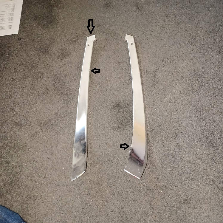

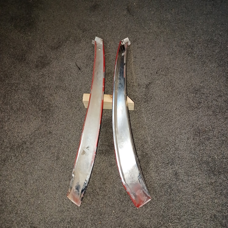

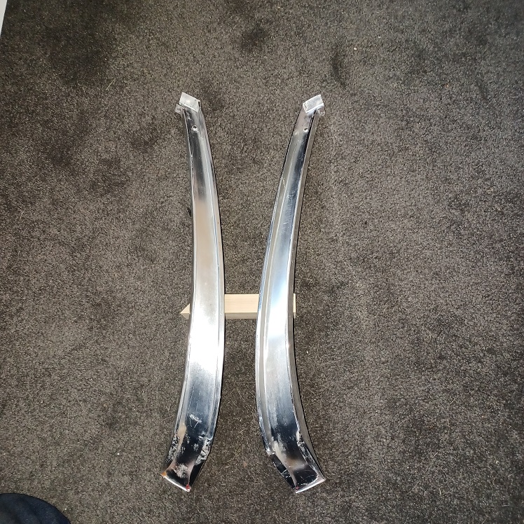

Didn't get much done today. Worked on cleaning up some parts such as the rear window sail trim. This set had plenty of overspray on them and a few dents that needed to be fixed. They have several scratches as well. Wont ever be show pieces, but might be good for a daily driver.
Puebloswatcop
post Jun 10 2022, 06:51 PM
Post #552
Posts: 1,609
Member No.: 18,258

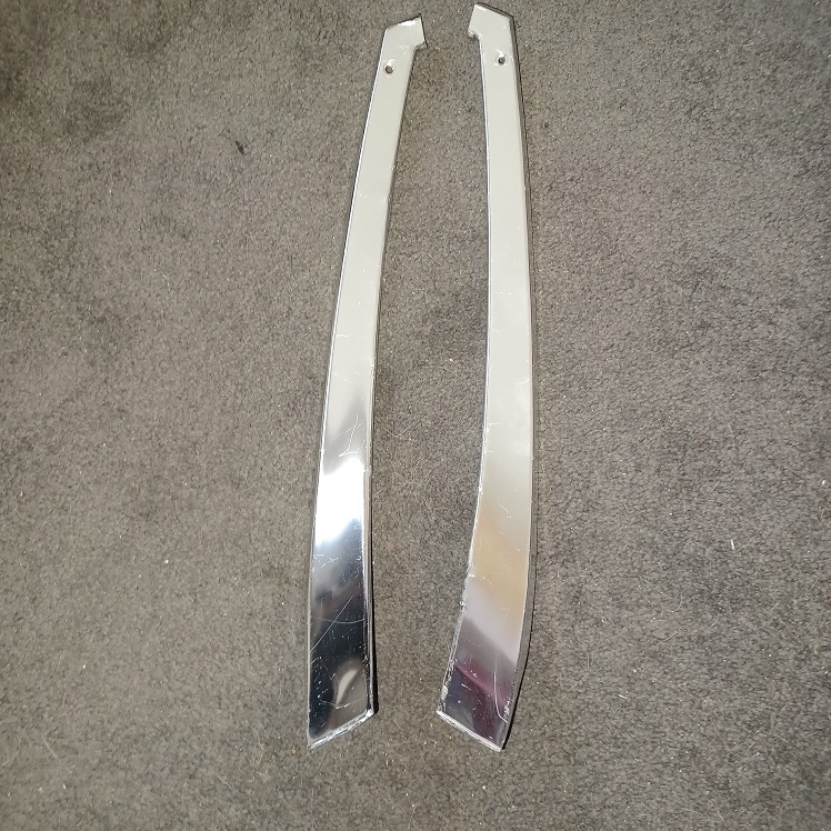

Was able to get the dents out (there are still marks where some used to be), and got all of the overspray off. Now I just need to see if I can buff the scratches out...

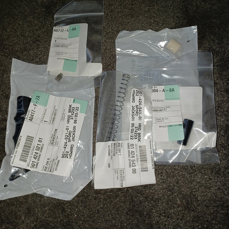

On a high note, all of the parts I needed for my e-brake handle rebuild came today....the low note....Have to wait for some of the other parts to come back from being plated before I can get it rebuilt...

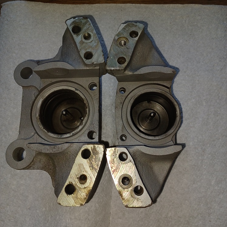

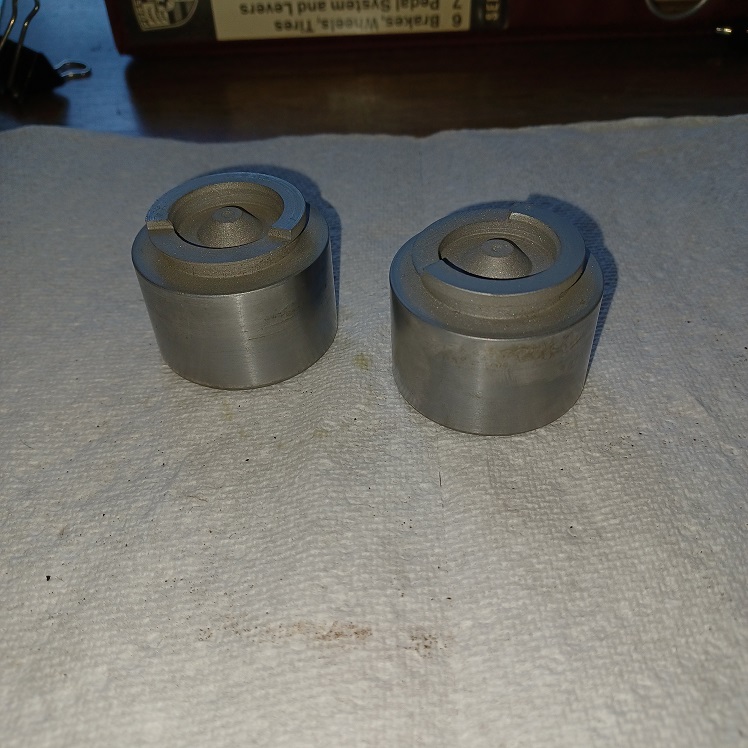

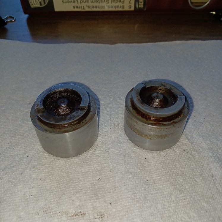

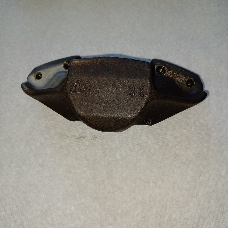

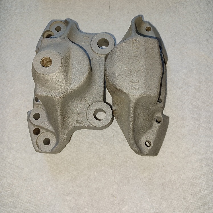

Thanks to Doug (Literati914), I got another front caliper donated to replace the one with the broken bleeder in it, so now that can be addressed later.
After 3 days of soaking and trying to free the pistons in the caliper, I have success. The caliper was pretty rusty and dirty...I forgot to include the other half in the photo before blasting, but you get the idea....yuk
Puebloswatcop
post Jun 11 2022, 03:45 PM
Post #555
Posts: 1,609
Member No.: 18,258
All blasted clean, just need to clean and hone the piston cylinders

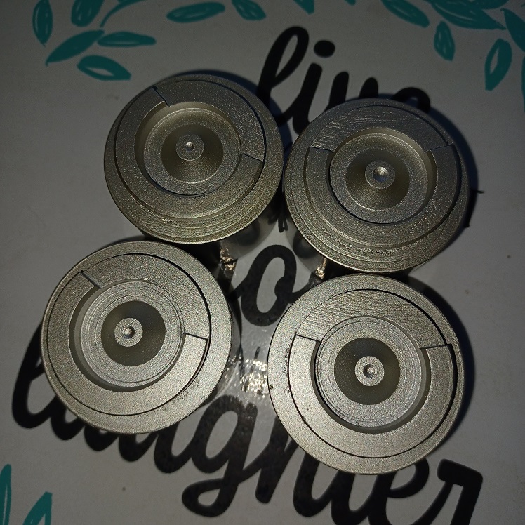

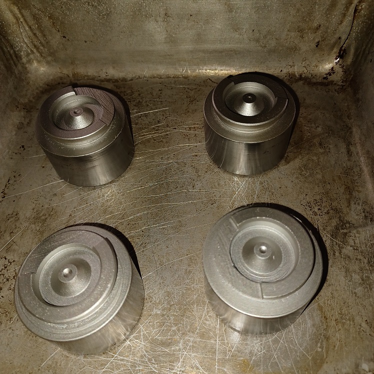

And of course the pistons soaked all day. But even after that they looked pretty bad. But a good cleaning and blasting of the faces and they are ready for VHT Paint.
