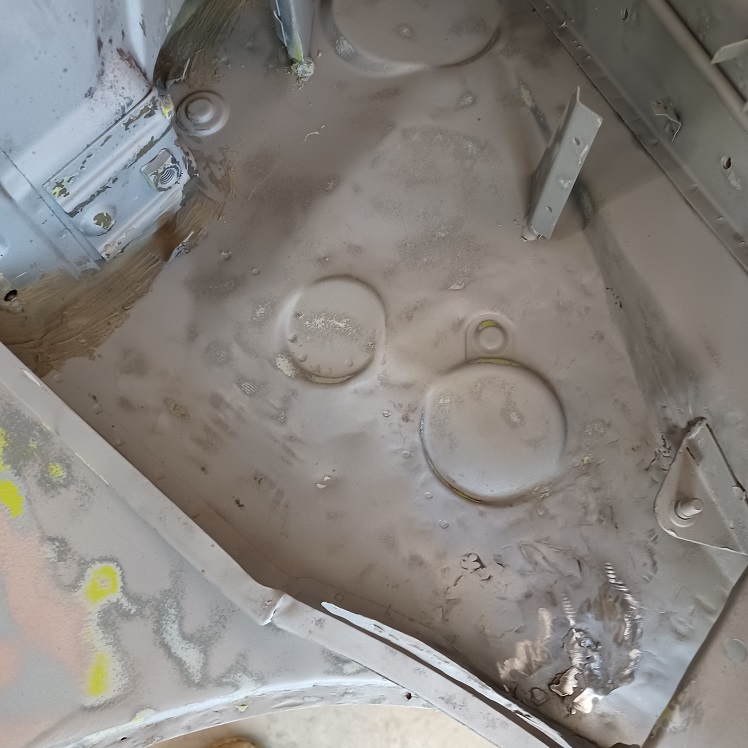

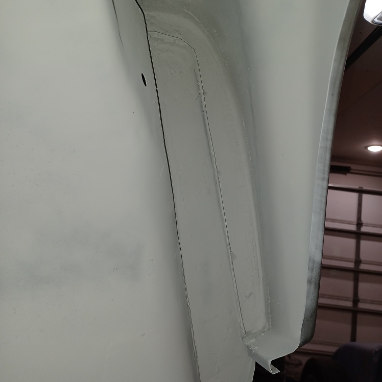

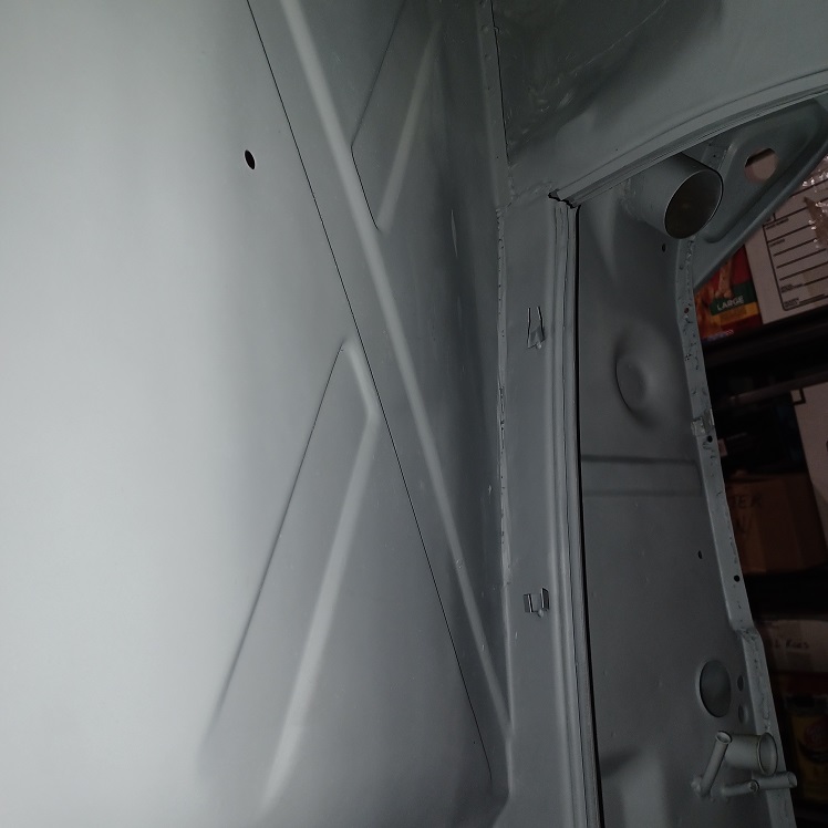

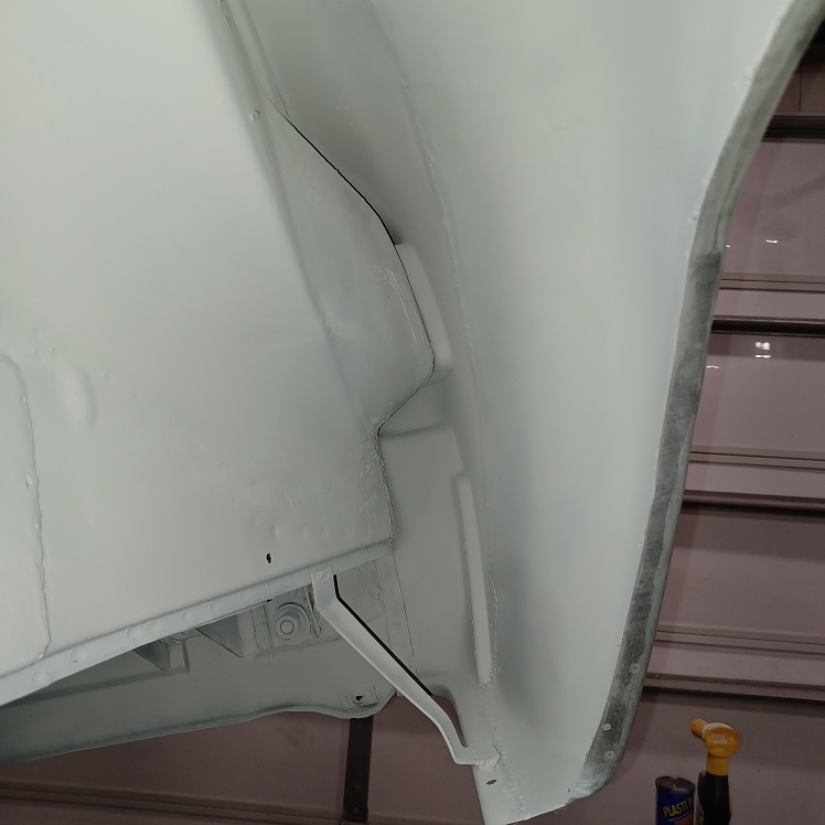

Then I worked a bit more trying to get the inner wheel housing which was damaged in the previous accident as straight as I could get it. The first photo showes the damage after the first round of hammer and dolly work, the second is after the work was completed....
Puebloswatcop
post Jun 15 2022, 11:48 AM
Post #582
Posts: 1,609
Joined: 27-December 14
From: Mineola, Texas
Member No.: 18,258

So, lastly I Finished the area where the lower firewall repair was made and the two wiring harness retainers were welded back in...
That makes the engine compartment pretty much done, with the exception of fine tuning some of the body work and paint.

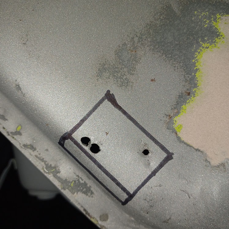

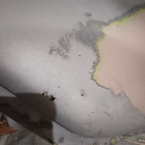

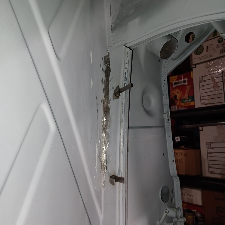

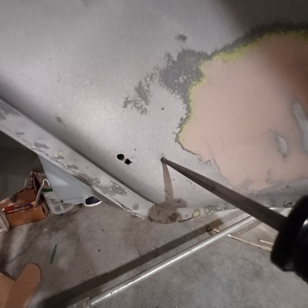

Had a minor setback today when I went to remove what I thought was a grease spot in the drivers side front wwheel well. Disovered that light was coming through....yes, yet antother rust hole.
Puebloswatcop
post Jun 16 2022, 09:40 AM
Post #585
Posts: 1,609
Member No.: 18,258

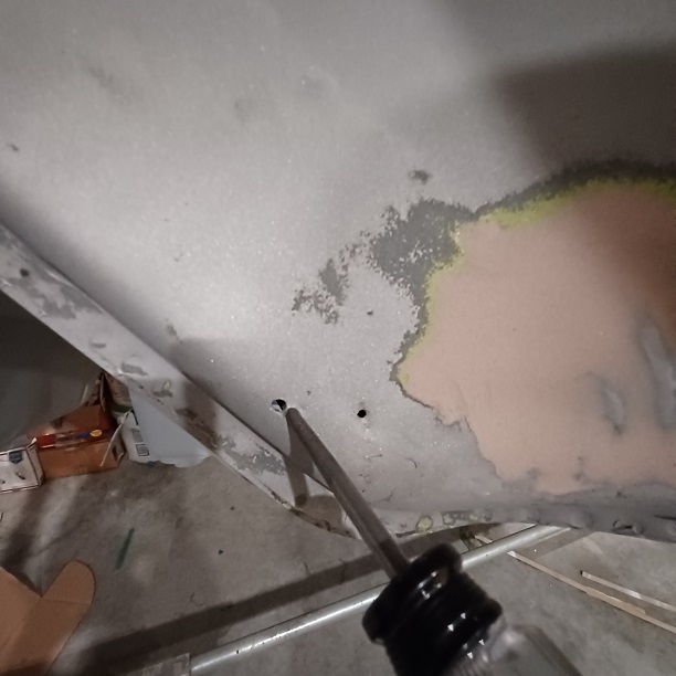

So I got out the ice pick and hammer and started probing. Luckily its not a large area, so a minor repair.
Puebloswatcop
post Jun 16 2022, 09:41 AM
Post #586
Posts: 1,609
Member No.: 18,258

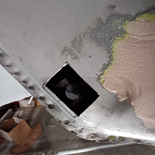

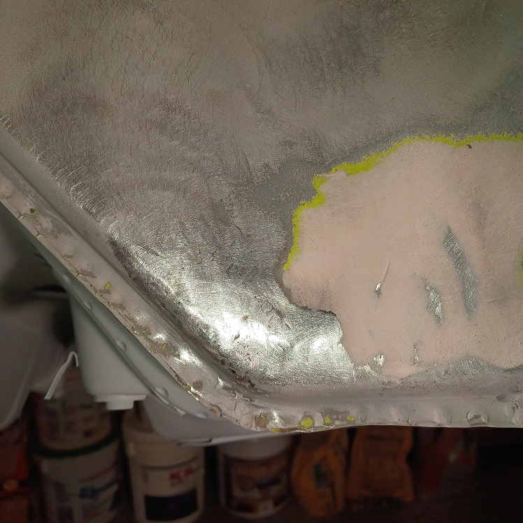

Cut out the rusted portion...
Puebloswatcop
post Jun 16 2022, 09:43 AM
Post #587
Posts: 1,609
Member No.: 18,258
And welded in the new patch. (IMG:style_emoticons/default/welder.gif)

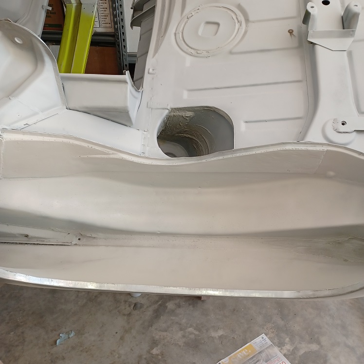

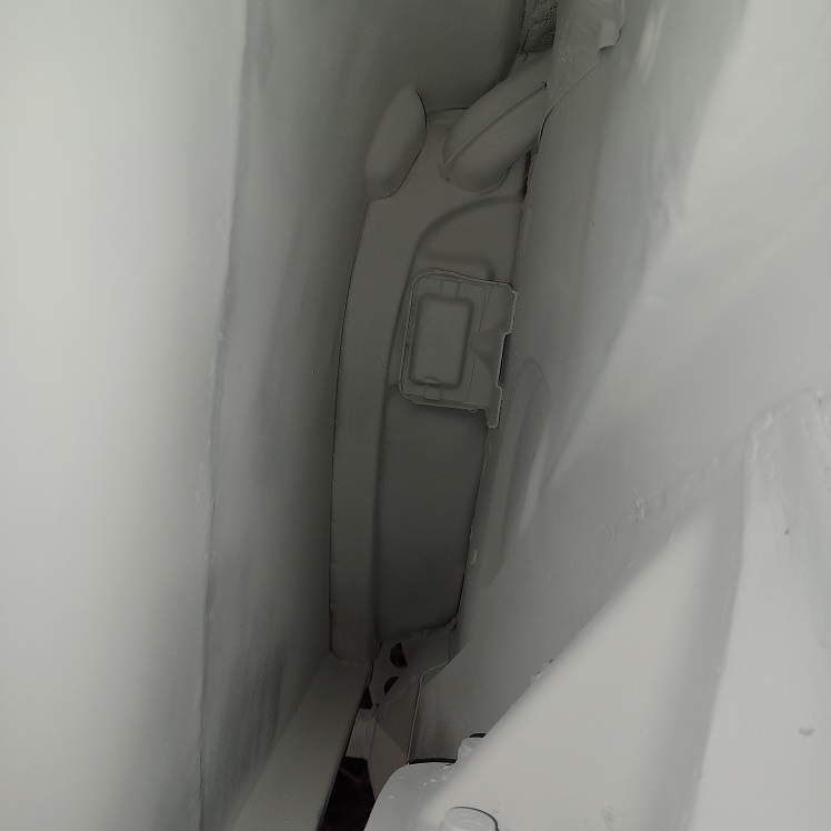

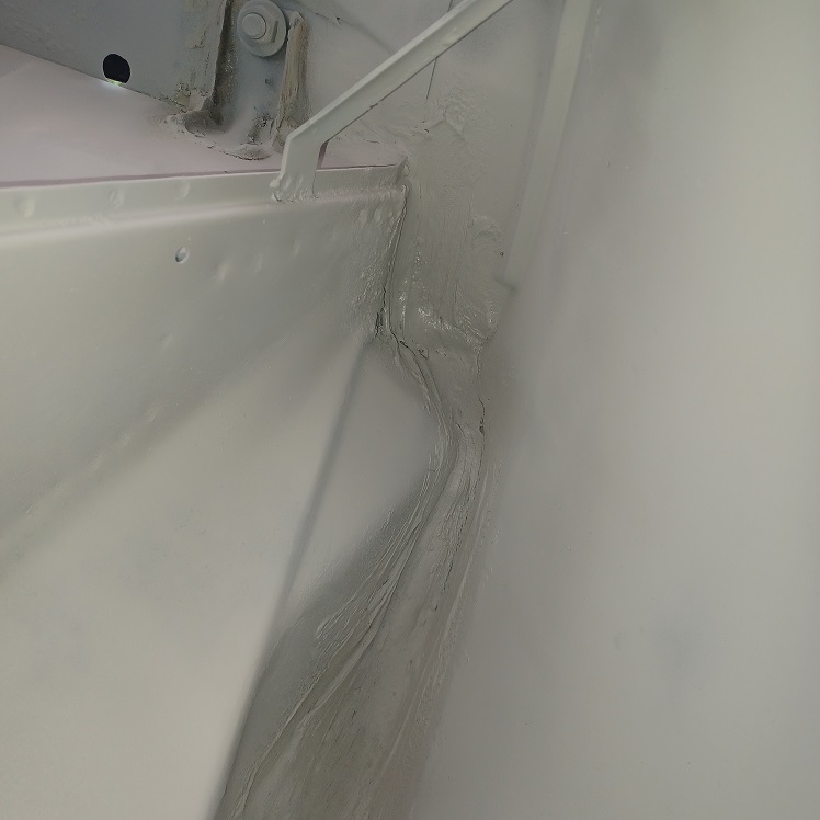

To finish off the day I got one of the rear wheel wells painted with Epoxy paint. Hard to get everything in those cramped sapces, but another wheel well down, 2 more to go.

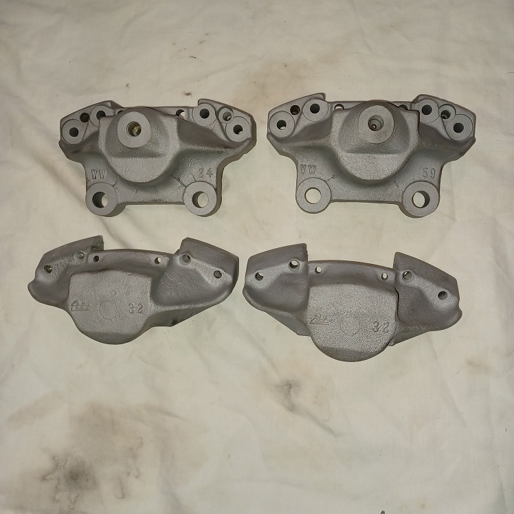

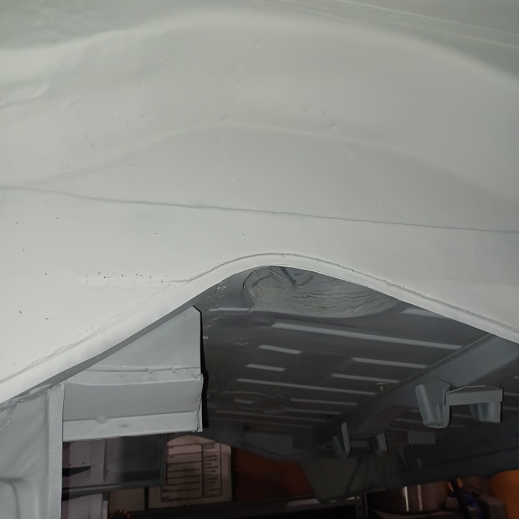

So finished up the week with a few odds and ends done. The front calipers have been cleaned, blasted and are ready to go to the Plater..
Puebloswatcop
post Jun 19 2022, 01:50 PM
Post #594
Posts: 1,609
Member No.: 18,258

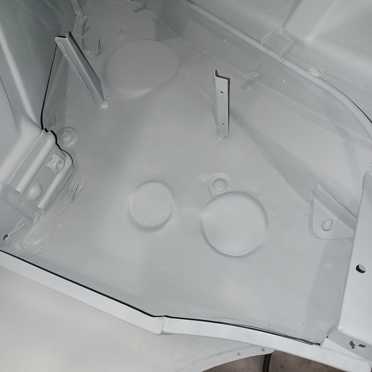

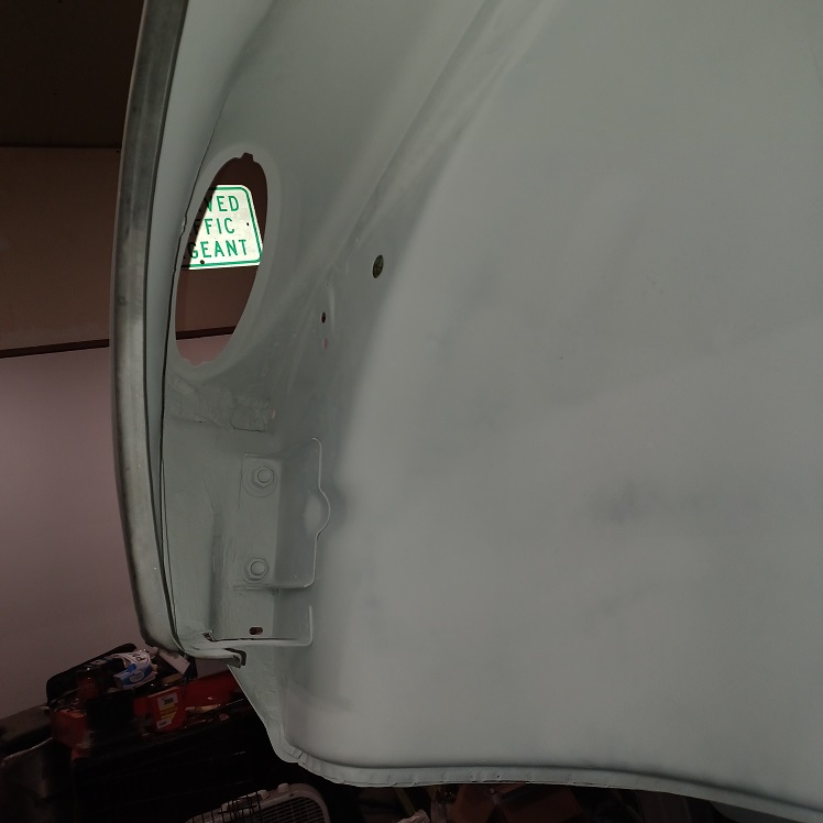

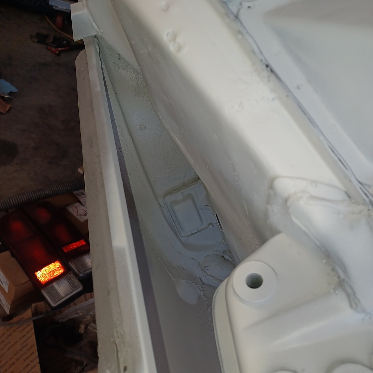

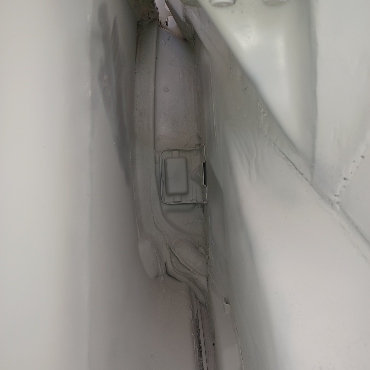

And the two drivers side wheel wells and the rocker are now painted in epoxy primer.
Front

Drivers side rear

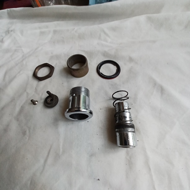

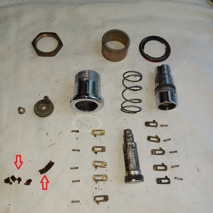

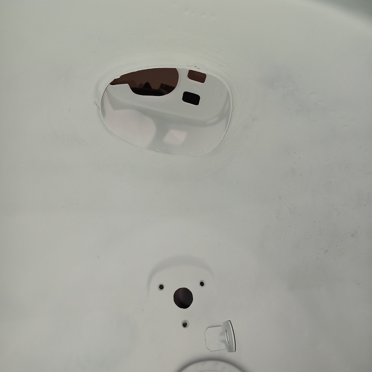

Then since I was bored I decided to tinker around with the trunk lock. Figured I would tear in apart and clean it up. I don't understand why when some people repaint their cars, they dont remove, or at least properly mask things. As you can see there is red overspray on the gasket, guess I will replace that.
Puebloswatcop
post Jun 19 2022, 02:11 PM
Post #597
Posts: 1,609
Member No.: 18,258

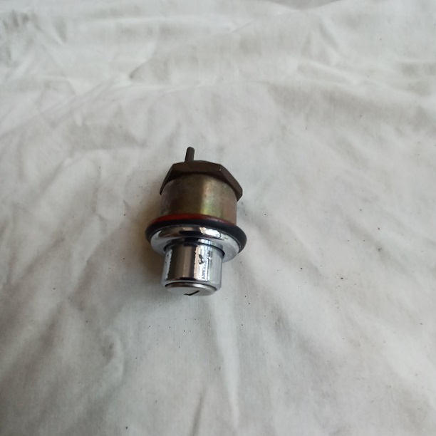

So, this is the first trunk lock I have torn all the way down. It is kind of an interesting puzzle. First you have to take the mounting nut and sleeve off of the cylinder, Then you can start taking apart the cylinder itself. Unbelievable what 50 year old locks are gooed up with. NASTY
Puebloswatcop
post Jun 19 2022, 02:27 PM
Post #598
Posts: 1,609
Member No.: 18,258

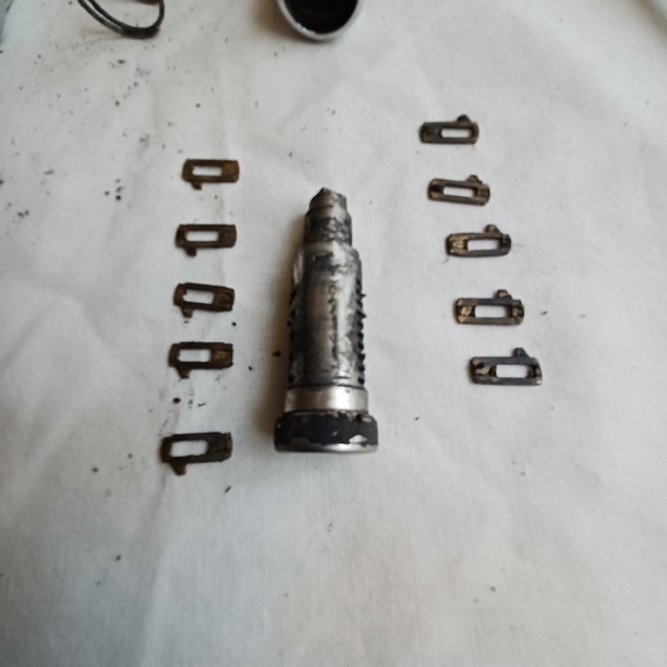

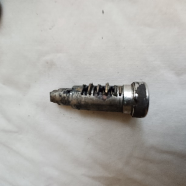

Then I moved into the key cylinder itself. It was so gummed up, none of the wafers or springs would come out without having to use tools to pull them out.
Puebloswatcop
post Jun 19 2022, 02:43 PM
Post #599
Posts: 1,609
Member No.: 18,258

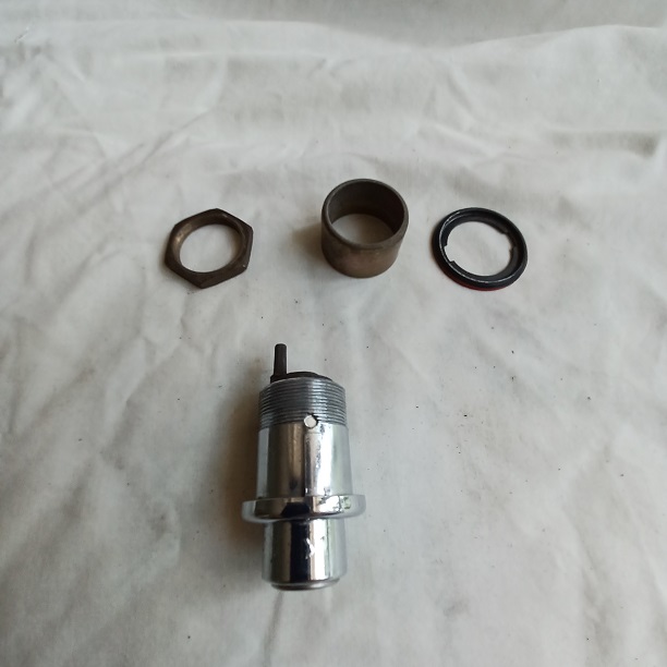

I didn't realize just how many parts there are in that one simple lock. The rubber collar that goes between the lock cyliner and the housing just crumbled (red arrows). I reached out to Cabinetmaker and he informed me that this collar is available from 914 rubber and its now aluminum, so I guess I will order a few of those next week.

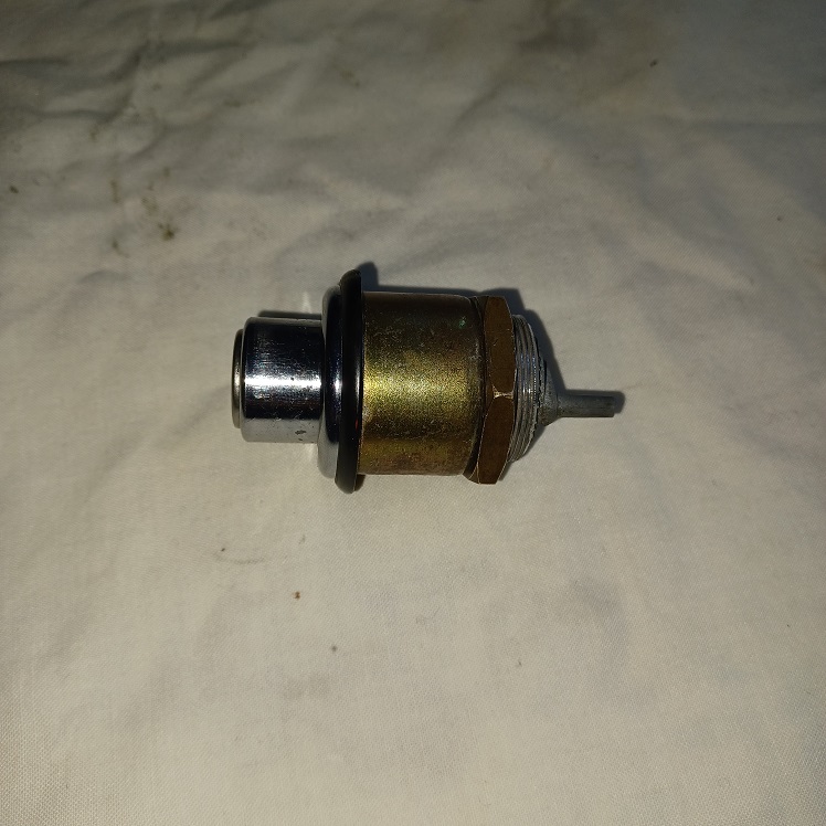

You can see a definate difference from before cleaning to after cleaning....lol
Puebloswatcop
post Jun 19 2022, 02:48 PM
Post #600
Posts: 1,609
Member No.: 18,258

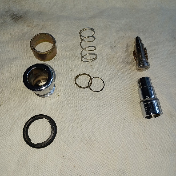

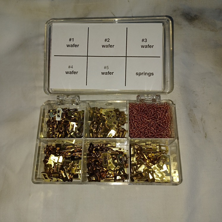

while I was at it I decided to re-key it so both of my 914s are keyed the same. So all new wafers and springs...and I was able to get the red overspray off of the gasket. So I have temporarily re-assembled the lock and will replace the collar when it arrives.
