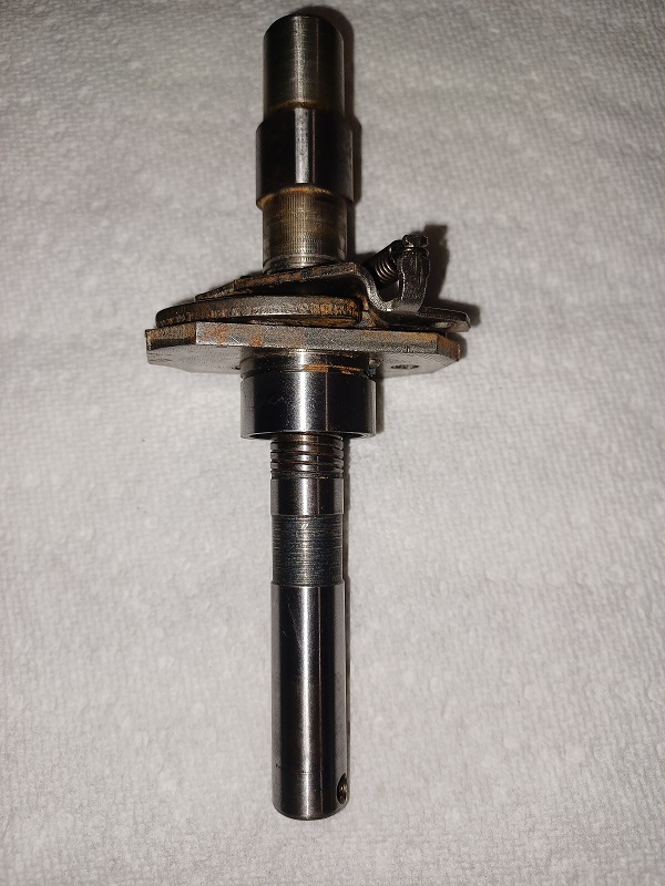

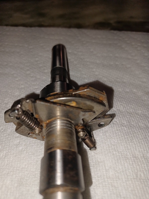

Next up...the main shaft. This had some minor rust and hardened grease on it. There is a center ring in the top of the shaft that can be removed allowing the entire assembly to be taken apart. However I chose to forgo tearing this mechanism apart. Instead I used pipe cleaners and PB Blaster to clean the parts, then sprayed the remnant debris out with carburator cleaner. All of the bearing contact surfaces were polished using 4-0 steel wool.

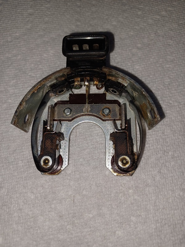

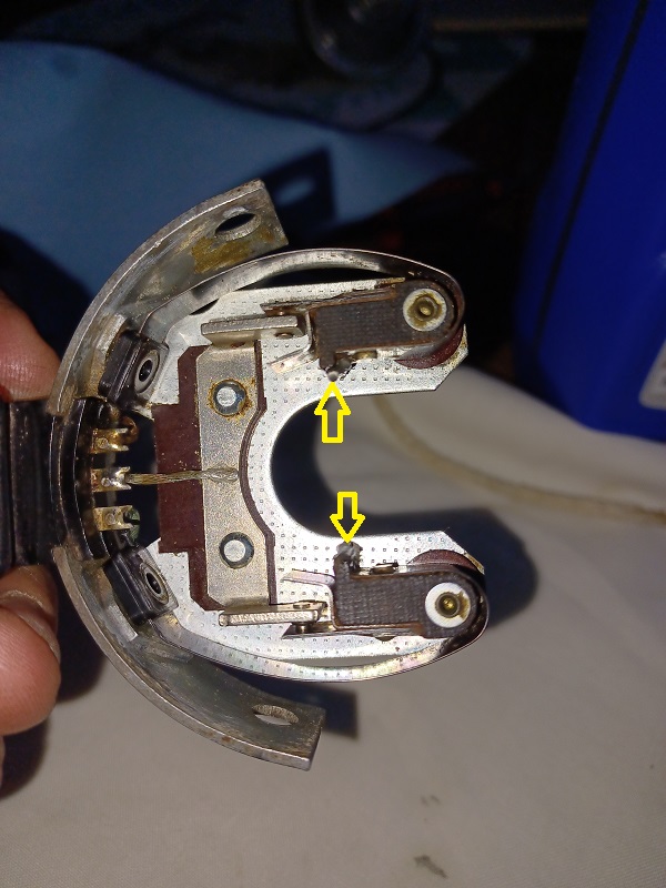

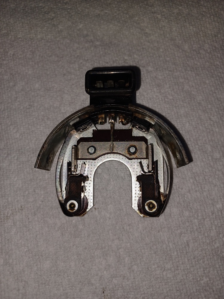

The FI breaker points weren't too bad, but I cleaned them using carb cleaner to get all the nasty grease off of them then used electric contact cleaner to clean the entire assembly.

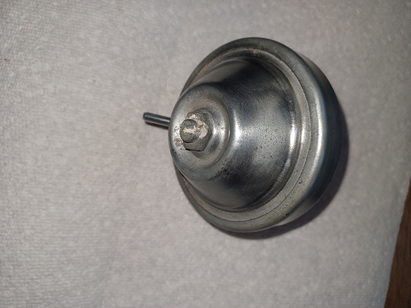

Lastly I polishedup the vacuum canister....so now that everything is clean I can start re-assembly.

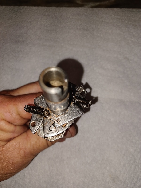

QUOTE(Puebloswatcop @ Aug 9 2022, 02:31 AM) *

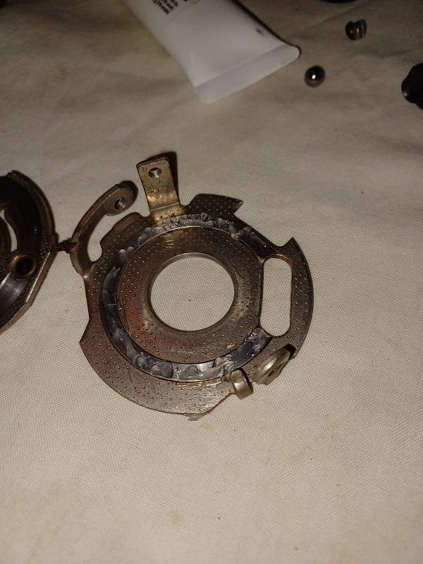

The inside of the distributor is dirty with a combination of old lube, dirt and some minor rust. After removing the breaker points I removed the mounting/advance plate as well. (sorry for the poor pic quality)
IMO the advance plate is usually the main cause of sticking advance,rust and crap get between the sliding plates so its not just a matter of a bit of spray lube because due to the fit of these parts it simply won't get in there.
The vacuum canister is overcome by the friction and causes slow or no advance and the same issue on retard often resulting in high idle as one example.
I used to overhaul Bosch VW units and found this is common with the "205" units,you have done this overhaul correctly ,well done,keep up the good work.

QUOTE(porschetub @ Aug 10 2022, 03:18 PM) *
Thanks for the compliment. Thats my feeling as well. Wether I use this distributor or pass it to someone else, I want it to be done correctly, so that it is a plus and not a detriment. Those sliding plates have a large surface interface, so just spraying in some lousy lube and expecting it to be successful is, IMHO, a foolish waste of time and money. I'd rather spend a little extra money and do the job correctly.

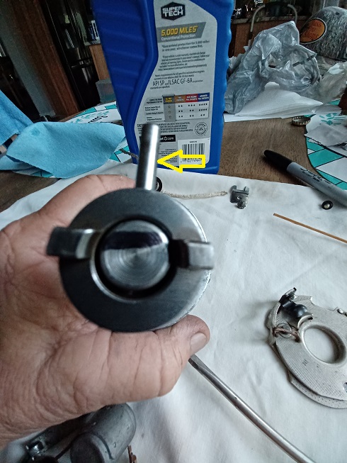

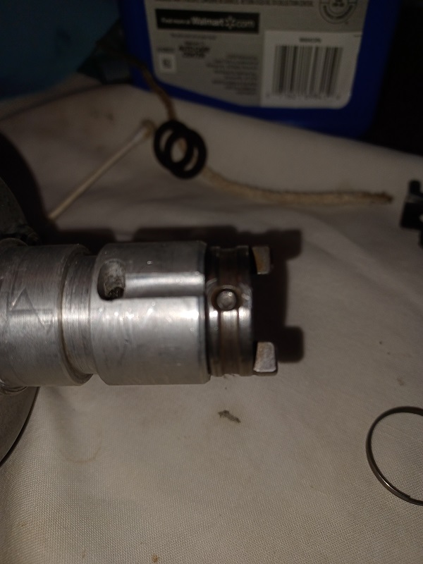

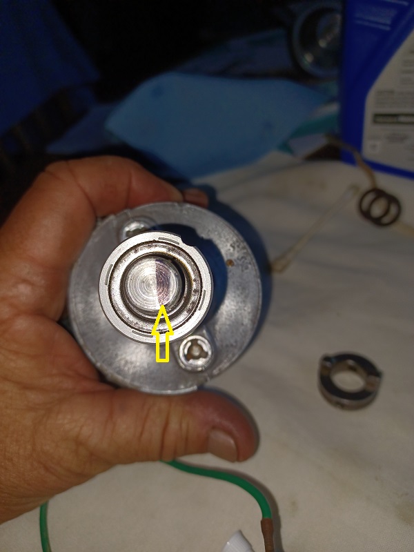

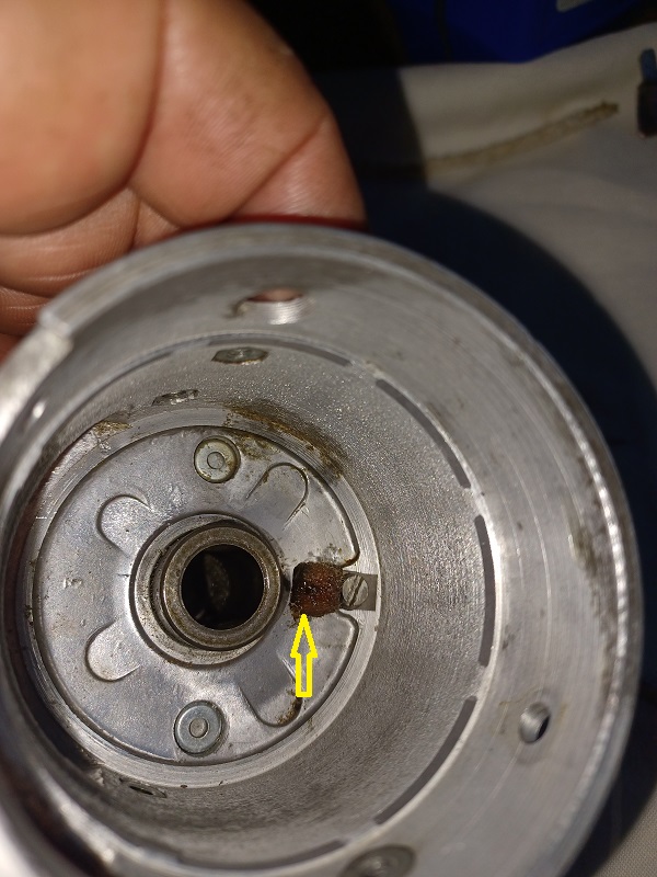

Starting with the distributor body, the first thing is to lubricate the pad in the bottom of the body. It just gets a few drops of motor oil, it is the pad that helps to keep the rotor portion of shaft that activates the trigger points for the fuel injection.
In addition to this lube, I did lightly lubricate the shaft with some of the grease. Then in accordance with the manual, I put a small amount of lubricant on each of the rubbing blocks of the trigger points.
Puebloswatcop
post Aug 12 2022, 08:25 PM
Post #771
Posts: 1,690
Joined: 27-December 14
From: Mineola, Texas
Member No.: 18,258

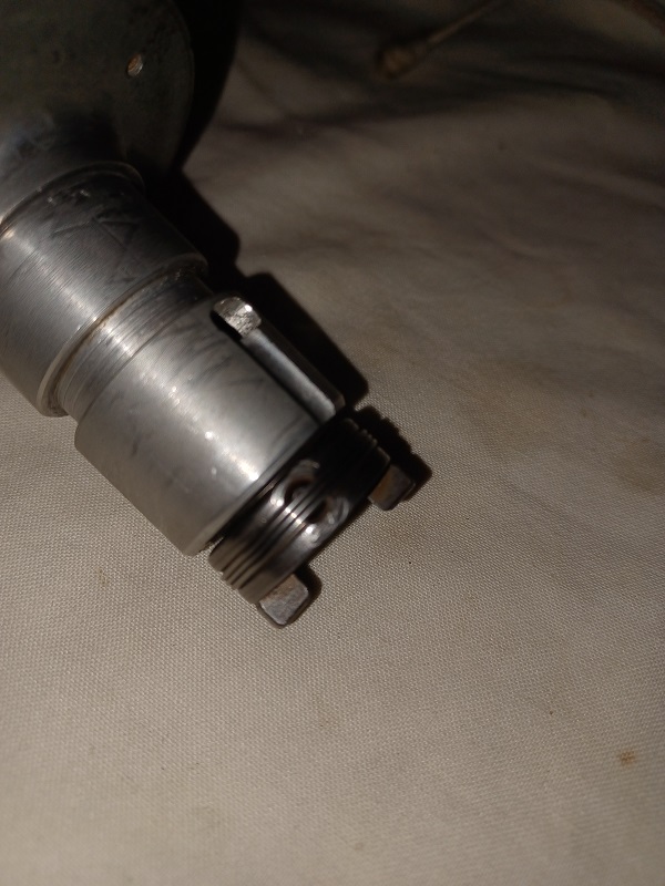

One important thing is to note that the distributor drive that engages the drive gear is not centered. So I made sure to mark the shaft as to its orientation. The scratch mark was hard to see in the picture so I used a sharpie to make it more visible.
Puebloswatcop
post Aug 12 2022, 08:31 PM
Post #772
Posts: 1,690
Member No.: 18,258

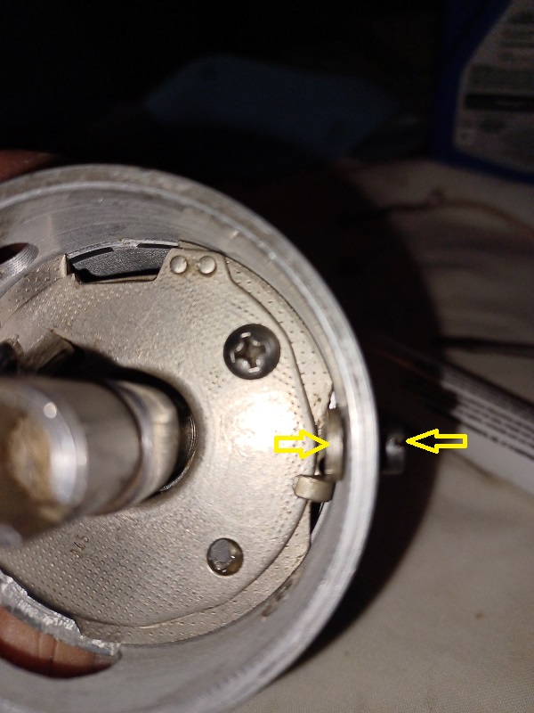

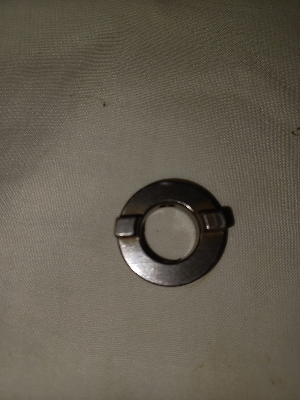

The next step is to re-insert the retaining pin. This pin free floats in the engagement ring but is a VERY tight fit in the distributor shaft. I recommend pressing the pin in. Unfortunately my press is not here, So I carefully used my bench vise with aluminum jaw covers to push it in, being careful not to pinch the bottom of the distributor body. (sorry no pic). Then used a punch to counter sink it and center the pin in the engagement ring
Puebloswatcop
post Aug 12 2022, 08:34 PM
Post #773
Posts: 1,690
Member No.: 18,258

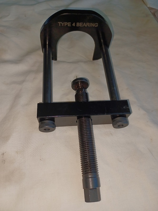

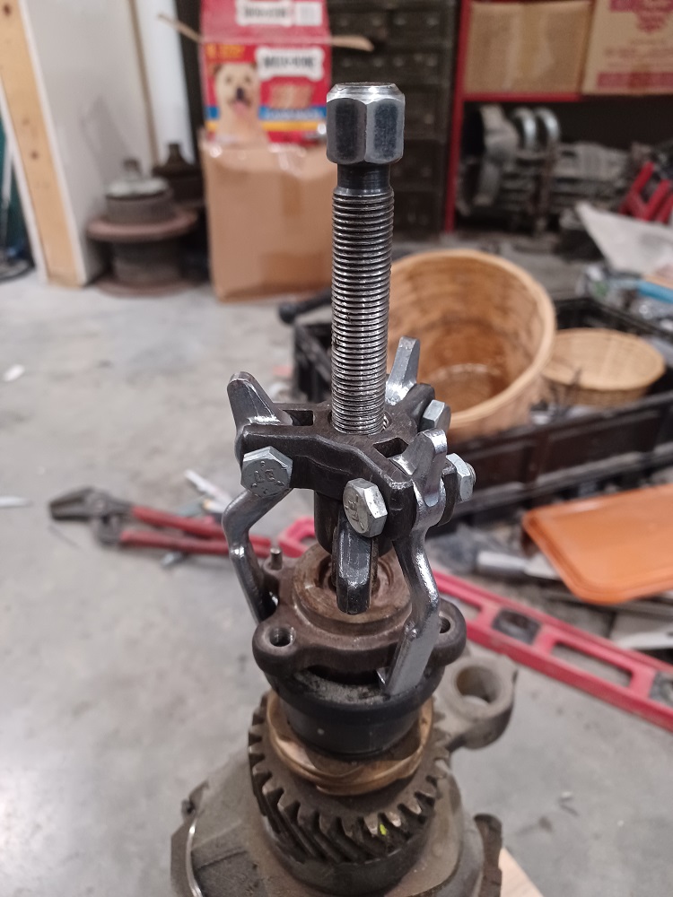

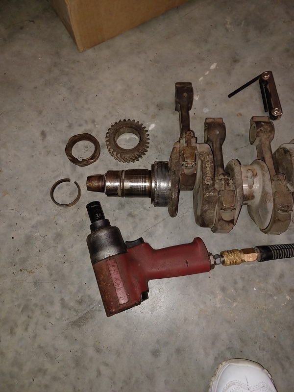

My new tool from Empi arrived today. It is the gear puller for the crankshft. Empi's Part number is 00-5714-01. On Empi's web site it sells for $131. Got it on Amazon for $82.
The quality seems to be top notch.
So of course I could not resist to try it out, feel like a kid at Christmas time....
Puebloswatcop
post Aug 15 2022, 12:00 PM
Post #778
Posts: 1,690
Member No.: 18,258

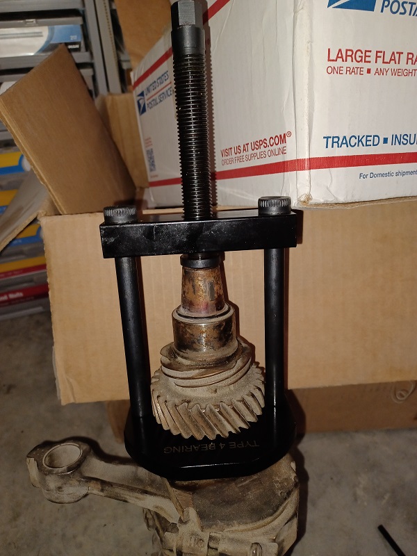

Of course it comes with no instructions, so when I first tried to install it on the crank gear, it wouldn't fit. Then I realized it does both type 1 and type 4 gear sets and of course was set up for type 1. Flipped the bottom plate over and walla, set up for type 4, and it slid right into place....
Puebloswatcop
post Aug 15 2022, 12:16 PM
Post #779
Posts: 1,690
Member No.: 18,258
It took me longer to get my airgun and socket (14mm) set up and ready to go than it did to remove the gear set. Definitly a great investment....Thanks Empi.

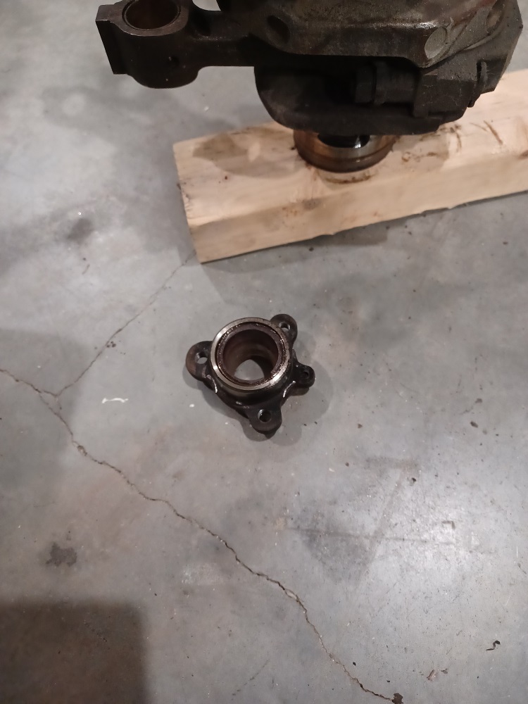

But now its back to work. So I decided to go ahead and pull the gears, etc. off of the other crank that was laying out in the garage. Before I could get to the gears though I had to pull the fan hub. So a 3 armed puller, a little heat and an impact wrench and done.
