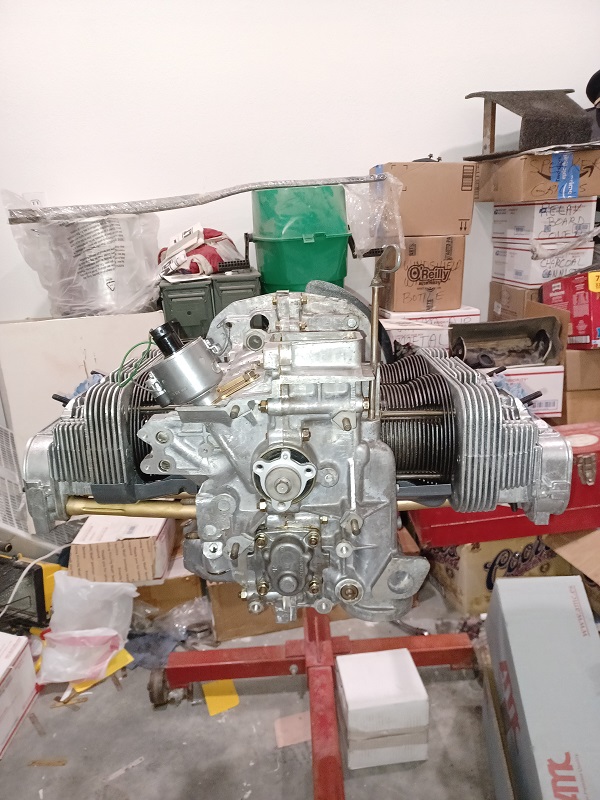

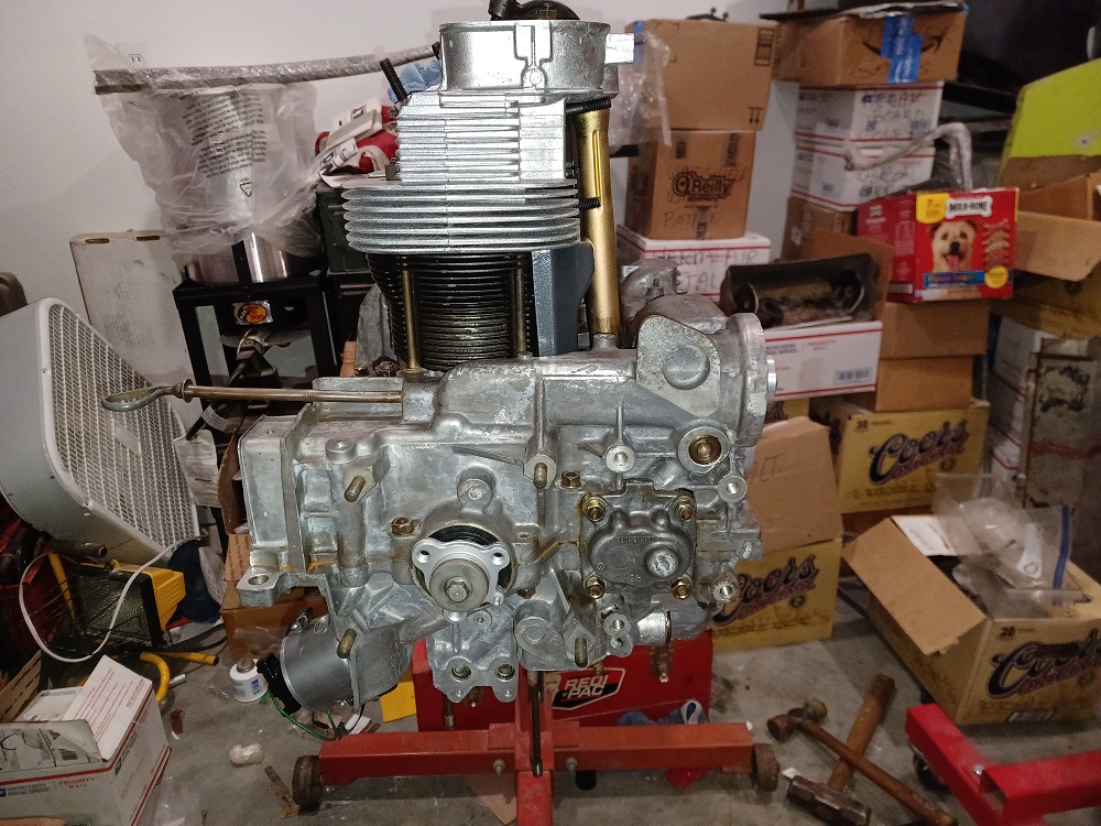

So half of the engine has been completed, the front is sealed up as well as #1 & #2 cylinders and the bottom of the engine....One side to go....

Again, this is my first air cooled engine build, so...PLEASE...if anyone sees anything I am missing, could do better or differently, feel free to chime in and share your experience with me, so I can get it right.....Thanks all. (IMG:style_emoticons/default/drunk.gif)

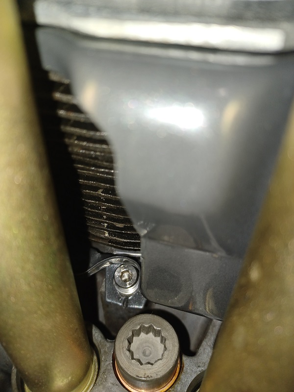

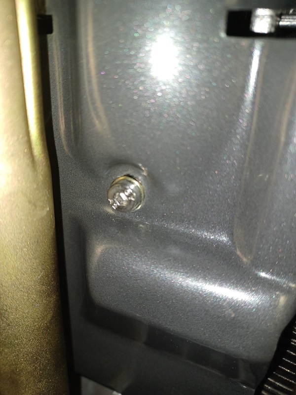

Belmetric comes through again.... I decided to go with all stainless, shallow head, allen screws for my engine tin. I just think they are easier to deal with and wont strip out as easily during installation and removal....And they have a nice clean look to them as well.

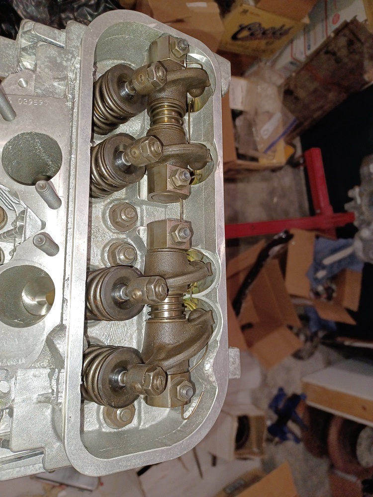

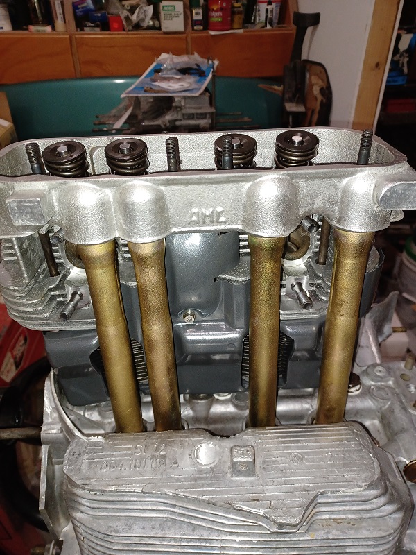

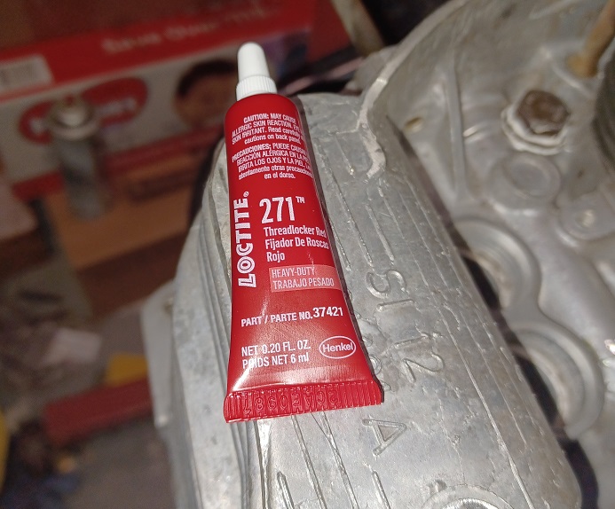

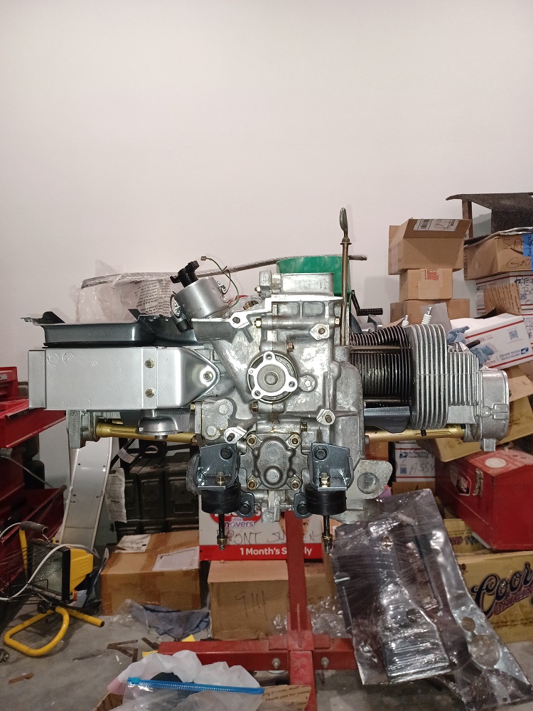

Didn't have allot of time this weekend to work on my pride and joy, but did get the other head put on. Started by installing all of the studs using Loctite 271 (red). After installing the last 2 pistons I also installed the engine tin that fits under the cylinders.
Puebloswatcop
post Dec 11 2022, 06:55 PM
Post #866
Posts: 1,690
Joined: 27-December 14
From: Mineola, Texas
Member No.: 18,258

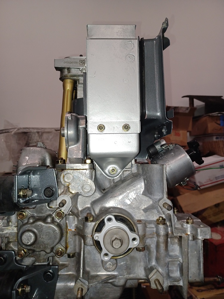

Then installed the pushrod tubes. It is actually starting to look like a real engine. Now I need to go through all those boxes in the background and find the other valve train componenets....

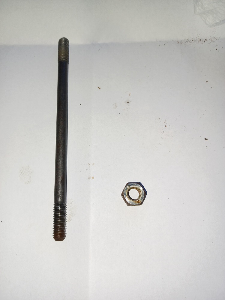

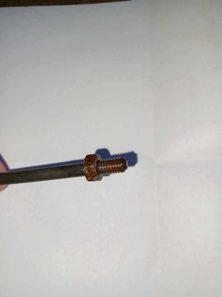

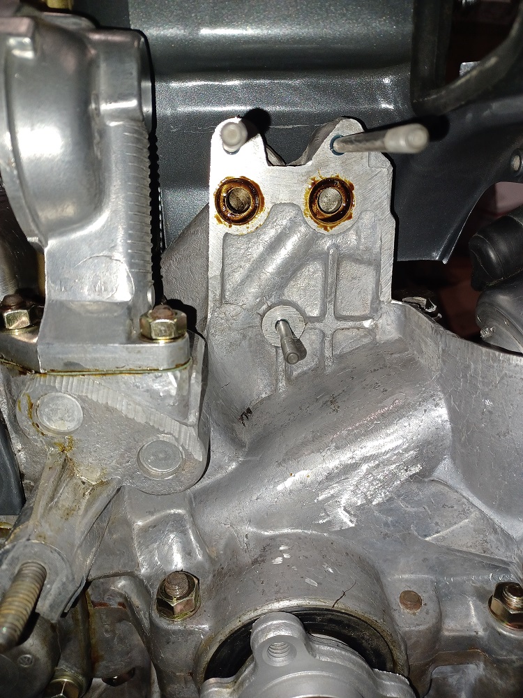

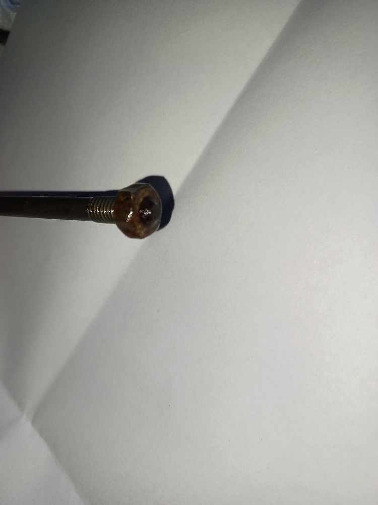

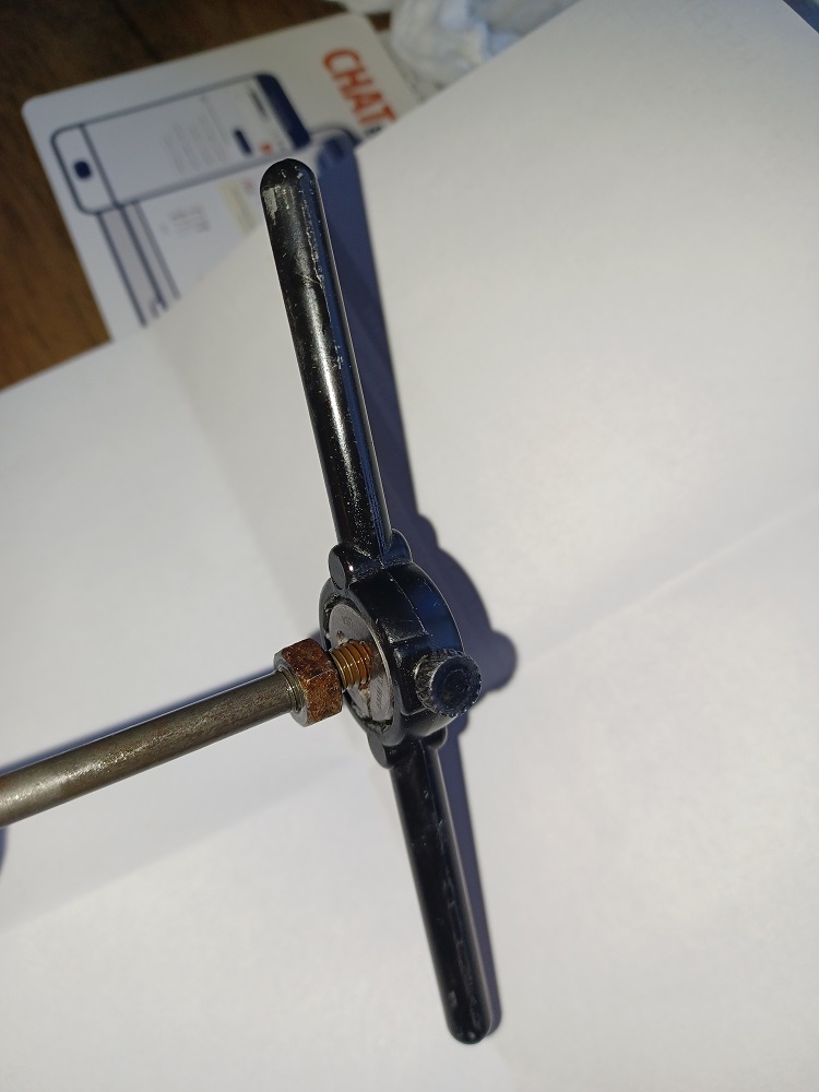

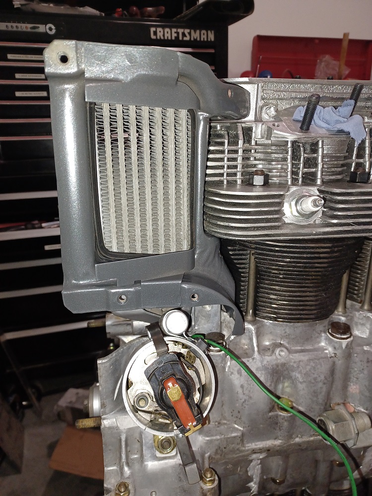

With the holidays, and all the visitors, its been difficult to get much done on the car. But I did get some of the tedious parts cleaned and then installed. Starting with the oil cooler mounting studs. They had the nuts stuck on them and when I originally removed the oil cooler long ago, the studs came out of the engine case. So I soaked them in PB Blaster. I found the nuts still didn't want to come off, but they would screw on further down the stud.....
Puebloswatcop
post Dec 31 2022, 06:12 PM
Post #869
Posts: 1,690
Member No.: 18,258
After screwing them all the way down the threaded portion, I chased the threads with a tap and the nuts came right off. Then I cleaned up the studs and decided not to re-use the nuts, so used new nuts and washers....
Puebloswatcop
post Dec 31 2022, 06:17 PM
Post #870
Posts: 1,690
Member No.: 18,258
After getting all three studs cleaned and the threads chased, I used blue threadlock and replaced them into the engine case. Then I used aircraft sealant on the gasket surfaces and installed the oil cooler.

I also started re-installing more engine tin. I also installed the new engine mounts. I really like the Gun Metal color I decided to finish the engine tin and some of the other parts. I know its not the usual black, but I just wanted to be a bit different and unique.

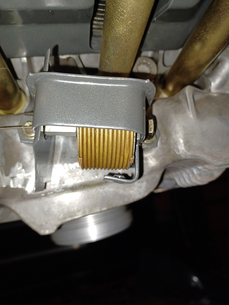

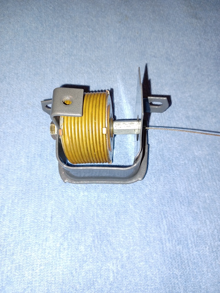

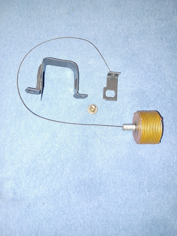

Friday I picked up the last of the powder coated items for the engine. So thought I would start assembling the smaller pieces. Starting with the thermostat assembly. While it will not be very visible, I wanted it to match all of the engine tin.
Puebloswatcop
post Jan 15 2023, 08:25 AM
Post #877
Posts: 1,690
Member No.: 18,258
And here it is installed in its ever forgotten space on the engine...

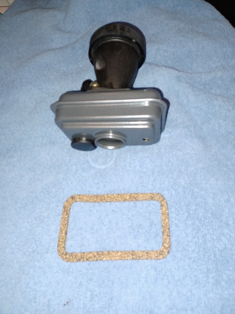

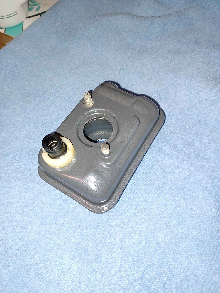

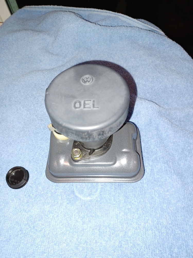

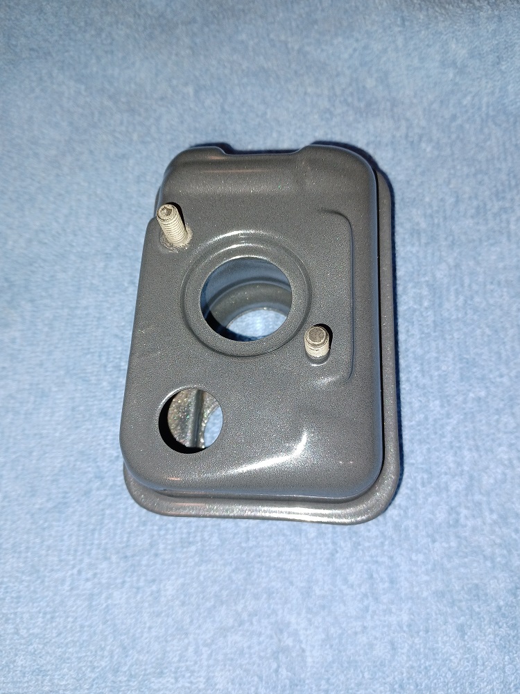

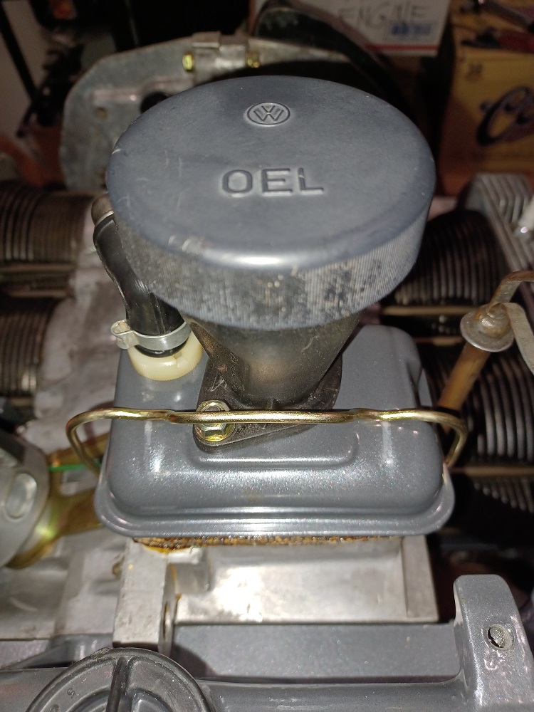

Then I moved on to the oil filler/breather assembly. The powder coater even got the inside coated as best he could. And I still had the original PCV Valve.
Puebloswatcop
post Jan 15 2023, 08:32 AM
Post #879
Posts: 1,690
Member No.: 18,258
I re-installed the filler neck and the bottom plug, but was a bit disapointed in the way the filler cap looked. I guess I will have to work on it and see if I can get the gray appearance to go back to black or try to find a better cap.
Puebloswatcop
post Jan 15 2023, 08:34 AM
Post #880
Posts: 1,690
Member No.: 18,258
And here it is in its very prominant place on top of the engine...
