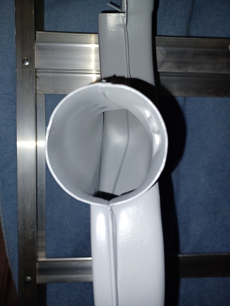

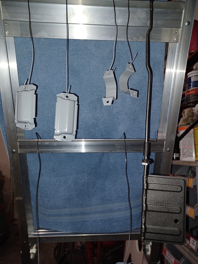

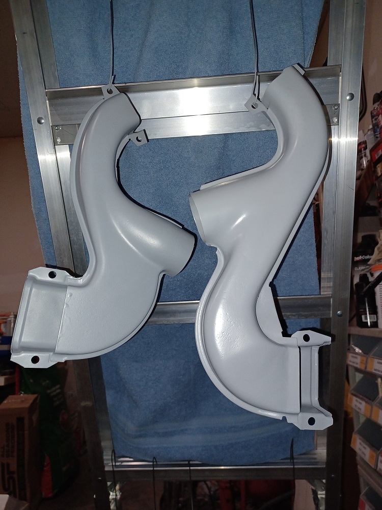

Today was spent blasting and painting some of the many exhaust/heating pieces. The small pieces were pretty easy and quick..
Puebloswatcop
post Jan 15 2023, 04:06 PM
Post #882
Posts: 1,690
Joined: 27-December 14
From: Mineola, Texas
Member No.: 18,258

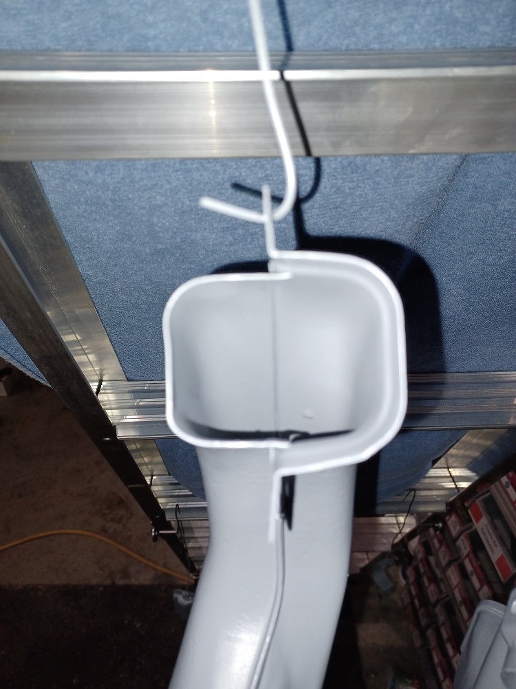

Blasting the insides clean was a long and tedious process, but I wanted to get inside and out with the VHT paint in order to try to preserve the metal as long as possible, who knows, maybe another 50 years?
Puebloswatcop
post Jan 15 2023, 04:09 PM
Post #883
Posts: 1,690
Member No.: 18,258
After 3 coats of VHT, inside and out I am pretty pleased. I did end up with a couple of runs while trying to get an inside coat, but not totally disappointed.

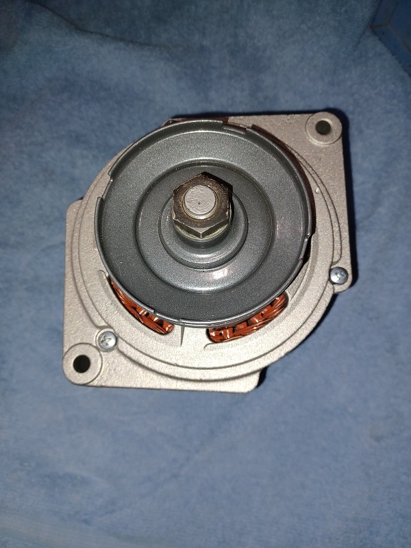

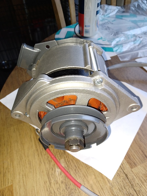

Got the re-built alernator all dressed out with the newly powder coated parts as well. Going to have to wait until my alternator wire harness is delivered to finish it out.

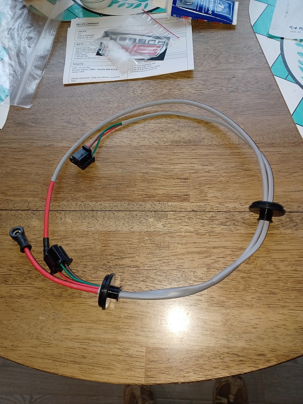

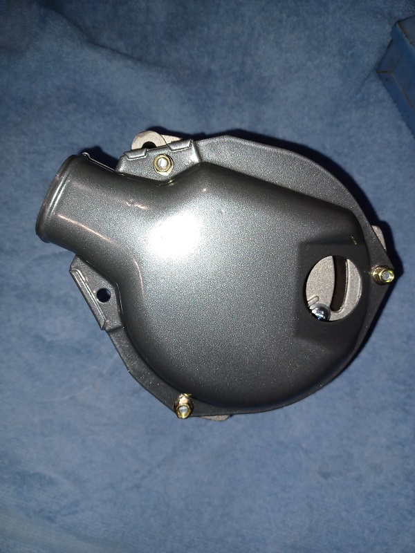

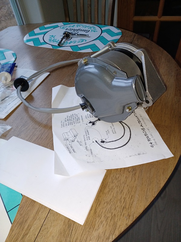

Look what arrived in the mail today from 914 Rubber.....
Puebloswatcop
post Jan 21 2023, 06:33 PM
Post #889
Posts: 1,690
Member No.: 18,258

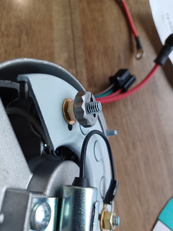

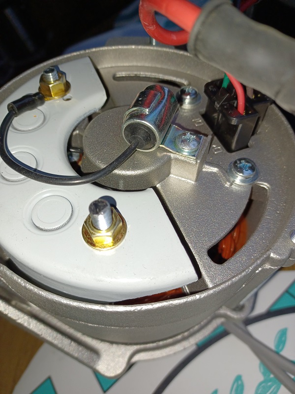

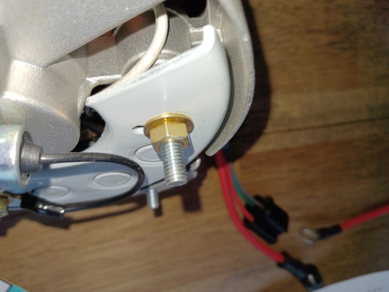

After a trial fit I discovered that this lug where the red wire has to go is to long to allow the cover to sit flat with the rubber cover for the wire in place...
Puebloswatcop
post Jan 21 2023, 06:37 PM
Post #890
Posts: 1,690
Member No.: 18,258
So in order to cut it off and not have any issues with the threads, I threaded the die on first, then a washer to protect the die. Then cut the stud to a shorter length. Then I backed the die off so I had a nice clean thread.
Puebloswatcop
post Jan 21 2023, 06:40 PM
Post #891
Posts: 1,690
Member No.: 18,258
After trimming the stud, the cover fit nicely. So I installed the wires, the cover and bolted it closed. I am pleased with the way it looks with the gun metal gray cover and pully....

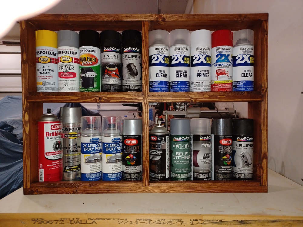

And in trying to get my garage space more organized (especially with the limited space) I built a new paint rack. Hopefully tomorrow it will be on the wall.

QUOTE(Puebloswatcop @ Jan 21 2023, 06:26 PM) *
Ha! I bet you will need about 10 of those racks before long.

QUOTE(Puebloswatcop @ Jan 21 2023, 06:40 PM) *
I suggest you check the continuity between the red wire for the alternator and the body of the alternator. 914 alternators are notorious for shorting out the stud on the alternator rear cover. The factory used a very short stud and a thin nut to prevent this.
Puebloswatcop
post Jan 22 2023, 03:24 PM
Post #898
Posts: 1,690
Member No.: 18,258
QUOTE(ClayPerrine @ Jan 22 2023, 10:14 AM) *
Thanks for the tip Clay. I will do that. I also found that there is supposed to be a gasket between the cover and the alternator body, but of course itis no longer available, so I am going to get some gaske material and make my own, which will give a bit more space, although very minimal, I'm sure.

QUOTE(Puebloswatcop @ Jan 22 2023, 03:26 PM) *
There is also supposed to be a rubber boot over the stud. But most of them are long gone. And if the stud it too long it will tear the boot and still short out against the cover.
