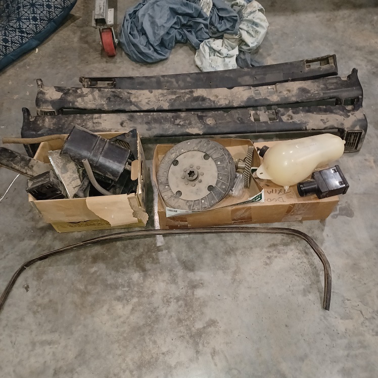

Puebloswatcop   :wacko: So spent the day unpacking a truckload of ...   Oct 7 2021, 02:37 PM

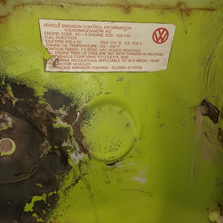

Puebloswatcop   The original Body Tag is still attached to the rig...   Oct 8 2021, 09:45 AM

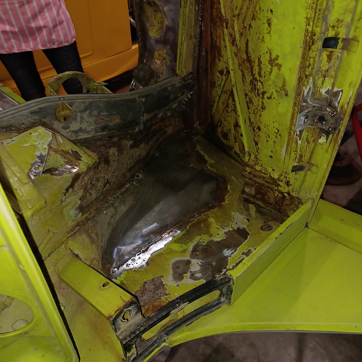

Puebloswatcop   The interior front half of the floor is in remarka...   Oct 8 2021, 10:03 AM

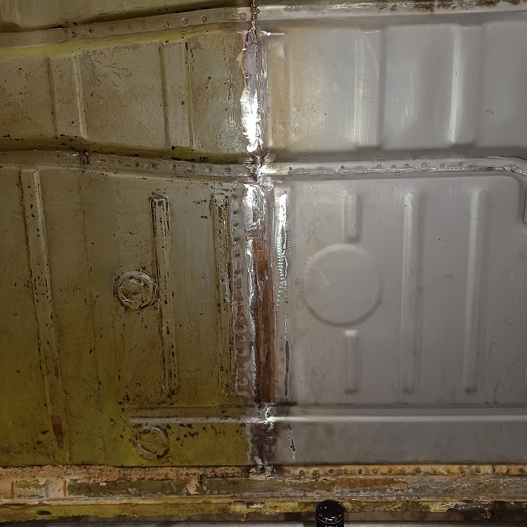

Puebloswatcop   The rear floor half has been replaced, but still h...   Oct 8 2021, 10:09 AM

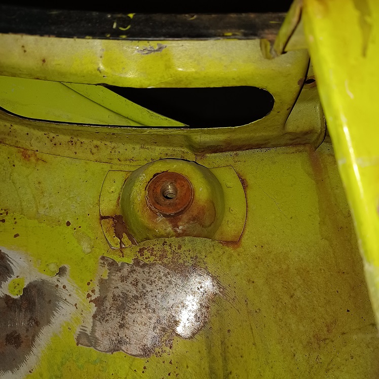

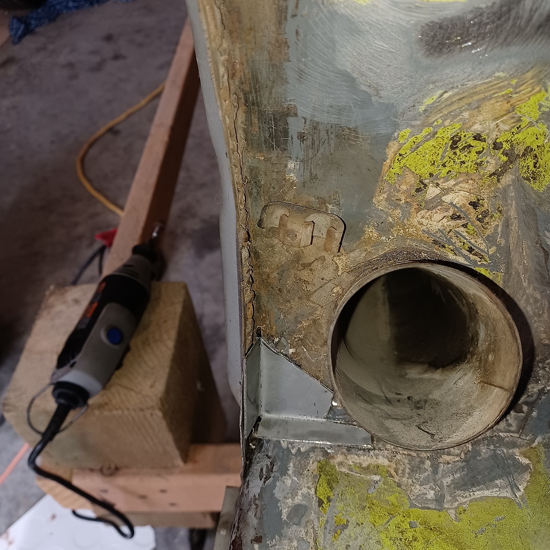

Puebloswatcop   The engine compartment was a mess when I first got...   Oct 8 2021, 12:06 PM

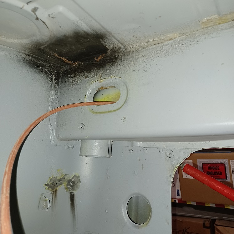

Puebloswatcop   Further inspection up under the drivers side fende...   Oct 8 2021, 12:18 PM

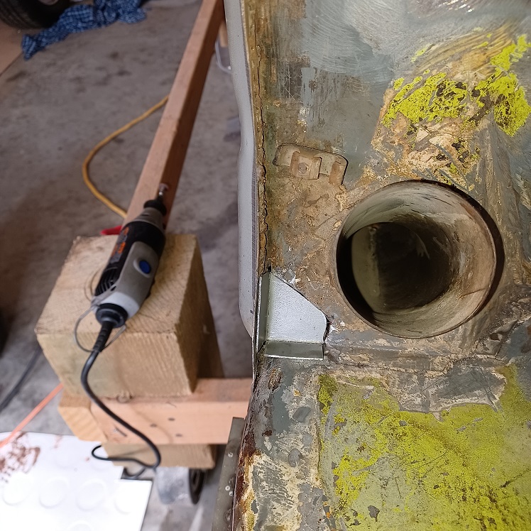

Puebloswatcop   Inside the right rear fender well, you can see the...   Oct 8 2021, 12:23 PM
Puebloswatcop   The rear trunk is good and solid, however the moun...   Oct 8 2021, 12:35 PM
Puebloswatcop   The right side fender flares have already been pla...   Oct 8 2021, 12:43 PM

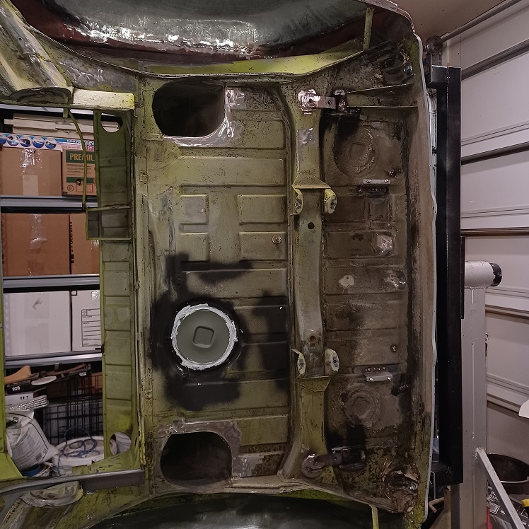

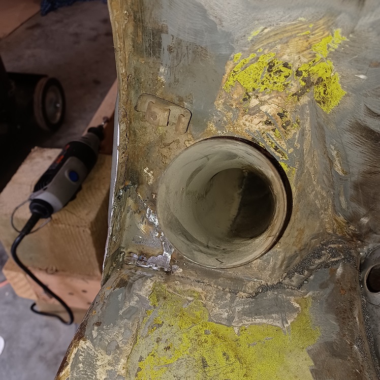

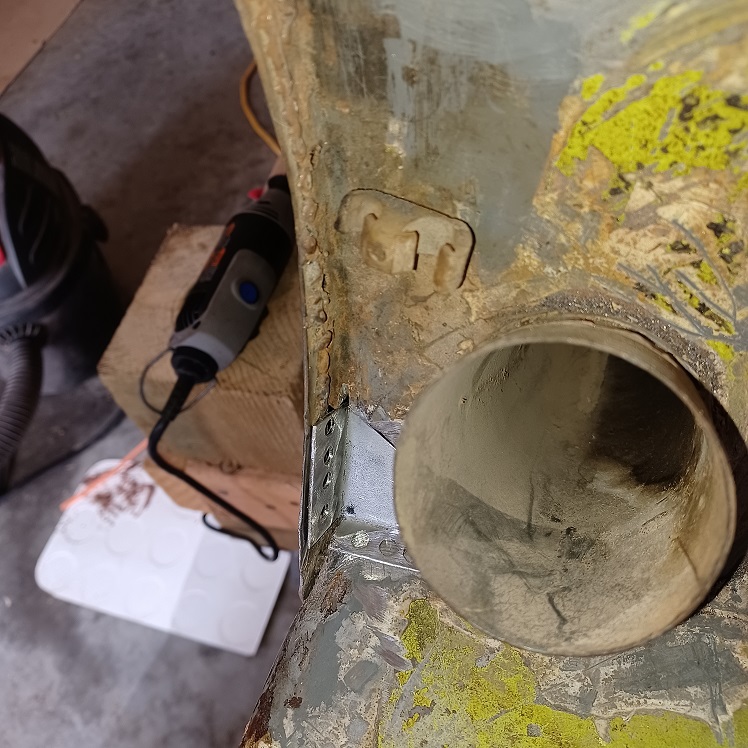

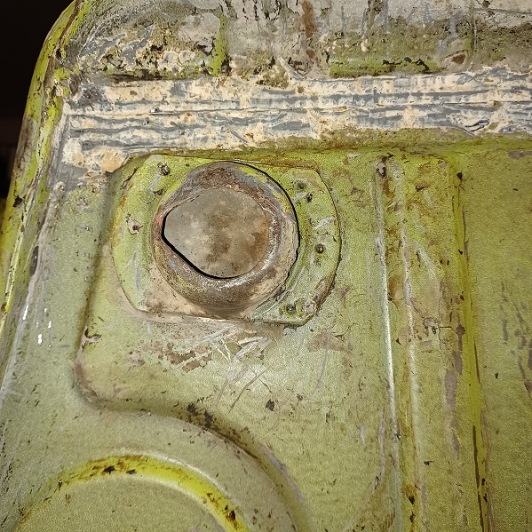

Puebloswatcop   After getting the tank dismantled I found that the...   Oct 10 2021, 11:13 AM
Puebloswatcop   The inside of the tank is not pristine, but looks ...   Oct 10 2021, 11:18 AM

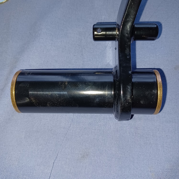

Puebloswatcop   So, as I suspected the upper bearing is shot, feel...   Oct 15 2021, 03:34 PM
Literati914   Dang.. nice jobs with that :beer1: I wasn't ...   Oct 15 2021, 06:41 PM
oldie914   You might consider using generic bearings instead ...   Oct 16 2021, 05:17 AM
Puebloswatcop   You might consider using generic bearings instead...   Oct 16 2021, 06:32 AM

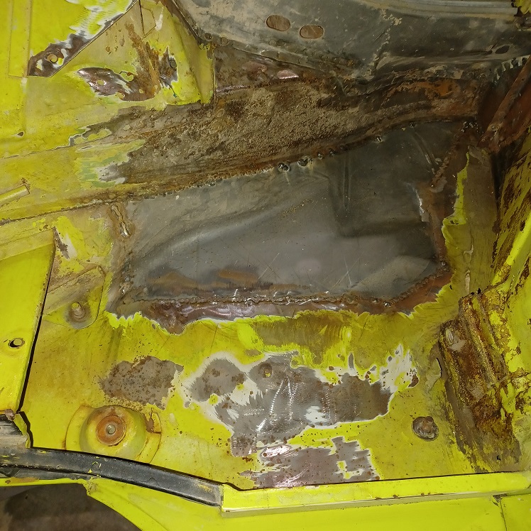

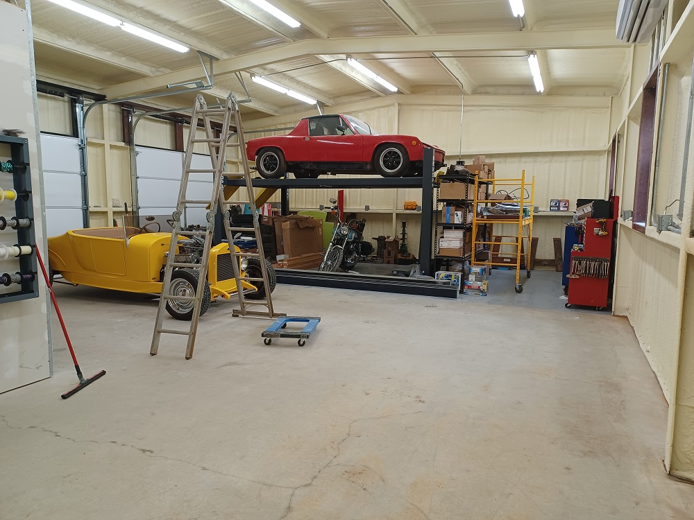

Puebloswatcop   So today it was nice enough to park the hot rod ou...   Oct 19 2021, 07:57 PM

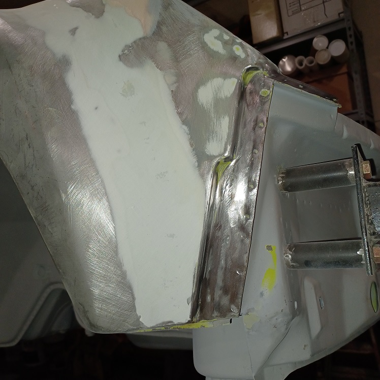

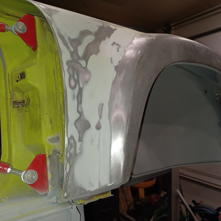

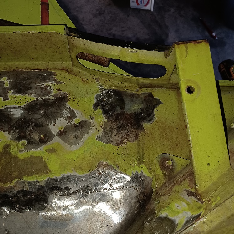

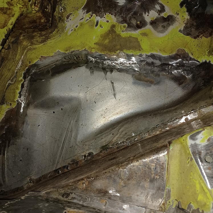

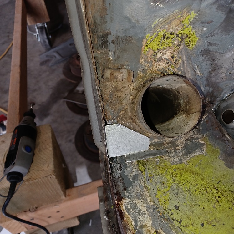

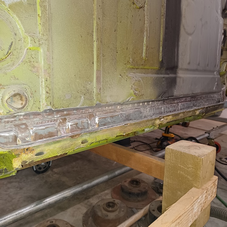

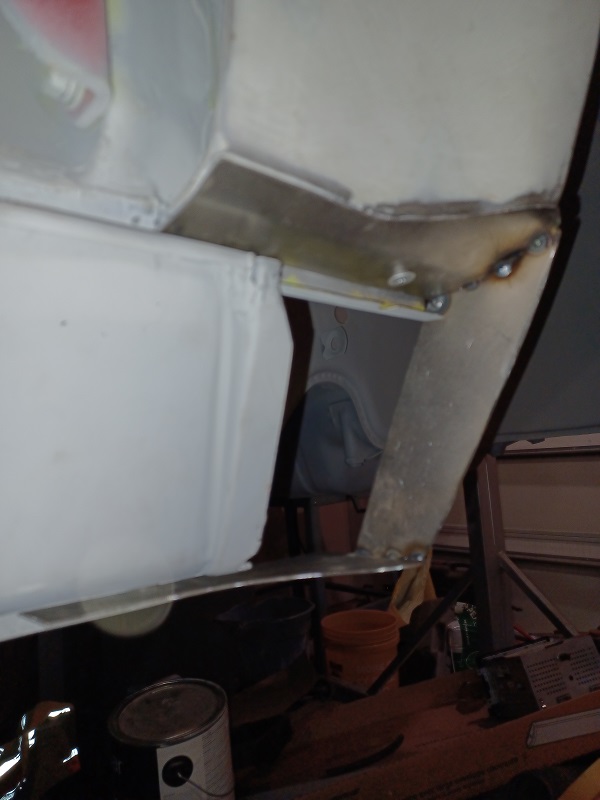

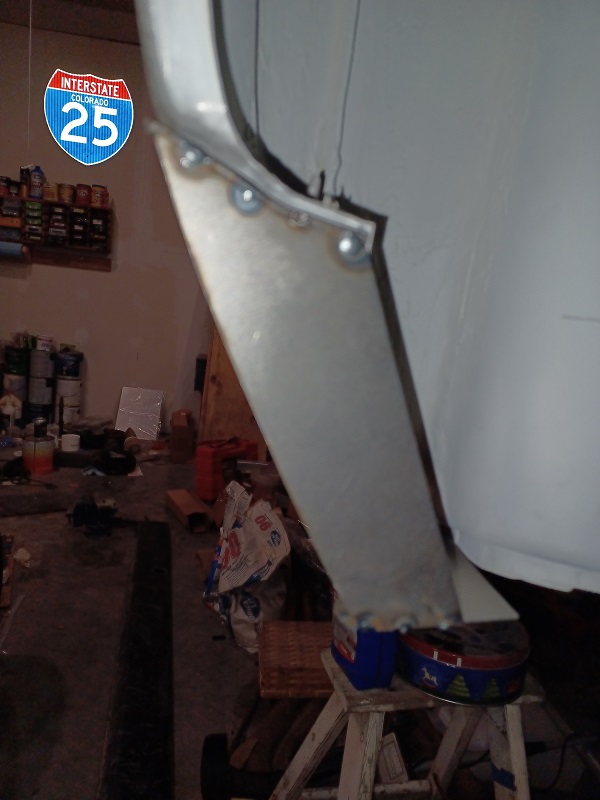

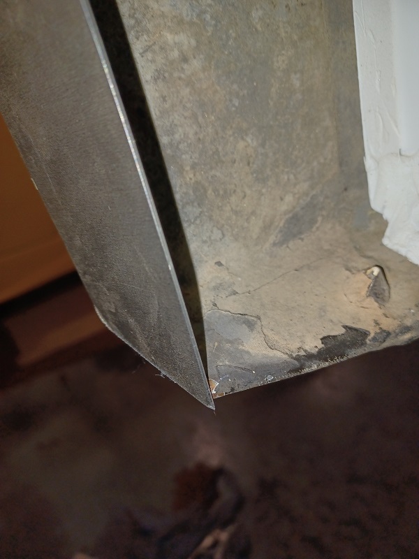

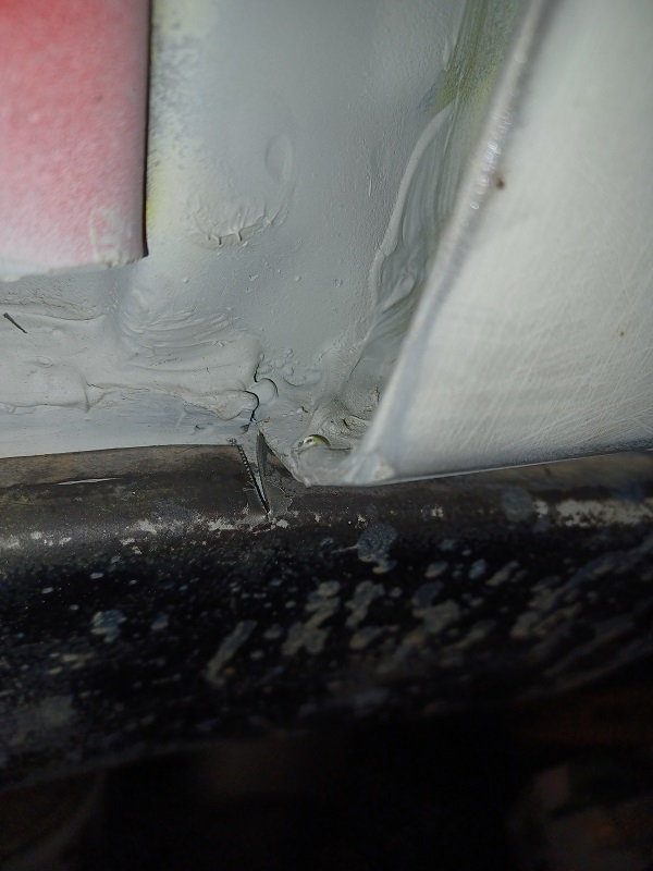

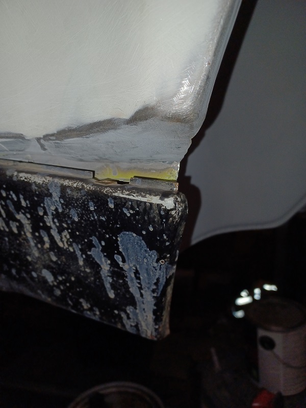

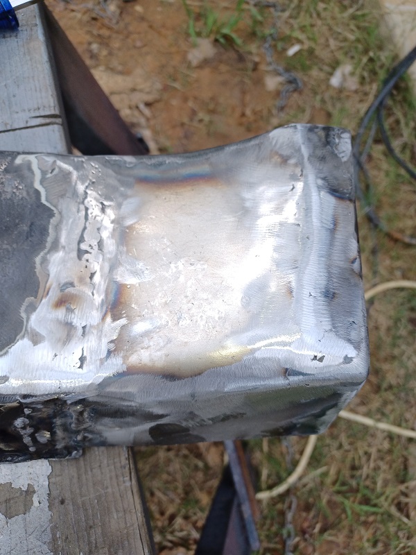

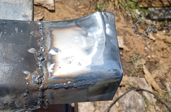

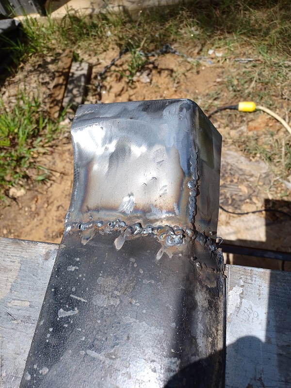

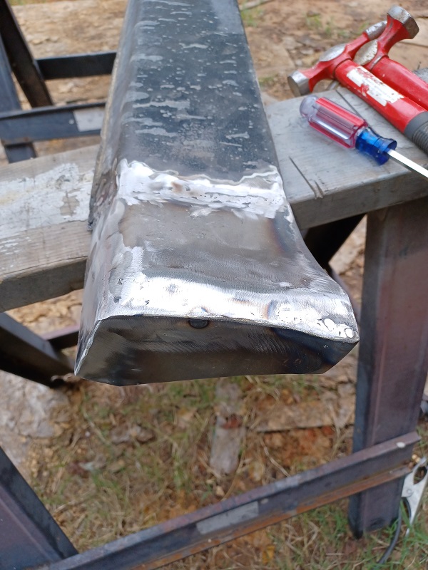

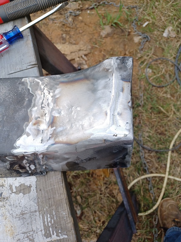

Puebloswatcop   Then moved on to the rust along the drivers side f...   Oct 19 2021, 08:20 PM

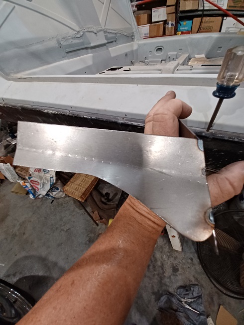

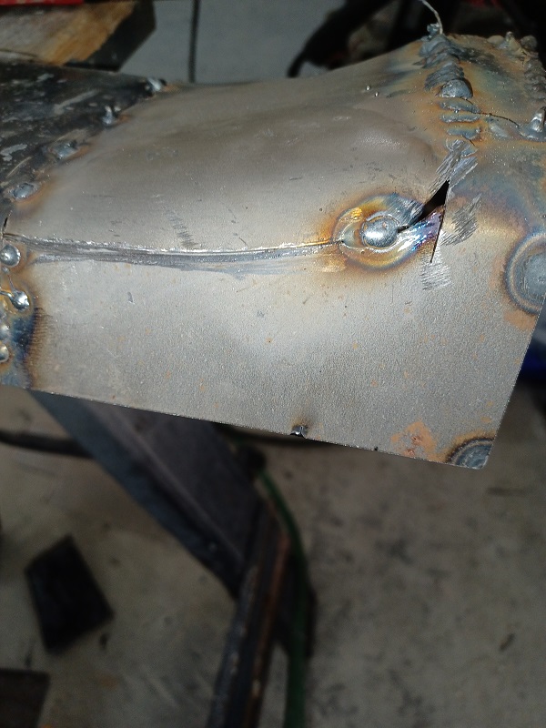

Puebloswatcop   Since I couldn't figure out the welder I moved...   Oct 19 2021, 08:26 PM
Puebloswatcop   Okay, so after spending over an hour this morning ...   Oct 20 2021, 04:50 PM
Literati914   Nice job, keep it up.. .   Oct 20 2021, 06:59 PM
Puebloswatcop   Got the support metal ground down and primed Th...   Oct 22 2021, 08:16 AM

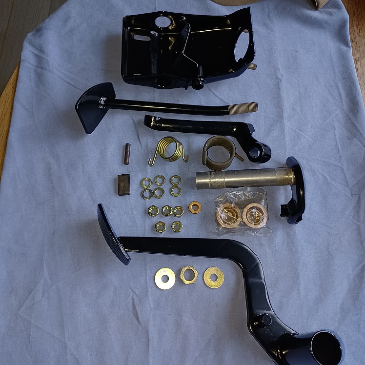

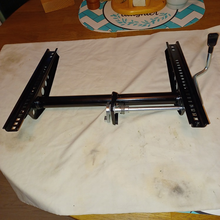

Puebloswatcop   So today I decided to take the day off from body w...   Oct 22 2021, 04:01 PM
Puebloswatcop   After laying everything out, I decided to start by...   Oct 22 2021, 04:24 PM

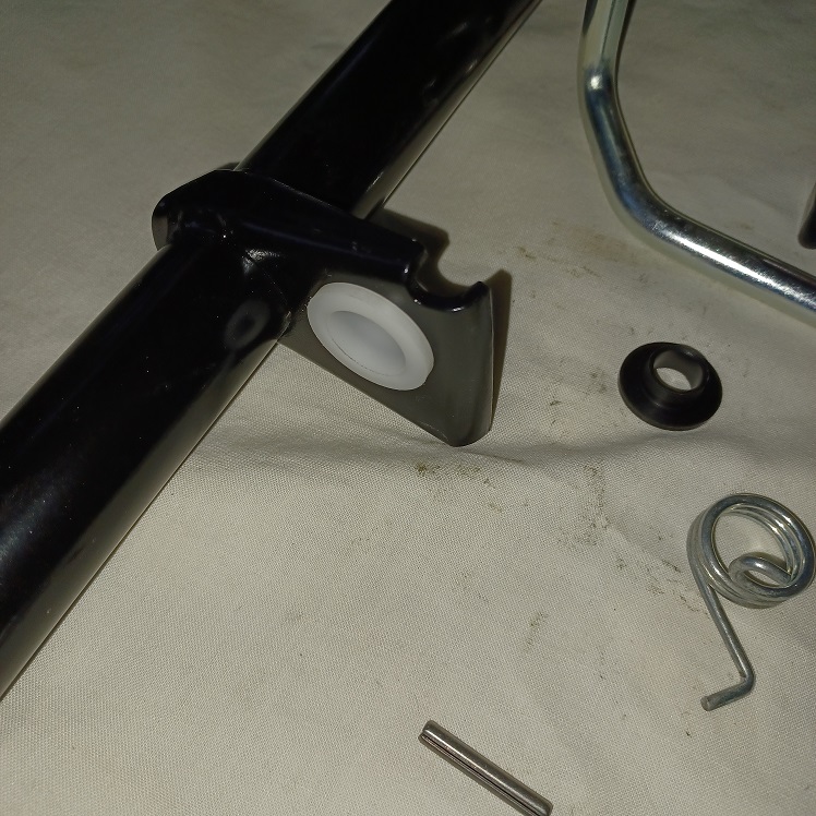

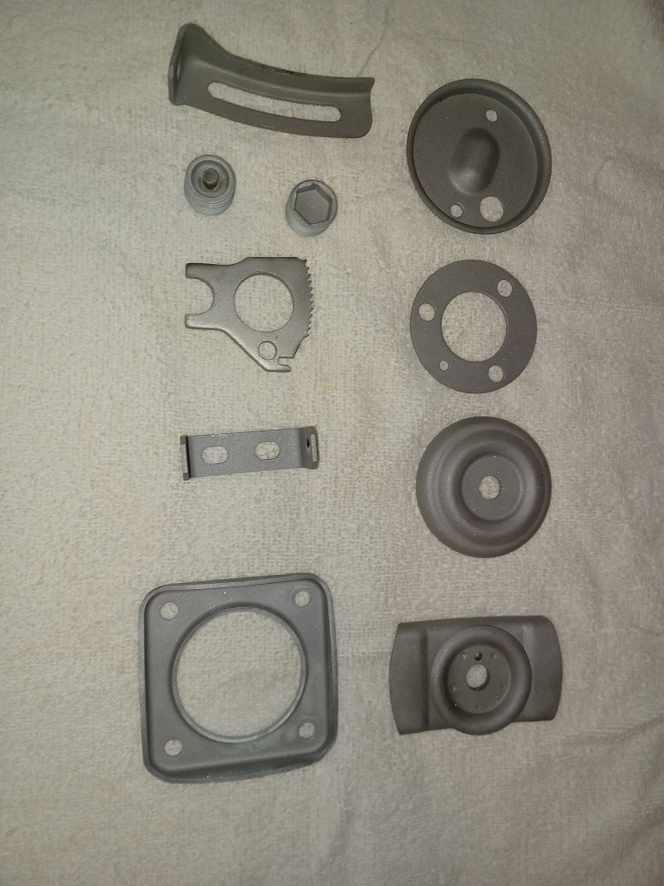

Puebloswatcop   From there i moved on to the ignition switch repla...   Oct 22 2021, 04:49 PM
Puebloswatcop   Since I plan on changing from a stock steering whe...   Oct 22 2021, 05:03 PM
autopro   I wasn't aware of that wiper switch modificati...   Oct 22 2021, 05:23 PM
Puebloswatcop   I wasn't aware of that wiper switch modificat...   Oct 22 2021, 06:21 PM
Puebloswatcop   After completing the sub assemblies, I began assem...   Oct 22 2021, 05:42 PM
Puebloswatcop   Then it was time to re-install all of the guts. F...   Oct 22 2021, 06:10 PM

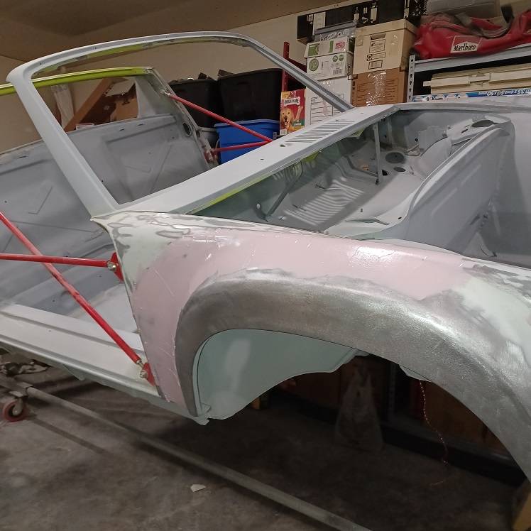

Puebloswatcop   I forgot how much I love chipping the spray on und...   Oct 24 2021, 11:39 AM

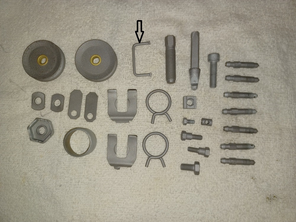

Puebloswatcop   Spent most of the day sand blasting miscellaneous ...   Oct 25 2021, 07:02 PM

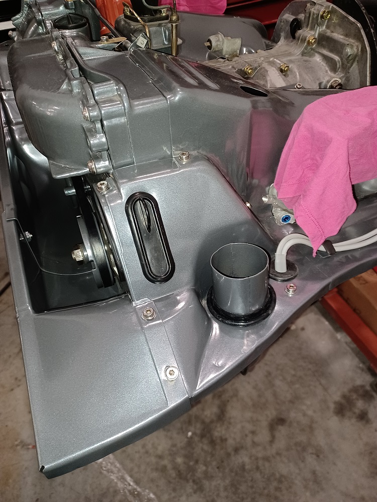

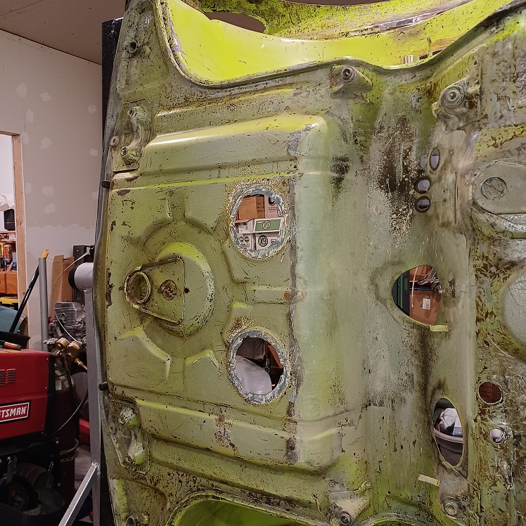

Puebloswatcop   Today I decided to work on the engine compartment ...   Oct 26 2021, 06:37 PM
Puebloswatcop   Then I went to work on the engine lid. I started ...   Oct 26 2021, 06:42 PM
Puebloswatcop   Then I drilled holes to mirror the regular screen ...   Oct 26 2021, 06:47 PM
Puebloswatcop   Then after spending the better part of an hour gri...   Oct 26 2021, 06:54 PM

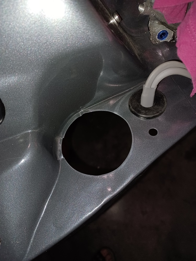

Puebloswatcop   After getting what I though was a fairly good fit,...   Oct 26 2021, 07:01 PM

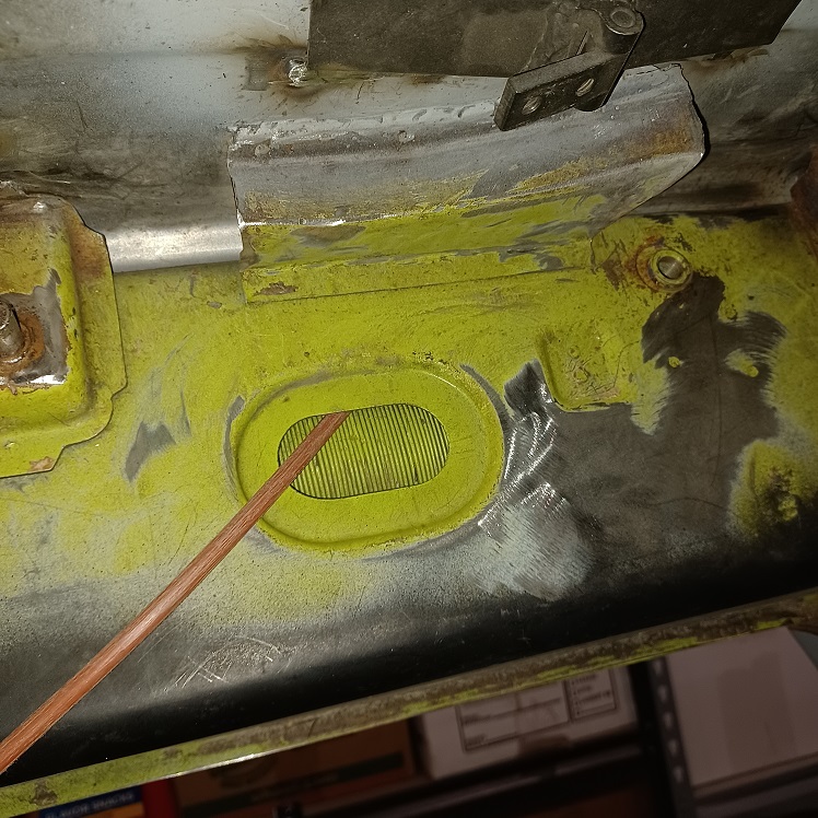

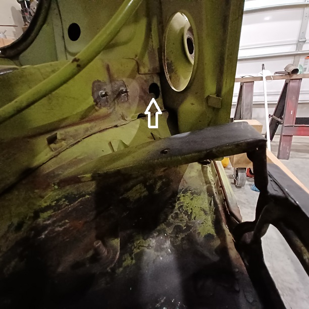

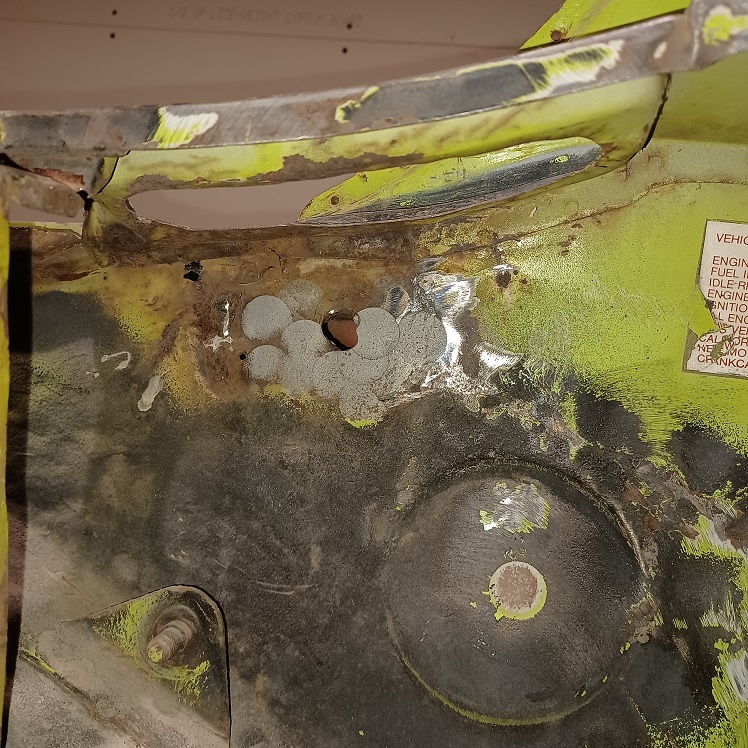

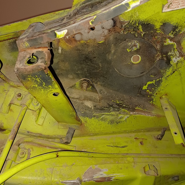

Puebloswatcop   Today started off by identifying any PO drilled ho...   Oct 27 2021, 06:42 PM
bkrantz   Today started off by identifying any PO drilled h...   Oct 27 2021, 08:00 PM
Puebloswatcop   Today started off by identifying any PO drilled ...   Oct 28 2021, 07:29 AM

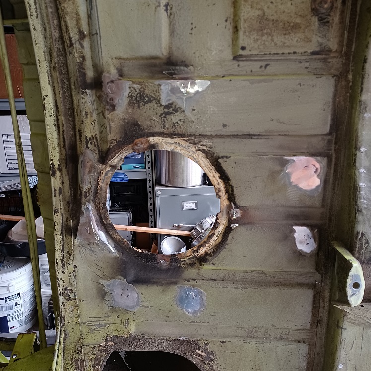

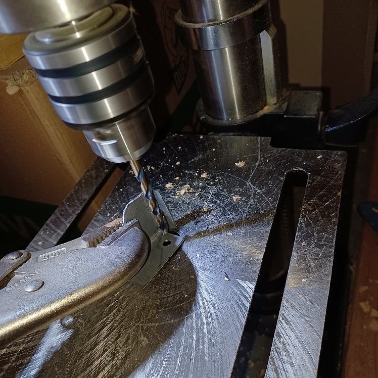

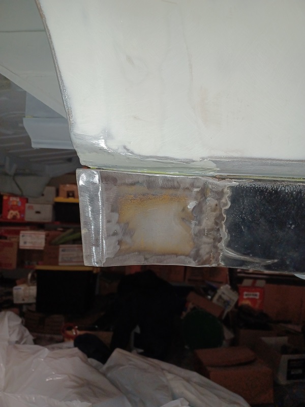

Puebloswatcop   I began by forming a piece to fill the larger hole...   Oct 27 2021, 06:43 PM
Puebloswatcop   Then welded it all up to include the small hole be...   Oct 27 2021, 06:51 PM
Puebloswatcop   Then I removed the body filler that was in the low...   Oct 27 2021, 06:57 PM
Puebloswatcop   And with that I decided I was tired of trying to c...   Oct 27 2021, 07:02 PM

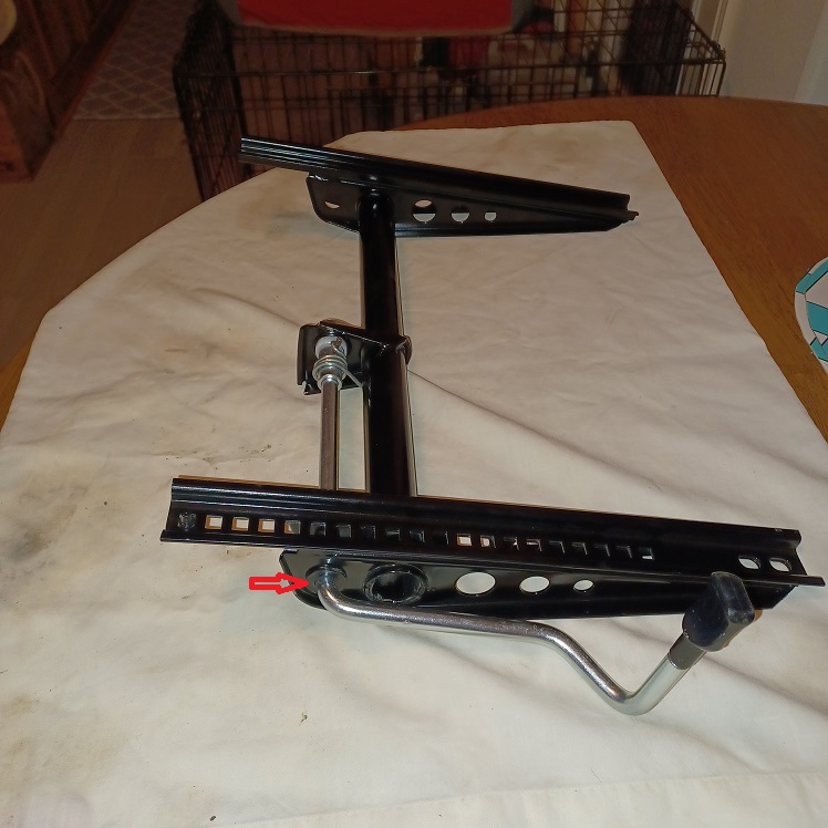

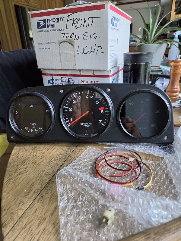

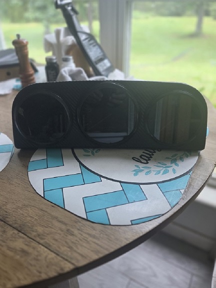

Puebloswatcop   Decided to take a break from working on the body t...   Nov 1 2021, 08:38 AM
Puebloswatcop   The next thing I unboxed was the climate controls....   Nov 1 2021, 08:52 AM
Puebloswatcop   One thing I did find is that it appears there is a...   Nov 1 2021, 08:56 AM

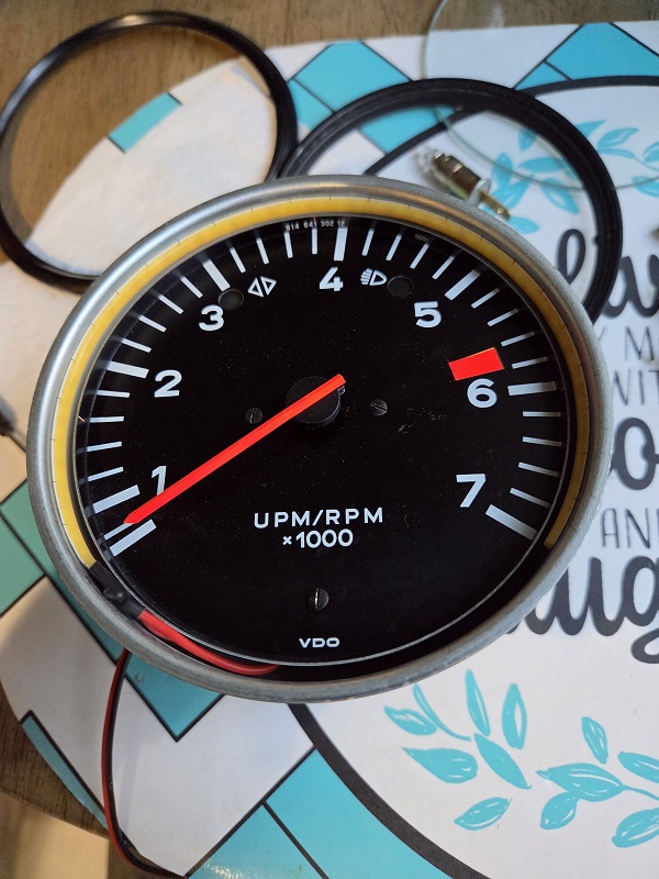

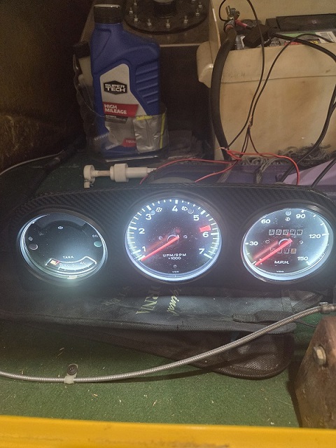

Puebloswatcop   So I spent about an hour dis-assembling parts of t...   Nov 1 2021, 08:59 AM
Puebloswatcop   Then re-assebled the clean product. Everything se...   Nov 1 2021, 09:02 AM

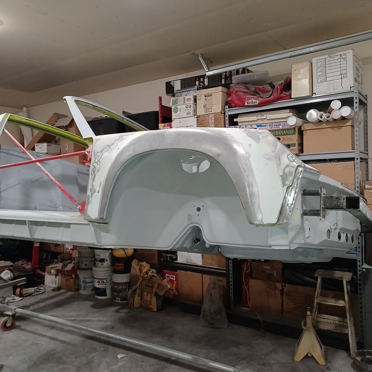

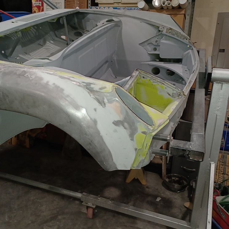

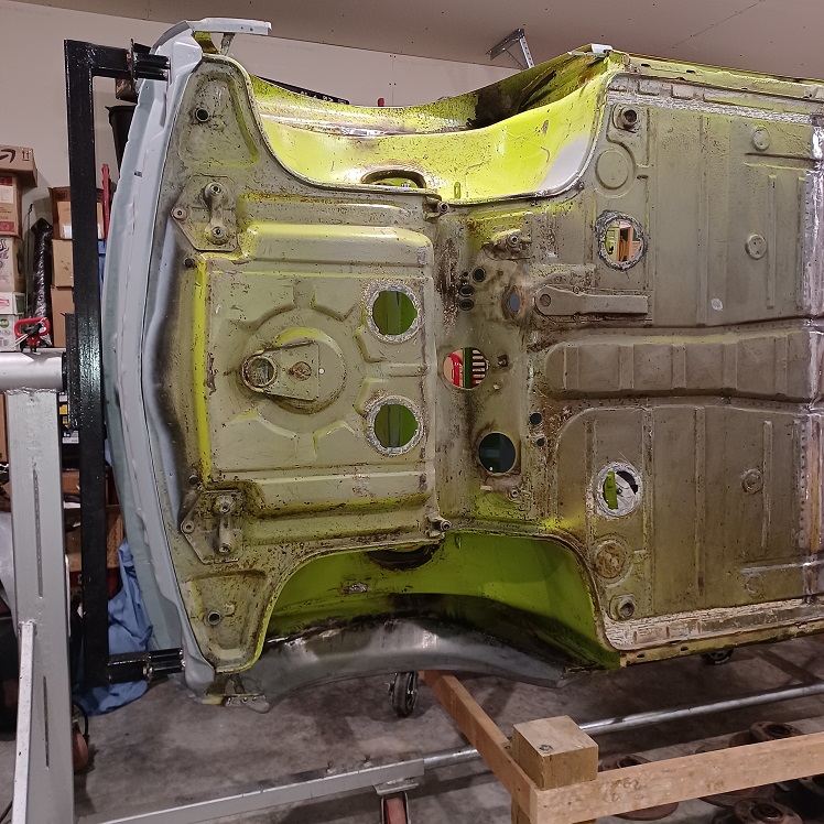

Puebloswatcop   Since today was a rainy and cold I decided to lift...   Nov 3 2021, 03:23 PM
Puebloswatcop   Only had 20 inches to get it onto the mounts   Nov 3 2021, 03:25 PM
Puebloswatcop   Then after getting it onto the rotisserie had to r...   Nov 3 2021, 03:27 PM
Puebloswatcop   And some 5 hours after starting, Its finally on th...   Nov 3 2021, 03:30 PM

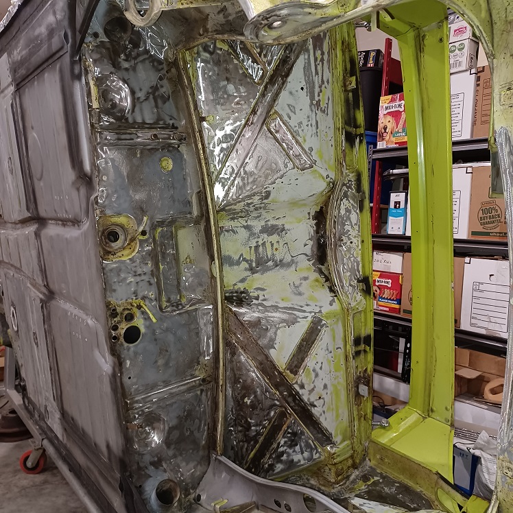

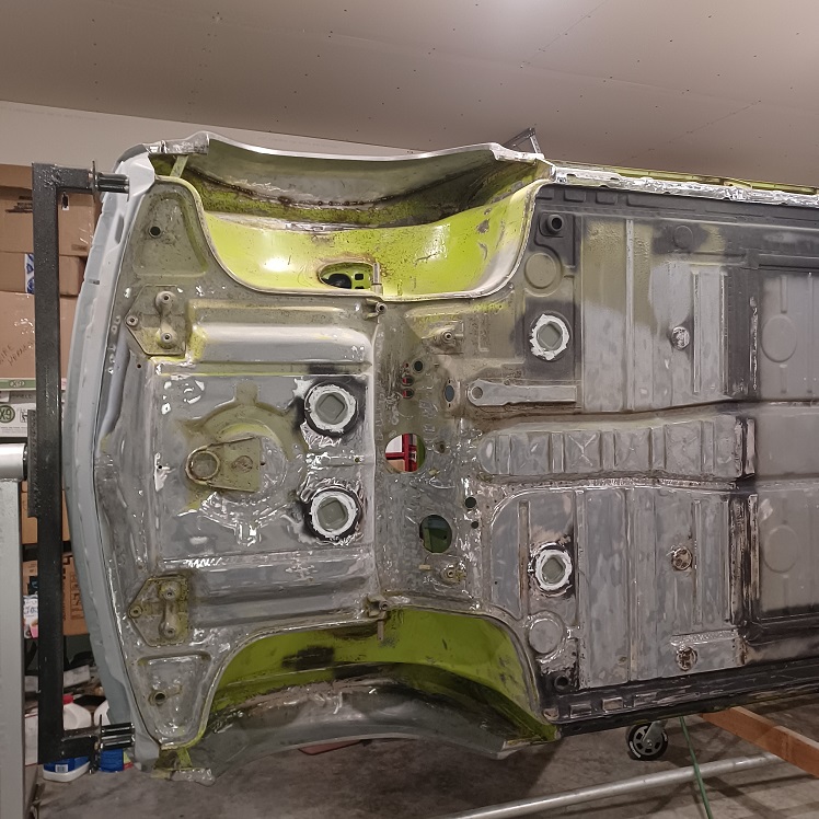

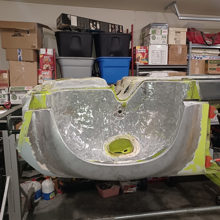

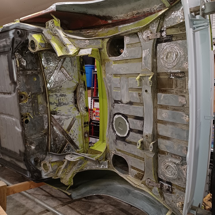

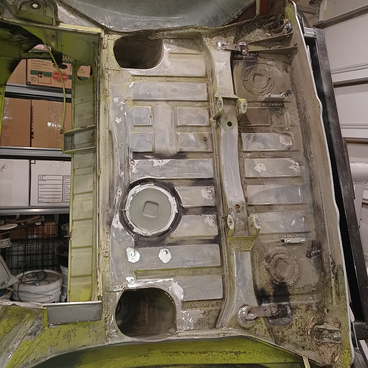

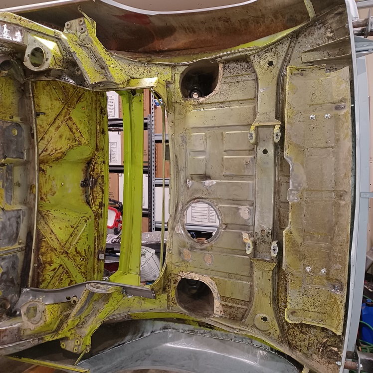

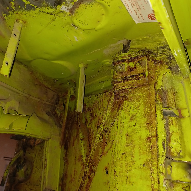

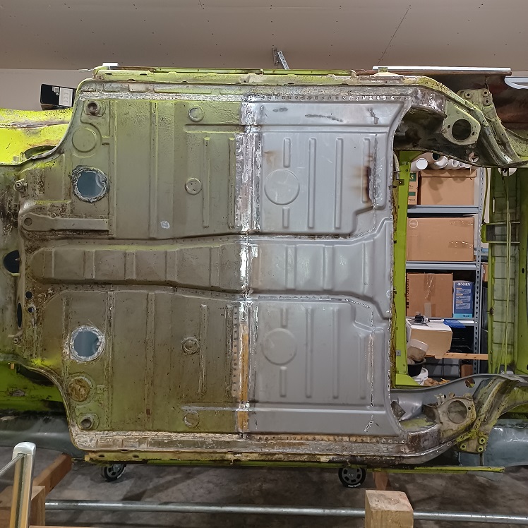

Puebloswatcop   So today was spent stripping the undercoating from...   Nov 4 2021, 04:41 PM
Puebloswatcop   At least some of it was already done, but there ar...   Nov 4 2021, 04:44 PM
Puebloswatcop   The good thing is the engine compartment is pretty...   Nov 4 2021, 04:47 PM
