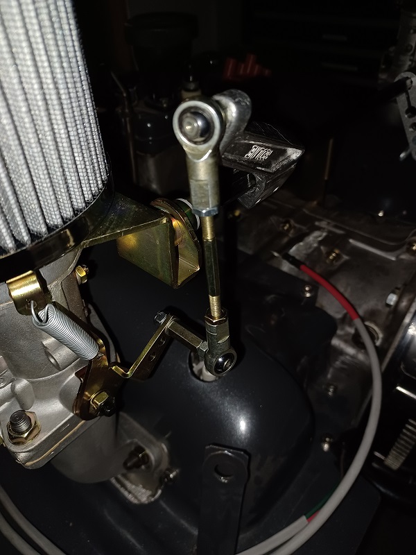

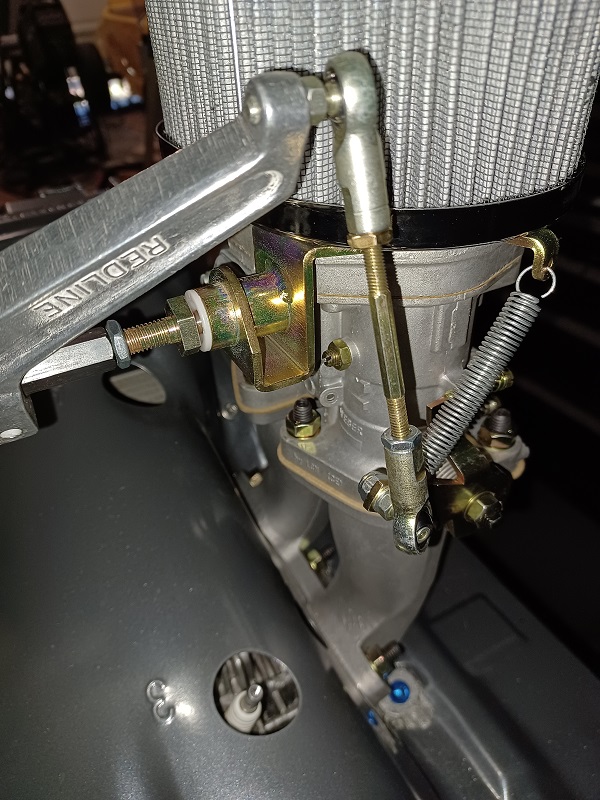

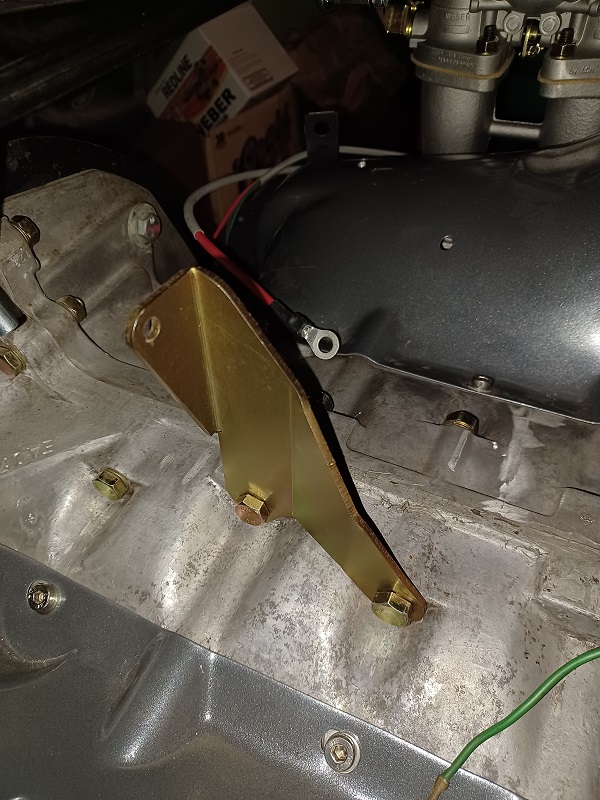

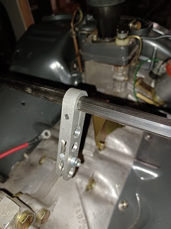

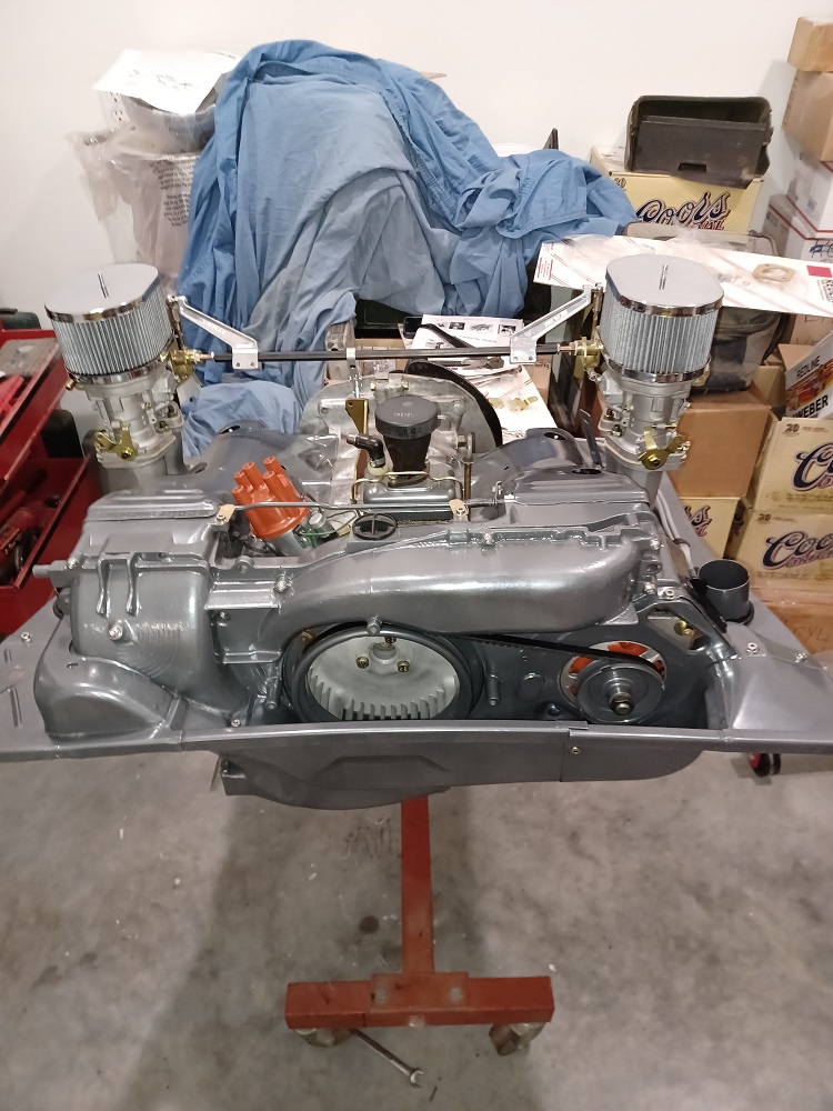

Somehow I lost all my pictures of the linkage installation, but here are the pictures after it was completed. I will say this, The installation instructions from Redline leave allot to be desired. Thank goodness for all the 914ers on here that are more than willing to help and answer seemingly dumb questions.....

And the last picture of the day, carbs and linkage installed. Final adjustments, etc.. will be saved for another day.

Looking good, Kevin. That linkage looks sexier than the twin cable kit I got from Tangerine--I hope it stays in sync. (IMG:style_emoticons/default/piratenanner.gif)

QUOTE(bkrantz @ Jun 11 2023, 06:53 PM) *
I was considering the twin cable setup as well, but decided to go with the linkage that came in the kit for now. If I find myself having sync issues I will look at alternative setups......but for now I am trying to save up for some sexy looking SSI heat exchangers and a new muffler system.....OUCH!

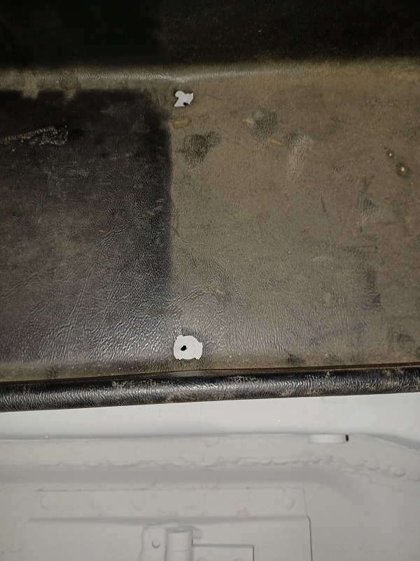

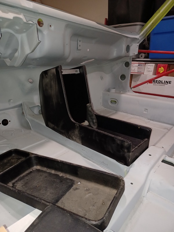

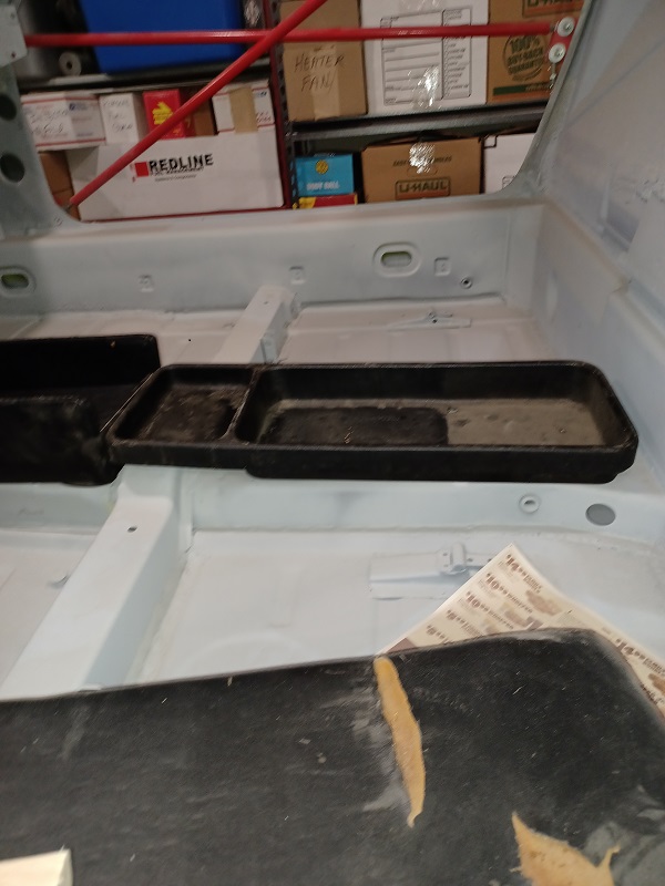

Had a little spare time today and while I was moving things around in the garage, saw my center console and 3rd seat tray. Just for fun I set them in the car, remembering what they used to look like...
Puebloswatcop
post Jun 13 2023, 05:09 PM
Post #968
Posts: 1,716
Joined: 27-December 14
From: Mineola, Texas
Member No.: 18,258
The console has a couple of small tears in it and the tray has 2 holes where the screws broke through. The 3rd seat pad is pretty much shot. So I plan to have the console recovered in real black leather. But then I started thinking how I didn't reaal want to put the 3rd seat back in there. But not wanting to waste the space I decided to make a new center console to fill that space.

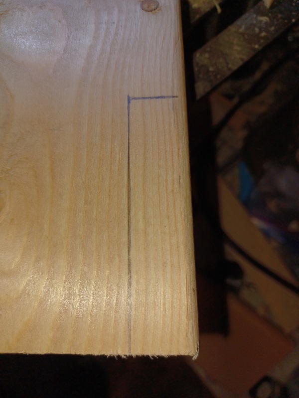

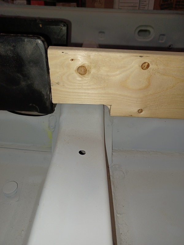

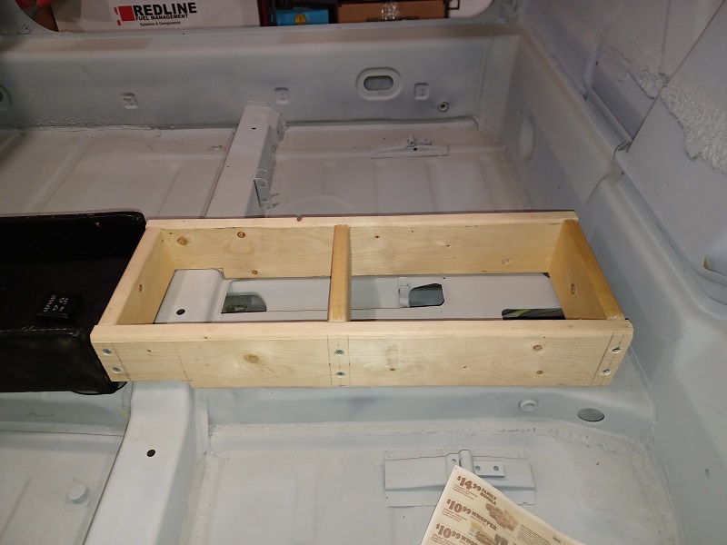

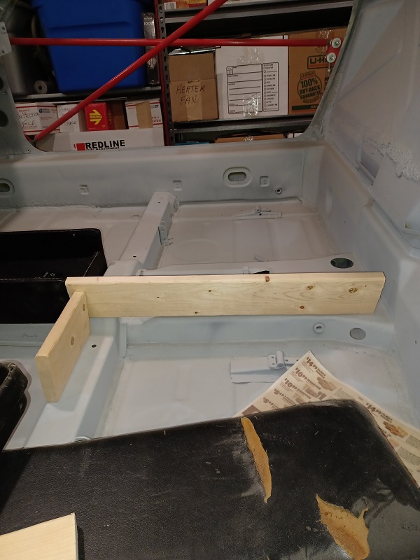

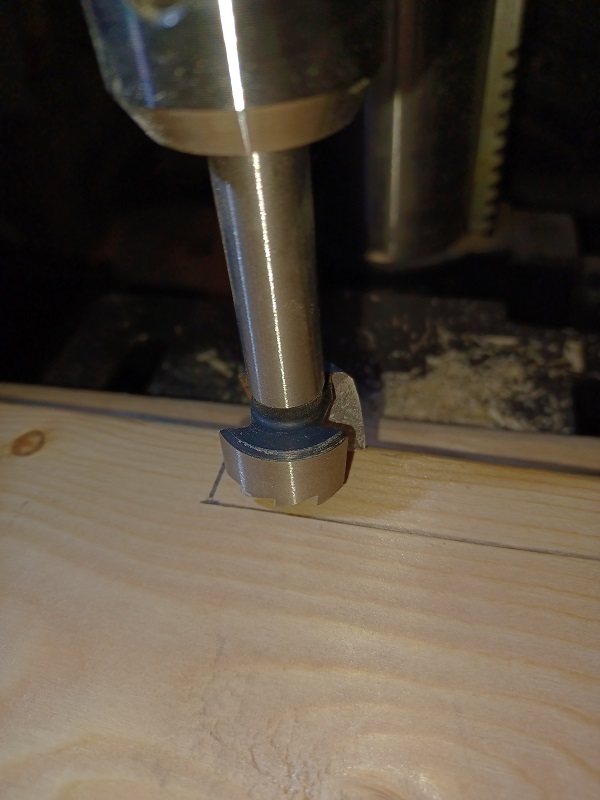

I decided to build something that was substantially stronger than the flimsy plastic that was originally there, but didn't want to over-fill the space either, that being said I thought I would try a simple 1 X 4 frame.
Of course the 1 X 4 had to be cut to fit over the center frame support that goes across the middle of the car. So I marked out where the cut needed to be. I didnt want to have any square, sharp edges, so I cut the front of the notch using a forstner bit to give it a rounded shape where it goes over the frame.
Puebloswatcop
post Jun 13 2023, 05:24 PM
Post #970
Posts: 1,716
Member No.: 18,258
It worked out pretty well. I continued building the frame, insuring that it's size matched that of the flimsy plastic tray, thus insuring that it will fit once the back pad, etc. are all installed.
Since I have very specific storage ideas for it use I then divided it into 2 compartments. After I finish sanding, etc, I plan to have it covered in black leather as well so it will match the center console.

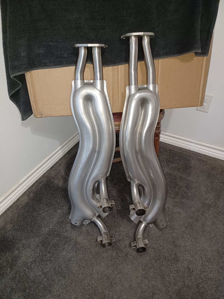

Okay, So today felt like a toys for tots christmas, except for old guys.....
Puebloswatcop
post Aug 7 2023, 06:04 PM
Post #972
Posts: 1,716
Member No.: 18,258
The gift even comes in its own wrapping bags....
Puebloswatcop
post Aug 7 2023, 06:07 PM
Post #973
Posts: 1,716
Member No.: 18,258
These are definately works of art.......Can't wait to install them. Unfortunately, will have to wait since I leave for Colorado day after tomorrow....

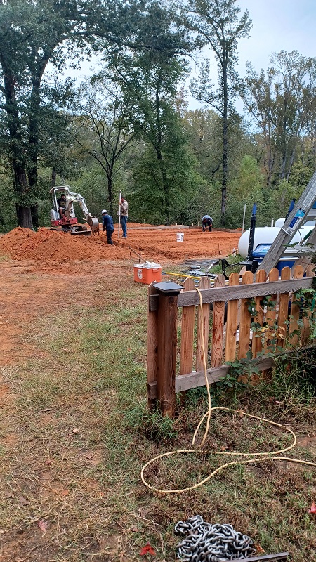

Member No.: 18,258

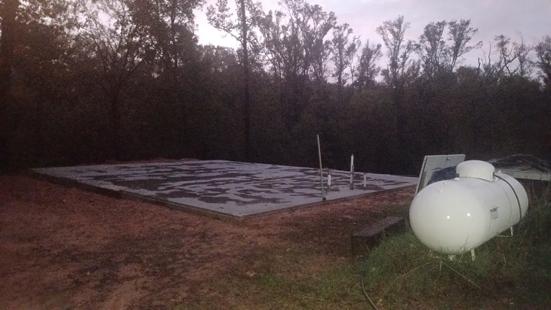

So its been awhile since I have posted anything, because life has been crazy and its been hard to find time to work on the cars. But I am now working on getting a better work space and a place where the cars can live in comfort. The new shop will be 30' X 40' complete with 2 lifts, an office and a bathroom. Should make a nice man cave.

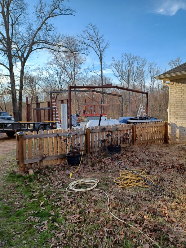

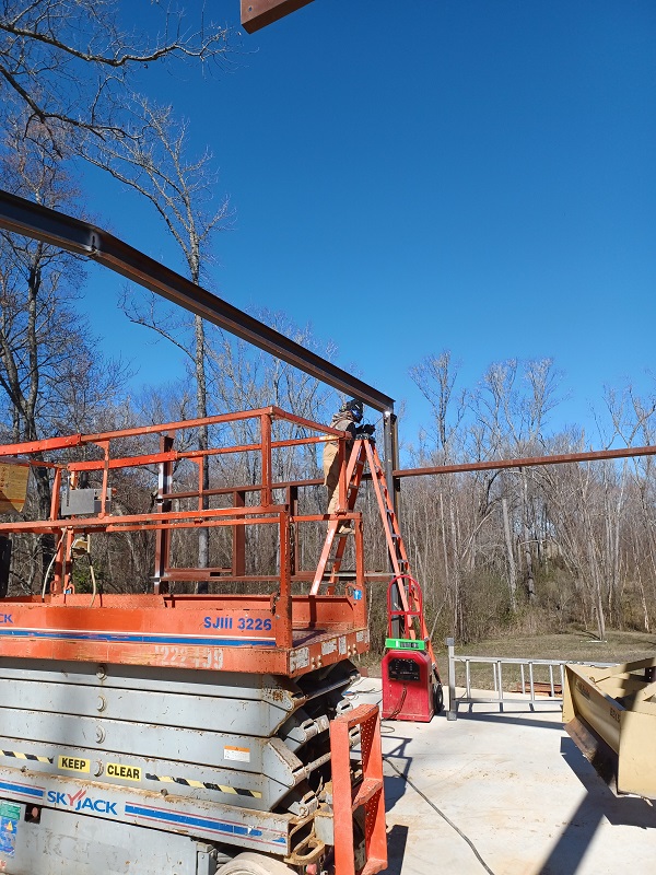

Unfortunately, I am still not getting a lot done on the car, but the new shop is coming along. Don't let anyone tell you it doesn't get to cold in Texas.....Was welding in 28 degree weather this morning.....

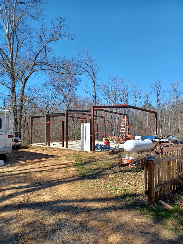

Got all the roof beams in and will be putting roof perlons on this week. Hopefully the skin will start going on in a couple more weeks.
