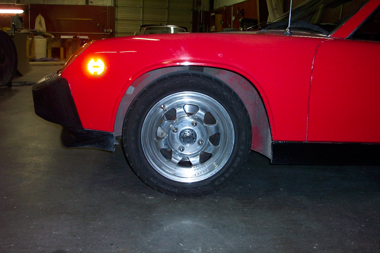

I have driven a several 914's through the years. With everything from 165/15's to 175/70/15's to 185/70/15's and now 185/60/15's. I think my car can handle a bit more tire. Tire harshness isnt a problem for me. Is anyone else running 205/50 on 4 bolt Fuchs?
I drive a 2002 Toyota Echo commuter with Koni Sports set on firm with sport springs and run 205/40/16's. So bring on the harsh - I just want quick turn in and great grip - I will put up with less than optimal ride on those grocery runs.
I just want my 914 to handle as well as my daily commuter:
(IMG:http://home.earthlink.net/~grantsfo/121-2113_IMG.jpg)

DUDE VSG, I have those same Rims! (IMG:style_emoticons/default/boldblue.gif)

Ferg, right you are!
tat2dphreak, I think they are westen wheels. Does anyone know for sure?

Yeah VSG, those are Westerns, my favorite.
