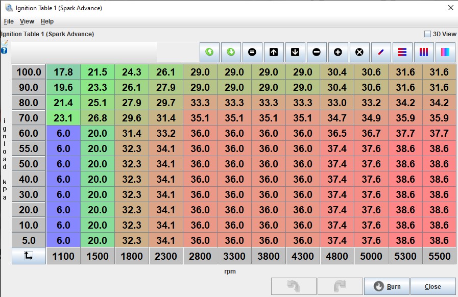

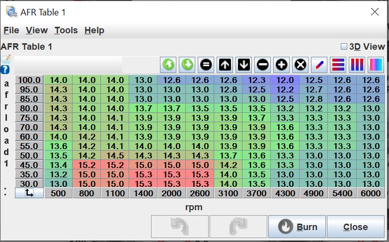

I'm atttaching my AFR target and ignition tables, let me know what you think. Am I in the ballpark?
I'm not asking you for any secrets. I'm just looking for some feedback to understand if I'm setting myself up for problems in the future. This is not my race car, I'm not looking for that nth hp advance; this is my street car, one that gets driven only 3000 miles a year (if I'm lucky, especially lately). I want to enjoy it and not worry about it. And maybe I'll learn something in the process.

You have a lot more advance than I do. I had mine over 30 until a few weeks ago, and I noticed I was getting some knocking on hard acceleration, so I backed off and took the max advance back to 27. That didn't fix the problem, so then I realized I was probably running lean under hard acc instead. So I fixed that in the fuel table, but I haven't bounced the max advance up again yet for some reason. Maybe I can do that now... (IMG:style_emoticons/default/smile.gif)
Your AFR table is a bit richer than mine. I'm not sure how much to trust AFR numbers. I've leaned these out over time because a) I'd like better efficiency - still seem like I max out at low to mid 20's in terms of MPG, and b) there is some evidence that I may be running slightly rich (e.g., plugs, etc.). I don't have any head temp issues, so other than the knocking as mentioned above (which I addressed), I don't think it's causing me issues. Still goes like stink through the whole driving range. But yes, this is where an experienced dyno guy who knows type IV's could really help.

QUOTE(BeatNavy @ Nov 6 2021, 01:28 PM) *
...You have a lot more advance than I do...Your AFR table is a bit richer than mine.
Those go hand-in-hand. I'm running fatter more as a safety measure, but I'm comfy with more timing mostly because it's a street car and I don't tend to run it hard. Any hard running I do will be momentary, rather than extended such as if I were doing lapping days.
Don't we normally set our stock D-Jet cars up at around 29 degrees total advance? With good gas and better fuel management I suspect they'll tolerate more timing.
Plus, I normally run it on 91 pump gas which should be more than enough for this 9:1 FAT 2056 engine, and a conservative cam. I ran it on 89 for my NJ trip because I knew I'd just be highway cruising all day in the middle of the tables...plus have you seen the price of 91 lately...??
I'd like to get a better idea if, for example, I were to do a track day of 15 minute sessions, am I setting myself up for trouble?

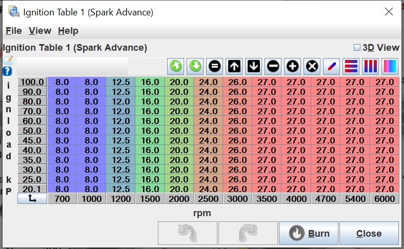

To that end, I thought I'd start with an ignition table pretty much like Rob's which looks to be close to a stock curve just to be safe. I still have a lot to learn about when it is safe to run more advance, and what you gain so am enjoying the discussion on that. I was also a bit surprised to see areas going to stoich and even leaner on both of your tables - again, thinking about CHT and being a total ignoramous on the subject myself.

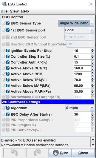

I mentioned this on my megasquirt thread but it seems like a closed loop fattening the AFR or dialing back advance when CHT starts to climb beyone spec would be ideal, but the only out of the box solution I've found is using alternate AFR and Ignition tables triggered by CHT as Greg mentioned. A loop seems like it would be a good way to tickle the edge from the efficiency side at least by building finding the edge into the algorithm. I am not shy of diving in and writing some custom code, but not when a bug could cost me my engine.
Well Brent, I just made mine a little more aggressive last night after reading this thread (IMG:style_emoticons/default/smile.gif) Reminded me that I solved my hard acceleration pre-detonation with fuel rather than timing but forgot to put it back the way it was. Haven't uploaded to the ECU yet, though.

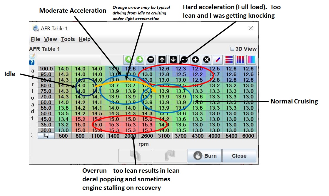

More info. Here's an annotated AFR table. I spend 99% of driving time in one of these circles (very roughly). I initially struggled with idle, as mine has a higher pressure (kPa) (lower vacuum) than almost anybody else I referenced, air or water cooled. I don't know if it's the Raby cam or something else. After a while I stopped fighting it and "gave the engine what it wanted." Any AFR numbers way outside of those circles, or when moving between them during driving, are basically irrelevant.

I don't understand those paragraphs from TunderStudio either, but I do understand that Squirt uses the AFR input to adjust fueling to target your desired AFR. That's the EGO Correction you see happening as you're driving along.

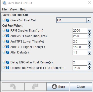

Overrun: are you using "Fuel Settings", "Over-Run Fuel Cut"? If not, I suggest it. I spent a bit of time tuning mine to where it drives a lot like my GTI.
I like how you've noted where you drive, generally. You can also see that in Megalog Viewer, under "Scatter Plots". The Histrogram area also weights the amounts of driving you're doing within the cells. It's a hoot to compare my street 914 to my Megaquirt MR2 racer, two totally different driving area (as expected).

I'm not using over-run fuel cutoff. I guess should try it and see what happens. I've never played with that, nor really acceleration enrichment, although I'd like to try both. Good tip.

Try the overrun cut; here's mine. Should be damned close except you've noted your MAP is not strong; will cam really matter on a closed-throttle car? To remind, I'm using the D-Jet throttle body and induction bits.

Thanks for posting that AFR table with circles Rob. You helped me realize how dumb I was being about where idle was on that table. I was thinking it would be at the bottom where you have 15s because I wasn't properly thinking about load in terms of MAP. This makes much more sense. I also appreciate you posting your fuel cutoff setting Greg. I had read fuel cutoff helps eliminate popping on overrun and makes sense for efficiency. Why squirt fuel when it is not needed?
I was also confused by that same para in the Tuner Studio manual. In fact, I'm still rather confused about the point of a VE table in general. The AFR table makes much more sense to me and if mixture is being adjusted using EGO feedback, then what does the VE table do?

Greg, I've got the fuel cutoff enabled now in TS. Just need to burn and take it for a spin...maybe this afternoon.

But, if we are going to talk about what we can do to really dial in our tunes, as with everything else Megasquirt that becomes a a pretty big discussion.
Honestly the timing and AFR tables you posted are pretty inline with where I usually start out save for a couple minor points so I would imagine its running pretty well. Of course the reason I start with those numbers is that they closely mimic what the factory parts do. Where it starts to get interesting is that we can do a lot more with Megasquirt than the factory d-jet and mechanical distributor could but at that point we are entering undocumented territory so who is to say what is right and wrong? (IMG:style_emoticons/default/confused24.gif) I mean at least until your heads melt or you crack a piston, then its usually safe to say someone may have been wrong.
When I look at the maps @GregAmy posted my initial thought is "WOW, thats a ALOT of ignition advance" BUT then noticing that the WOT areas are more conservative I cant say for certain one way or another if it would be a problem or not as the increased advance is all taking place under part load and overrun where it is a little safer to do such things. Then however we have the other important question of is it gaining(or hurting) anything to run that much advance? Because of the nature of the mechanical/vacuum distributor the factory couldn't do things like this even if it was advantageous to so i suspect there are gains to be had but because optimal timing is a function of the mixture figuring that out for anything other that WOT without additional instrumentation is going to be tough.
While its not ideal I usually fall back on head temps and drivability to work out the rest (non WOT areas) of the map, but my MS car is currently only used for autocross so I haven't cared to much about optimizing anything but the part of the map that makes POWER, other than to keep it from melting down on my way to/from autocrosses. But on that point of melting down, I am "blessed" to live in one of the worst parts of the country for air cooled cars from a survivability standpoint so special attention needs to be paid to keeping a tune from melting heads around here. These motors can run on a surprisingly wide range of timing and AFRs however what runs fine on flat ground at sea level on a cool fall day might not work so well in the summer over one of the passes around salt lake with ~20% less cooling air density, 100+ degree temps and 5000ft elevation changes.
and I see a couple things that may be of concern if you were to run at the extremes.
anyways... this wasn't the post I was planning on responding to so... more to come when I have the time.
