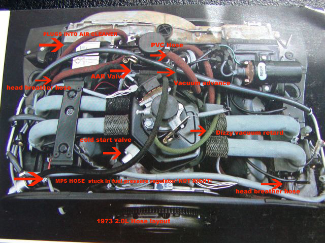

yeah, i started it up last night and it started running about 1500 to 2000 but after a minute and some revving, it calmed down to a 1100 idle. I also noticed that when i revved it, it went up quick and then came back down really slow. I've replaced all the vacuum hoses so i know they are all good... and where is this AAR valve?

Bleyseng
post Jul 28 2005, 02:20 PM
Aircooled Baby!
Posts: 13,037
Joined: 27-December 02
Member No.: 24
see pic

QUOTE (Bleyseng @ Jul 28 2005, 04:20 PM)
see pic
Nice pic, Geoff! Where'd you get that one? I don't think I've see it before...

my car is doing the same up and down thing too. I have a fuel injected stock 75 2.0 engine. that photo that was pictured, can i use that as a refrence?
thanx

QUOTE (Dave_Darling @ Jul 28 2005, 03:52 PM)
Also check the Decel Valve.
Where is that? i dont see it in the wonderfully labeled pic

The MPS and decel valve are mounted under the battery tray. Chuck the decel valve and plug the hoses....
Use the 73 2.0l pic for hose layout as its a real Factory pic!

A real factory pic, with only a few things moved around and in the wrong place....
--DD

QUOTE (Dave_Darling @ Jul 29 2005, 08:30 AM)
--DD
Dave,
Do you have the whereabouts of a "real" factory picture of all the vaccum hoses for a stock fuel injected 75 2.0?

I do, however, know where there are some line-drawings (which can occasionally show things clearer than photos) that have the 73-74 2.0 hose locations. The fuel hose routing is slightly different on the 75-76 cars, of course... You could use the 75 1.8 diagram for the fuel hose routing, I suppose.
