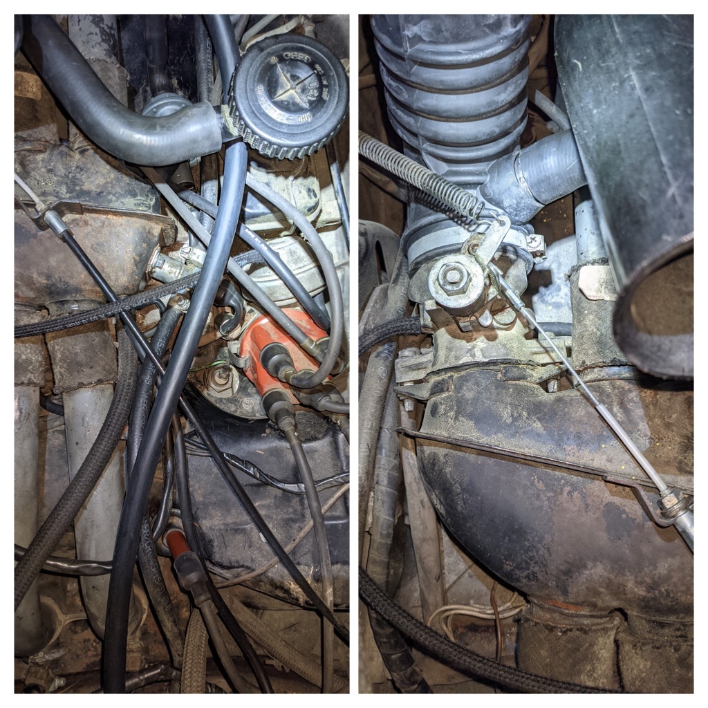

can i ask a favour. we are researching some stuff on the history of all the vac tube set ups between dist and throttle body for 1.8s.
can you take a photo of your emission sticker thats in the engine bay?
give us a Vin date. month and year.
and take a photo of your throttle body and distributor showing the vacuum line hook ups for advance and retard. post them up here. if you got time.

i've got some thoughts on this now.
and its to do with the retarded ignition on idle that some cars have.
for emissions.
your car may or may not have it.
see photo request above.
its the vac line off the back of the distributor that runs to the vac port on the TB.
thats the port on the TB that faces towards the front of the car.
been doing some reading about problems of cars back in the day.
weak idle at cold start up caused by above.
but who knows.

Never seen an emissions sticker in the engine bay. But the car is dual vacuum and was manufactured 12/73

@Van B
thanks for photos and vin info.
if the emissions sticker is still there its on the lhs side wall of the engine bay,
just above where the relay board and the air cleaner are.
be handy to know what engine code it has written there.
be something like EC-B or EC-A.
any idea where the car might have been originally sold new.
did you get a glovebox manual? would have a dealer stamp maybe.
re the retard at idle.
i think you already know about this?
but for emerygt350's interest.
some, but maybe not all 1.8s hook up both sides of the double can vac on the distributor.
the small side is known as a retard can. the larger side is advance.
the small side if it is connected to the throttle body port that is downstream of the throttle plate (engine side) uses engine vacuum at idle to retard the ignition a further 3 degrees or so than 7.5 btdc (or ideal idle). what that does is make the engine reduce NOx emissions at idle. lowers combustion temp. though it also has the effect of raising exhaust temp (Still got to get my head around that bit). at that retard (about 4 deg btdc) you won't get a smooth take off at that level of retard except the minute you snap the throttle open the engine instantly comes off vacuum and the distributor snaps to 7.5 - and you do get smooth take off.
also the engine cranks and fires at 7.5 for ideal starting before it goes into its full emissions retard idle.
emery350gt -its why you time the 1.8 at 7.5 btdc at idle with the hoses off.
you get it to 850+ or -. then you put the hoses back on and do a fine tune on the idle speed after they are back on. some say to block both the hoses, but my logic tells me you only need to block the retard hose. it doesn't hurt to block both. the manual mentions nothing about blocking the hoses at all. so (IMG:style_emoticons/default/confused24.gif)
i've come across some material that says this - while it was good for meeting the idle emissions standards it did cause the engine to run hotter while stuck in traffic. and it was mentioned could cause weak and stumbling warm up idle.
i'm wondering if that is a feature of our cars with both vacuum ports connected to both throttle ports. an easy test would be to pop the vacuum retard hose off the back of the distributor can at start up and see what it does. (you need to pop it off and block it just so you are not pulling any air in the port near the throttle.) basically disable the retard at idle and see if its a steadier faster warm up?
i think vw and porsche might have been doing this themselves right through 74 trying out variations as there seem to be a number of distinct versions with and without both hoses hooked up.

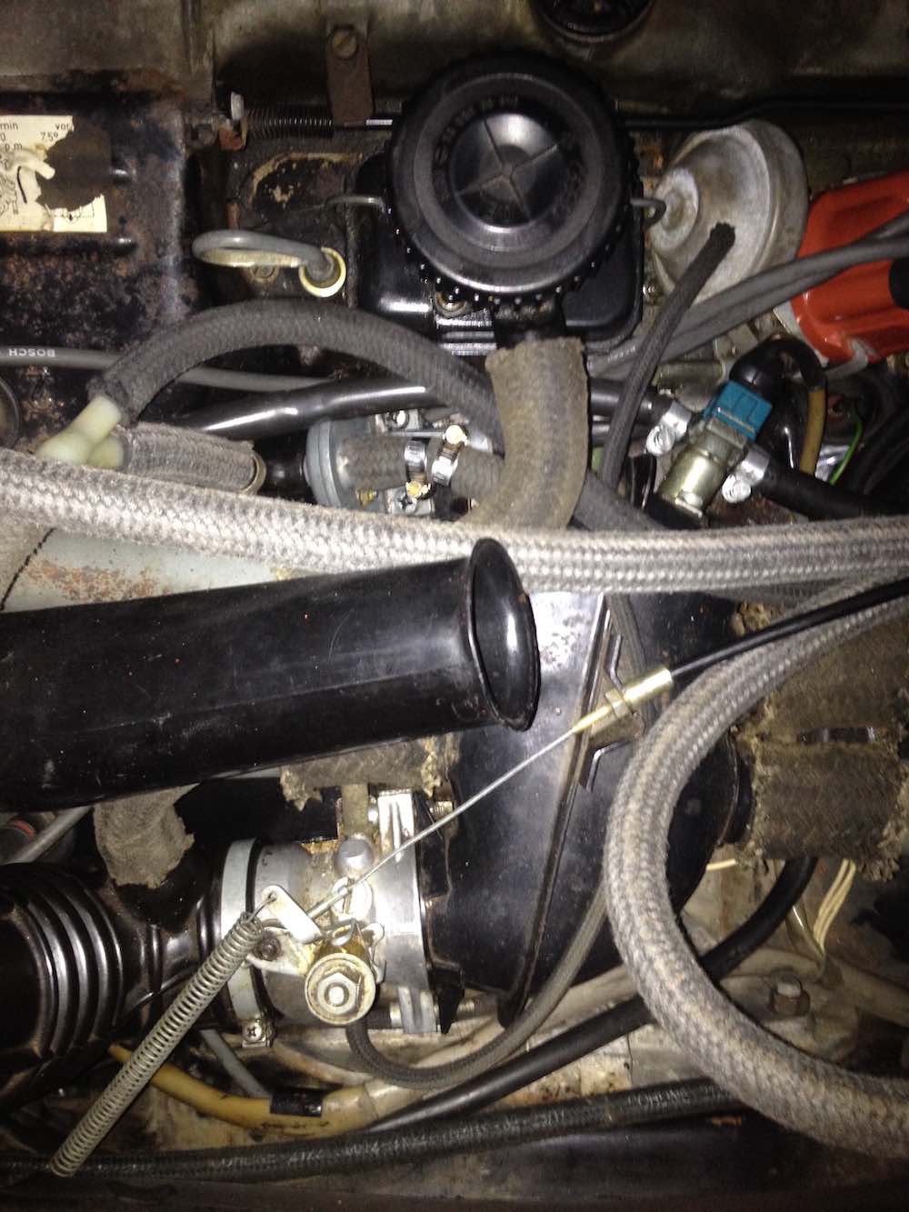

@Van B
yours is the splitting image of the setup on mine. (IMG:style_emoticons/default/beerchug.gif)
