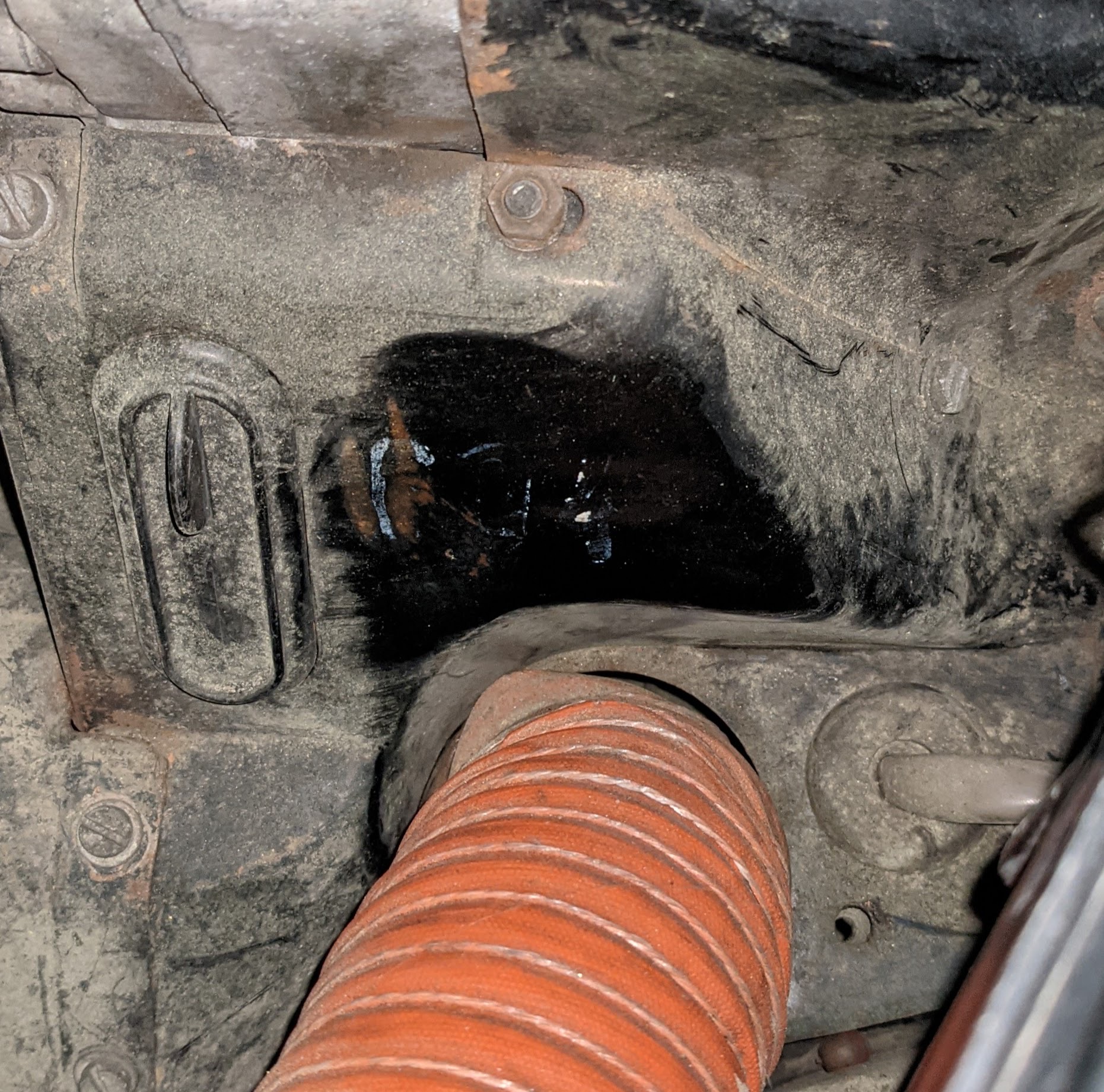

Well, emissions sticker is there… its also gone forever. It was sprayed over when new with corrosion protection. So, not likely it would survive any attempt to reveal it.
Engine number is EC008741, but that’s the best I got. Other than it’s a US spec with the low compression pistons that provide a whopping 76hp/91ft lbs… to the crank.

QUOTE(Van B @ Nov 20 2021, 07:08 PM) *
My emission sticker on my (my father's) 74 had some overspray from a trunk hinge repair done before my time. I used isopropyl alcohol on a q-tip to remove the overspray paint and it removed the paint and didn't harm the sticker. I learned the trick from a friend of mine.

Yeah, this is 48yr old ziebart rustproofing… it ain’t coming off.
Ah okay. No worries. I didn't know it was undercoating/rustproofing.
extreme hell hole paranoia - and in 1974! ha. (IMG:style_emoticons/default/smile.gif) (IMG:style_emoticons/default/biggrin.gif) (IMG:style_emoticons/default/av-943.gif)
